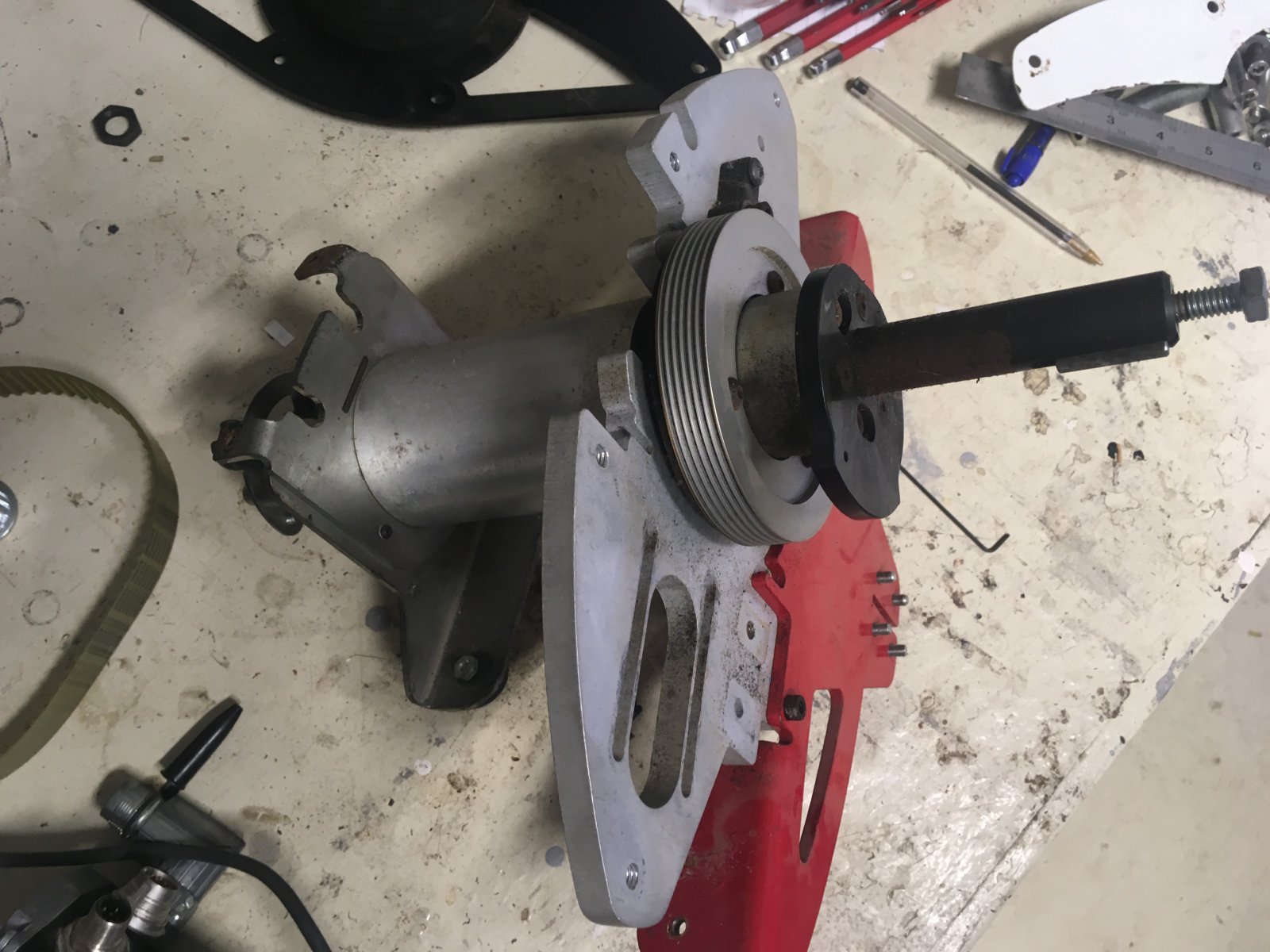

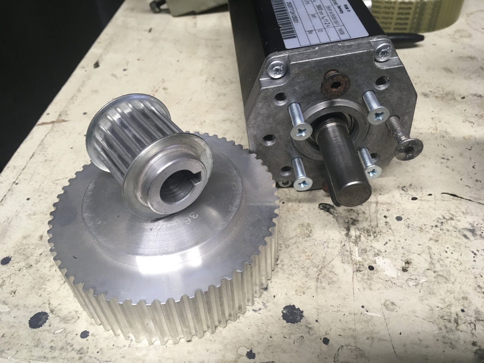

    ECCI 6000 with motor in place of the damper. Mechanical conversion is progressing well and electronics tested up to encoder integrated into STM32 and MMos.
    Question - the encoder is 5v output, can the STM32 handle 5v logic on the encoder input pins?

    motor is a dunkermotoren BG75x50PI, encoder an "omron" E6B2-CWZ3E, 1024 p/r voltage out

    The mmos is closed source, so no getting analog voltage outputs. If you go EMC or VNM software they both support DAC output I believe.
    Stm32f407 pins are not officially 5v tolerant so you’d need a level shifter (in my experience it works fine without it though, did not know this in the beginning and haven’t burnt anything yet)
