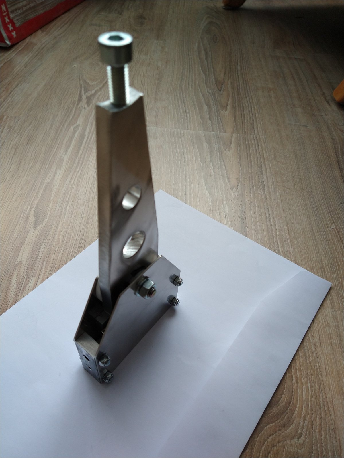

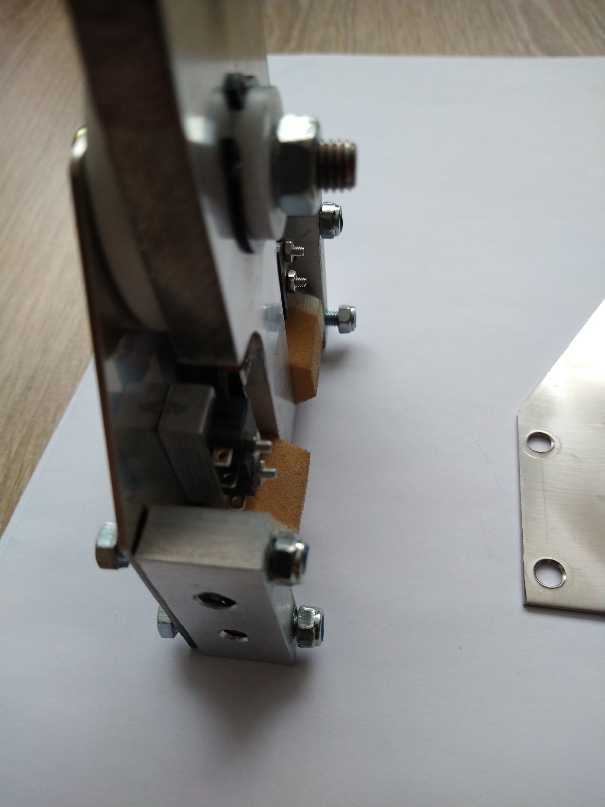

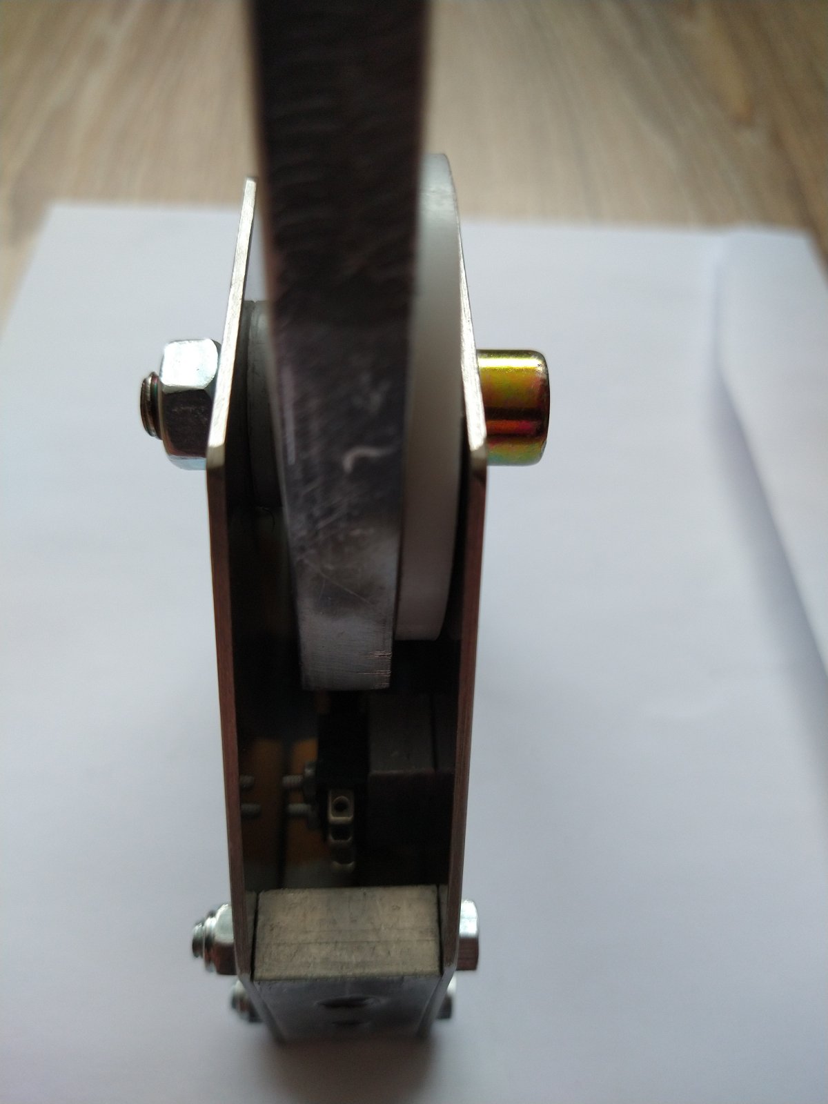

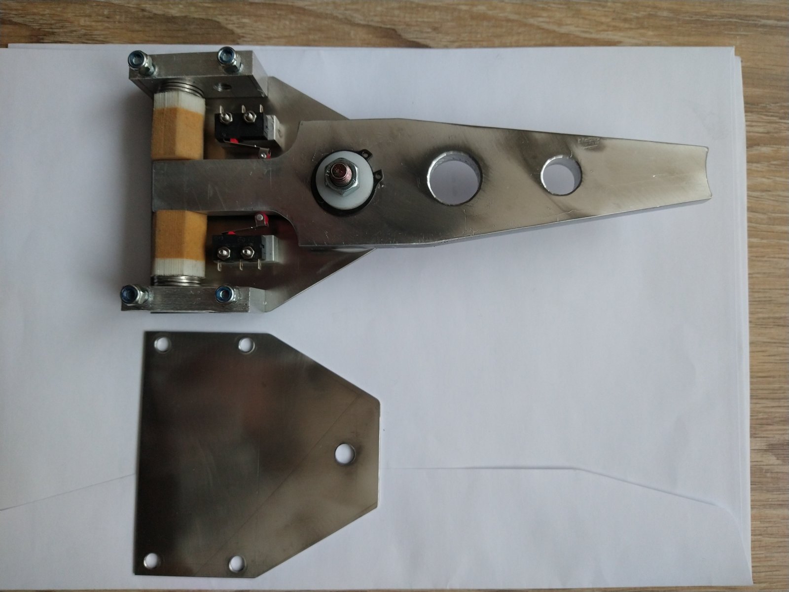

    Since I do not have a 3D printer, but can machine parts I have made a simple sequential shifter from stainless steel and aluminum. The self centering and end stop is achieved by special silent blocks. The stroke of the lever is only 10 mm forwards and rearwards. Still the wiring to be connected up to the micro-switches and the knob to be placed. I assume the attachments clearly show the design. Currently also designing and building a 6- speed shifter.
