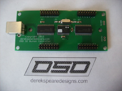

    i'm planning to make a shifter to my Thrustmaster F430 ffbw with a cheap generic usb controller, that you only attach some wire to the ussualy buttons with a drop down resistor and you can use all the buttons of the ubs controller.
    i pretend to use to shift the gear and some other uses, like pit limiter, and etc.
    i'm thinking to make the shifter a arcade stick, only working in one of the axis.

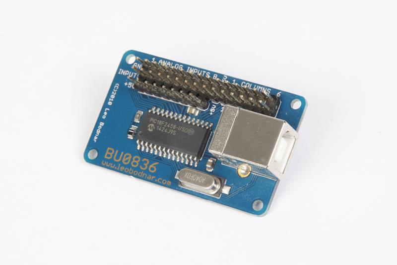

    at the end i opted for a cheap usb gamepad like the one posted by merchan-e , so i decided to take advantage of the extra inputs and wire some push buttons and a rotary encoder.
    now i am having trouble to get the controller read clean inputs from the rotary encoder, i have try
