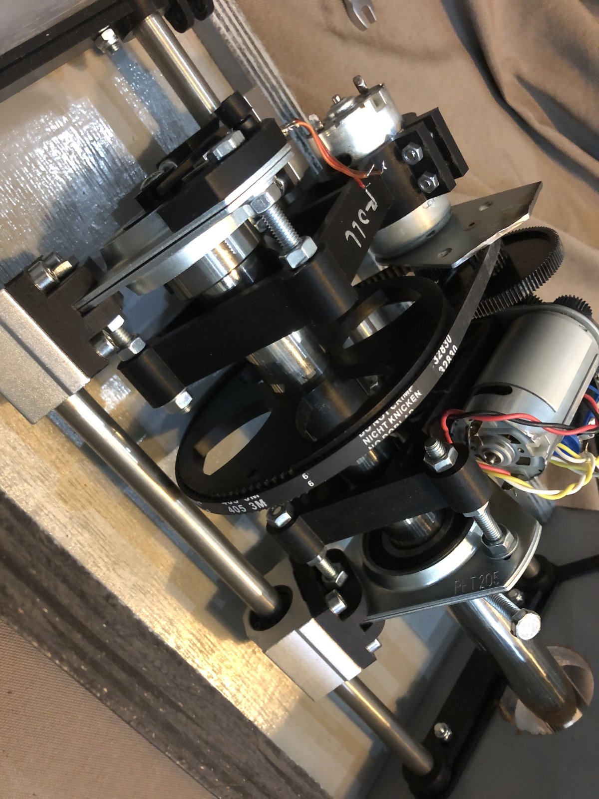

    I'm thinking about if it's possible to use an RC Servo for Force Feedback. They are small and (depend on type) powerful.
    Two Servos, connected to a Arduino board controlled by simtools. The main problem ist how to install the servos into the saitek yoke. I will make some tests with some servos abnd think a little about it.

  8. ericdozi
    ericdozi New Member
    Mar 1, 2022
    23Coins
    I use this, but the feed back doesn g work very well on MSFS20, the
    i use this with msfs20 but the xpforce app doesn t work very well for me, so I abandoned the project
