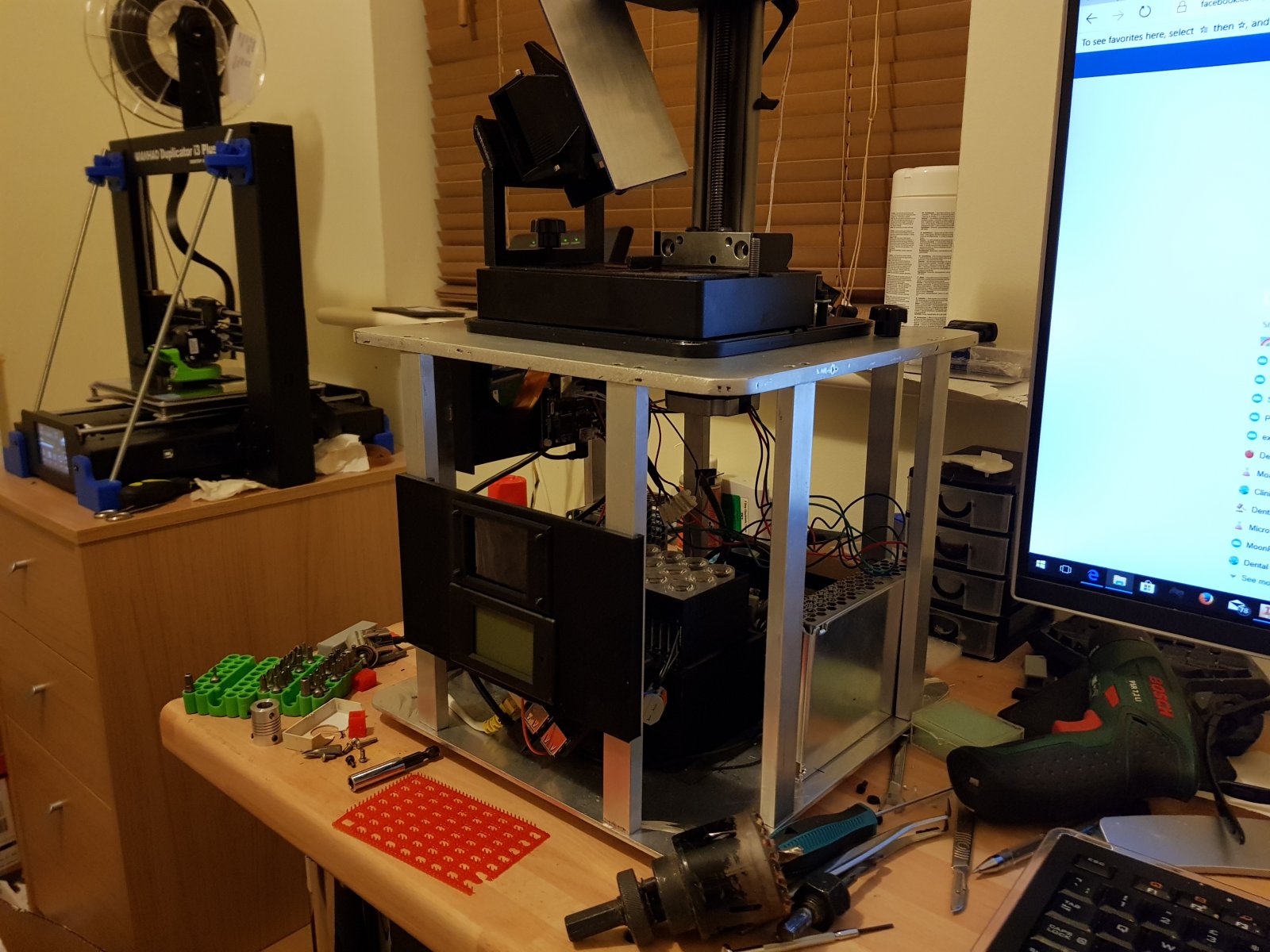

    This DIY printer build is an LCD type
    Note: the case is obviously not finished yet and the printer is taller than it needs to be (also wider if only using a 5.5" screen but i plan on upgrading to a larger screen/build volume at some point).
    Whilst it may not look much, its got it where it counts :) is super fast by LCD resin printer standards and very accurate with high detail.
    Now IMHO this is actually easier to build than an FDM as there is only 1 moving part, the Z axis and 3 main mechanical components which affect the performance of the screen...

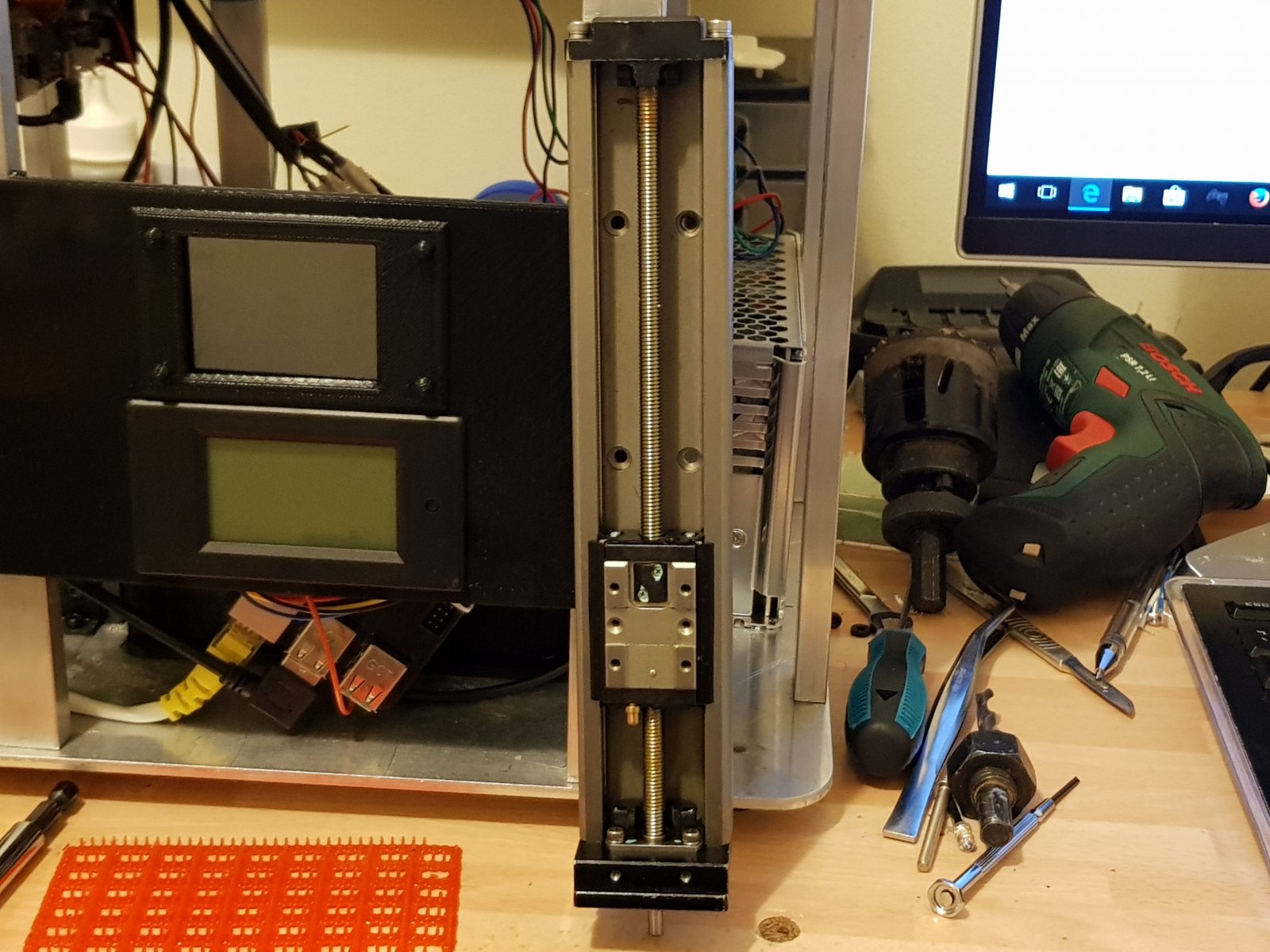

    Z axis.
    You can build your own with similar parts to FDM ie rails and bearings or buy something off the shelf. Now if you want the least hassle and best accuracy then id suggest just buying something as this is the main moving part and critical to print quality. After various trials and experiences this is what ive ended up with for this particular build.
    http://www.ebay.co.uk/itm/THK-KR20-...165028?hash=item3ad5912f64:g:jM8AAOSwYlRZFa-C
    Brand new this is a $1000 rail! and when you print with it you will instantly see why. Has minimum layer height of 10um (will do less) and virtually zero backlash.
    This has a stroke of about 130mm so that will be your highest part, but you can buy larger versions ie KR30 if needed.

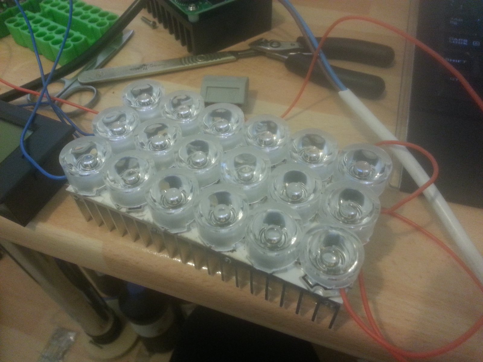

    UV engine

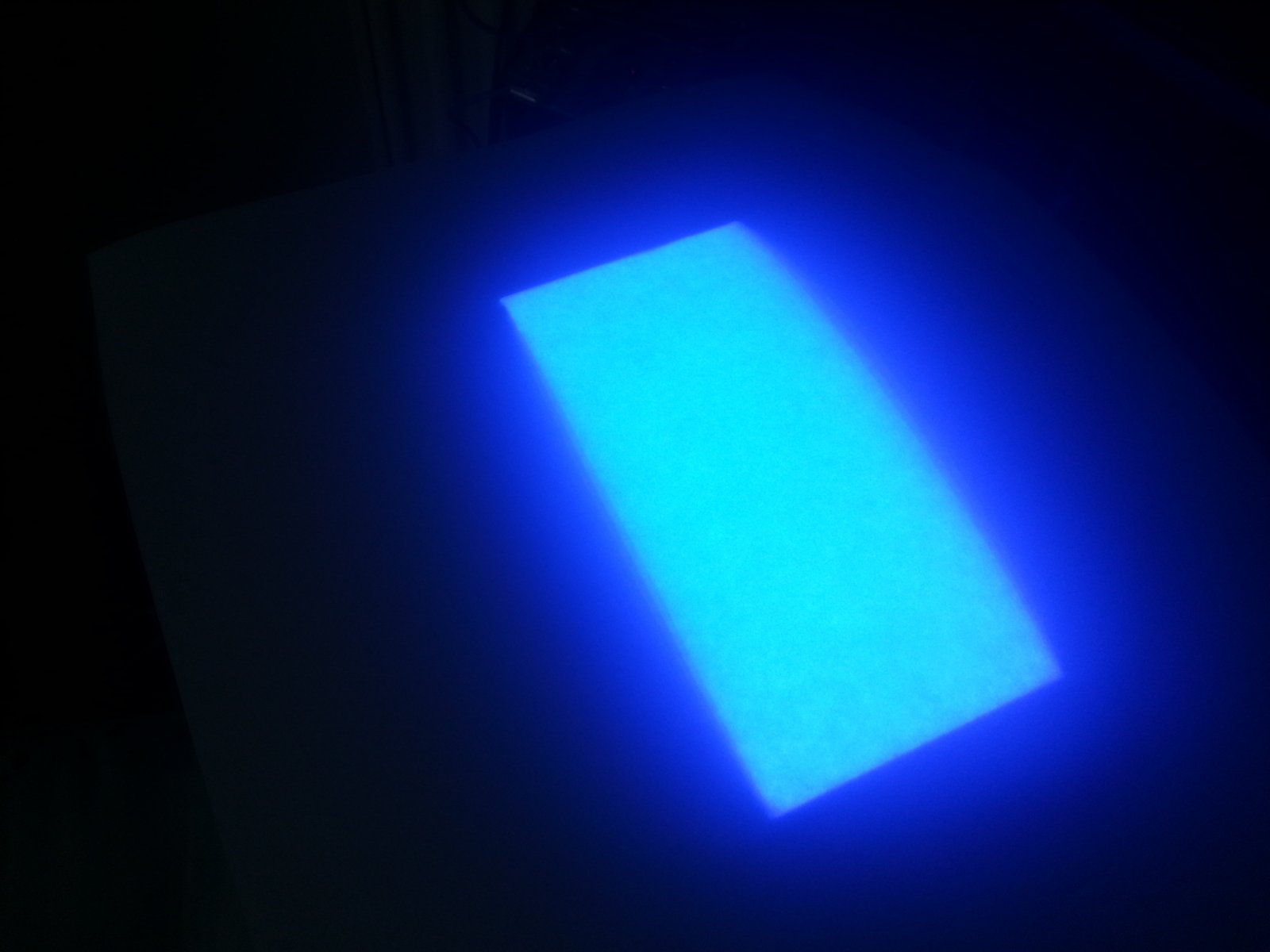

    OK this is the real heart of any LCD resin printer and that took the most time to figure out, it is very important to speed and accuracy.
    The most popular and cheapest resin printer doing the rounds at the moment is probably the Wanhao D7. This printer actually started out as one before i stripped it.
    Why is it so cheap? poor build quality and cheap components with reliability issues and most importantly, uses a single LED in the centre of the build area.
    As you can imagine this causes all sorts of issues as you end up with a hot spot in the middle of the build area and the intensity of the light drops off towards the edges of the build area. This causes allot of issue with accuracy as the resin is curing at different rates and causes havoc with getting prints to stick properly to the build plate.

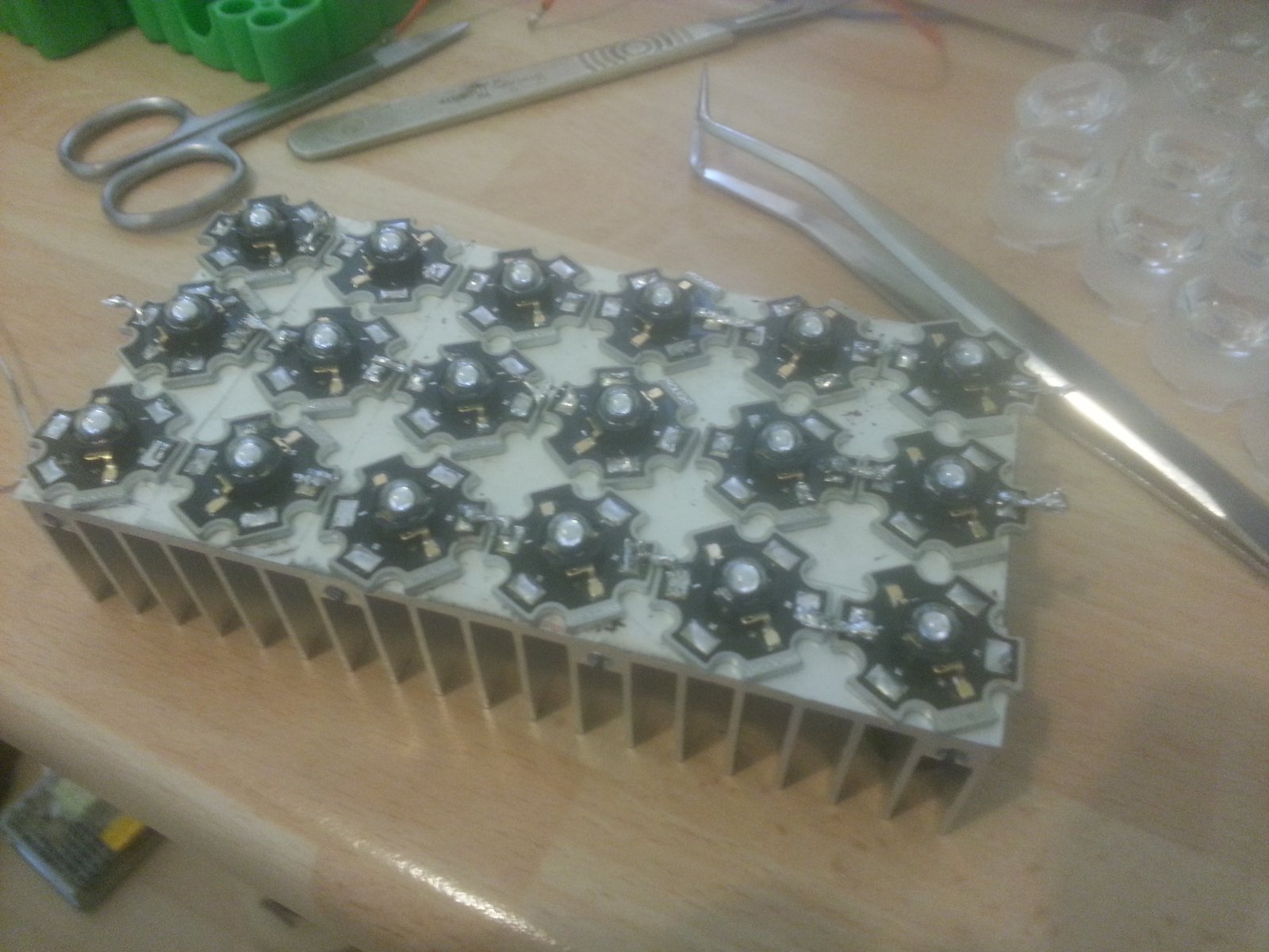

    Ideally what you want is an array like the pictures above which covers the whole build area. That way the resin receives even exposure and cures at the same rate.
    This is what you are trying to create:
    The above array is for a 5.5" screen but is easily scalable. It consist's of 18 3w 3.6v leds on a surface mount star PCB for total output of 54w. This is wired in serial/parallel with each row in serial and the 3 rows in parallel. Its cooled by 2 60mm noctuas which are basically silent. This also has some redundancy so that if one fan packs up, the whole array dosent go pop! as it will overheat VERY quickly without active cooling.
    These are the leds i used or search aliexpress for similar.
    https://www.tme.eu/gb/details/pm2l-3lls-sd/uv-leds/prolight-opto/

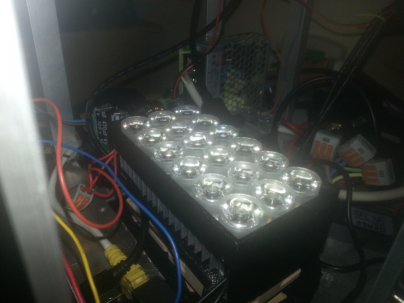

    Now you will notice other 5.5" LCD printers with a much smaller case. The reason for this is they are using led's with the built in collimator to focus the light which is generally about 130 degrees. This means the beam spreads out wider and therefor the array can be closer to the screen.
    Some things to note with this approach. 1. It makes it much more challenging to manage heat coming from the array. Apart from UV intensity, heat is the other factor which will determine the life span of the LCD!.
    2. And i really need to research this further but as i understand it the straighter or more focused the beam from the led, the sharper the light is and the more focused the important wavelength's are which are hitting the resin (please correct me if I'm wrong here).
    For this reason i used extra collimators on the LED's to narrow the beam to 20 degrees. This does mean the array needs to be further from the LCD but this also has the added benefit of making it much easier to control heat. It dosent increase the footprint of the printer buy making it slightly taller so I'm much happier with this approach.

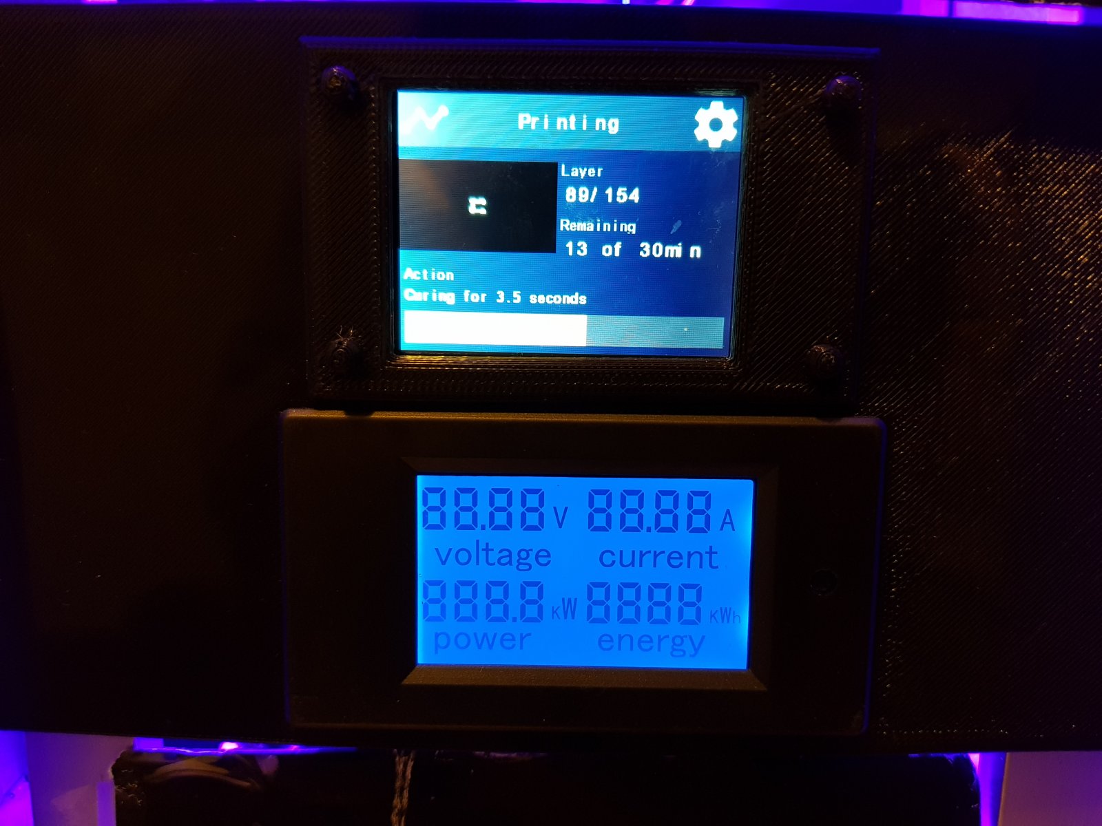

    This image is also configured to run a Nextion touch screen which was quite a bit of effort to get running so would save you allot of time. This allows you to get real time status from nanodlp and access basic functions. There is editor software for the Nextion screen so in theory you can add and customise it however you like.
    https://nextion.itead.cc/
    https://www.aliexpress.com/item/Nex...a3d2-4b1e-b52b-07db442423bd&priceBeautifyAB=0
    https://github.com/Tibus/TouchScreen-For-NanoDLP
    The second screen at the bottom is for reading voltage and amps at the same time which is really useful when tuning the array (more on that later)
    https://www.ebay.co.uk/itm/DROK-Dig...983915&hash=item1a40e27971:g:i-cAAOSw6~VZz5EG

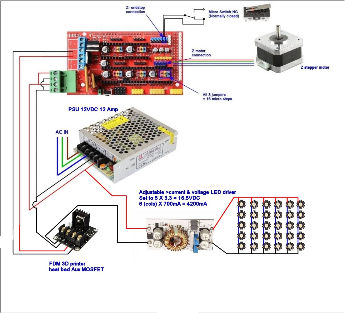

    Power, Converter Buck, SSR
    Power is from a regulated 12v PSU. 12-15amp should be enough to power the stepper, screen, UV array and RPI3.
    On the Wanhao motherboard there is a 34v out which i used as a trigger only for the array. Power is taken direct from the 12v PSU to avoid stressing the wanhao board to much as its not designed to handle the current required by the Array. 34V signal goes to a solid state relay which switches 12v to a step up buck which has pots for voltage and current. This then makes it easy to dial in the power requirements of the array without using resistors. Because it is all triggered from the 34v out of wanhao board (the standard UV output) theres no need to modify nanodlp in anyway.
    step up buck used:
    https://www.ebay.co.uk/itm/600W-DC-...007480?hash=item3abe2213b8:g:n5cAAOSwQYZWzShZ
    DC to DC SSR Used:
    https://www.ebay.co.uk/itm/RUIKE-ly...2-100V-L1C6-/282655550589?hash=item41cf956c7d
    (Wiring Diagram of all this to follow)

    The Array of UV leds is under the LCD (which has the backlight removed) an this array is the 'New' Backlight ?! Is that what the idea is ?

    yes that's correct, the array is the back light that cures the resin through the LCD. Other than having an accurate linear rail, this is where most of the magic happens which affects quality of prints.

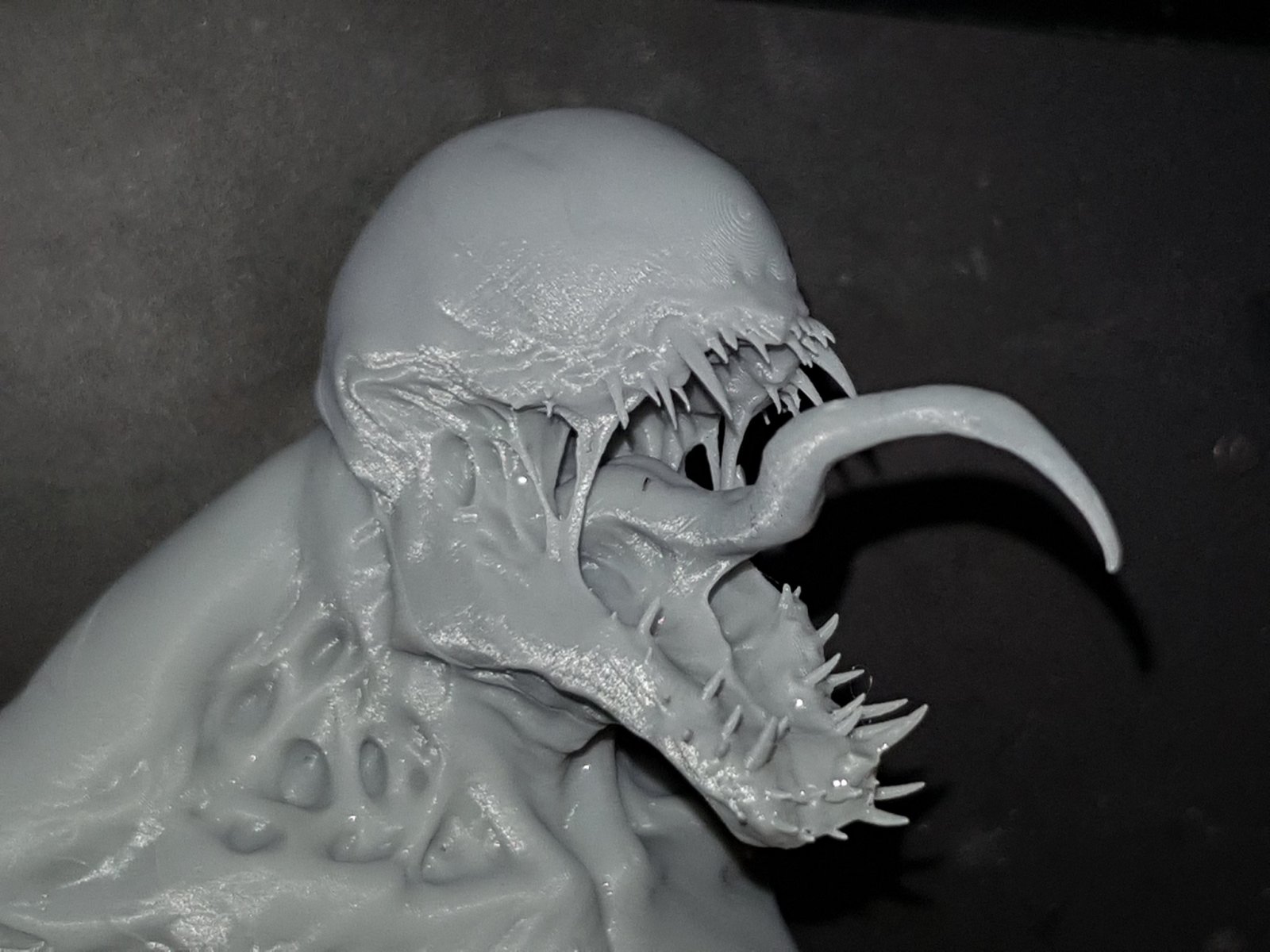

    Regarding results the printer works great. better than the Phrozen make i have. The DIY is way faster and works with a wider range of resins (phrozen chose a led that's 400-420nm, you need to stick to 405nm for the best compatibility)
    Most of my prints are dental parts (i own a dental laboratory) so not particularly interesting for others but i did this at 50um just to see how far i could push small details. The head here is the size of my thumb nail so as you can imagine, the teeth etc are super tiny.
    Still a slight bit of undercure as some of the teeth are not fully formed, needed an extra 0.1 seconds per layer i would think.
    This is not maximum quality could do 10um per layer but would take forever.
