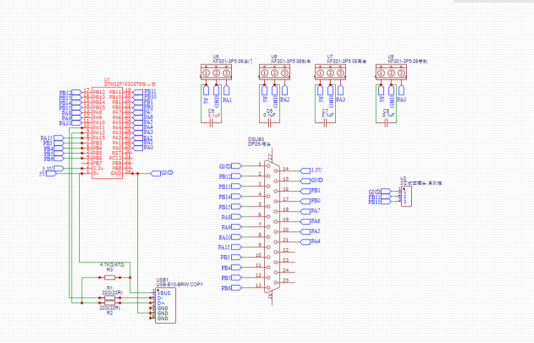

    Parts used:
    stm32f103c8t6
    KF301-3P5
    DP25- Female head
    3-core aviation plug
    USB-B10-BRW COPY
    0.1uF

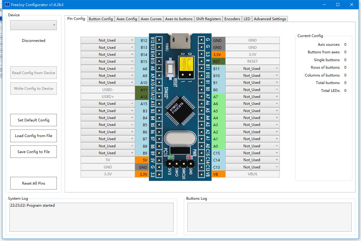

    Controller software:
    FreeJoy Configurator

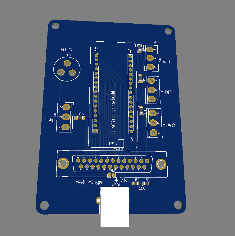

    PCB making
