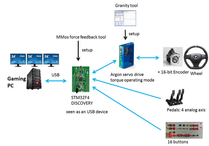

    Installation instructions for das MMos FFB USB/HID Board (STM32F4 Disco):
    It may be neccesary to remove vJoy if you want to use the great expansion board MMos has programmed. If you still get crashes from the config utility please make sure that vJoy is completely removed from the system!

    Here is the principle of the second case (MMos FFB USB/HID STM32F4 Board):
