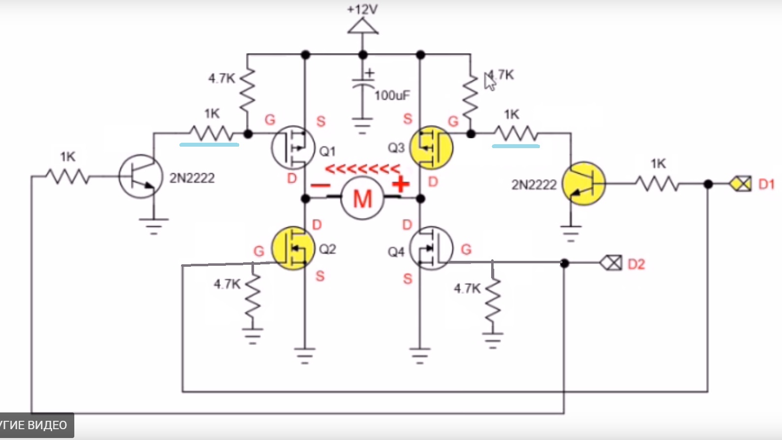

    Decided to give a go with DIY H-bridge for the arduino DIY wheel, as an alternative replacement for BTS drivers.
    Just curious.
    The test with 5v to controll inputs, to change the directions.
    And 12V power supply.
    The schematic was taken from here.
    https://www.circuitlab.com/editor/#?id=m4c244
    Made with Manhattan components mounting style.
    The MOSFETS are: for P-channel IRF4905, and N-channel - IRF3205.
    As there were no slugs to isolate the mosfets from the radiator, made quickly and simply with thermal contraction tube and plumbing flax fiber.

    Well, got some progress with this thing. Checked and changed one of the 3205 and it starts to work much better, in terms, that now it performs the smooth work without any kicks as before. ( i.m. I check it with Wheelcheck "Simple Spring" mode on this sort of things) All the same picture as was with BTS7960 except the slightly 1% of the wheel turn with 900deg range deadzone. It is about 10deg of the wheel turn itself. Not to slightly, but still good to know. ) Now schematics looks like that, except the underlined 1k resistors out there. Should also try 1k instead of 4.7k, and smth less with of values to gates of 2n2222. May be will bring the dead zone to better picture. The 1k to gate of the low irf3205, as per initial schematics, brings no signal to it at all, so was excluded. At least all of this is true with 12V power supply.

    Alright. A little sum up, for now. The driver is fully working!
    Got to solder the mosfets maybe more carefully, without overheating the pins of the device. Changed another side IRF3205 and here we go) Also added 47 ohms to the gates of the 3205 to eliminate, (must work) the "ringing" as an LC contour. )

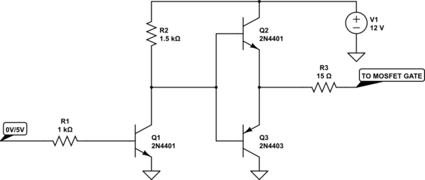

    Made the MOSFET gate driver. But it inverts the signal. So the invertor for the gate driver itself is required to this approach.

    Regarding the mosfet gate driver from this schematic.
    https://radiohlam.ru/driver_polevikov/
    In order, there be no inversion of the signal, the required signal is on the vcc of the schematic. The one that is needed. And then the "out" should be connected to the common ground. The "P-channel connection". ))) Works with 3v input. And it might be even less. Logic level.)

    Finally.
    I just took an optocoupler, and connected the "out" signal, to come from the emitter to the H-bridge. If from collector, it will give an inversion. And it works! The gates are fully opened. Can make 10-15v on them. In the example, it is fed with 12V small battery. )
    So no need in the other gate drivers)
    In the example, it is connected to the left side of the H-bridge.

    Guess just need to put IRLB-3034 instead of IRF-3205, and that should go right without gate drivers things.
