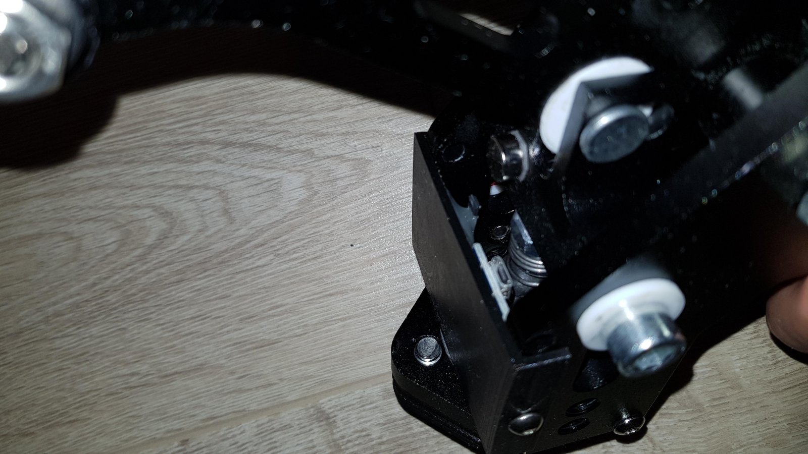

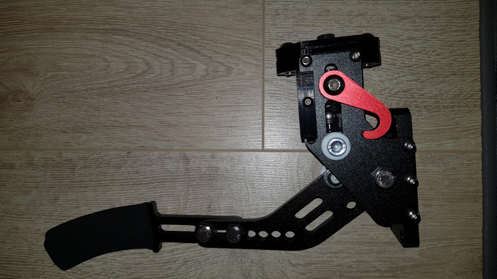

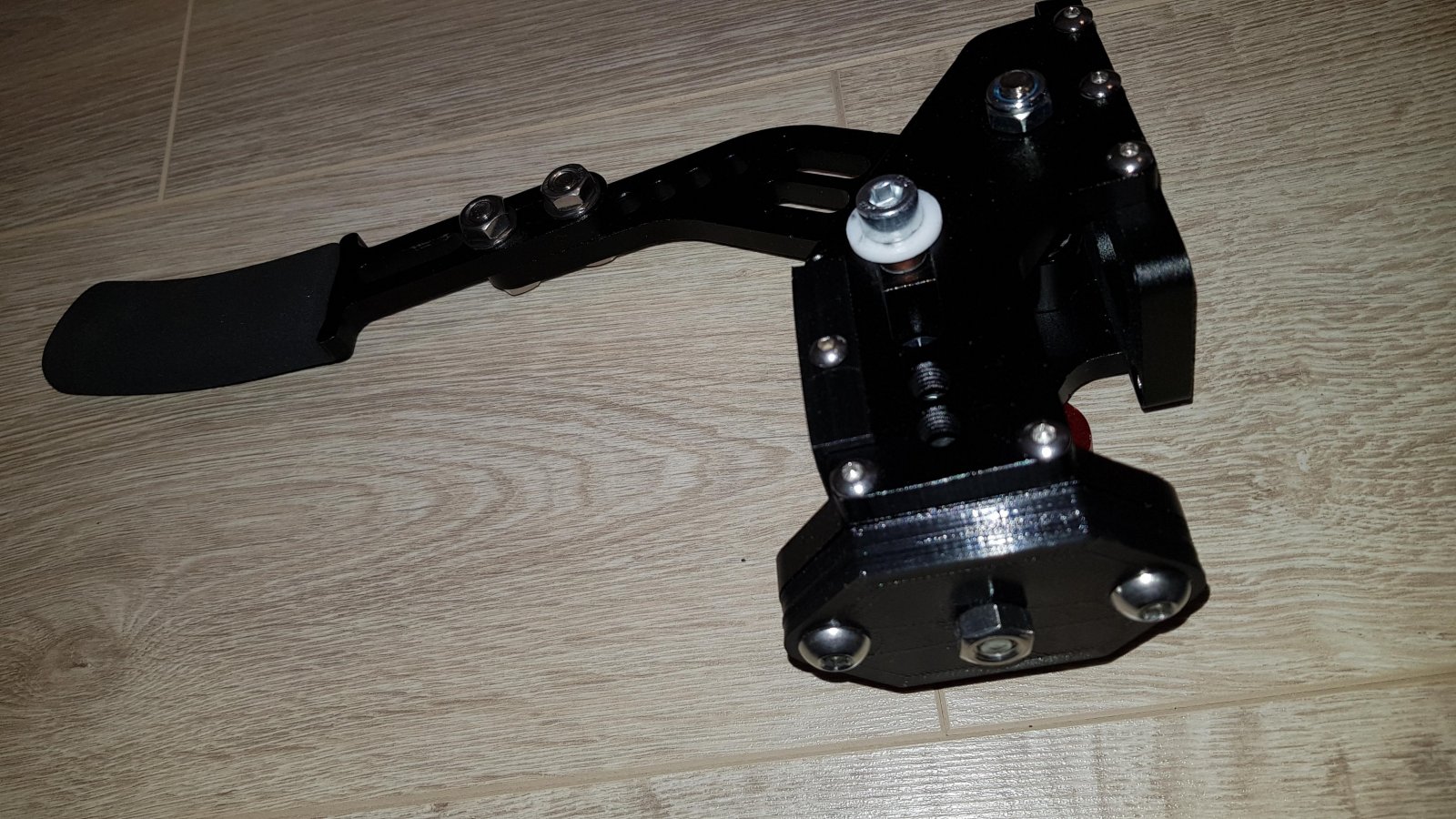

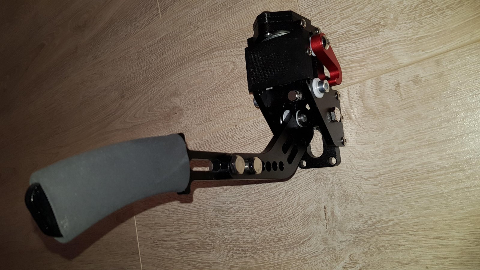

  2. iLLuac4
    iLLuac4 Active Member
    Jun 19, 2019
    136
    893Coins
    +58 / 0 / -0
    Here are some pictures of the build. The whole handbrake was less than 30€. You can find cheap one on aliexpress.
