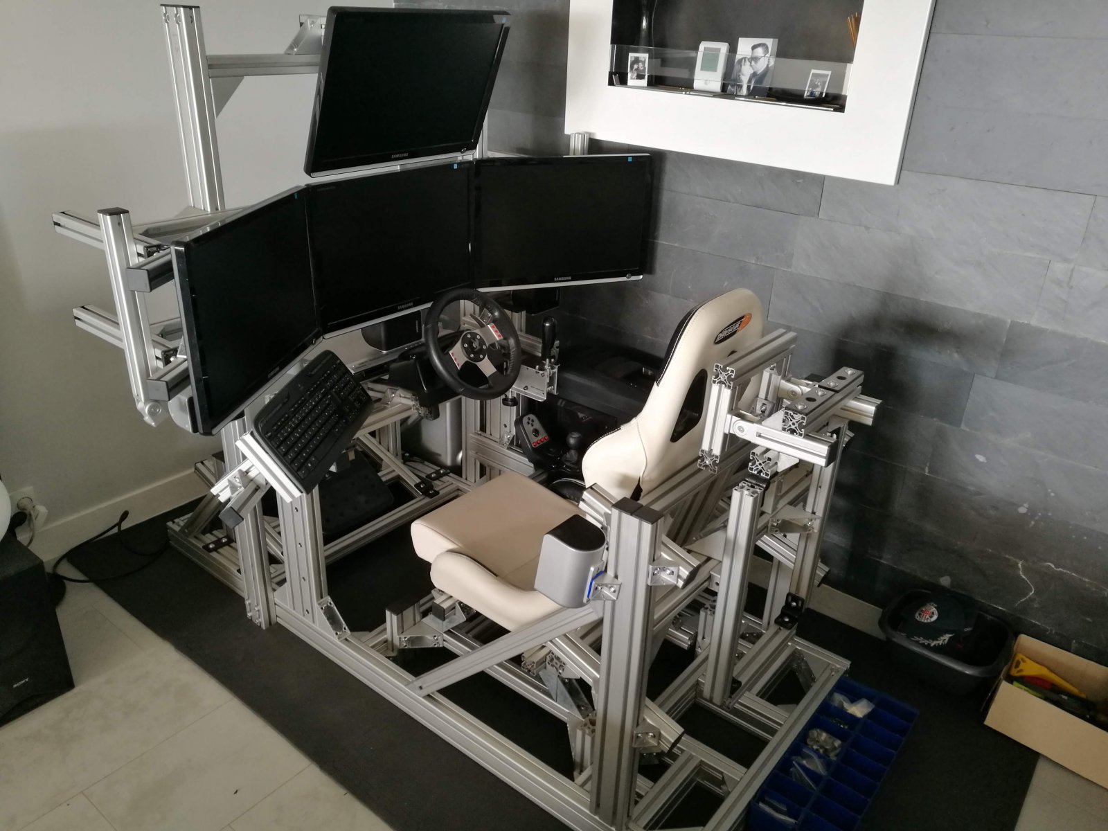

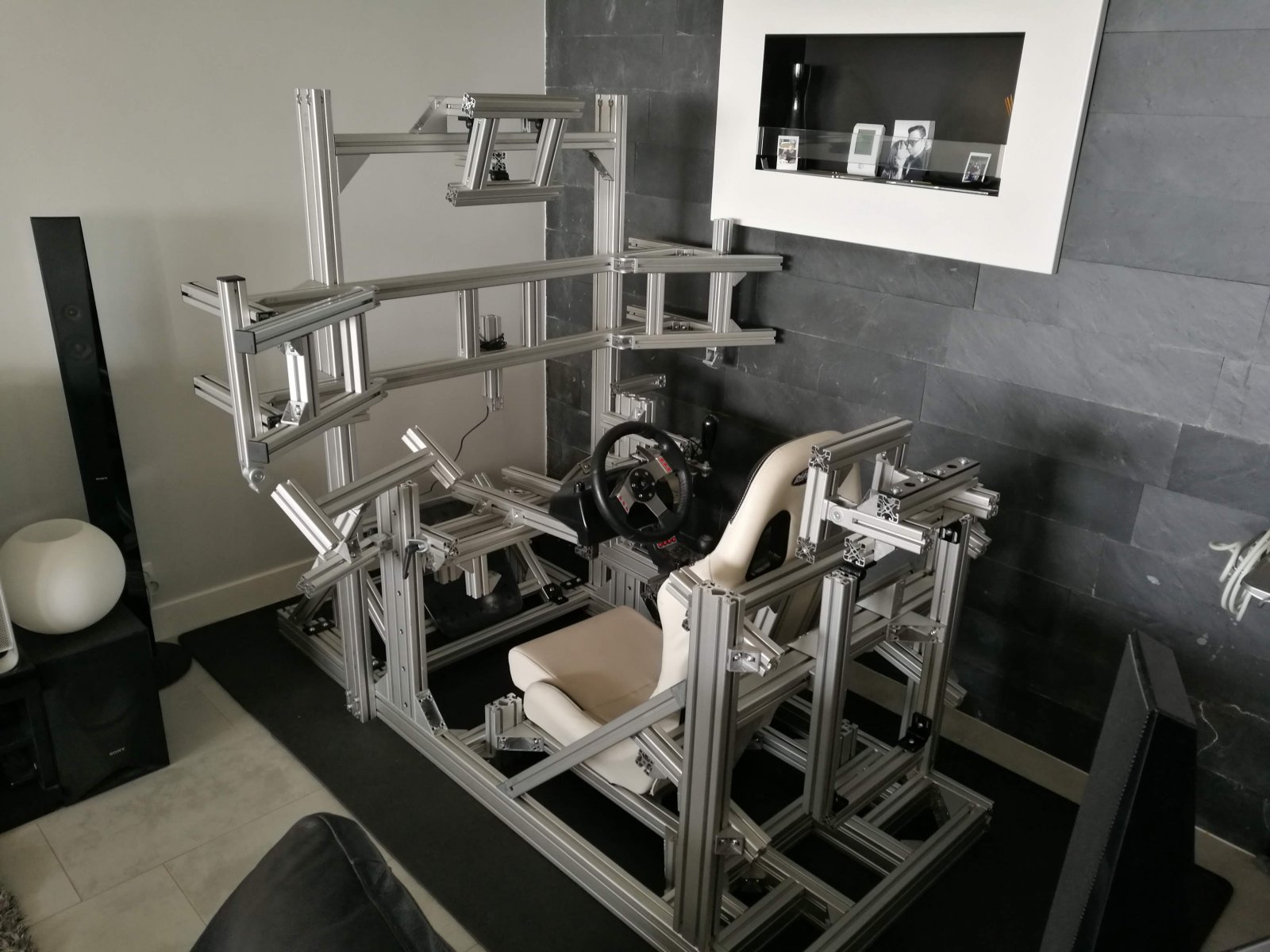

    I present my DIY G-Seat simulator.
    It based on G-Seat system. The purpose is to generate G-force on pilote with almost no movement.
    The bucket seat is slice in 3 parts. The backrest is a the only fixed part, seat and the top of the seat (behind the shoulder) are mobile parts.
    Bottom of seat transcribe longitudinal G-force, top of the seat combine longitudinal/lateral G-force.
    The system is actuated by 3 DC motors of 150 W. The electronic part is composed by Aduino Uno with 3 H-bridges (MotoMonsterShield).

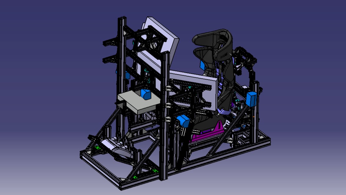

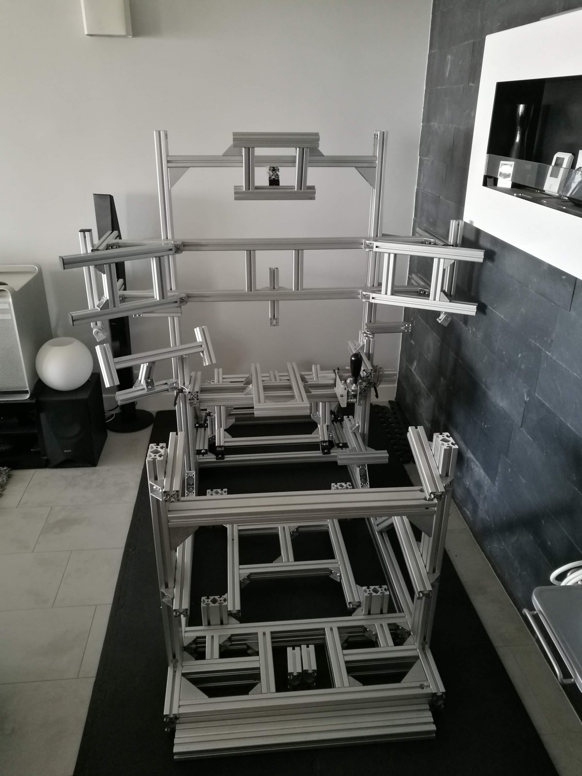

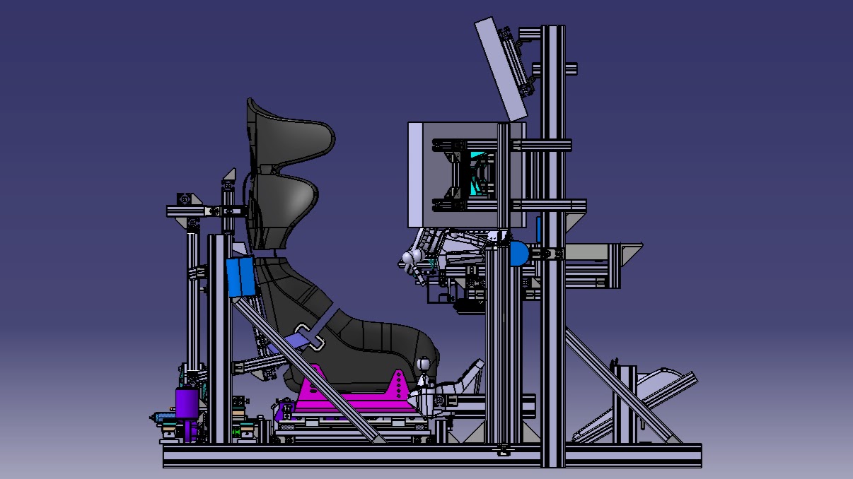

    To begin a CAD study
  5. TomKlash

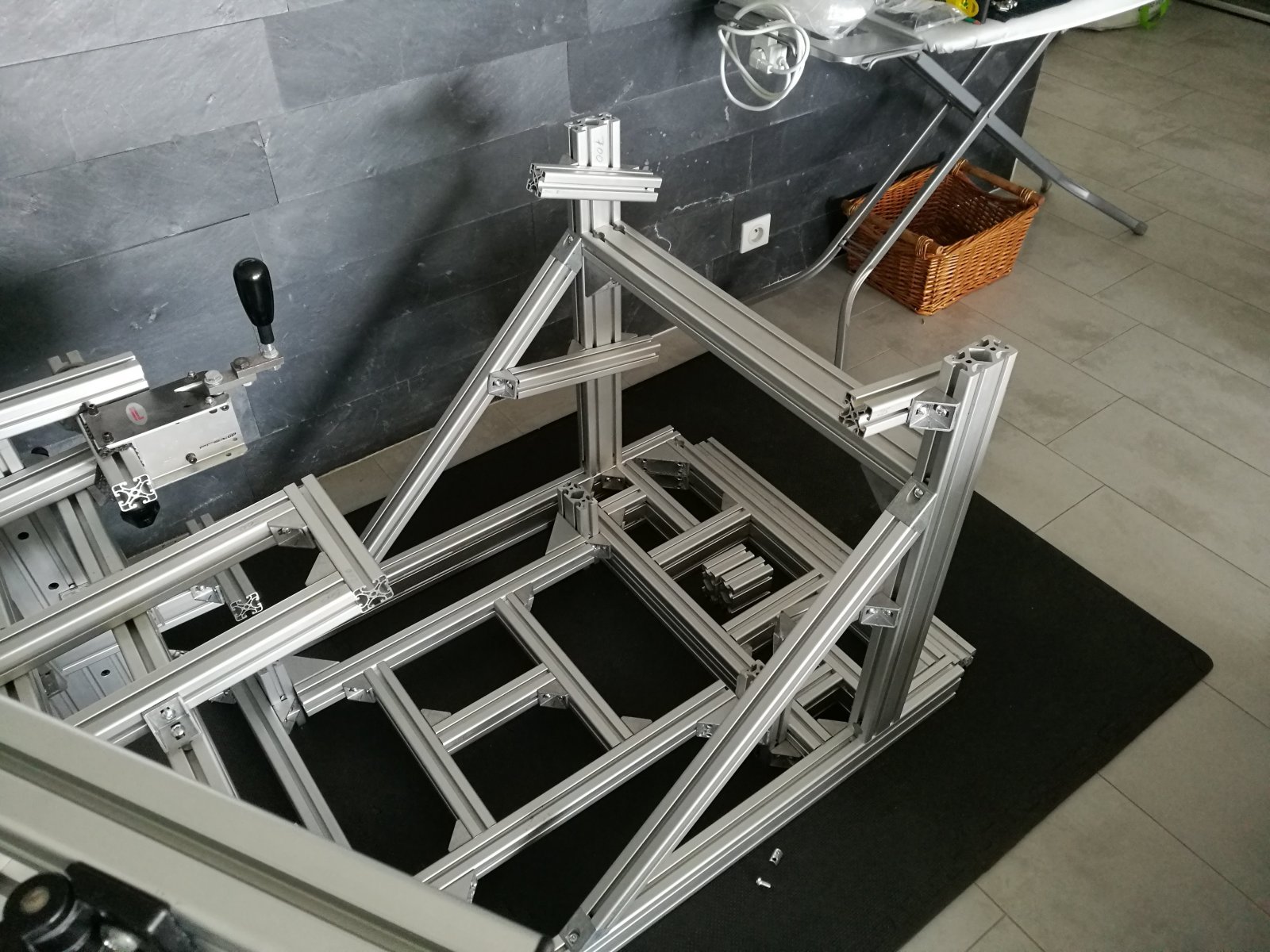

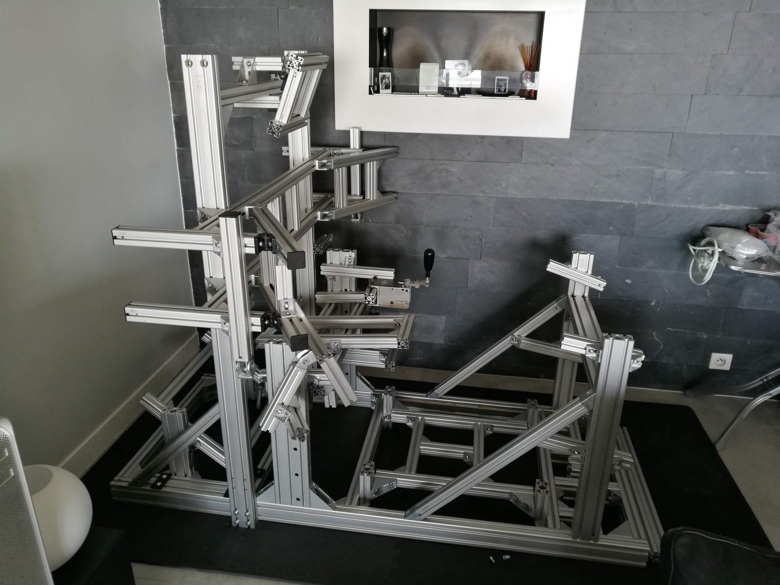

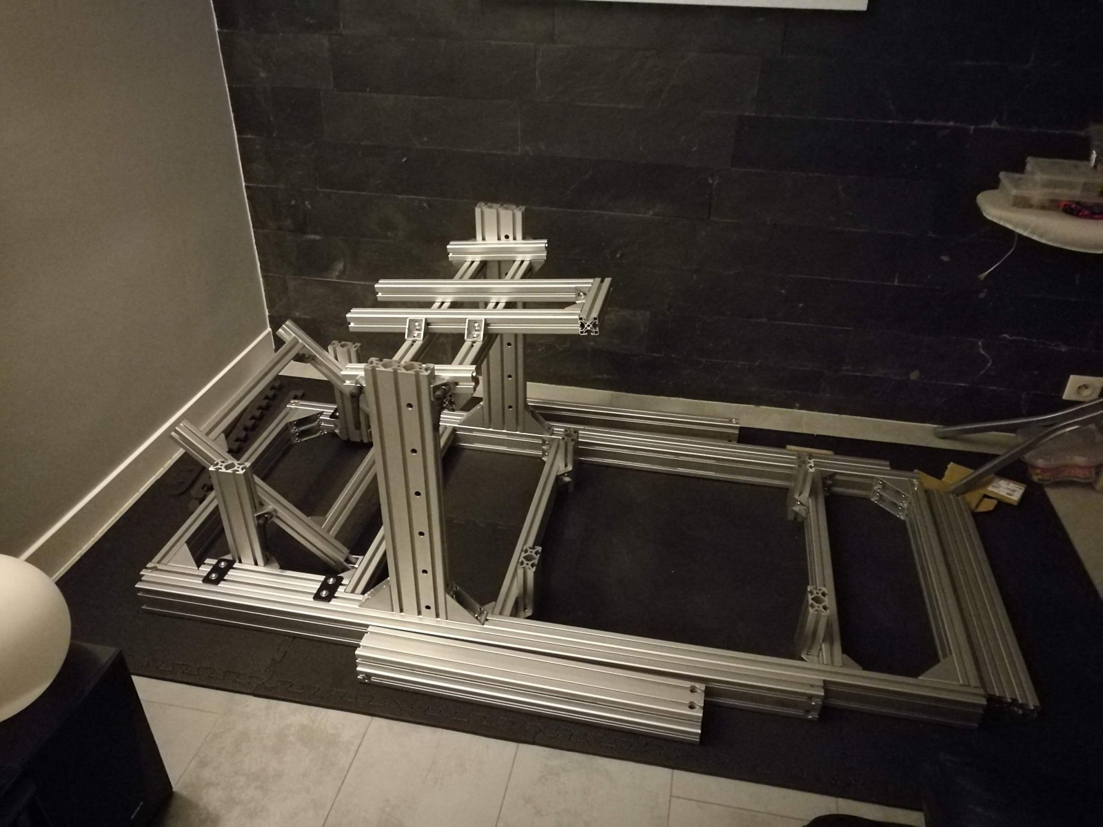

    2DOF, 3DOF, DC motor, SCN5, Arduino

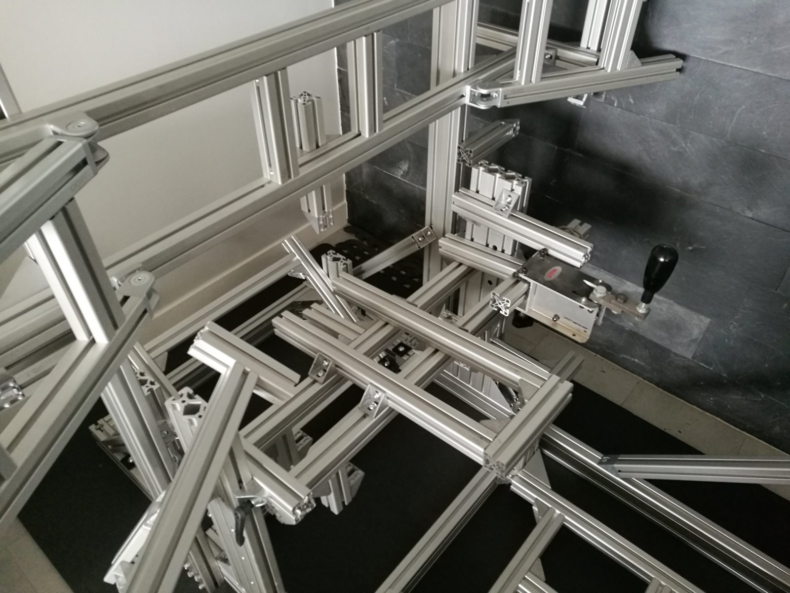

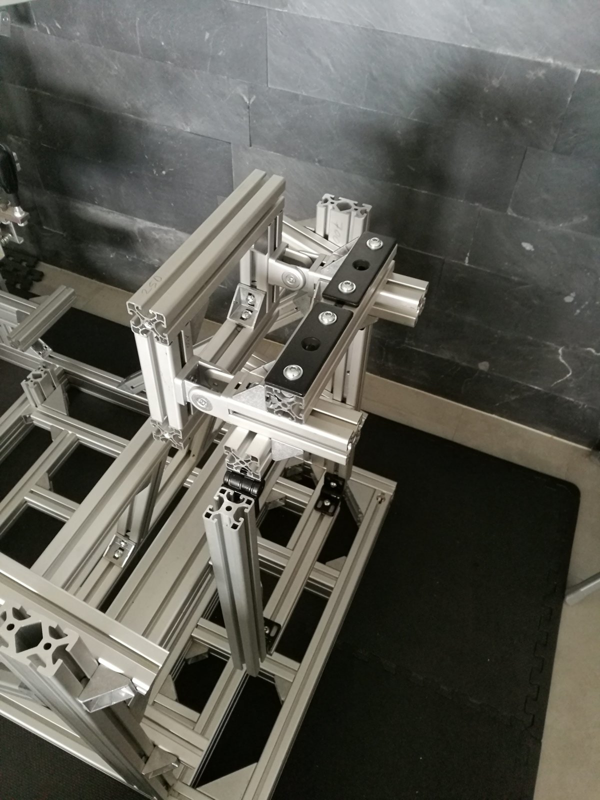

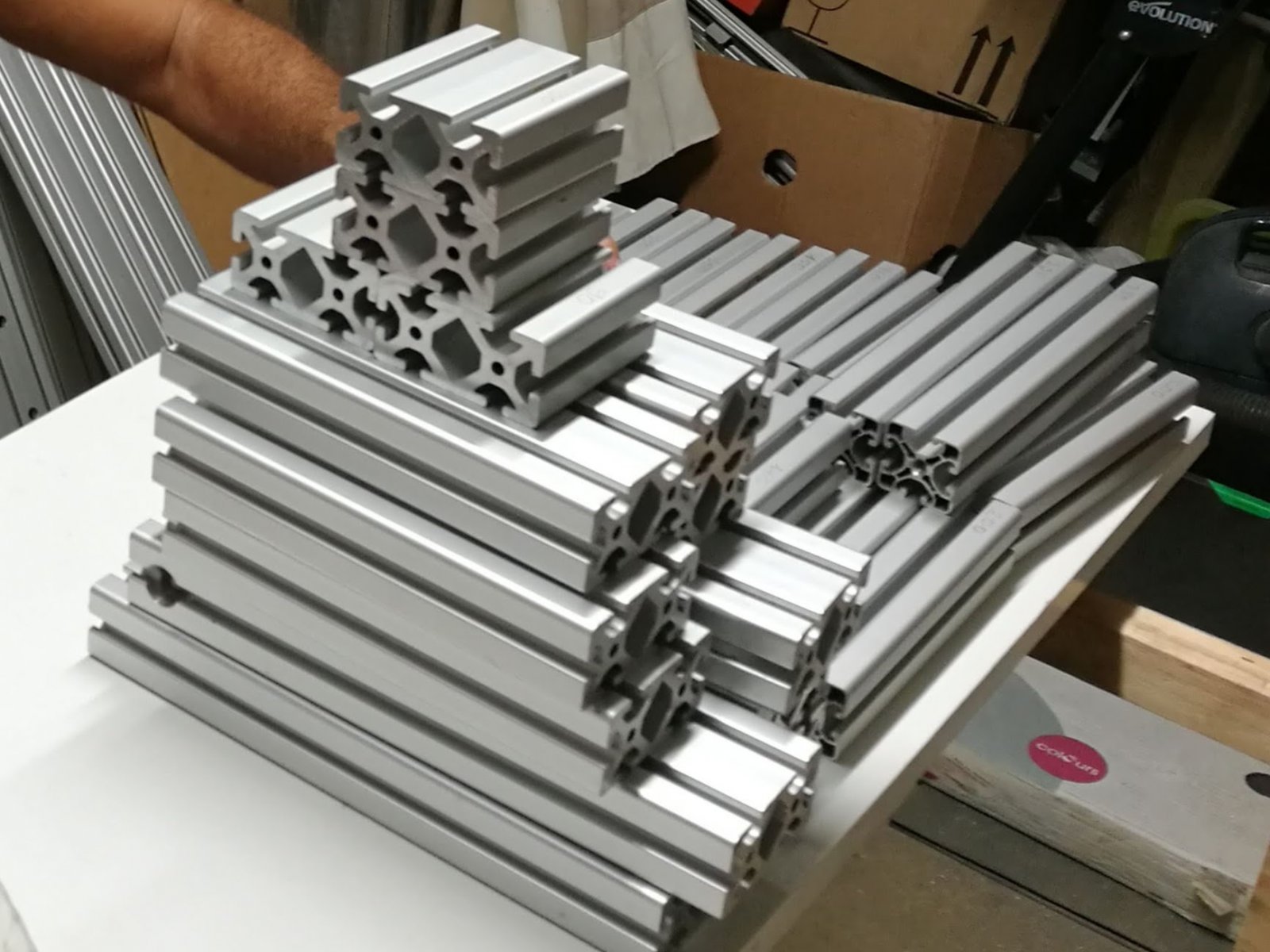

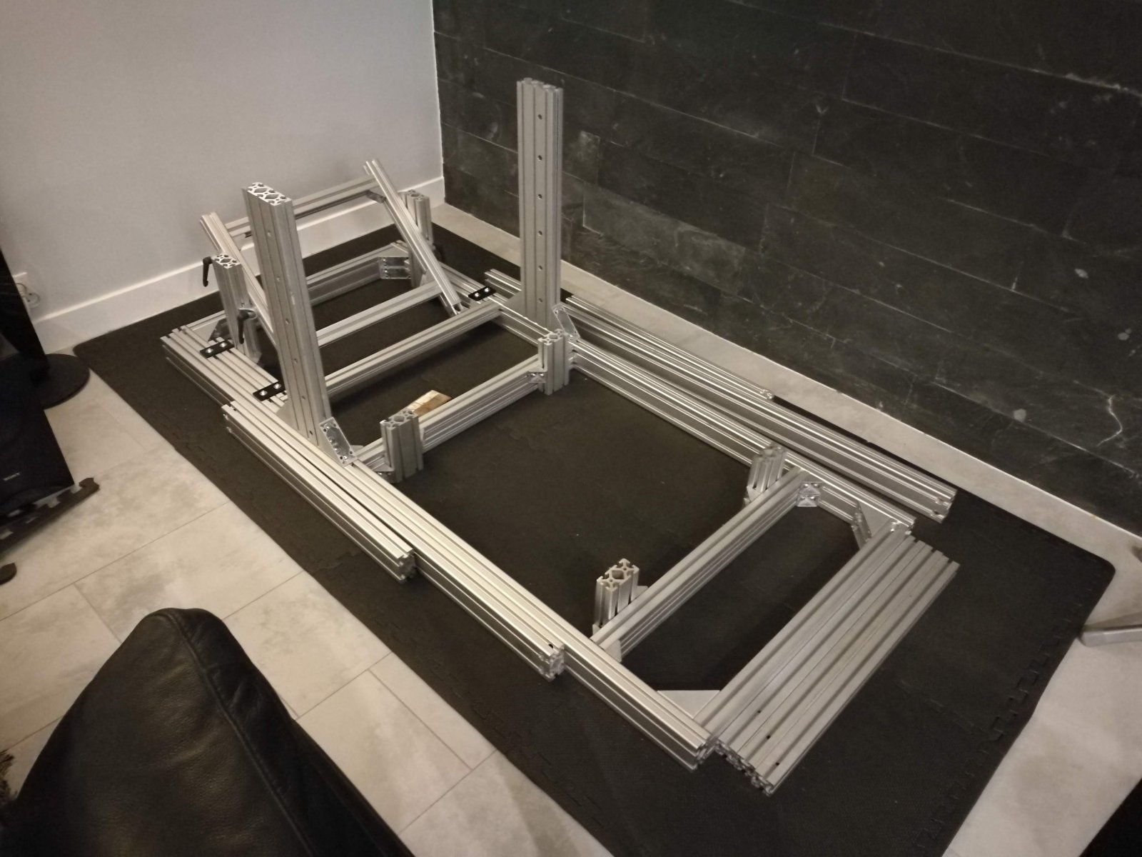

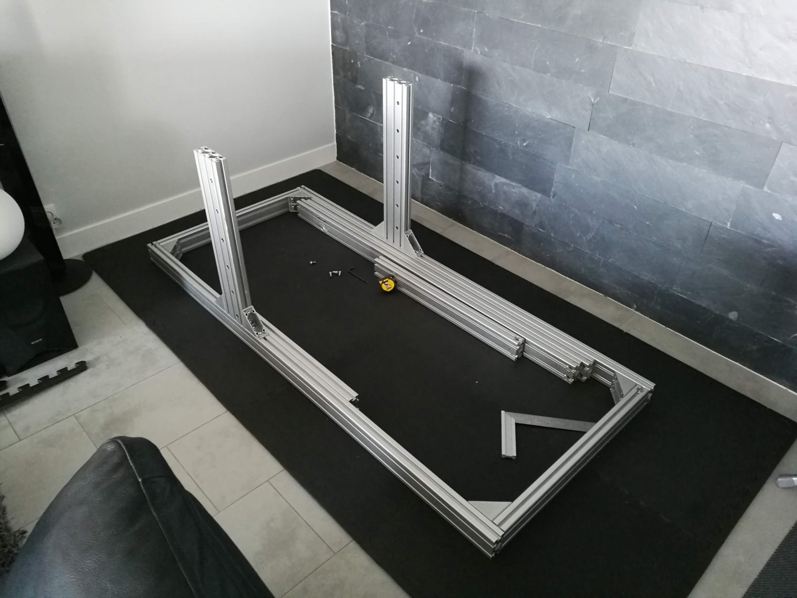

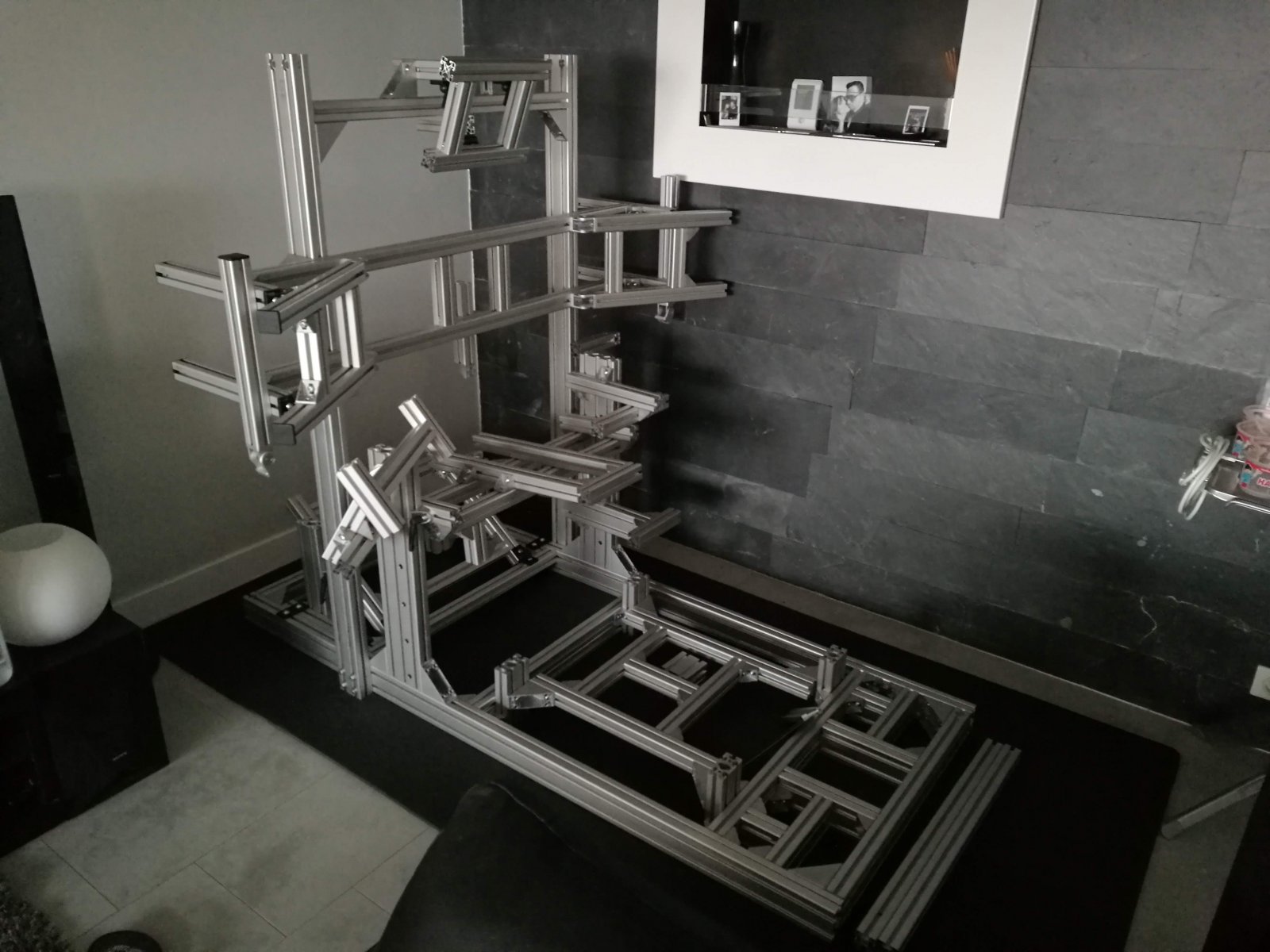

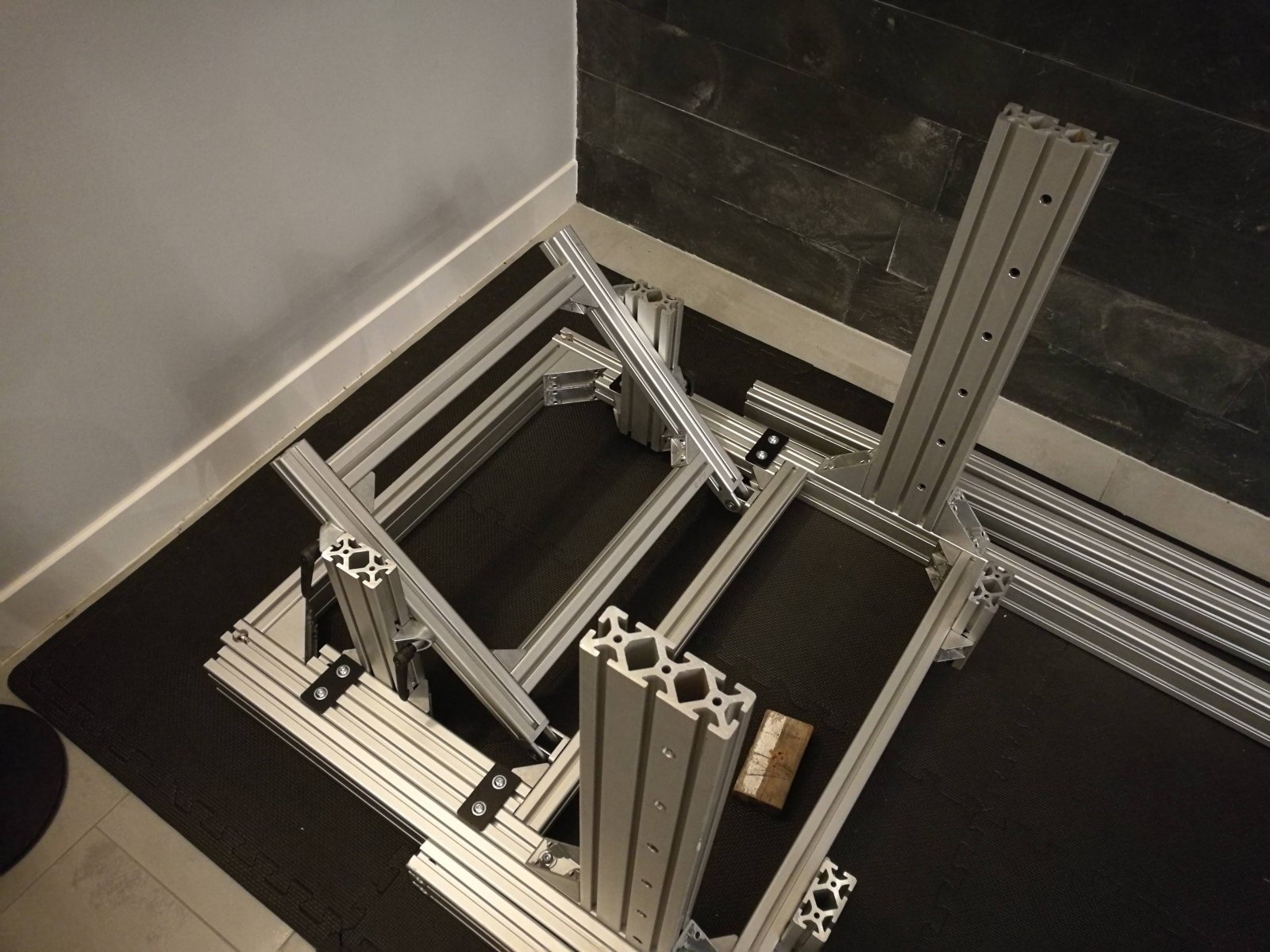

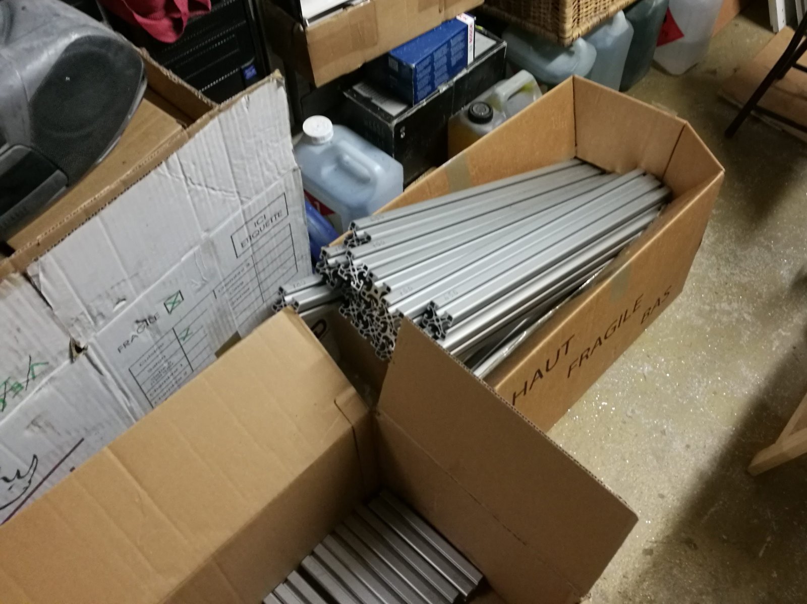

    The beginning of mounting...

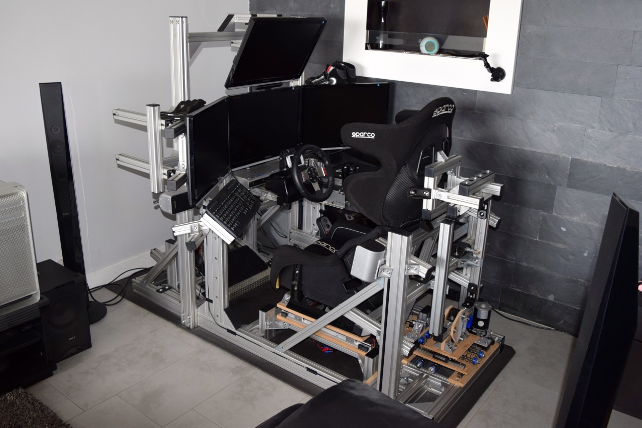

    Triple screen mounted.

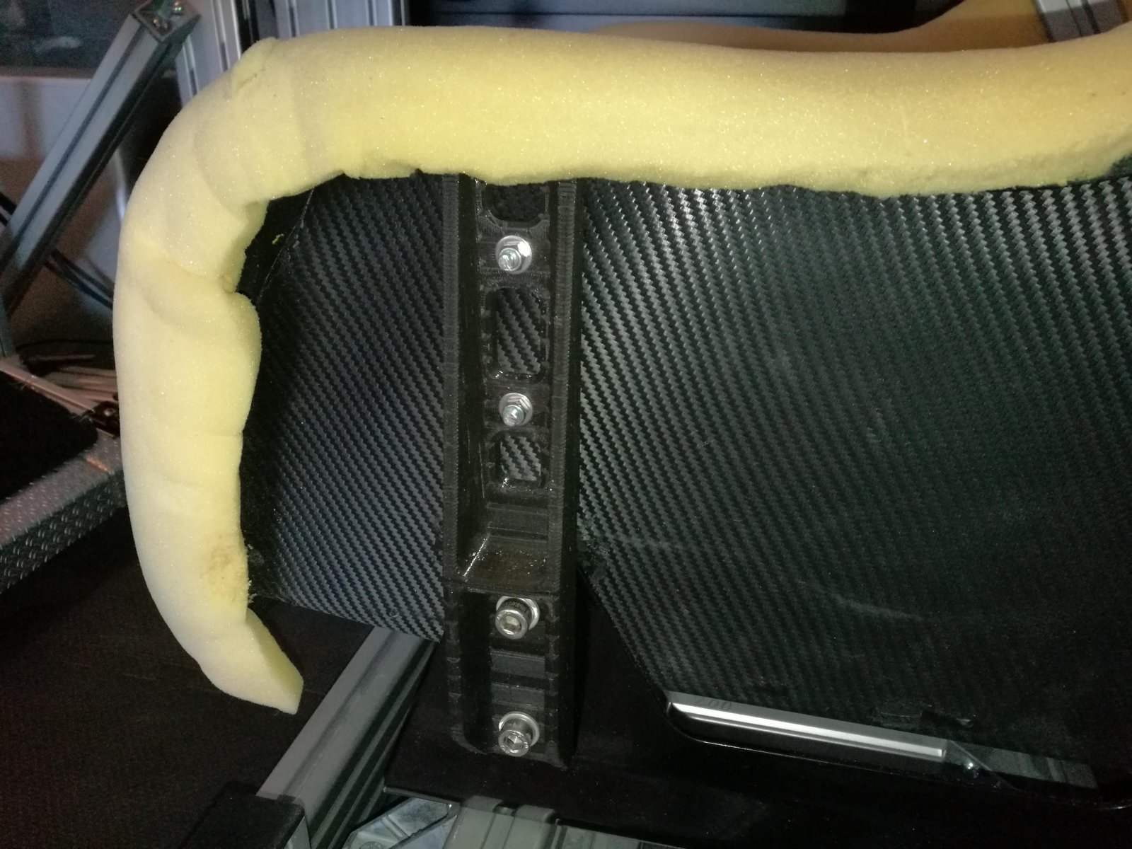

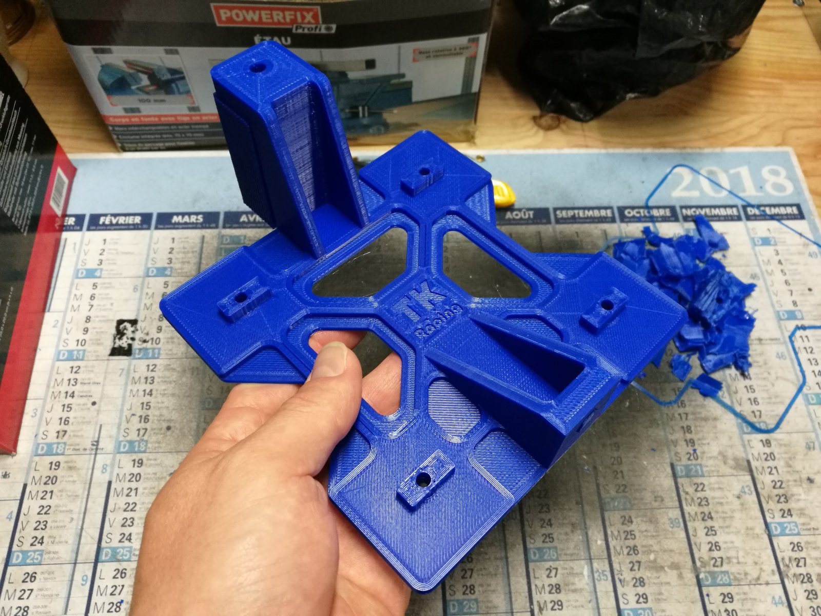

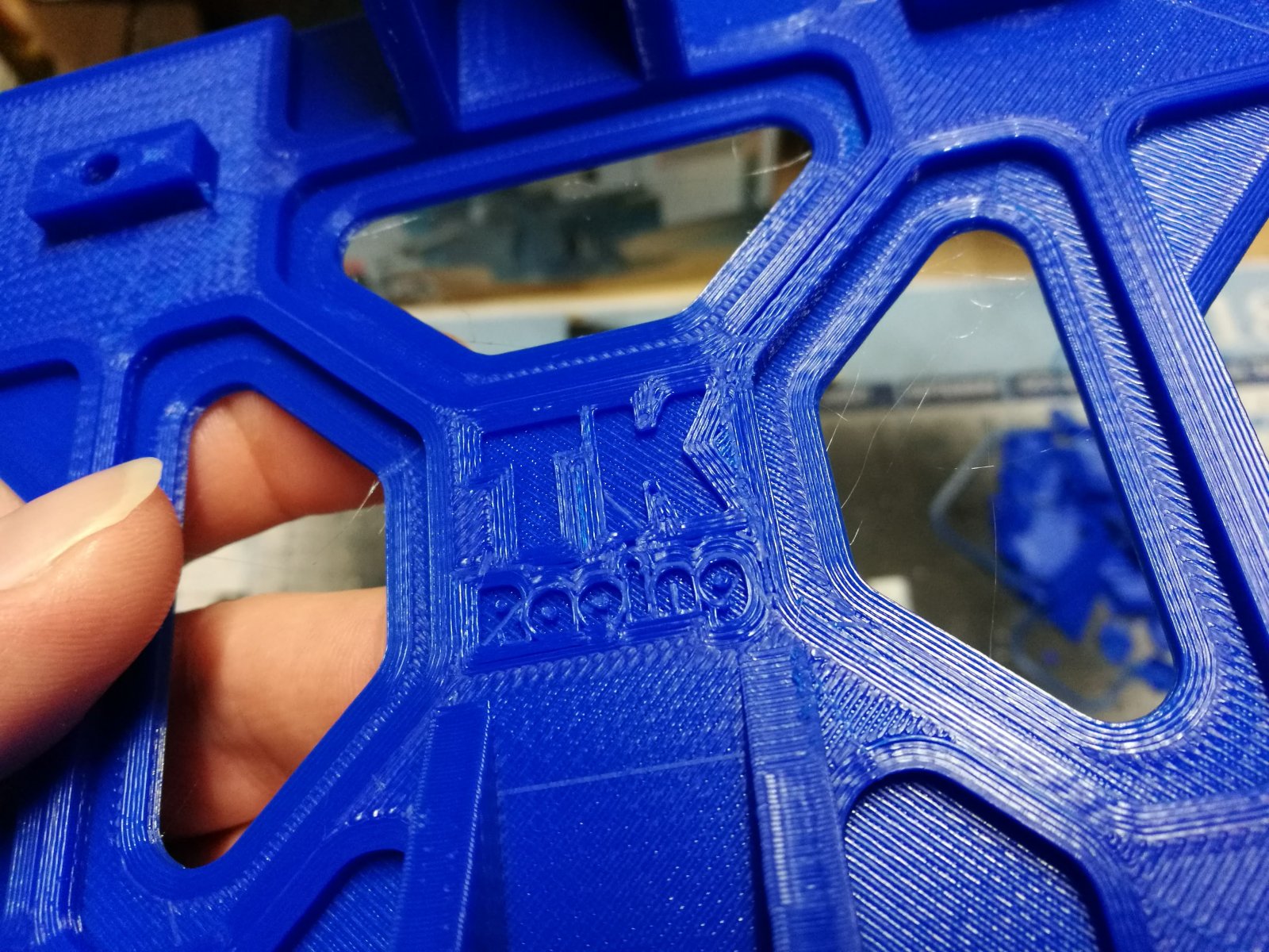

    Some parts printed in PLA or ABS...

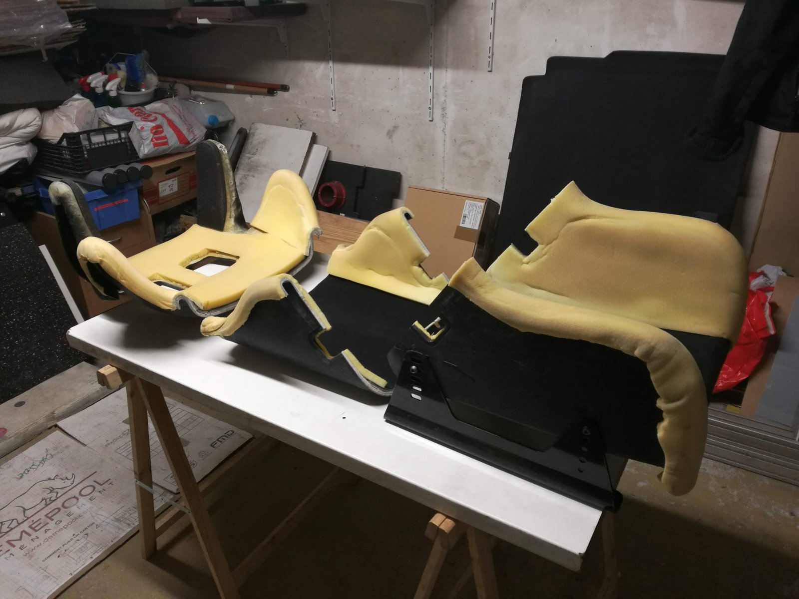

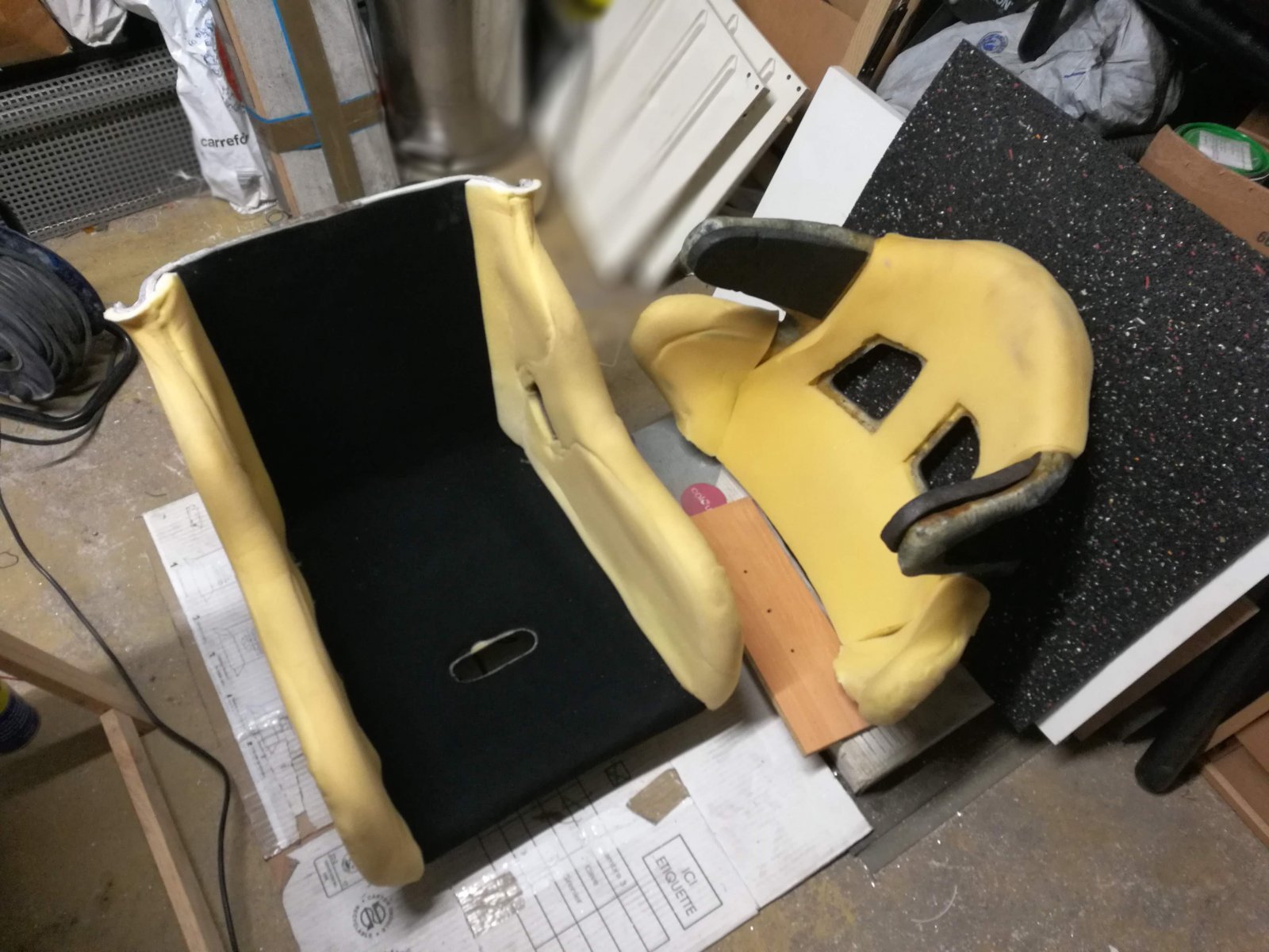

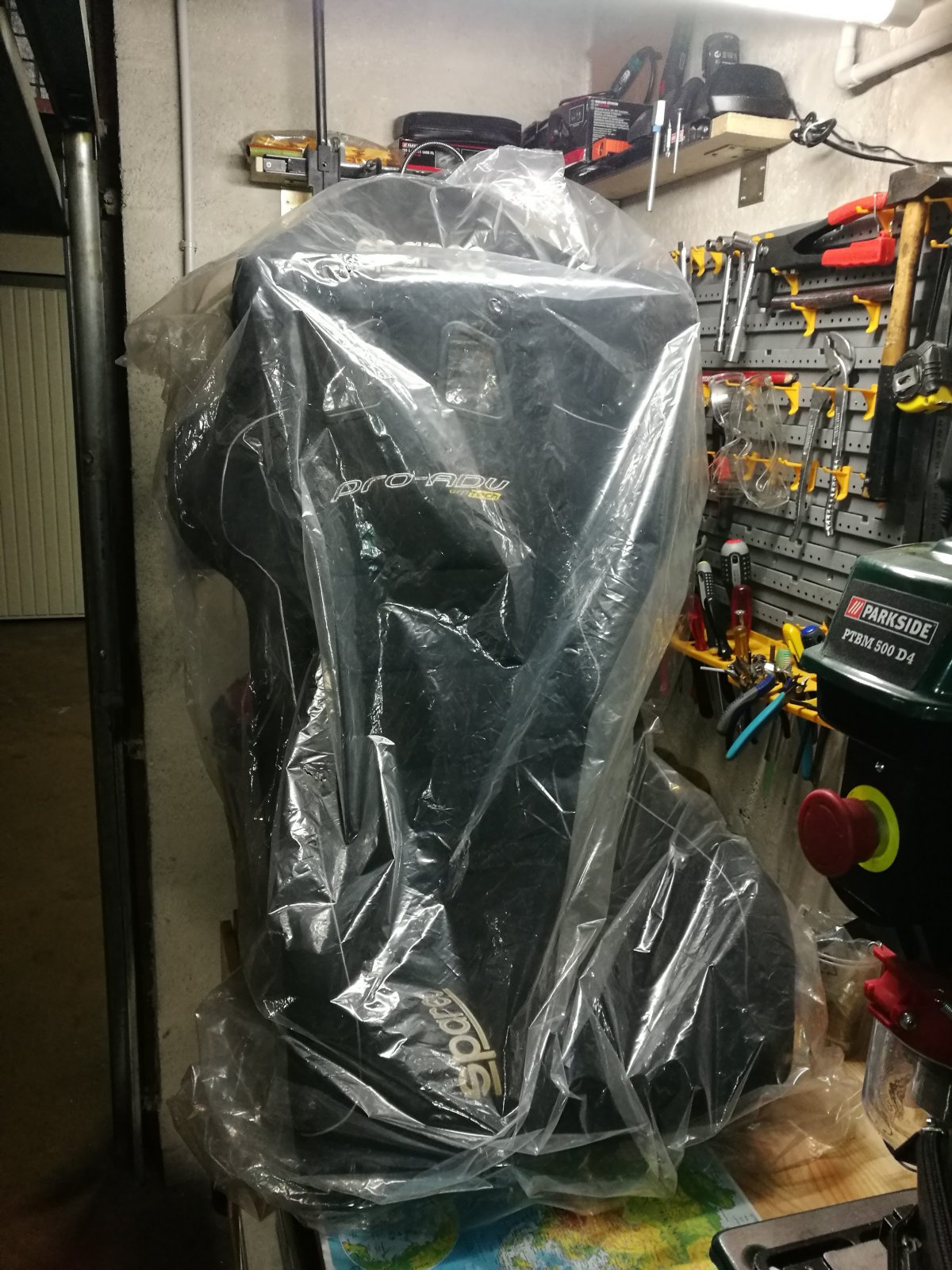

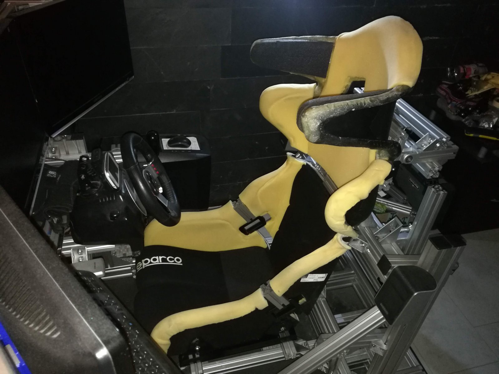

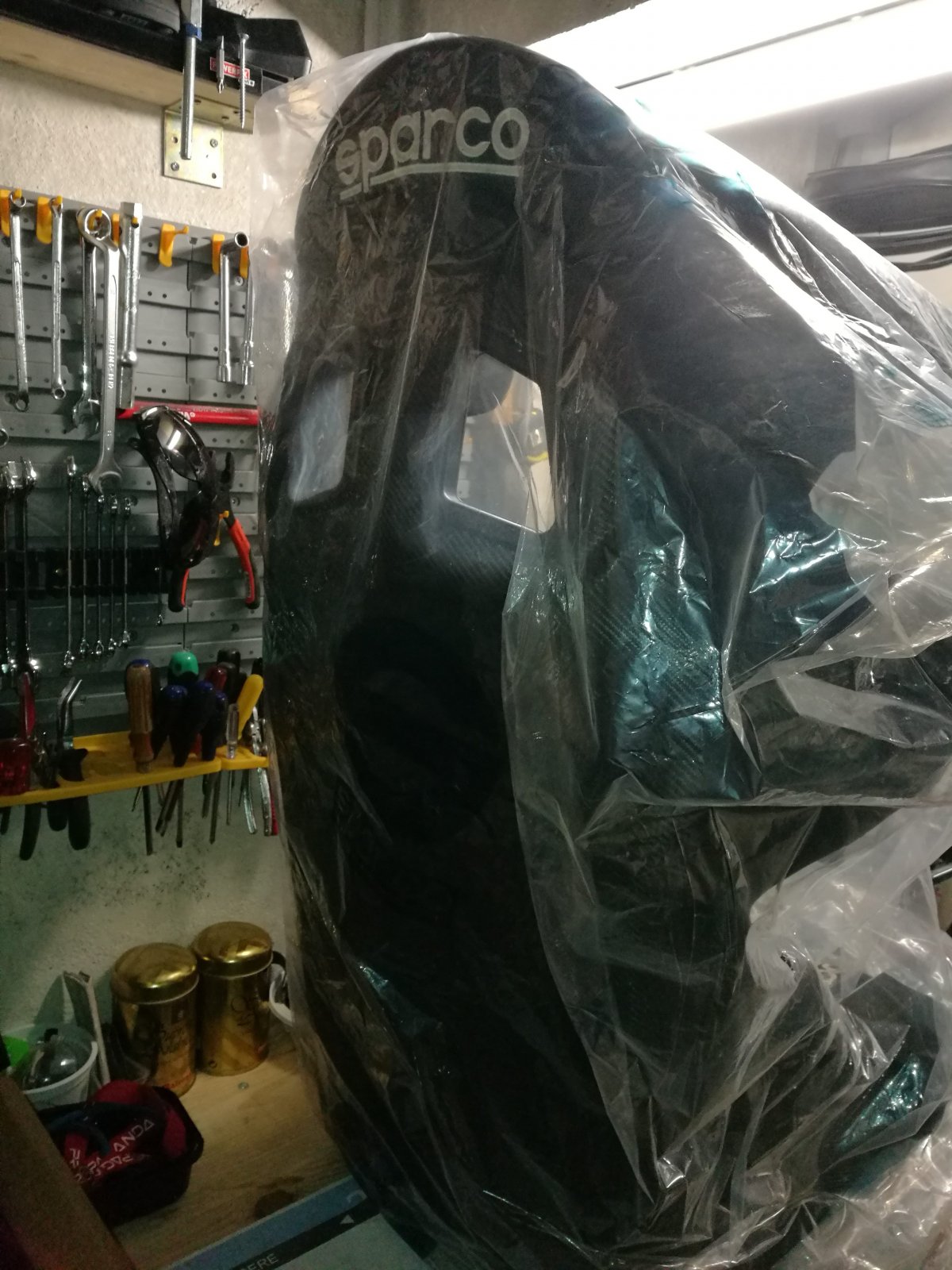

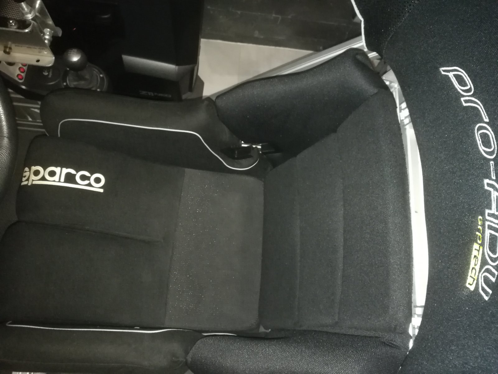

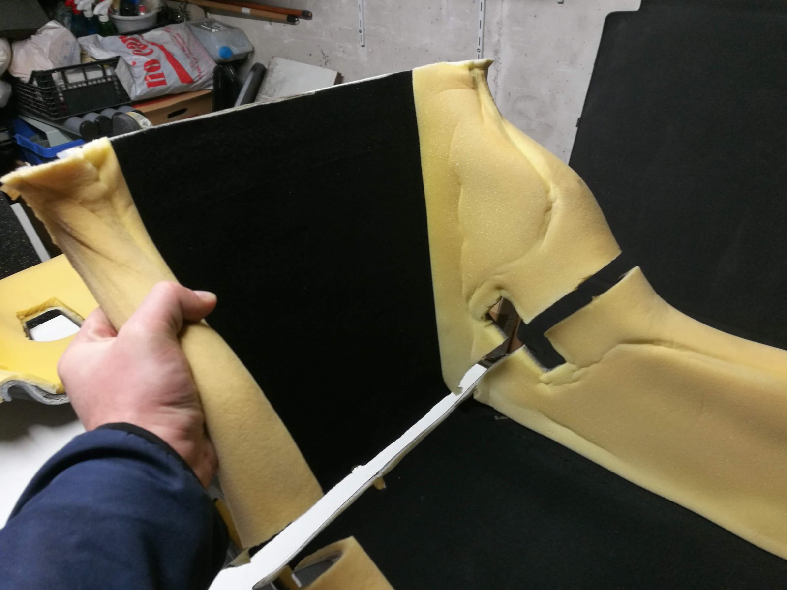

    Rallye refurbished bucket seat...

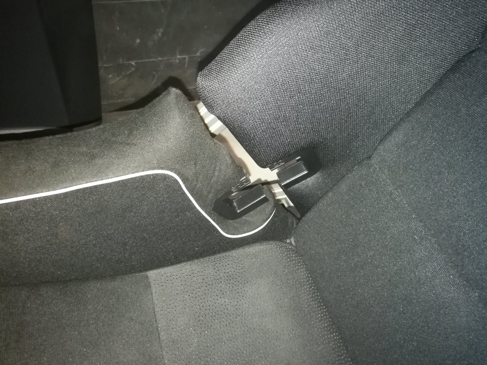

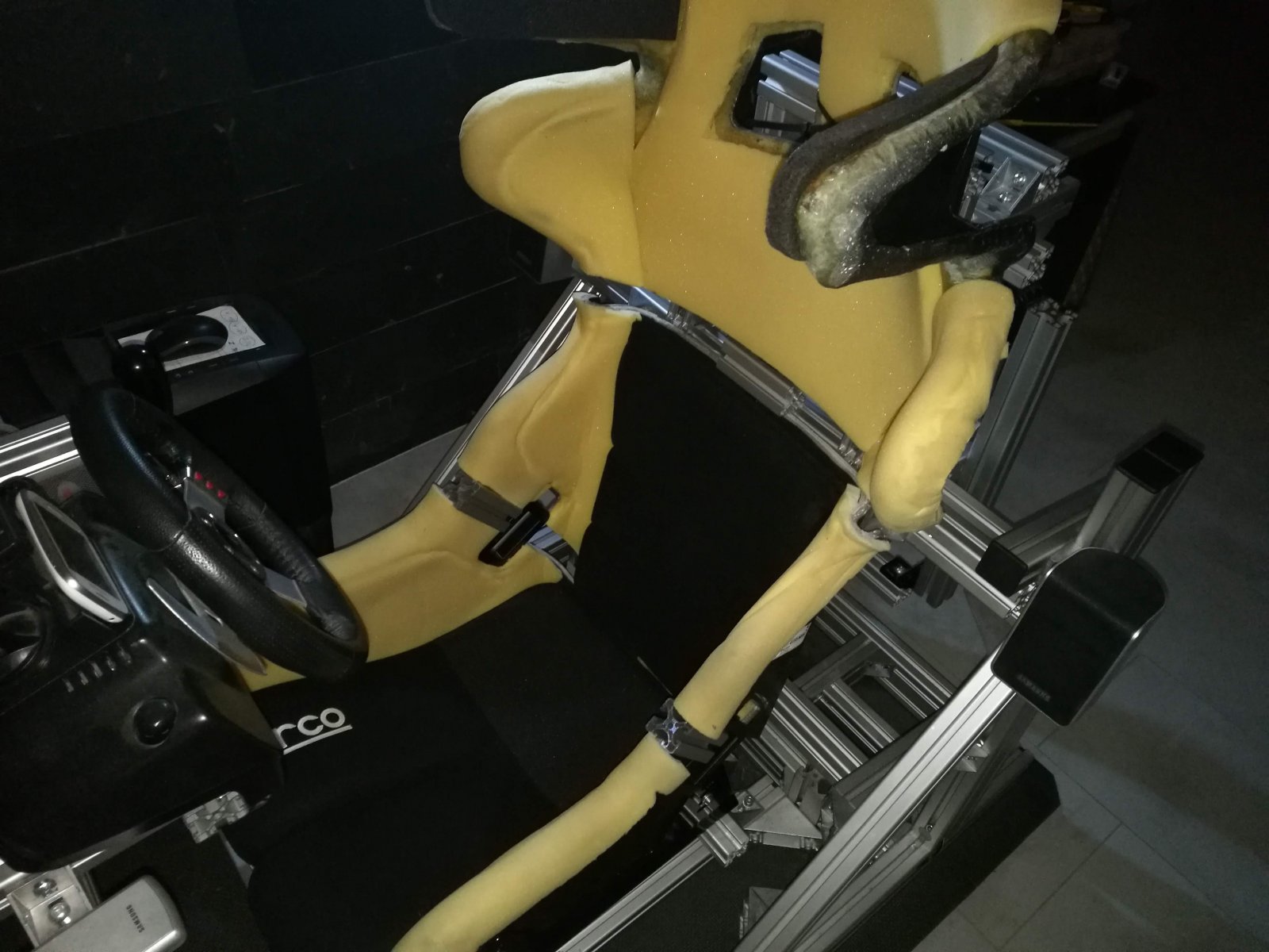

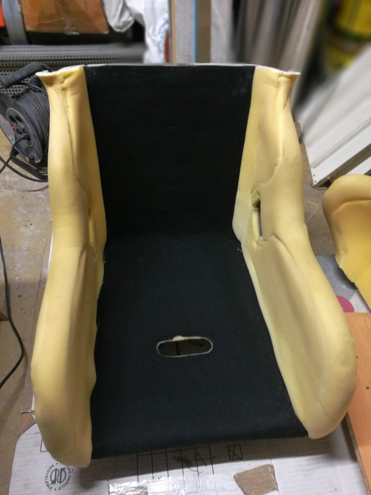

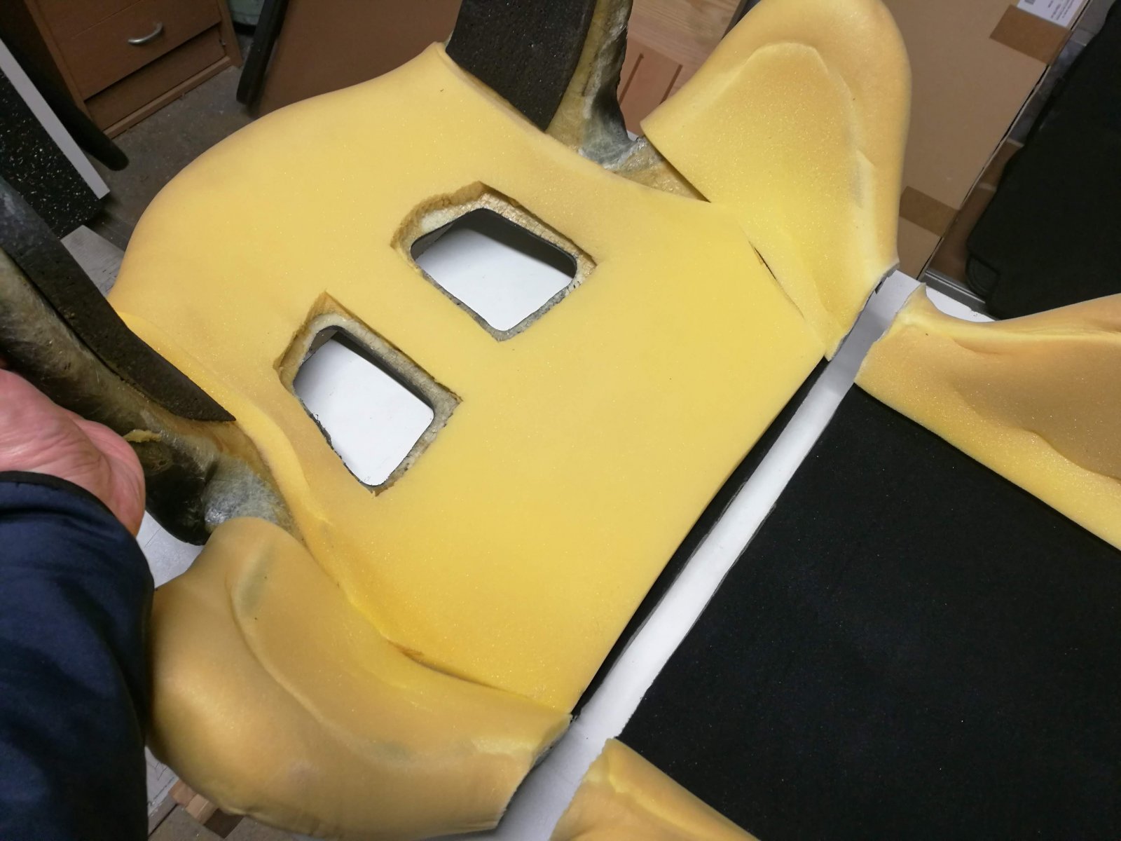

    Heat the saw...

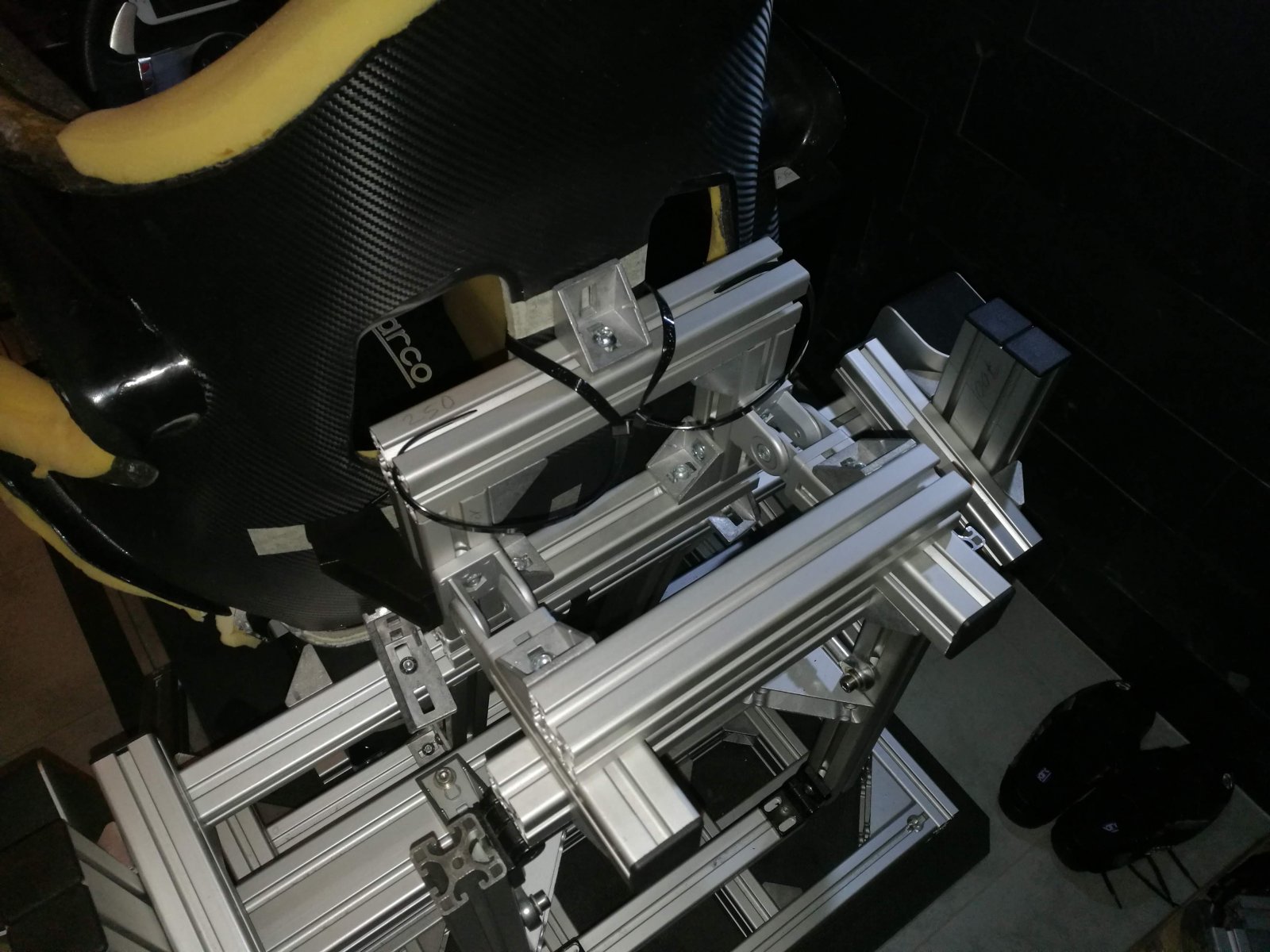

    First mounting on SIMU.

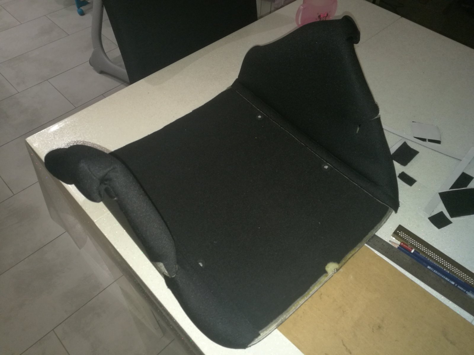

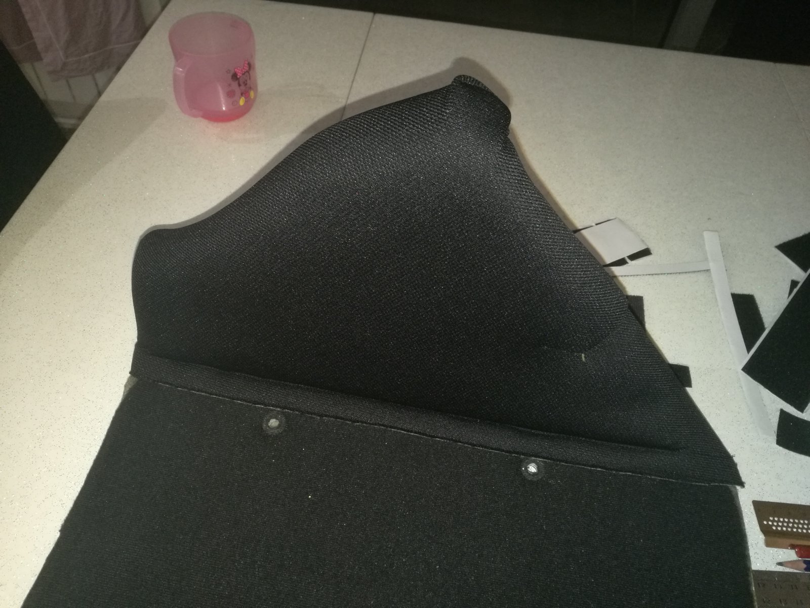

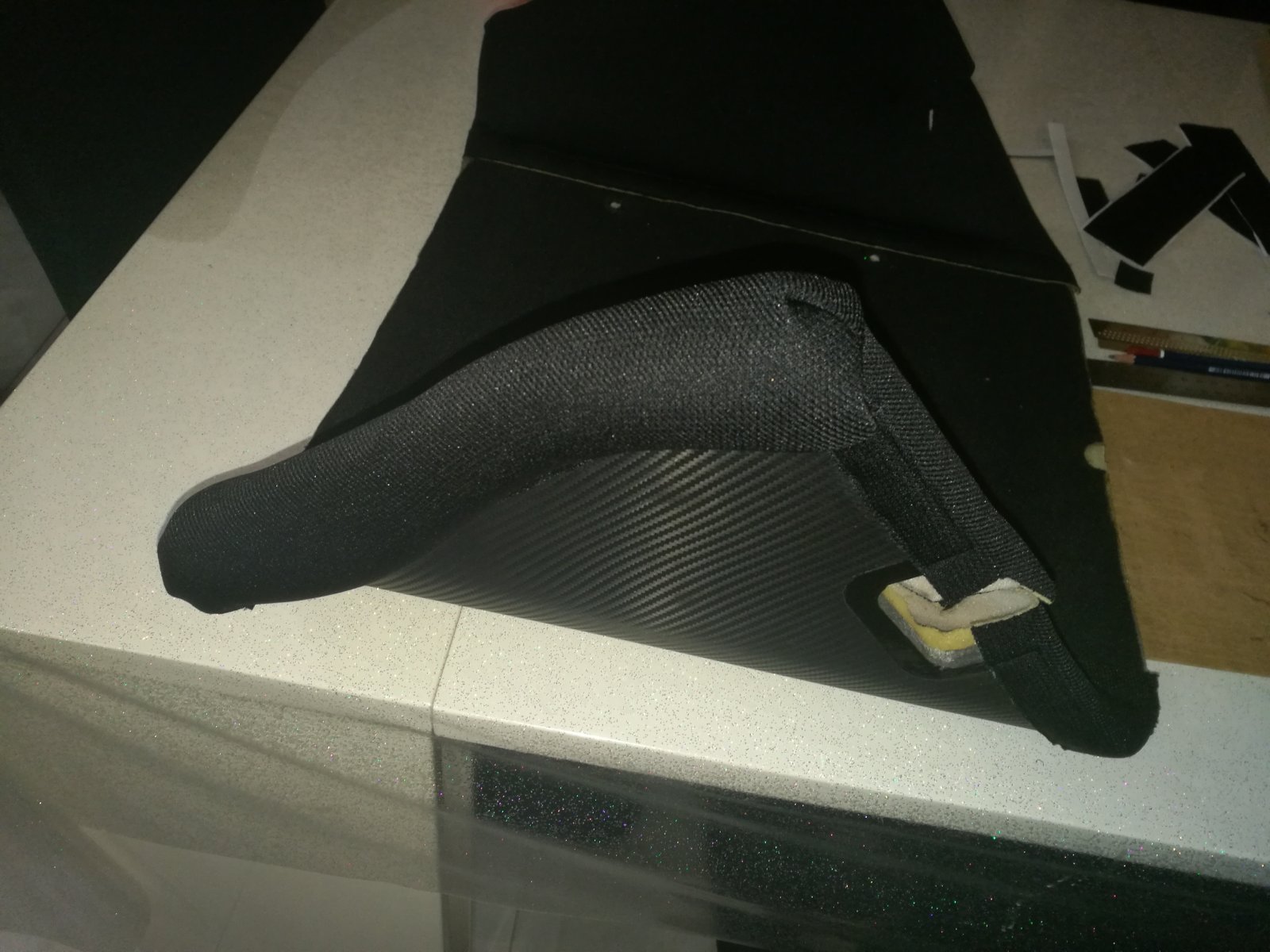

    A little sewing...

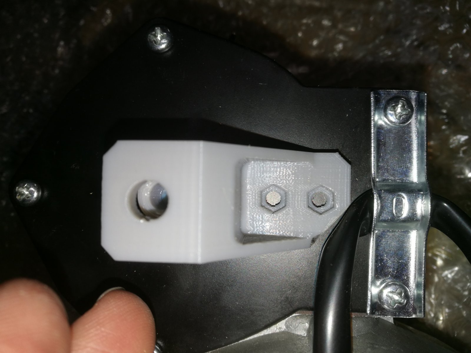

    3x 150w DC motor from CHINA

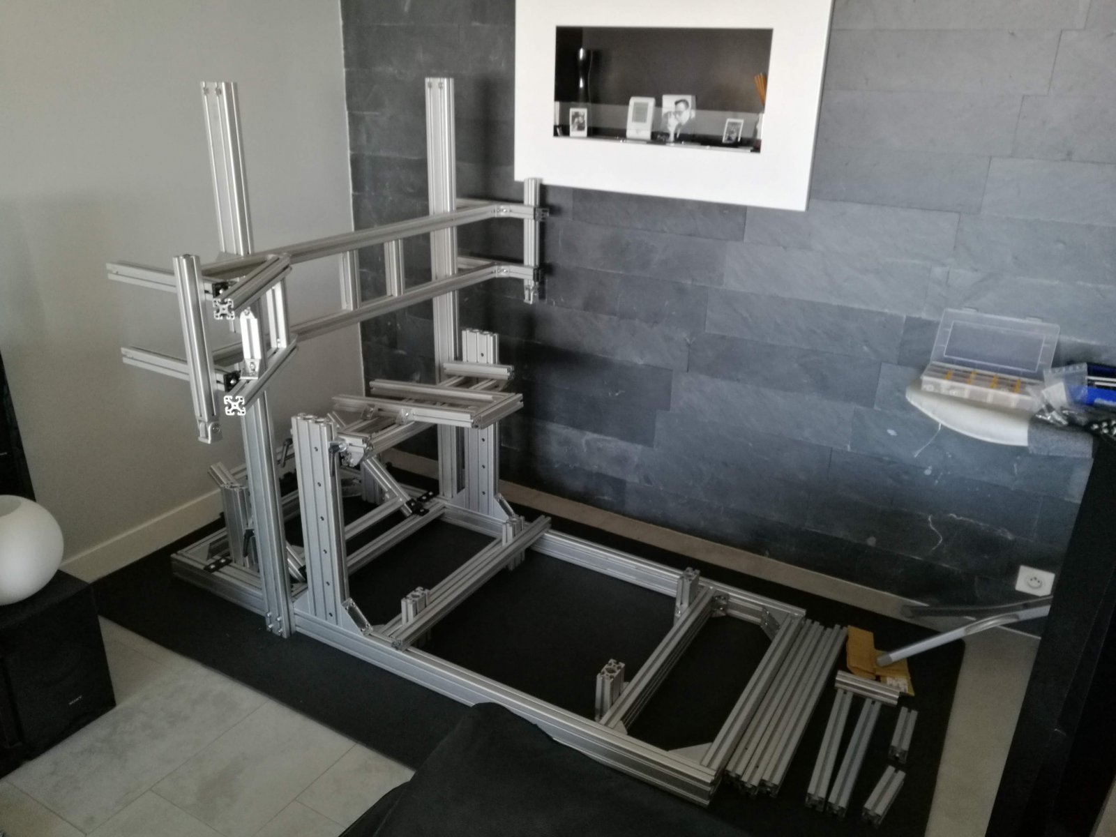

    I continue the construction presentation...

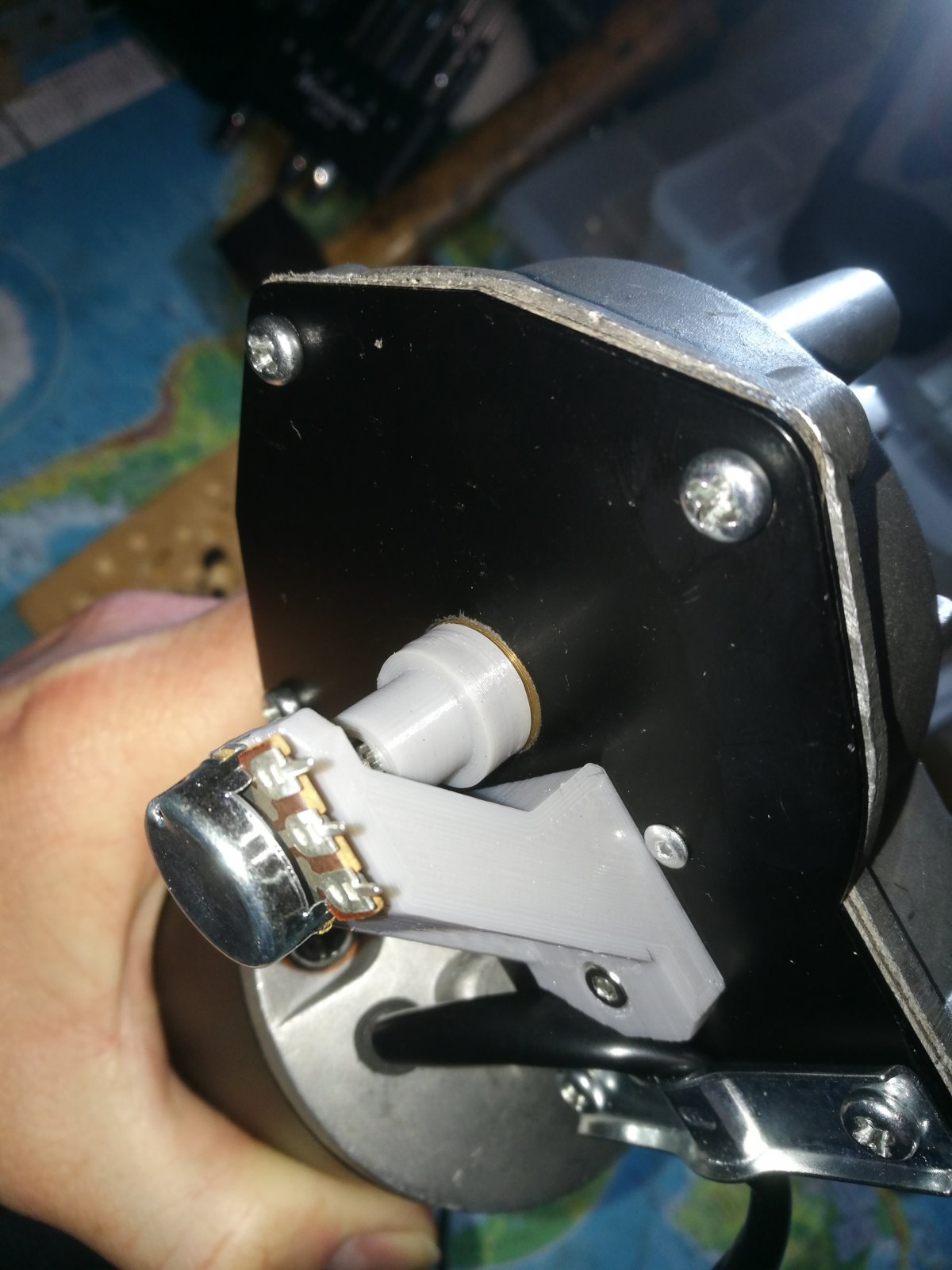

    Motor potentiometers mounting

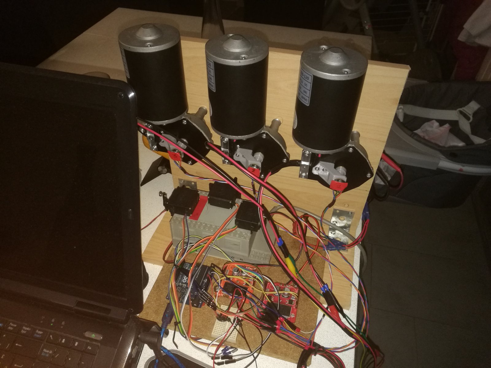

    Real motor on test model (Arduino + Motomonster Shield)
