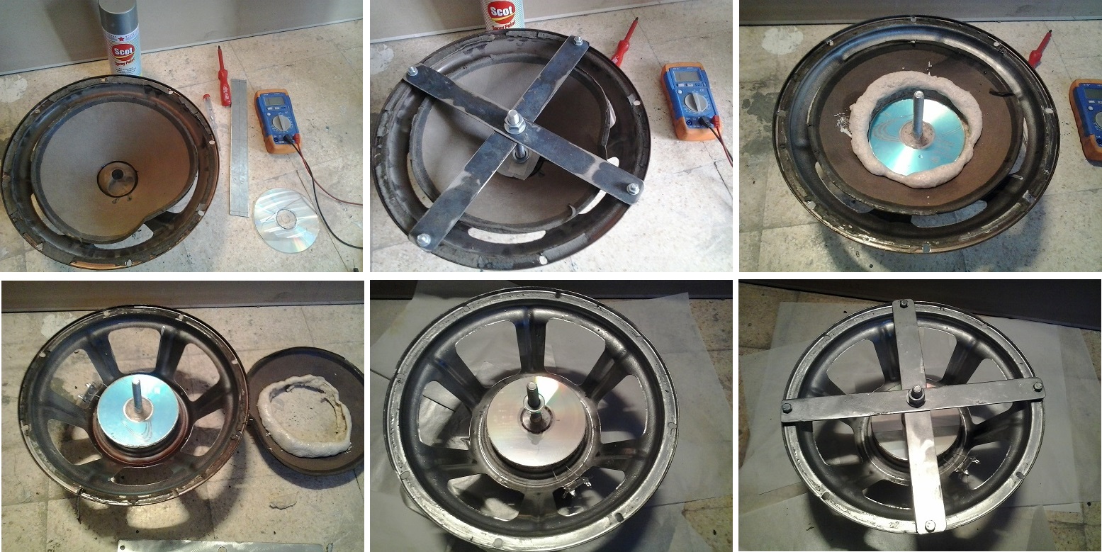

    Hello!
    After a stormy party in speakers diffusers torn, it was a pity to throw out them (it was good "pumped" sound), so I decided to bring them a second life, the pictures can explain technology, after connected to the amplifier at lower frequencies the effect is stunning :thumbs
    - If placed under the fifth point, the effect of immersion in the game ensured.

    - under the fifth point on which everything means we are sitting: - chair, sofa, etc. and you thought about what man? :think
    I use spray foam
    - weight of what ? weight of speaker ? For something to improve the effect, there is an idea to add to the central bolt additional weight.

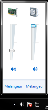

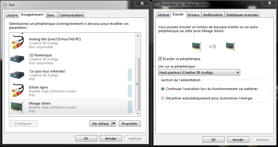

    What I have:
    - a soundcard on my motherboard ("Realtek")
    - and a PCI Soundblaster board ("Audigy")
    What we intend to do:
    -> make the Audigy "listening" the sound stream produced by the "realtek"
    What we get:
    - two distinct control levels

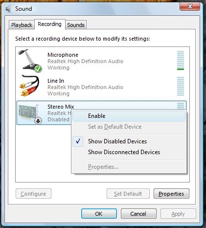

    First:
    1/ you need to enhance the "Stereo Mixer"
    it is located on "Recording" tab
    - update your driver (At first, I didn't and was stuck)
    - in english here: http://www.sagebrush.com/mixtech.htm
    2/ the mixer is bound to my Realtek and I make it listen Audigy sound card
    tada! after some trials and errors (the windows logic maybe weird), it will work!
    Mat
