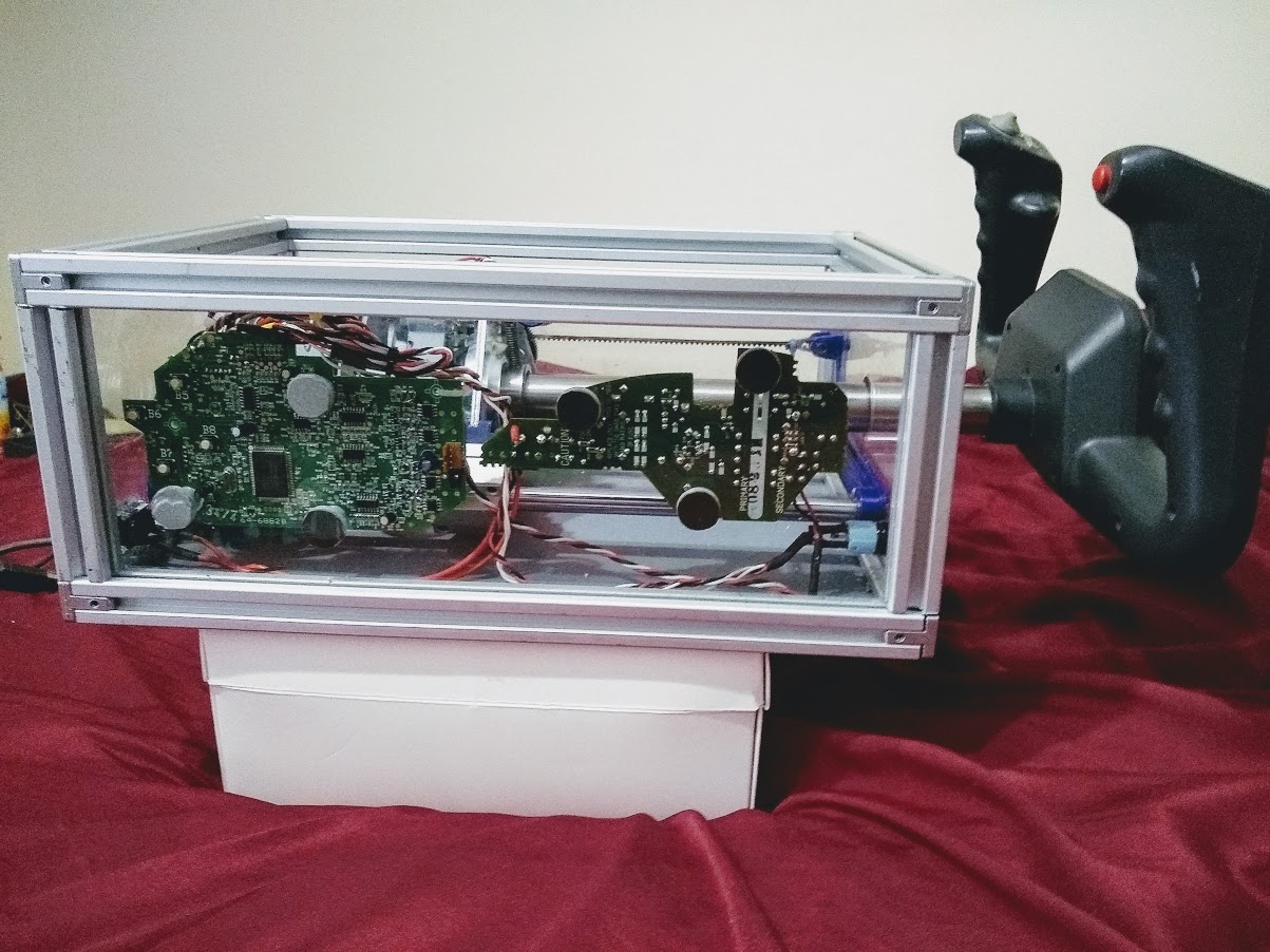

    I wanted to share my experience in building Jay's FFB flight yoke adapted from Microsoft's Force Feedback Joystick.
    It works really well and the build is not that hard to do.
    Jay has a website with all the info you need to build it.
    He has 2 videos on you tube and a 3rd animated presentation that you can actually take measurements from .
    My hope here is to maybe enhance his instructions and help with any questions.
    You do need the correct Microsoft FFB2 Joystick to start out with.
    There are several versions being sold on Ebay but only the latest version is useable.
    The one you need must have a USB cable and a 110vac -220vac power cord.
    It is also the most expensive of the 3 versions. Typically $100 USD.
    You will need a 3d printer to make a dozen or so parts.
    And close to $100 in belts,bearings,rods and screws.
    You end up with a $1200-$1800 device.'

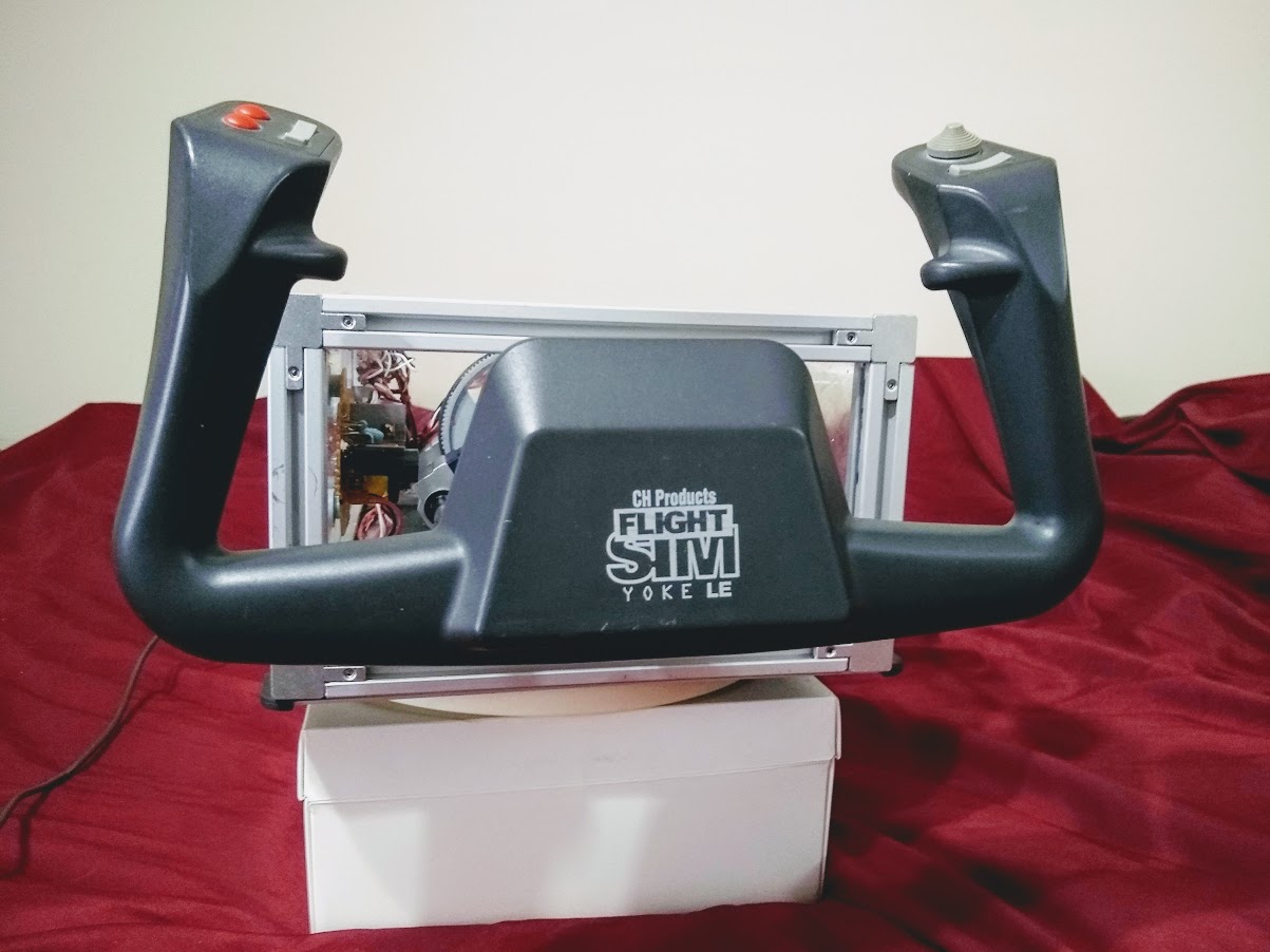

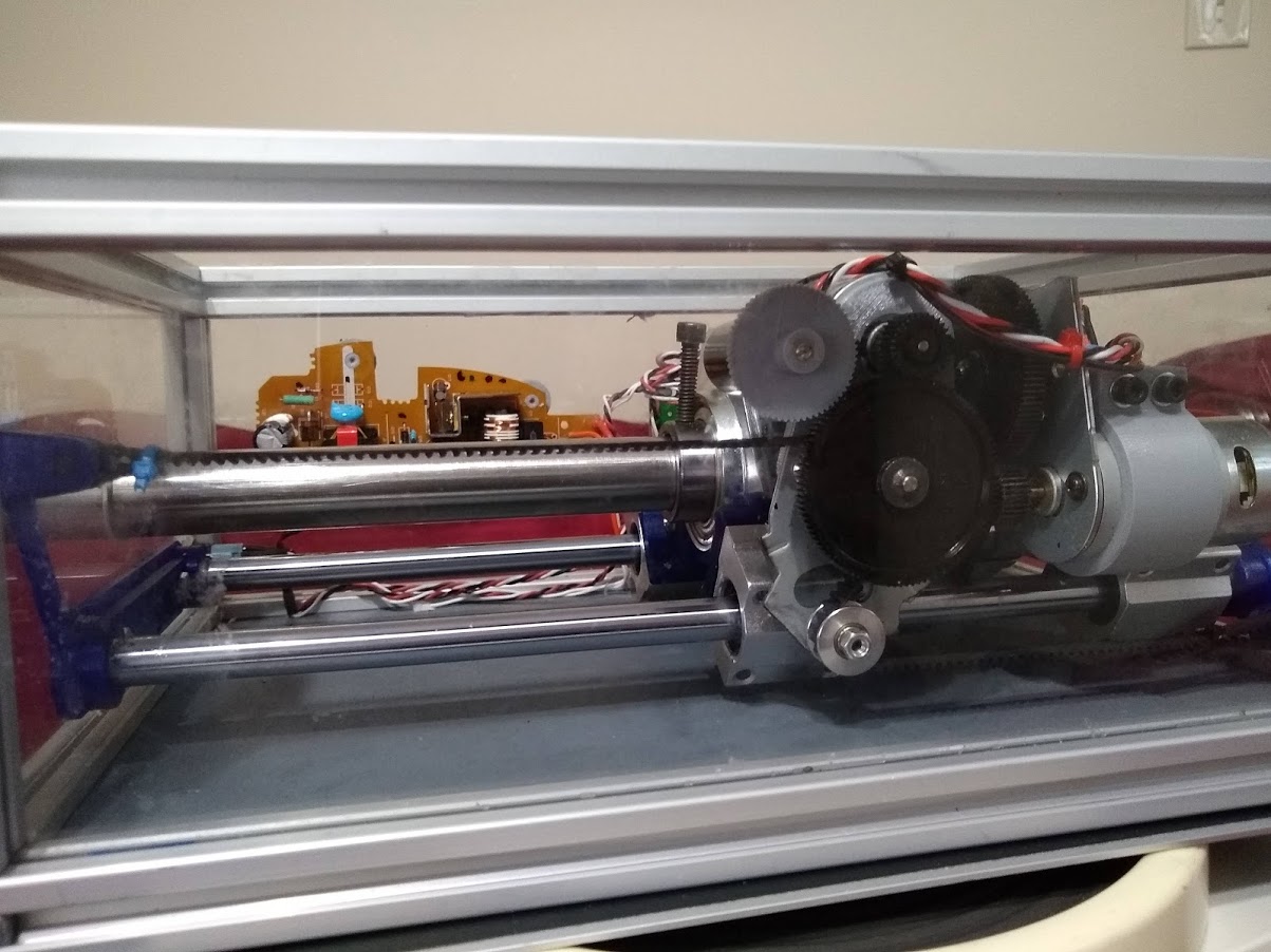

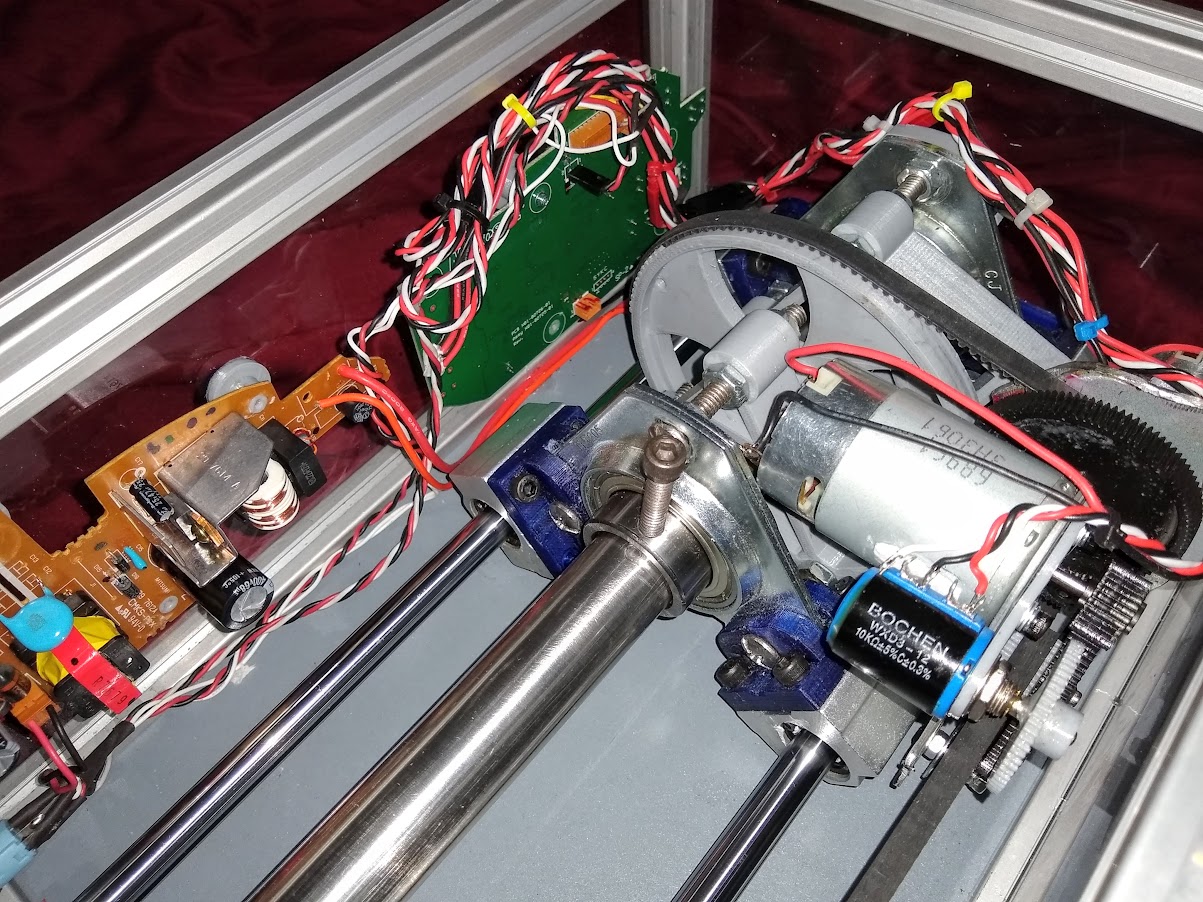

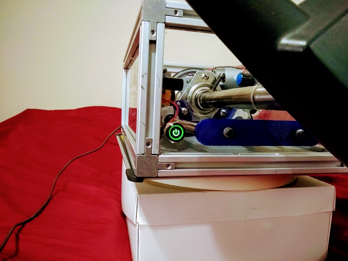

    My build with using 20mm extruded aluminum and 6mm clear plexiglass.

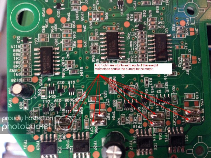

    A simple resistor modification doubles the power of the motors.
    The yoke has about 160mm of travel.

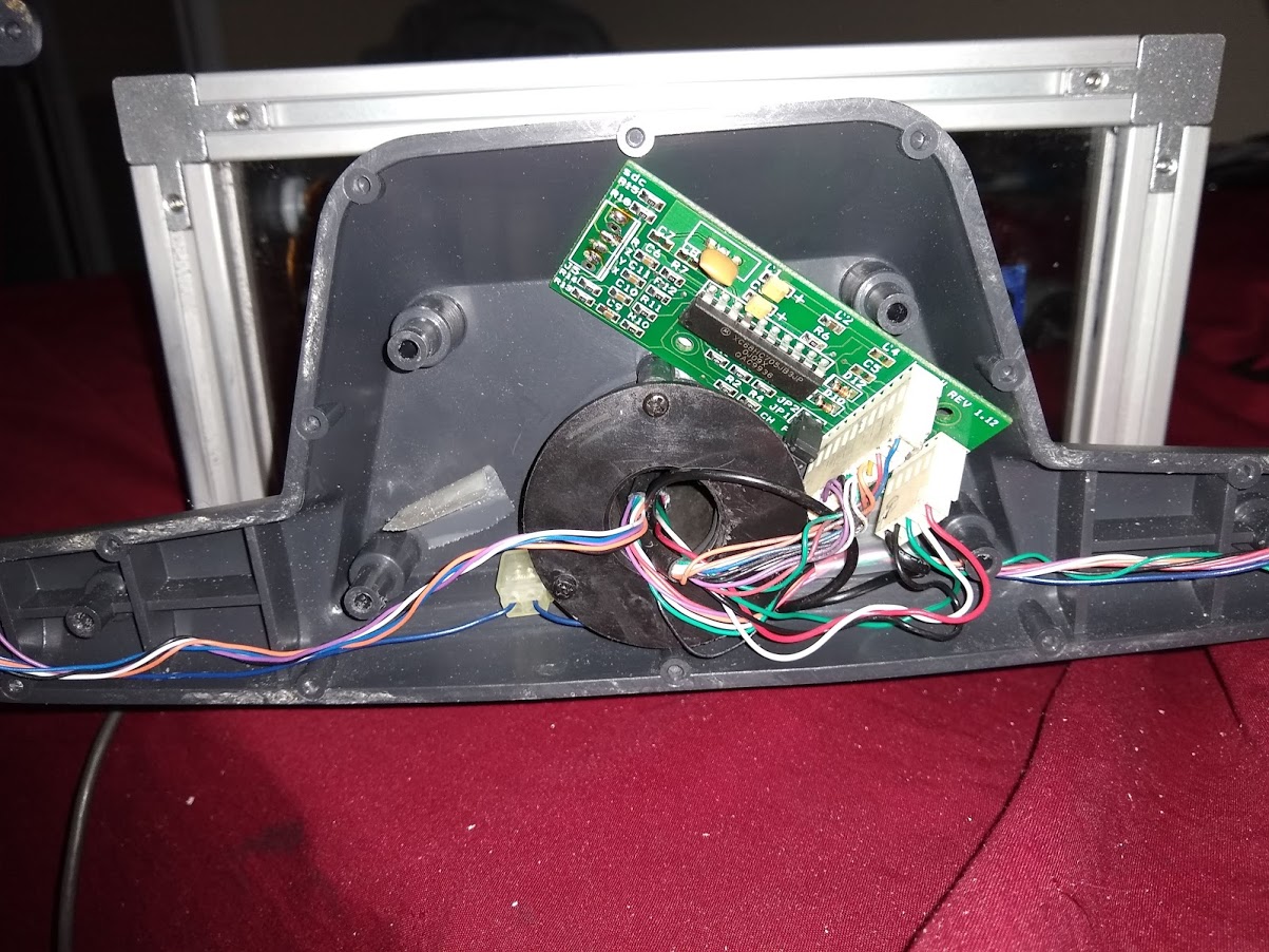

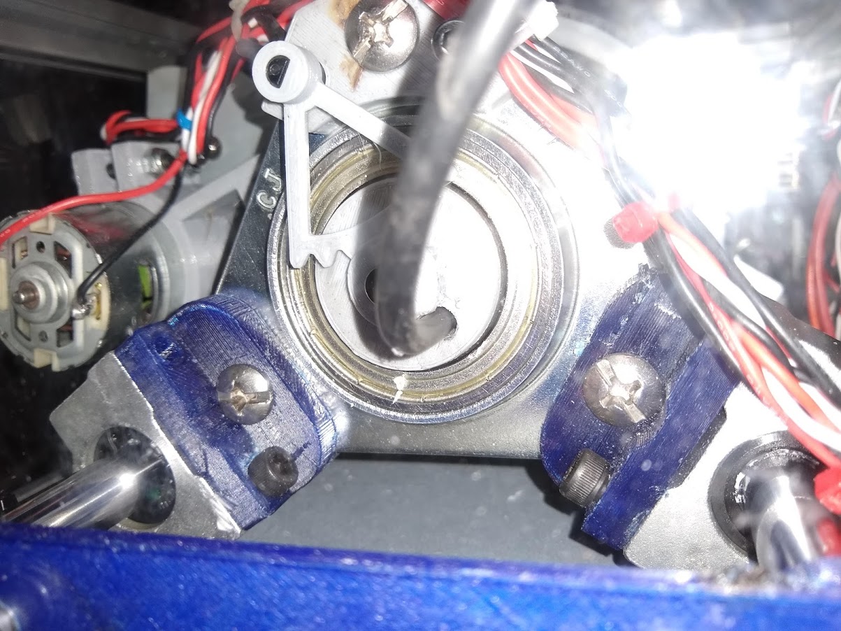

    The yoke switches can be activated by moving the CH Yoke's usb board right into the yoke. It fits no problem. It is best to release the pins on the plastic connector to ease snaking the wires through the outer box/ rear gear assembly and through the 25mm tube. You will now have 2 usb cables to hook up but that is the easy part....

    Thank you for the additional info on Jay's FFB yoke project!
    Can you share the resistor mod you spoke of to make the motors stronger?
    Thanks,
    Bo
  6. T R Para
    T R Para i make stuff up
    Oct 18, 2018
    385
    Cincinnati, Oh
    2,446Coins
    +358 / 3 / -0
    AC motor, 6DOF
    Sure.. There are 8 one ohm resistors that are used for sensing the motor current.
    These are smt chip resistors.
    There are 2 of the one ohm resistors in parallel on the circuit board for each of the 4 motor driver IC chips.
    The mod is to add 8 more 1 ohm resistors in parallel to the existing 8 one ohm chip resistors.
    example.. there are currently 2 one ohm resistors in parallel for each motor driver chip which equals .5 ohms... if you parallel an additional 1 ohm on to each of those 8 chip resistors you will get .25 ohms effective current sense resistors per motor driver chip.
    This effectively doubles the motor output torque.
    It does still stay within the specs of the driver chips...
    I have modded about 5 of these boards and used sever different sized resistors.
    But in the end they always equaled out to about .25 ohms..

    Out of curiosity, what did you end up buying exactly to solve your issue with the 25mm OD tube and the triangle Pressed Steel 3 Bolt Bearing & Housing?
    The shipping from the UK is killer on these items, and I'd rather source them from North America or China if possible.
