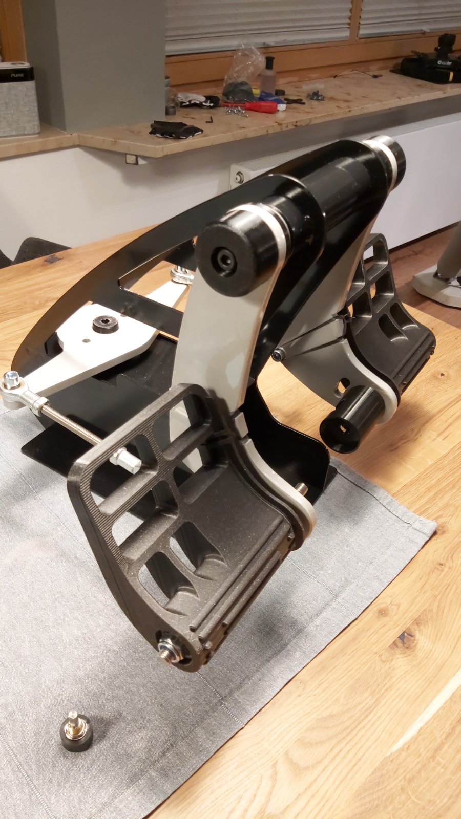

    Thank you sooooo much for sharing the links here! Last year I started FFB rudder pedals. As a motor controller I used the "moteus" bldc servo controller. Everything was working well, but the forces have been little too low for Rudder pedals and I didnt like the noise comming from the motor and controller. So currently I use the pedals without FFB. The Odrive solution shown in the link is a new chance - so thanks again!

    Ah..yes..this was also a source of inspiration for my rudder pedals. Here in the assembly stage some months ago. It works so good in my sim.
  5. Tehrawk
    Tehrawk New Member
    Feb 27, 2021
    22
    168Coins
    +28 / 1 / -0
    That looks really nice. How did you machine the metal?
  6. PeterW
    PeterW alias Wickie
    Oct 21, 2018
    199
    Dipl. Ing. Mb (FH)
    1,609Coins
    +361 / 3 / -0
    I have acces to the Makerspace in Garching nearby Munich, Germany. They have a waterjet-cutter.
    But for a maybe future version I would order the parts in one of the online CNC shops. At the end this will be the cheaper solution...
