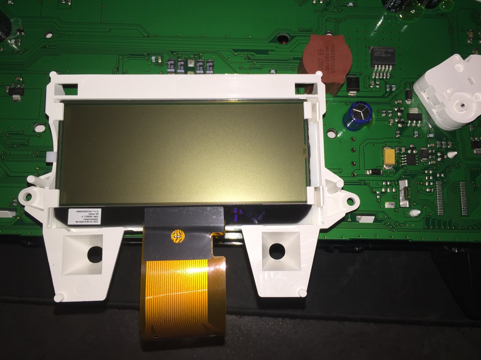

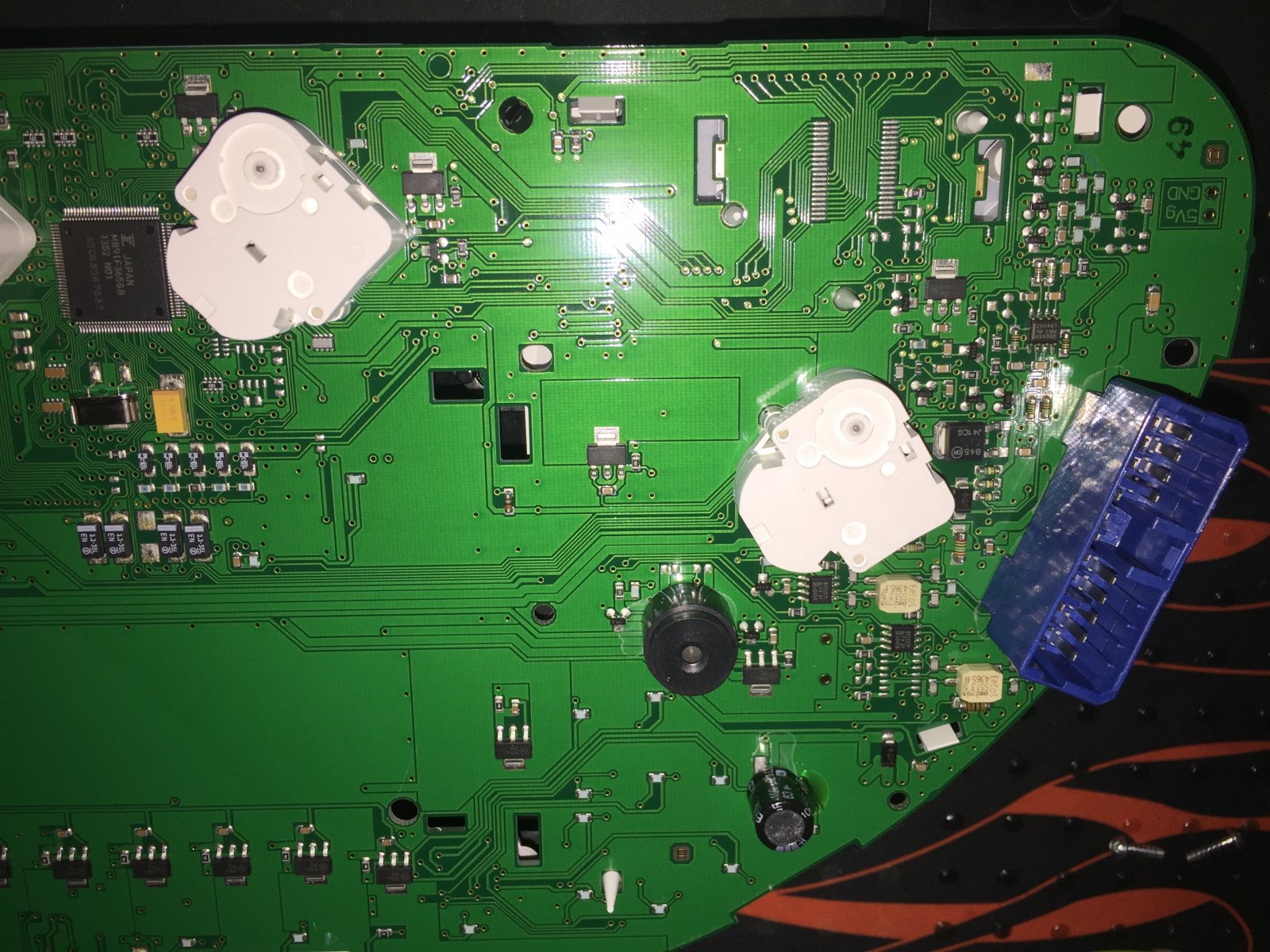

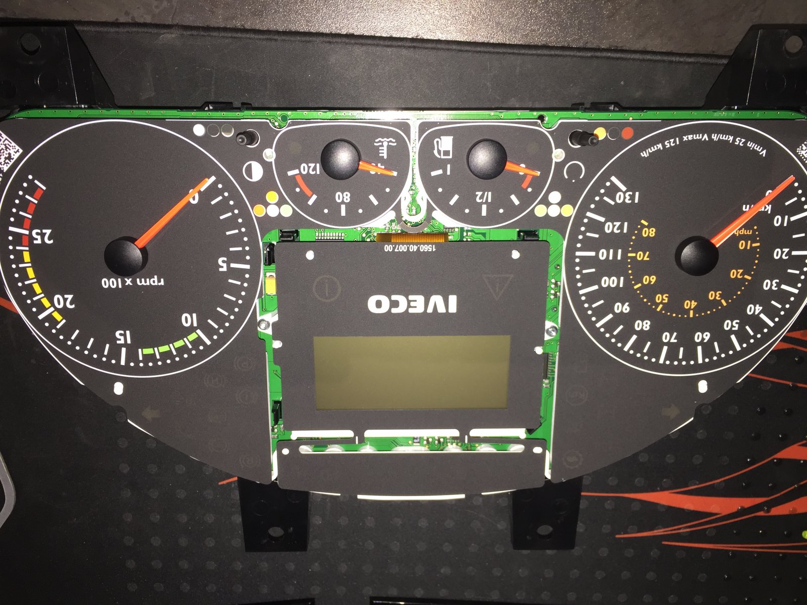

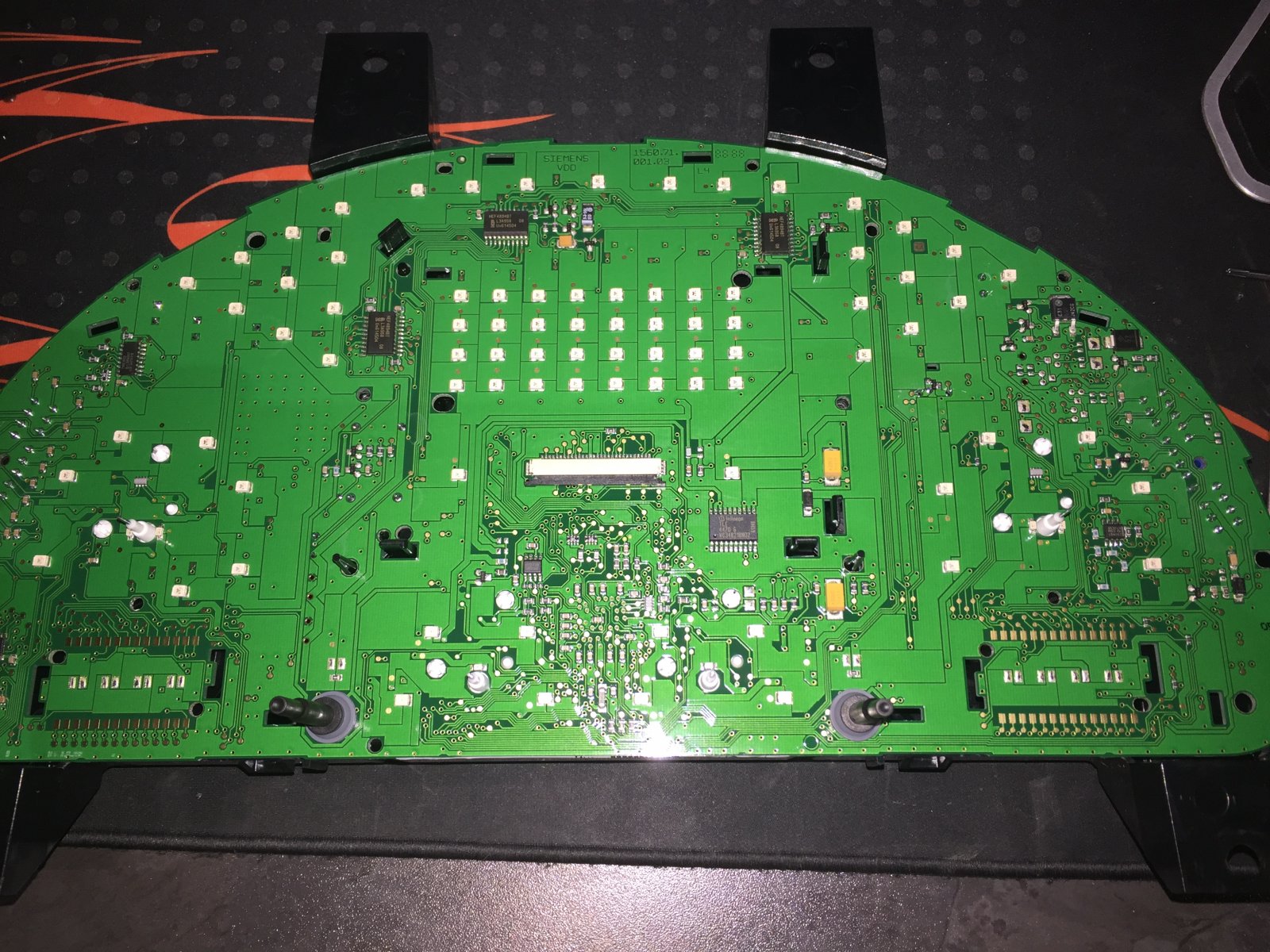

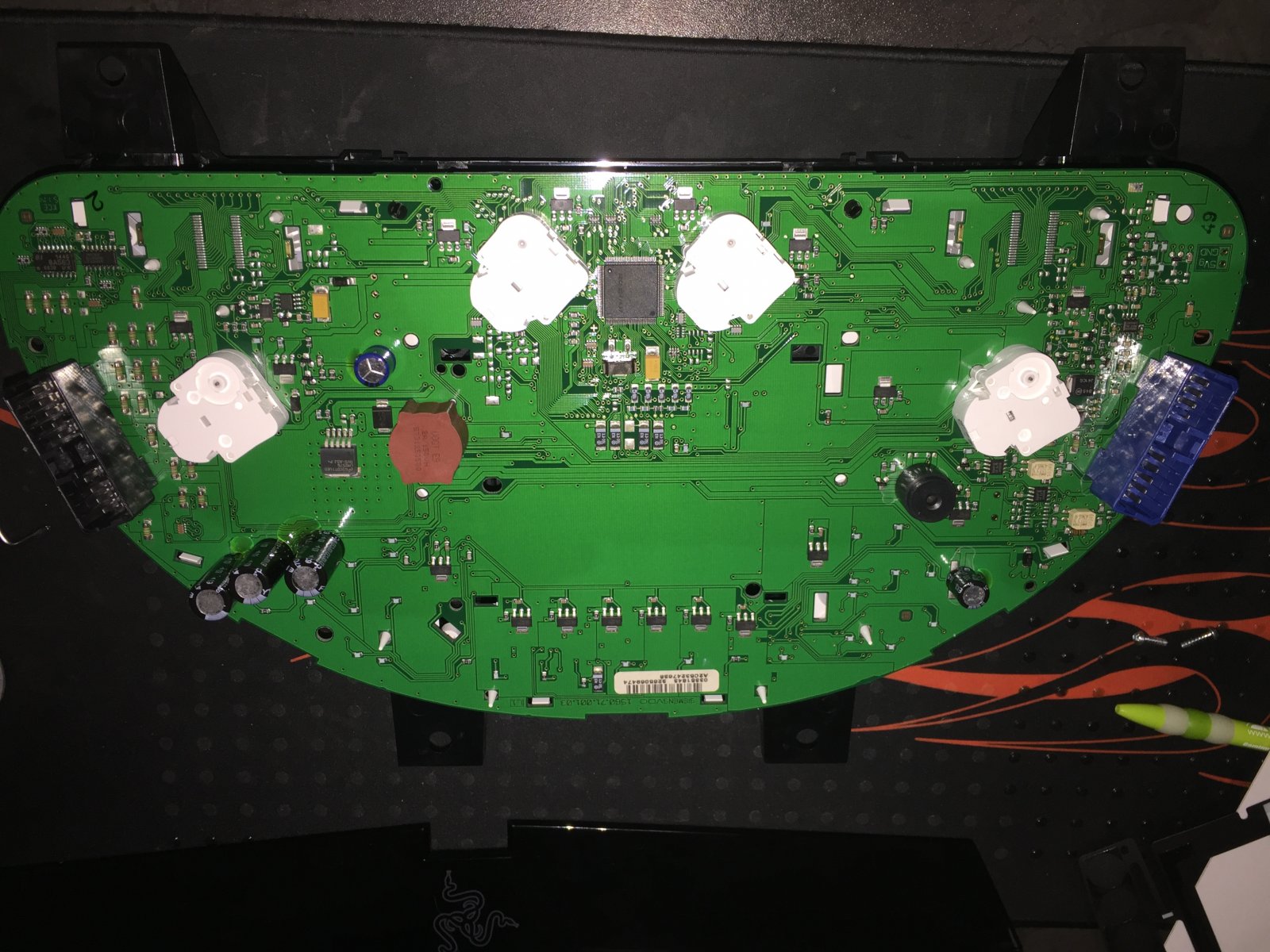

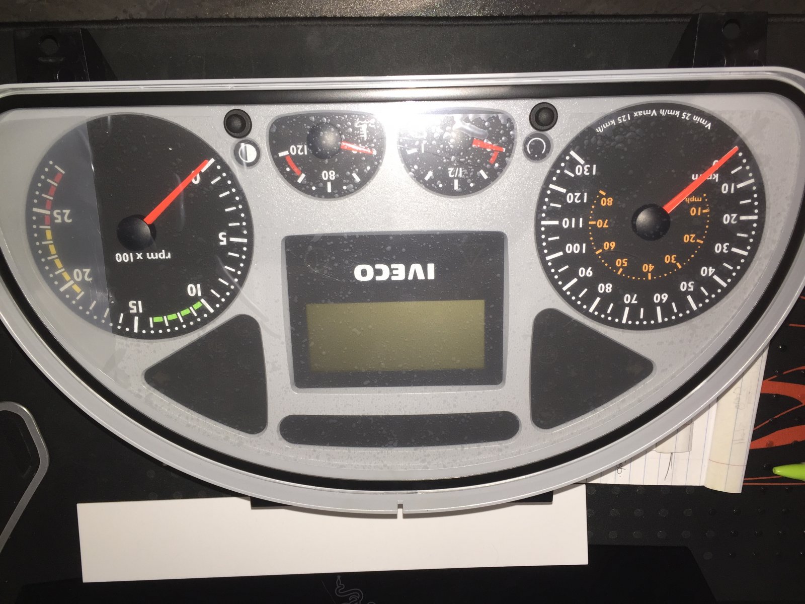

    Hi Guys,
    Ok after going through a few threads and reading up on the subject i want to attempt this with a Dash Cluster i got from a client for free :)
    Now i know i would need to get a few more things but what are my options and how do i go about getting started.
    I have the following dashboard cluster to work with.
    I would love to use as much as possible but if i could get the Speedo, rev Counter and maybe fuel and few lights working i would be extatic :)

    Ok not 100% but i think i found the Canbus Codes??
  4. RacingMat
    2,237
    21,022Coins
    You have luck!
    Everything is inside: socket pinout, baud rates, Node IDs...
    You have to read documentation in my post to understand what is useful.
    I wish you could get the same for me and my Mercedes Benz A class W176 cluster :)
    Where did you find this?
    21,512
    150,692Coins
    +11,018 / 55 / -2
    So what type of car is the dash cluster from that you got for free, as others may be very interested given @RacingMat's comments about the documentation you were able to find.

    @noorbeast it is a cluster from an Iveco Truck

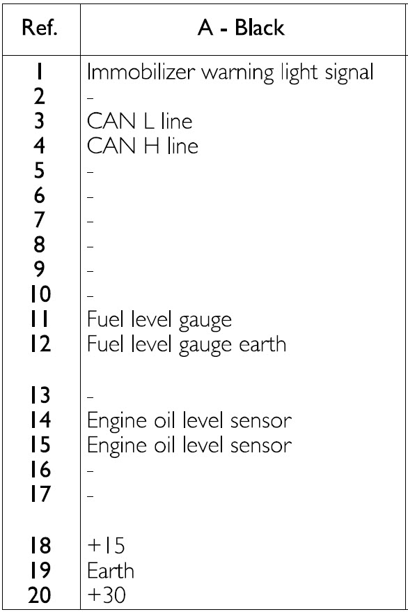

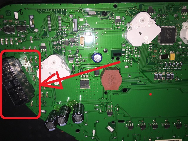

    Next steps:
    ► you have to buy a Canbus shield
    ► you have to find out the pinout of the socket of your cluster
    - ground,
    - 12V or 24V for a truck,
    - CAN high
    - and CAN low​
    If you can get the electrical wiring plan, we can have a look :)

  9. MiNeM
    MiNeM ..........
    Sep 13, 2015
    29
    Self Employed
    Johannesburg
    333Coins
    Ok so i managed to get a Canbus shield plus also got a serial to USB converter cable (Thought i might need that).
    Anyways where do i go form here and what else would i need? :)

    I don't know what shield you got. But normaly need an Arduino, the pinout of the cluster and some wires to connect everything.
    Now you can take your Id's from your document and a sample code for the shield if present and start coding.

    Hi!
    Did you find the electrical pinout to power up the cluster?
  12. RacingMat
    2,237
    21,022Coins
    Can you see the pin number written on the BLACK socket?
    Ground to pin 19
    +15V to pin 18
    +30V to pin 20
    Can Low to pin3
    Can High to pin4
    2015-11-19_10-48-32.jpg That should work!
