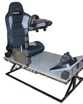

  14. Ibo
    Ibo New Member
    Nov 10, 2009
    0Coins
    hello to everyone,
    New here.
    So I'm looking for years to get a motion seat for Gran turismo since I played it at the nurburgring which was mind-blowing. (It's a huge rig with big pneumatic arms).
    For years I been also trying to find out how to built one. Then I fall over this site. First I was all hyped thinking here was the answer to all my questions. Fail. After searching a lot, many of you thought of very different and clever ways to built such a rig.
    Yare supposing to get the signals directly out of the wheel (In which case i would have bought the g27 so I can open up my g25 which has no warrenty no more). Nice idea, but probably a lot of work and programing to do to get it right.
    I tought now, (right now) that there must be a better way. Then I tought that gaming chairs have the most we need built in... so I googled for gaming motion chairs available for console. Then I found a seat named Gyroxus. Looked the videos to see how it moves. Seems quite descent maybe a little less stong on the g' forces than the big one for the pc.
    But taking this one, maybe ripping it apart. putting in bigger and stronger motors, installing a normal racing chair on and voila we should have something real for gt5.
    I fact I really hope, (like i read here) , that either sony will support the one everyone has there for the pc (best choice), either that an other constructor will add support for gt5, That's the only reason i need it. D'box seems interesting too but no console. Worst case no one get's one out, and here nobody could firgure it out too.
    it's just a thougt and i would be pleased to get some commentarys about this, if it's a good idea :clap: or stupid. :thbd:
