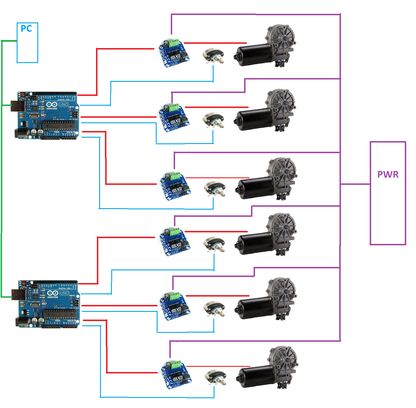

    My new design is a 6dof compact seat based on wiper motors.
    Basic assumptions:
    1. Soft - Sim Tools 2.51
    2. Arduino UNO SMC3 v1.0 x2
    3.BTS7960B x6 motor driver
    4. VALEO 404.027 wiper motor x6
    Best regards

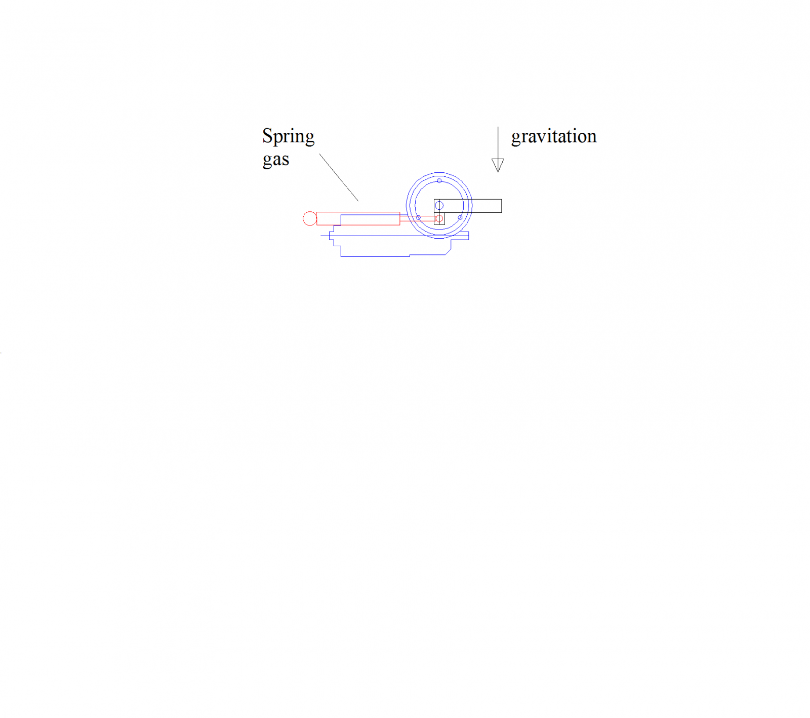

    Is it good idea?

  6. RacingMat
    2,234
    21,094Coins
    Arduino Uno has 6 PWM pins (3, 5, 6, 9, 10 and 11): you don't need 2 arduino boards
    yes, 10Nm torque with 5cm arm gives 20kg
    BUT 120kg vs 110kg is not enough
    and at what speed? max torque is achieve at lowest speed.
    Check the specs! here I readd 5Nm...
    that https://www.smolka-berlin.de/online...iper_motor,_gear_motor_24V_DC,_type_SW2L/5814
    Please add your location in your profile! we may advice you some place where to buy suitable motors

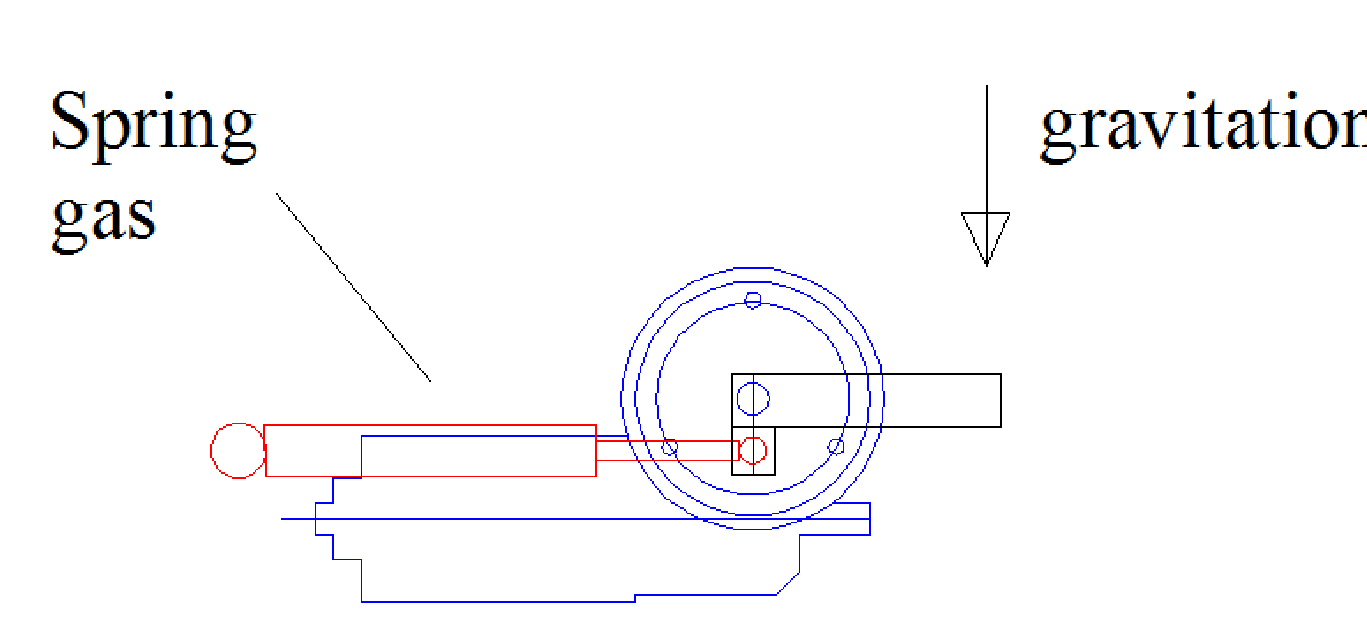

  9. tadeusz
    tadeusz New Member
    Nov 4, 2025
    14
    94Coins
    hi
    thx Noorbeast
    I wonder is it impossible to support the weak force of spring / spring gas
    best regards
  10. RacingMat
    2,234
    21,094Coins
    gas spring will slow the movements both ways... that's bad

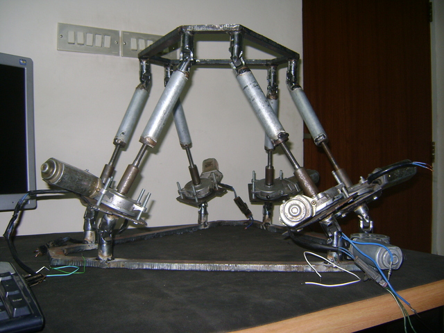

    the only wiper 6 DOF I know is this one BUT it's 24V driven and short arms
    AND I far as I remember, the builder didn't keep this design and build something else (but not 100% sure)
    h
    made by zigzag49
    http://www.racingfr.com/forum/index.php?showtopic=50098
    sadly, pictures have disappeared

    @zigzag49's detailed build thread can be found here: https://www.xsimulator.net/community/threads/6dof-dc-24v-smolka-zigzag49.7490/

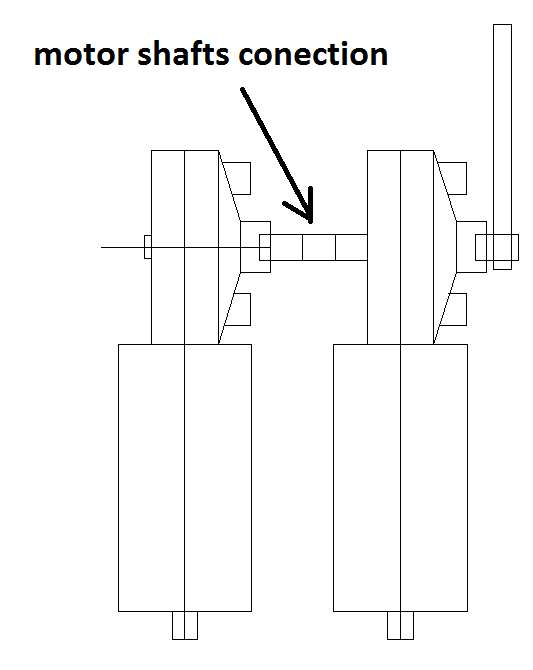

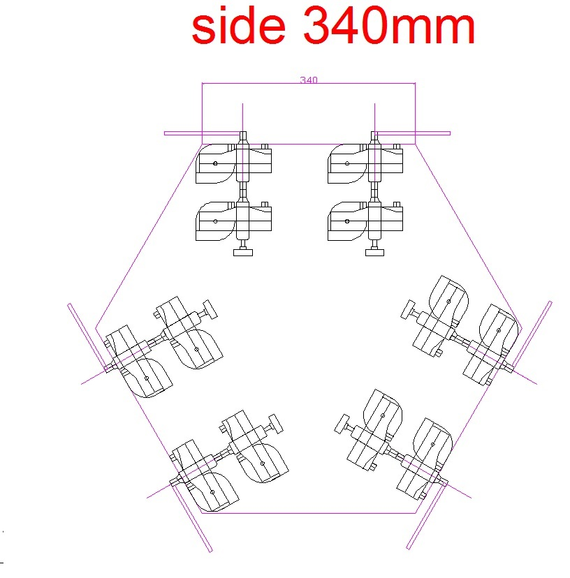

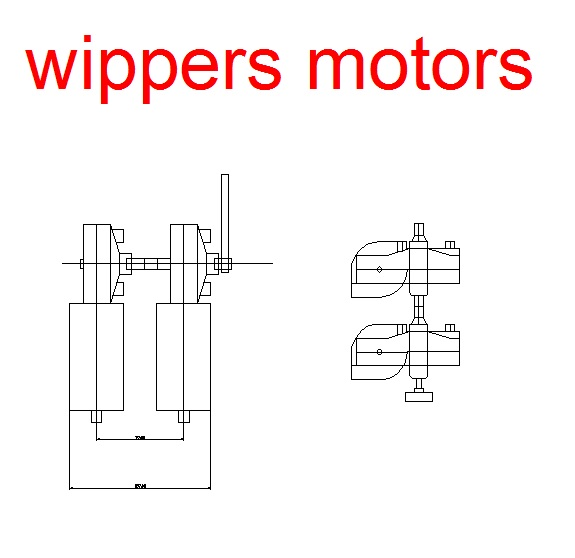

    Hi
    Has anyone tried this solution?
    electric parallel connection
    one regulator
    one potentiometer
    best regards

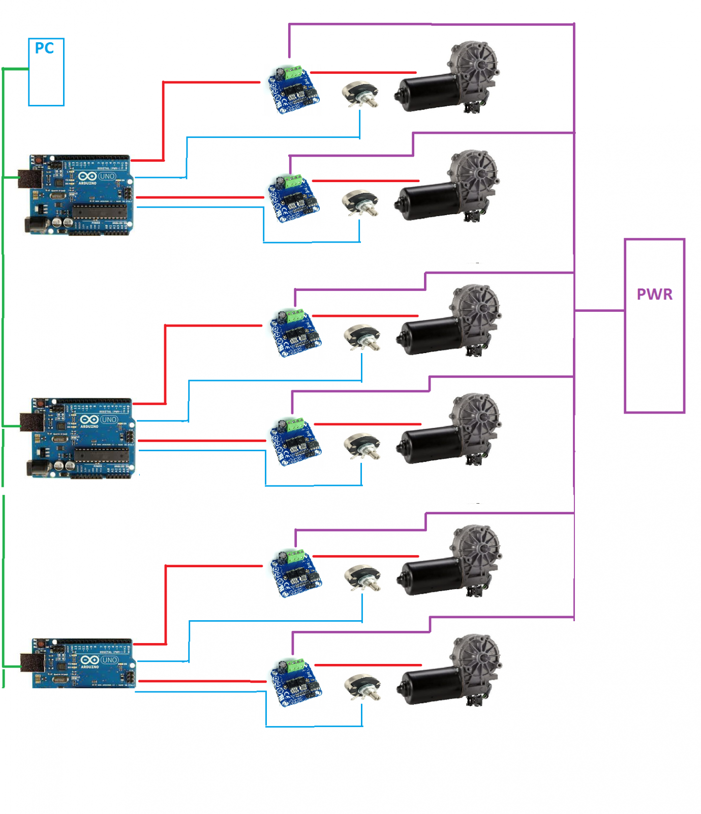

  14. C1500
    C1500 Active Member
    Nov 19, 2018
    165
    1,120Coins
    +86 / 1 / -0

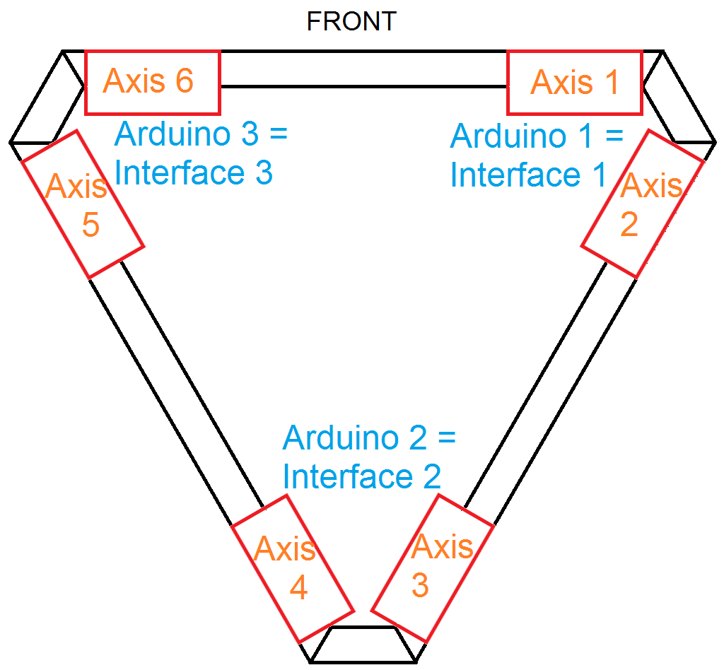

    AC motor, 6DOF
    Hi tadek
    Please keep in mind that the third PWM has not the fully frequency.
    I had a setup just like you but i used 3 Arduino.
    Do not save on an Arduino, you will only get more difficulties
    kind regards
    Peer

  16. C1500
    C1500 Active Member
    Nov 19, 2018
    165
    1,120Coins
    +86 / 1 / -0
    AC motor, 6DOF
    Yes i still use mover and have used FlyPT´s former software.
    Works great for me with 3 Arduinos and SMC3
  17. tadeusz
    tadeusz New Member
    Nov 4, 2025
    14
    94Coins
    Hello
    I will try this concept:

  19. tadeusz
    tadeusz New Member
    Nov 4, 2025
    14
    94Coins
    Hi
    C1500
    Have you tested
    layout with 2 Arduino?
    Do you think this system is better?
