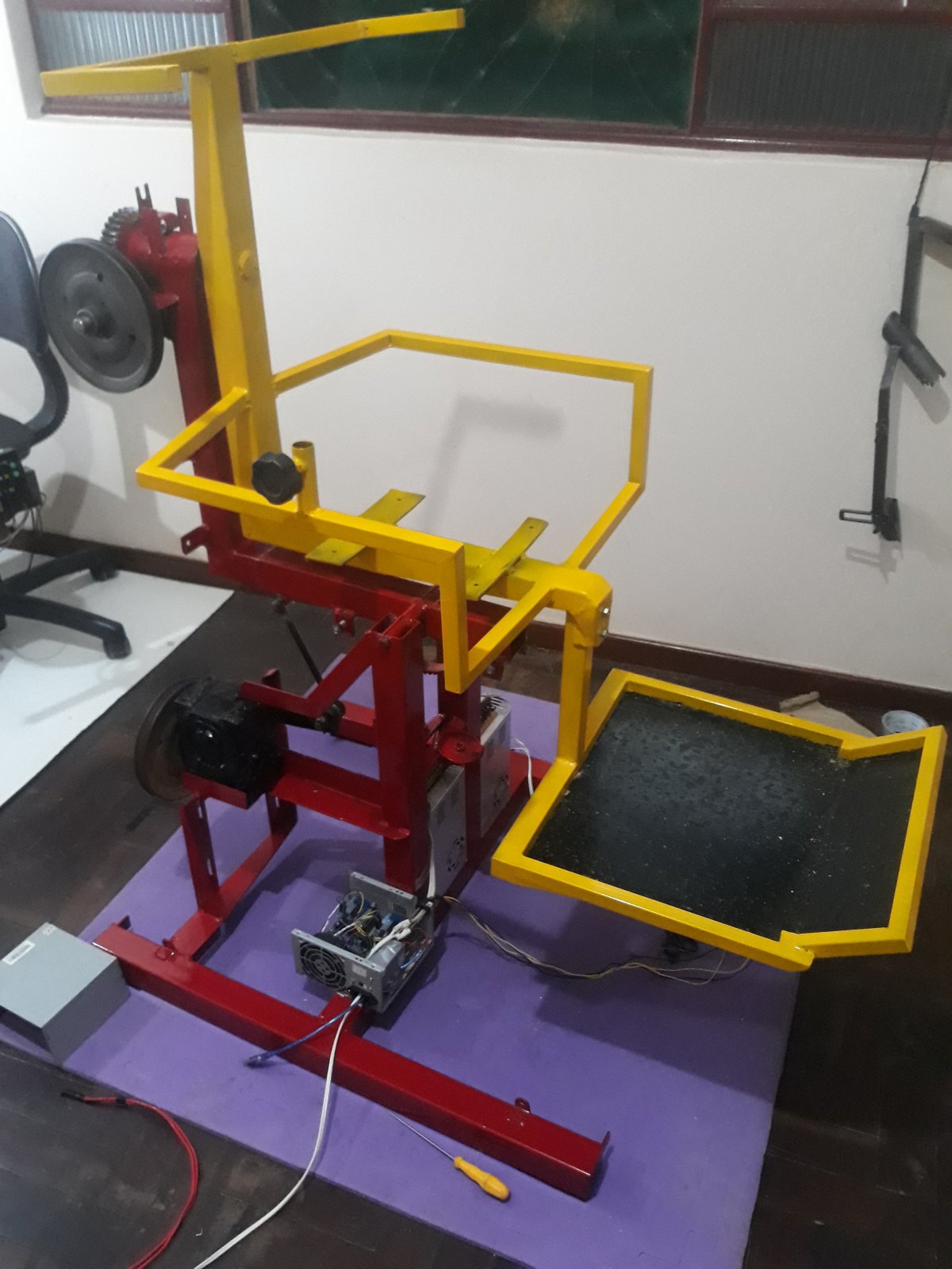

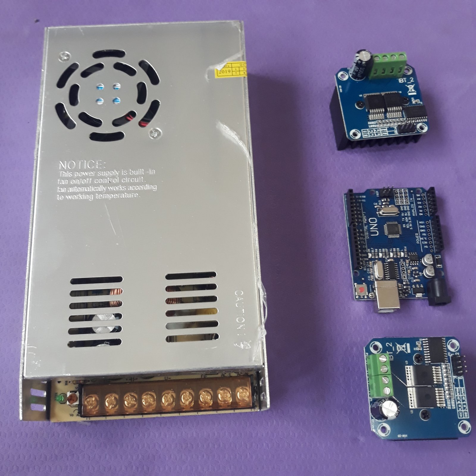

    developing my exclusive project for flying with hmd.
    components - 50mm x 50mm x 1.9mm square tube;
    - 2 dc 24v. wheelchair motors;
    -arduino uno;
    -2 bridge H bts 7960b;
    -2 sources of 20a.

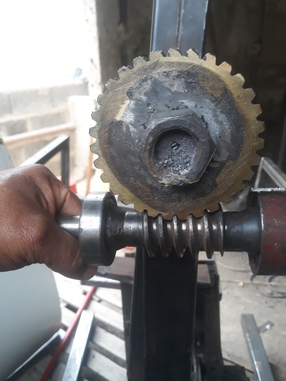

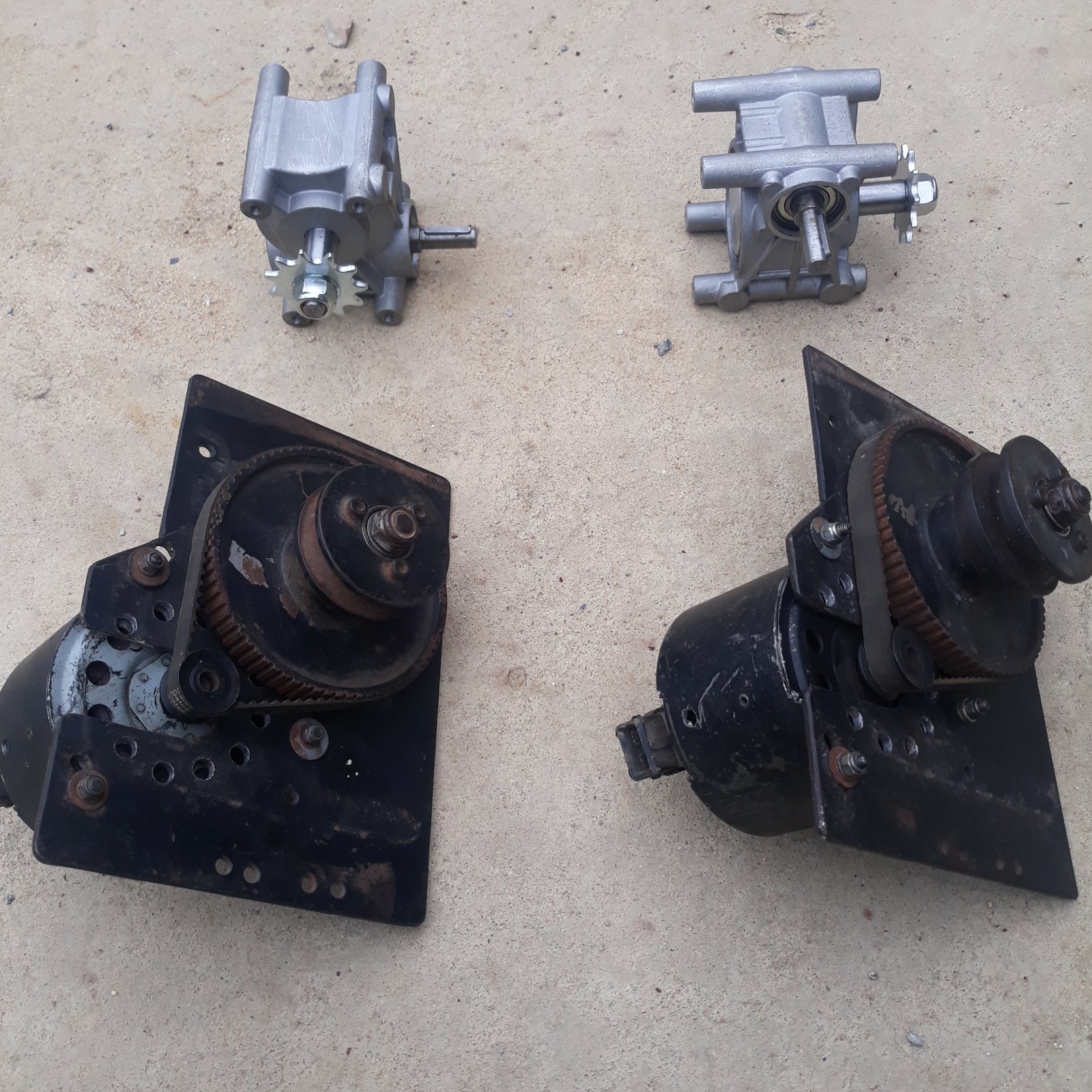

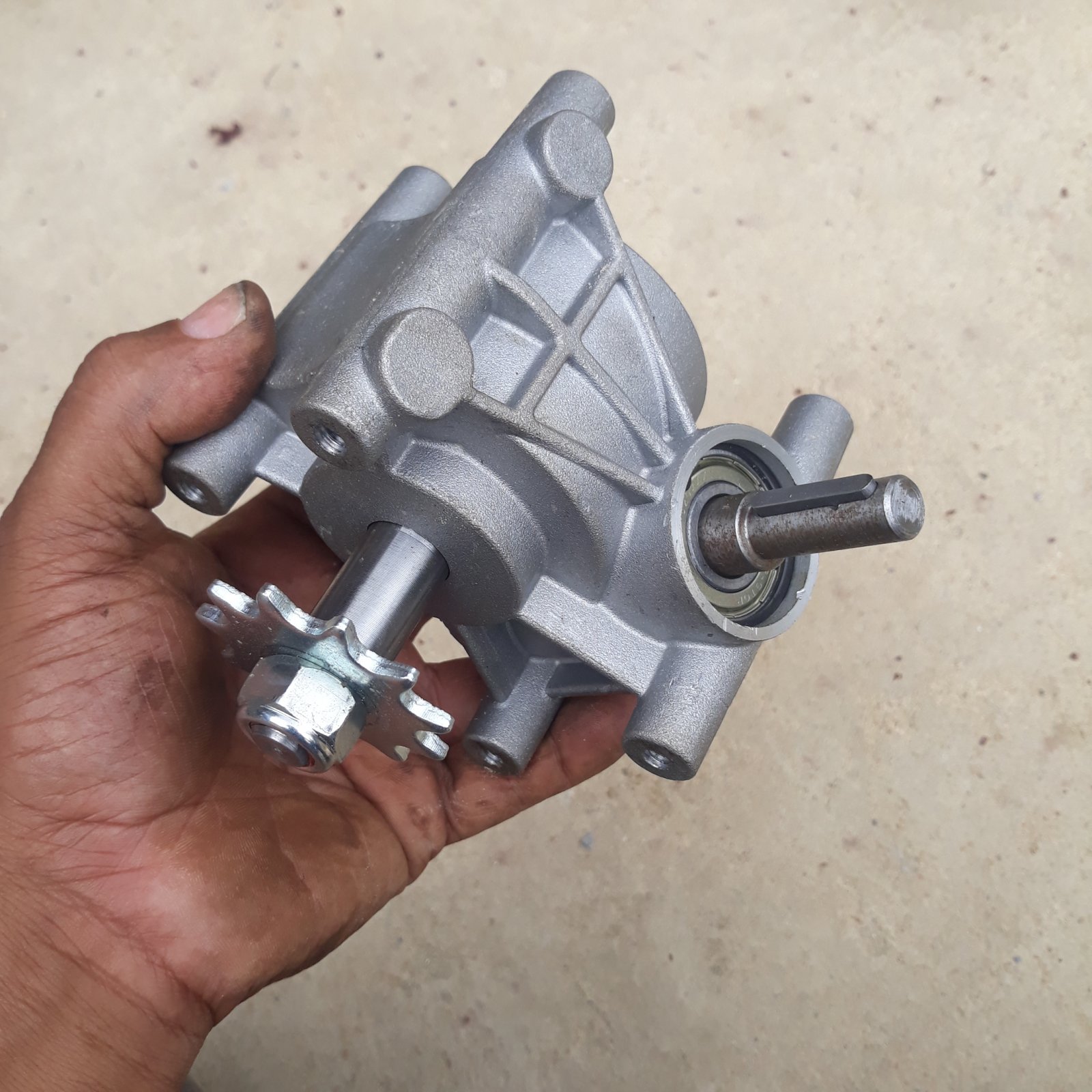

    the speed of the chair motor was high, so I will add a sliding reduction box.

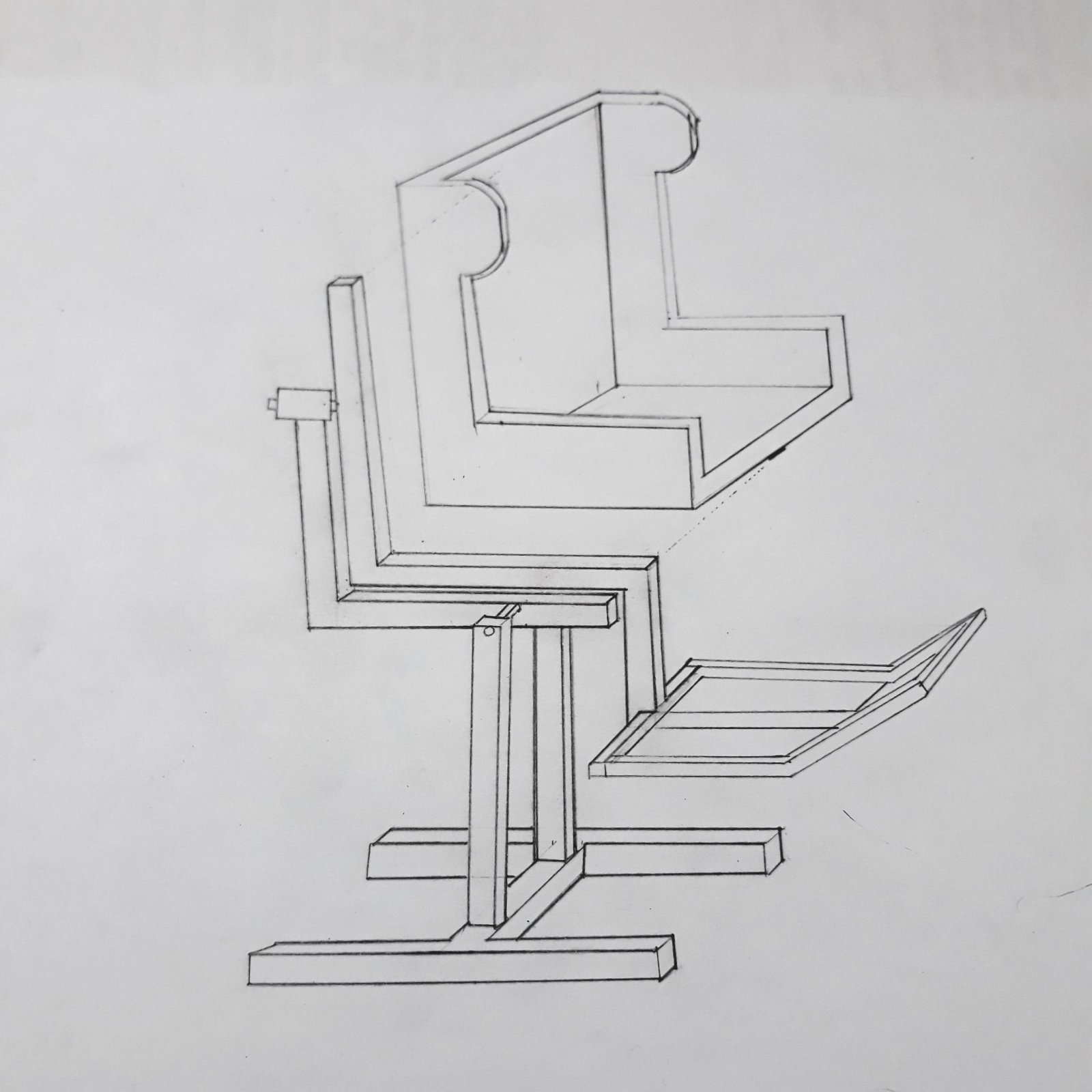

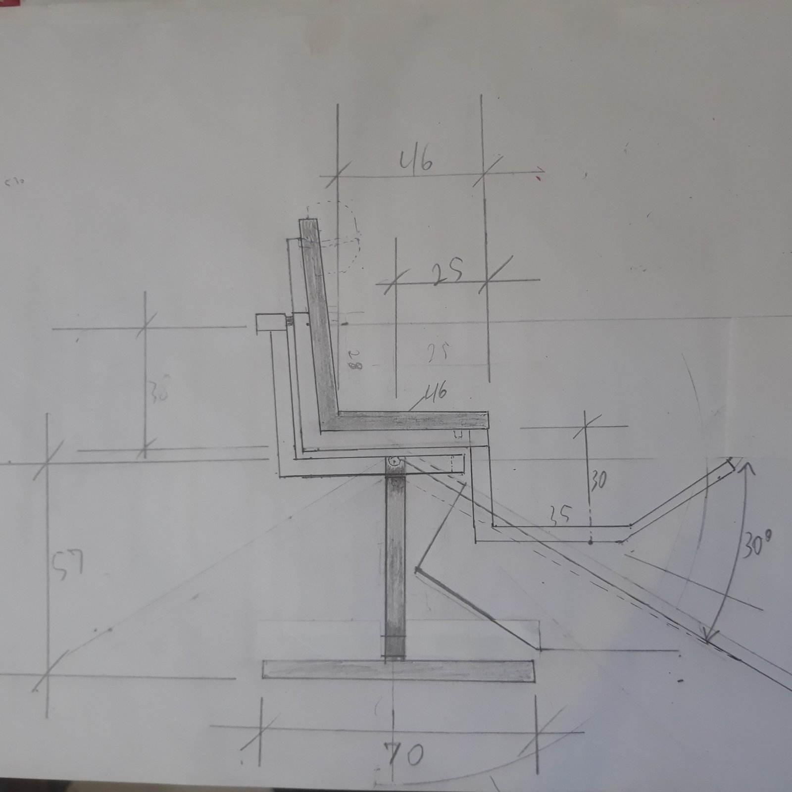

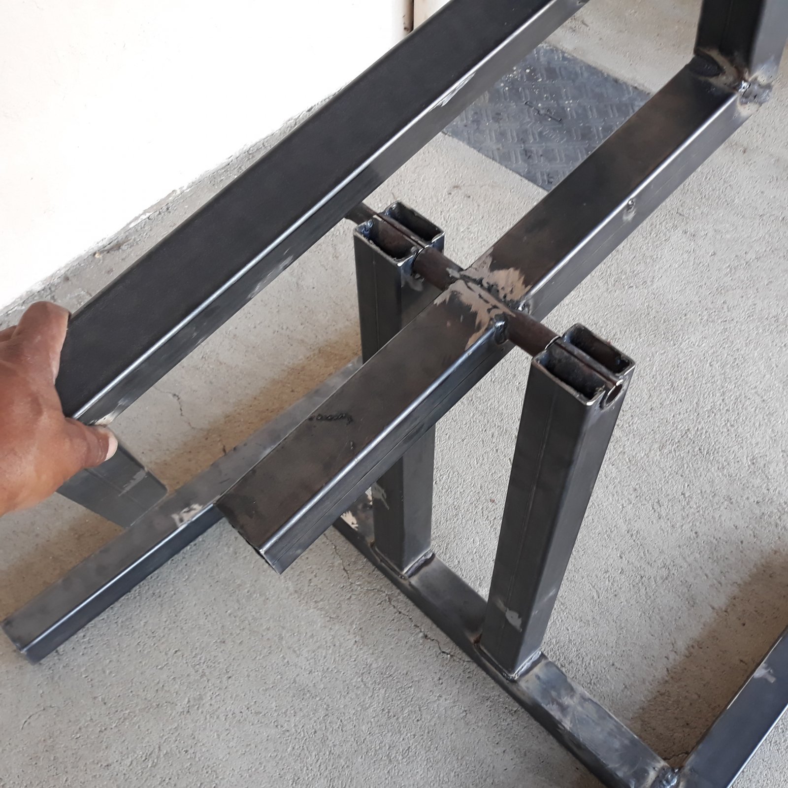

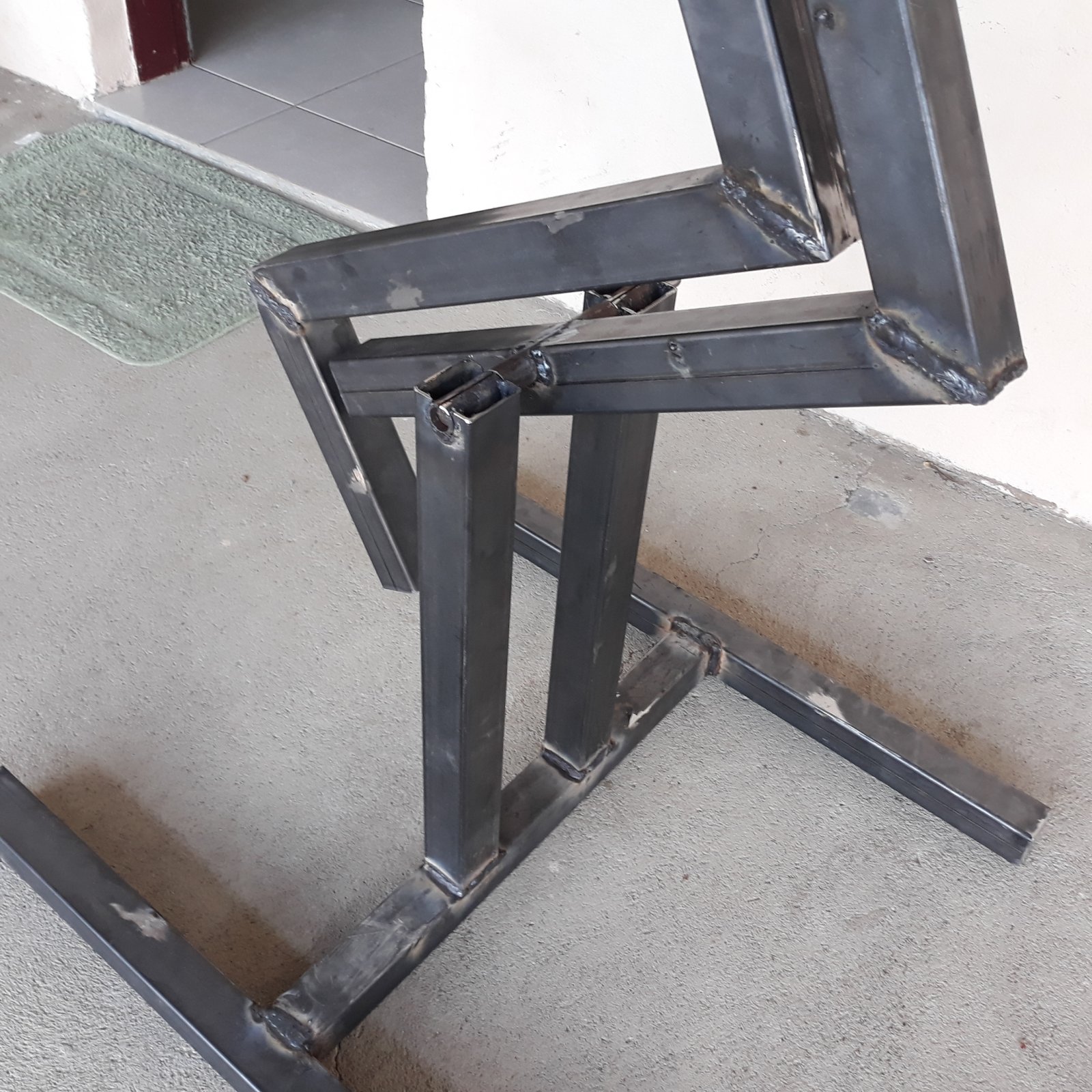

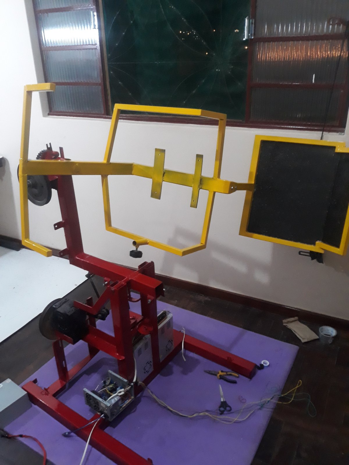

    me building the motion rig. 20200531_154047.jpg 20200531_154144.jpg 20200531_154309.jpg 20200531_154425.jpg

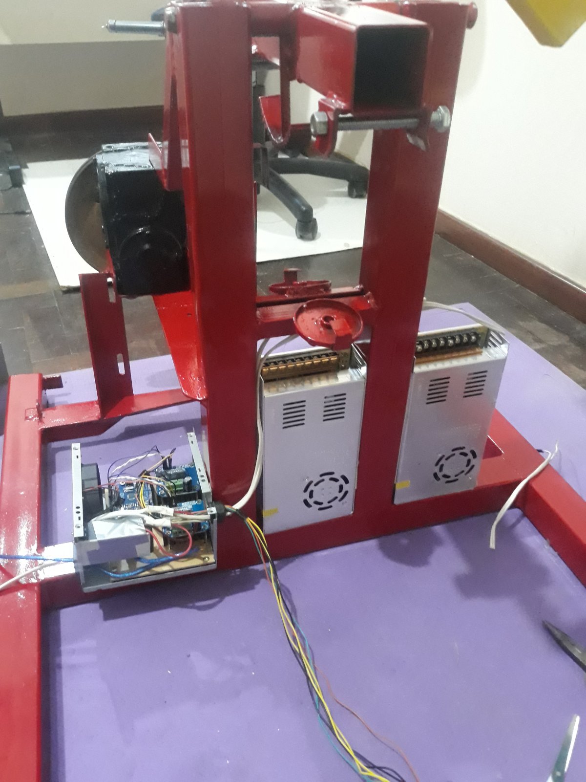

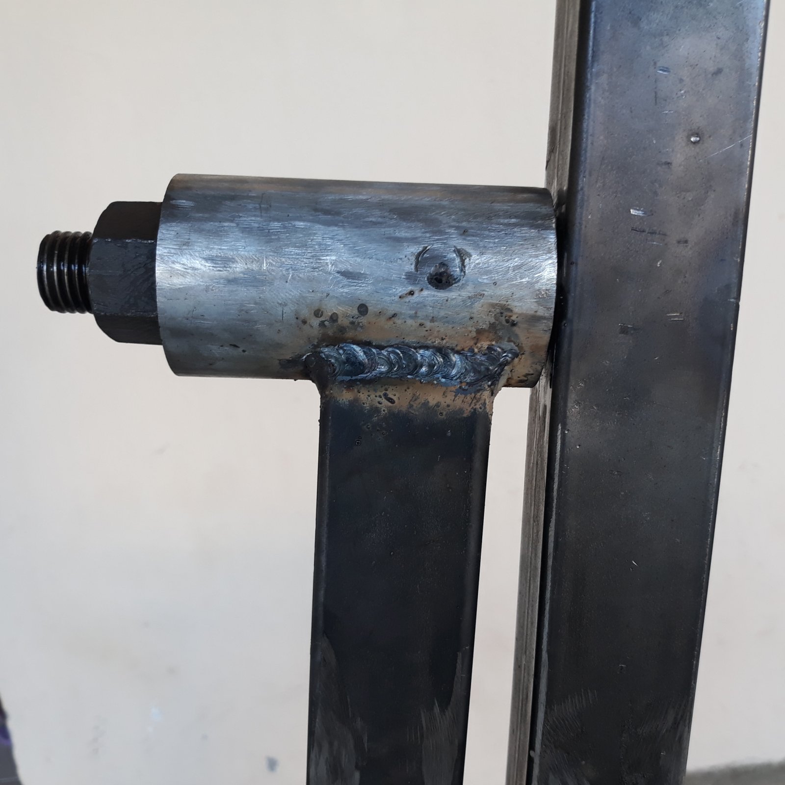

    the welding of my motion rig.

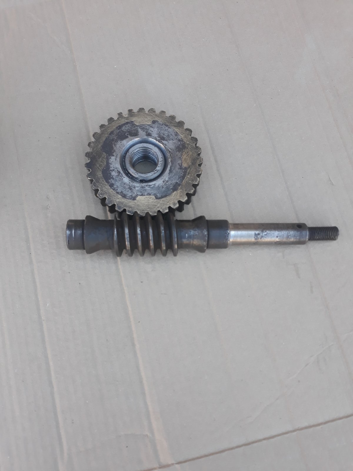

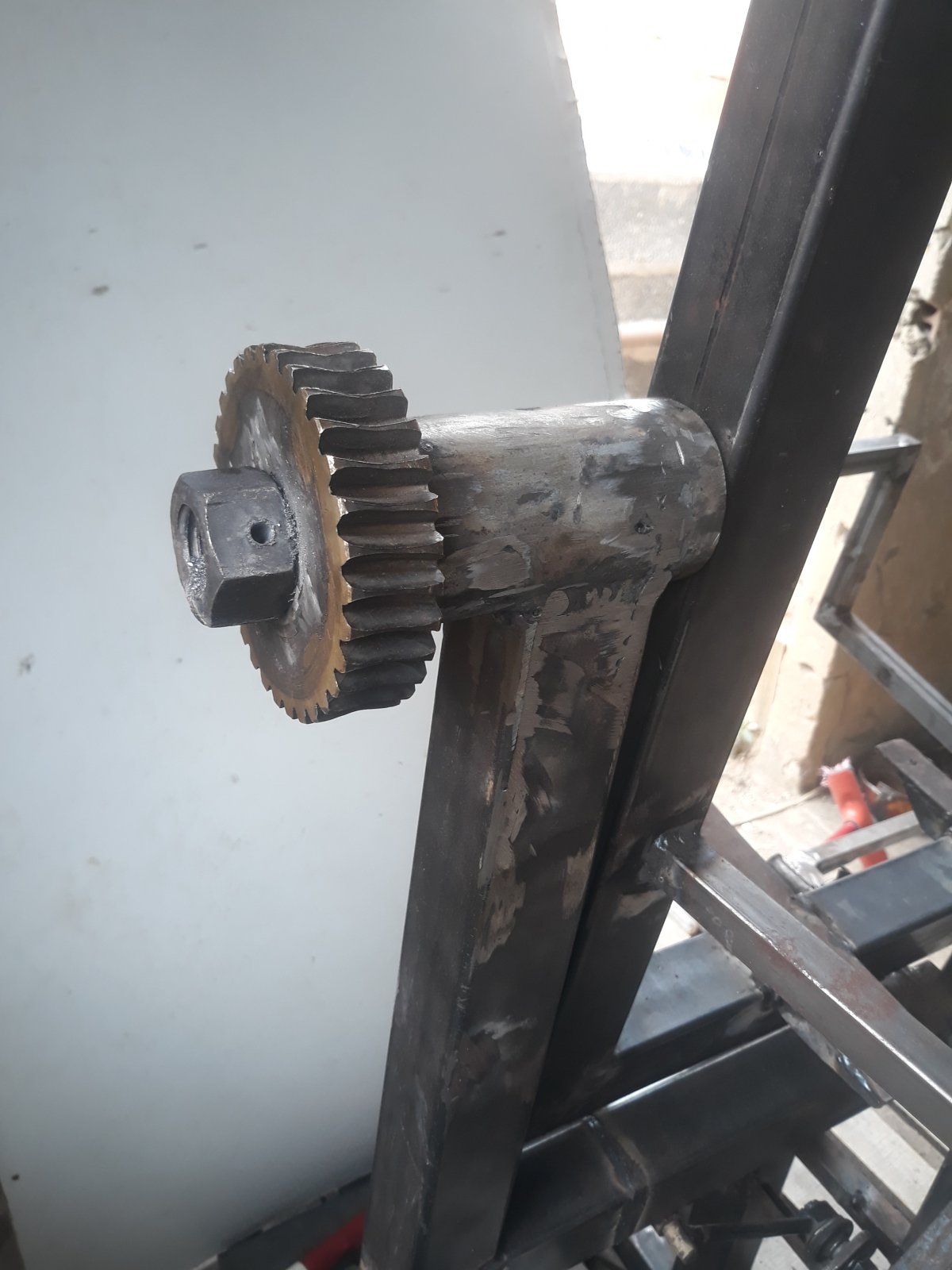

    the rpm reductions shown above were not strong enough after testing, so they will be replaced by stronger gears. 20200805_120110.jpg 20200805_120212.jpg 20200811_125012.jpg 20200811_125221.jpg 20200819_153209.jpg

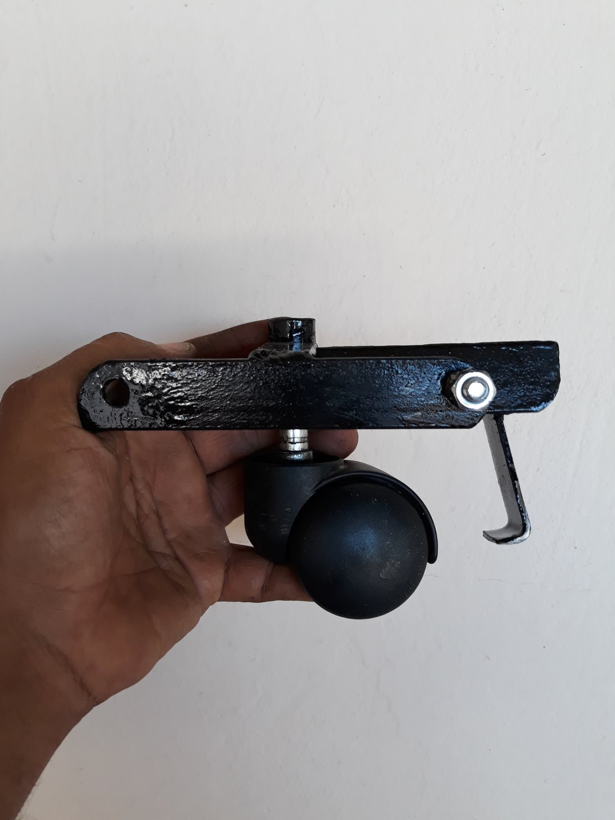

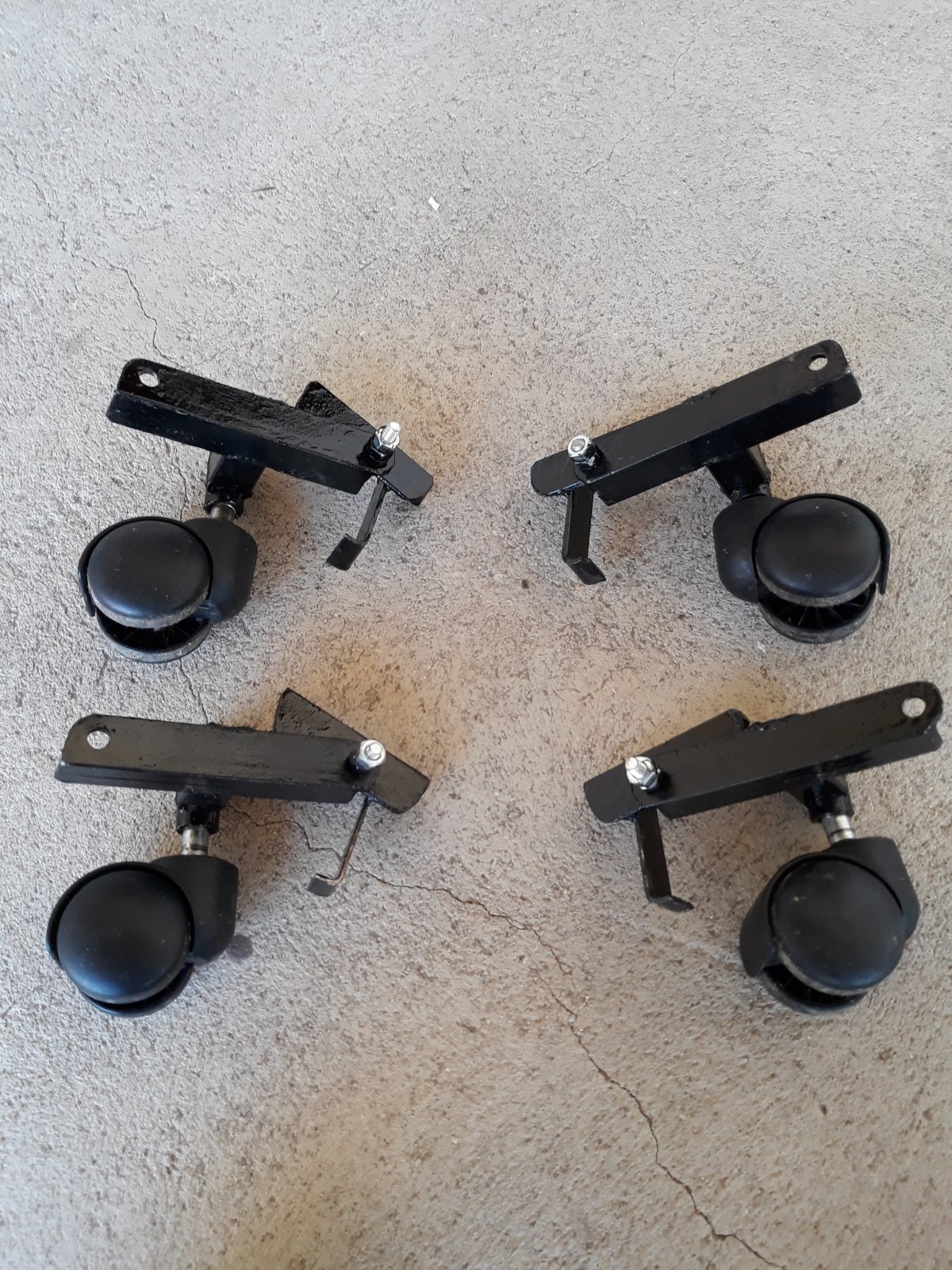

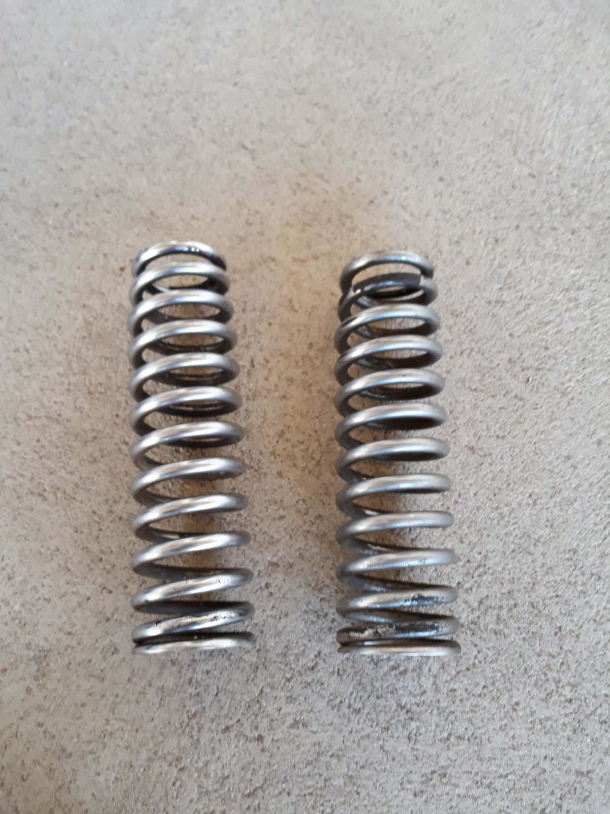

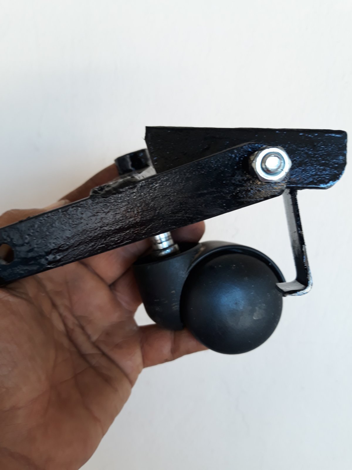

    - 2 motorcycle springs will be used to compensate for the weight when tilting the y-axis.
    - 4 retractable casters will be installed for small displacements. 20200831_123530.jpg 20200831_123704.jpg 20200831_123758.jpg 20200831_123826.jpg

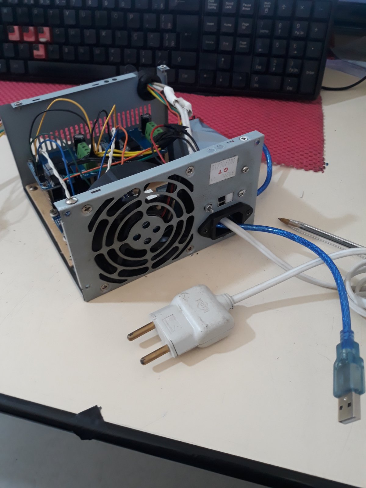

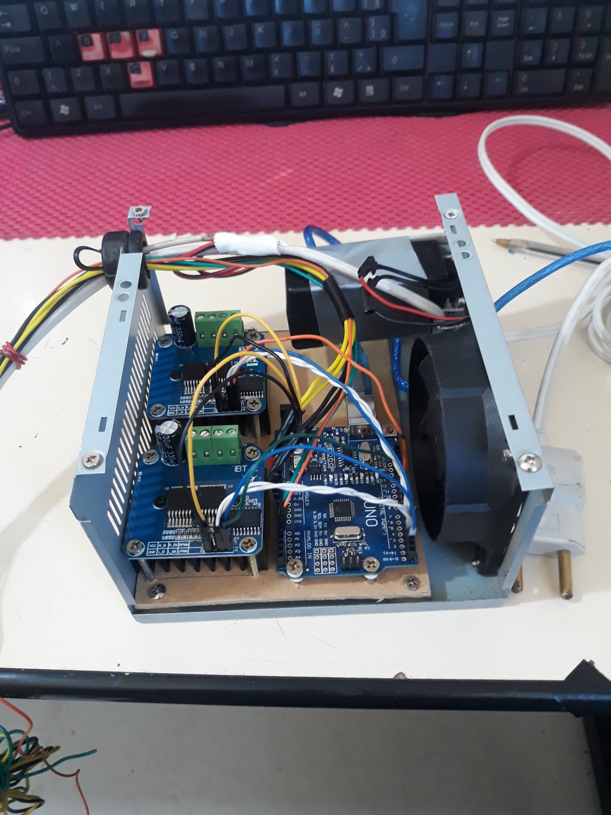

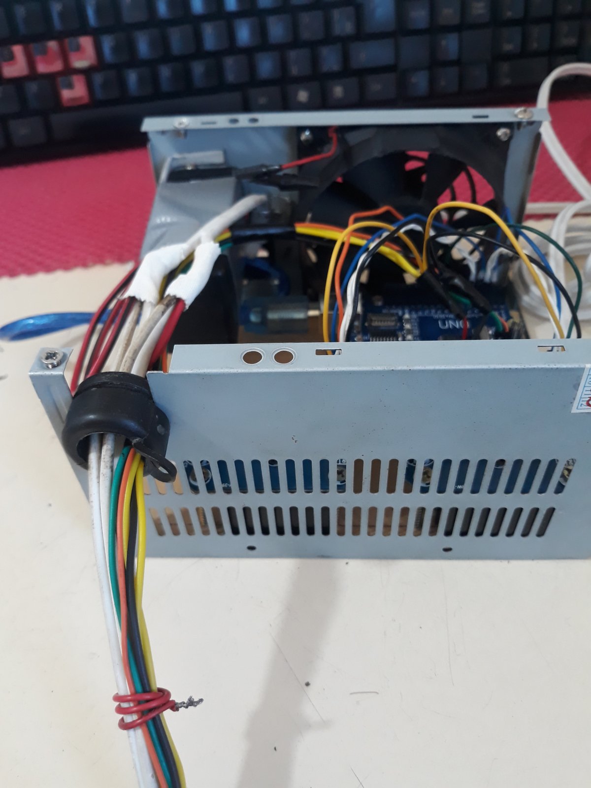

    arduino and h bridges ibt2 bts7960 mounted in an empty computer power supply box.
    missing to place the wires that connect to the motors. I installed a 12v power supply to power the fan.
  10. Dschadu
    Dschadu Active Member
    Jan 2, 2017
    109
    1,936Coins
    +146 / 1 / -0
    Looks nice and tidy.
    But: You are going through the metal case with mains power. I don't know if the cable just runs through, but it looks like the fan is connected to it. You need to have double isolation (like heatshrink around the fan wires) or you have to connect the case to ground to prevent electrical hazard. Grounding also helps with EMI.
  11. janio
    janio janio from brazil
    Feb 28, 2020
    81
    state employee
    belo horizonte
    184Coins
    +35 / 0 / -0
    I chose to run the cable through the box just for aesthetic reasons, the fan does not go directly to the power cable, there is a compact 12volts source for 1 ampere for it. my rig is getting pretty, see photo.
    thanks for interacting.

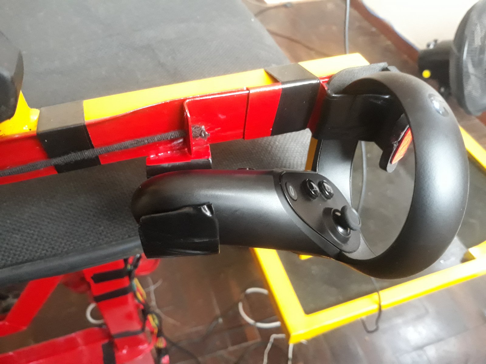

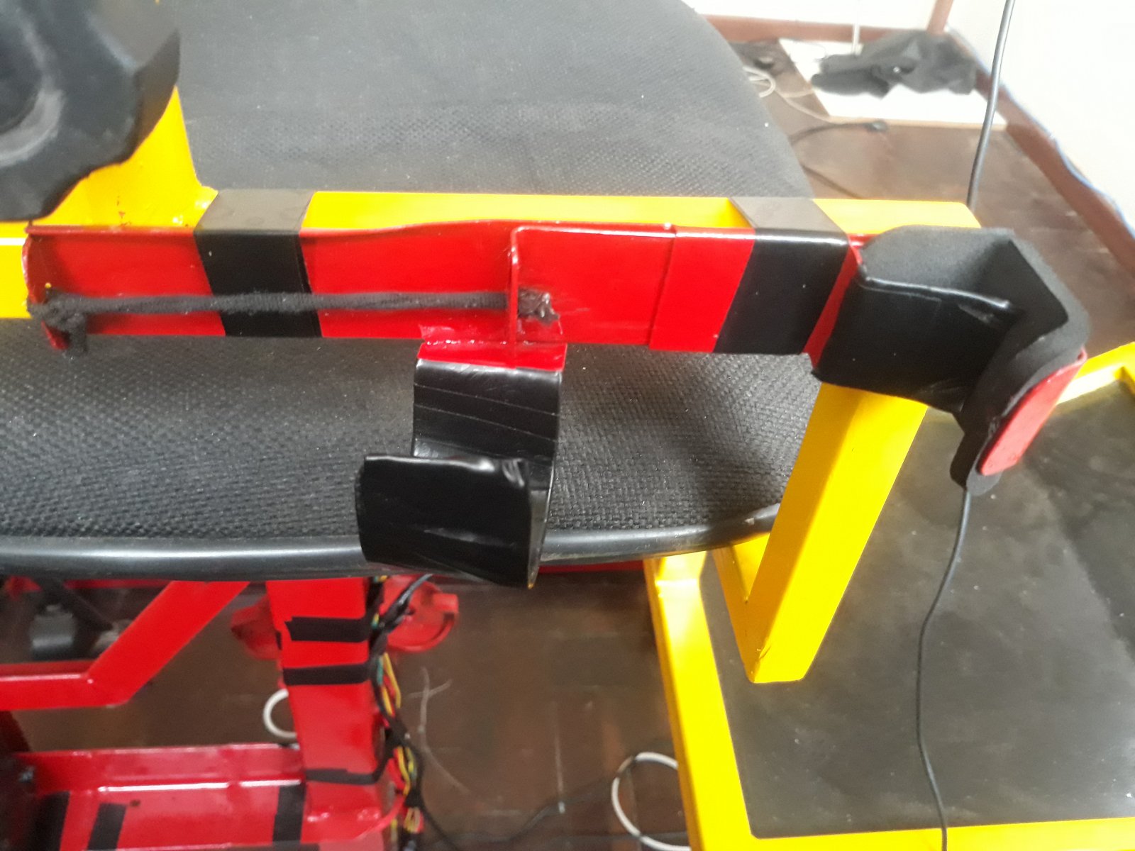

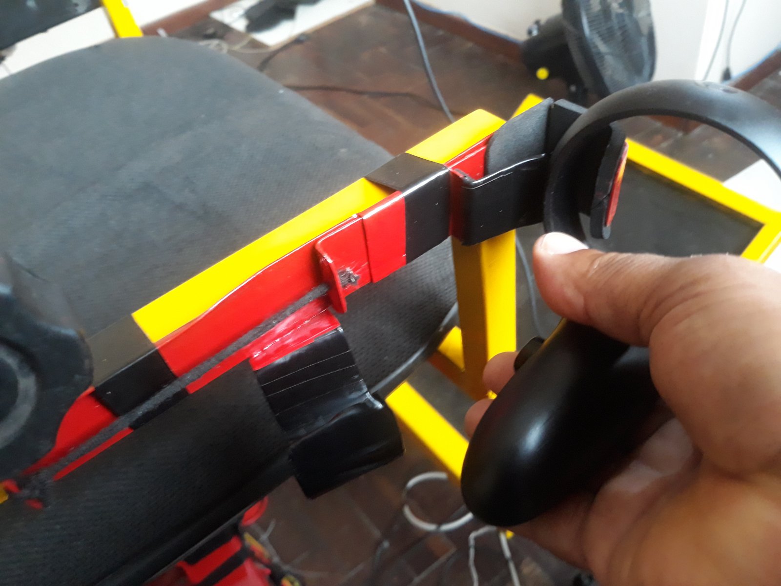

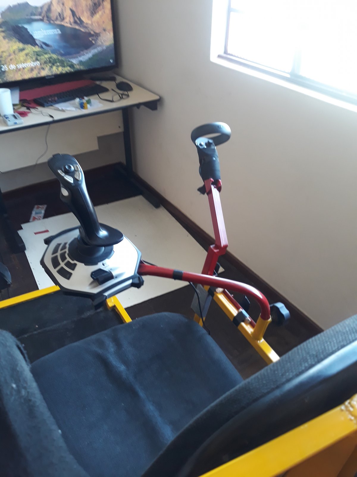

    I built a support for the touch rift. 20200922_100735.jpg 20200922_100716.jpg 20200922_100534.jpg

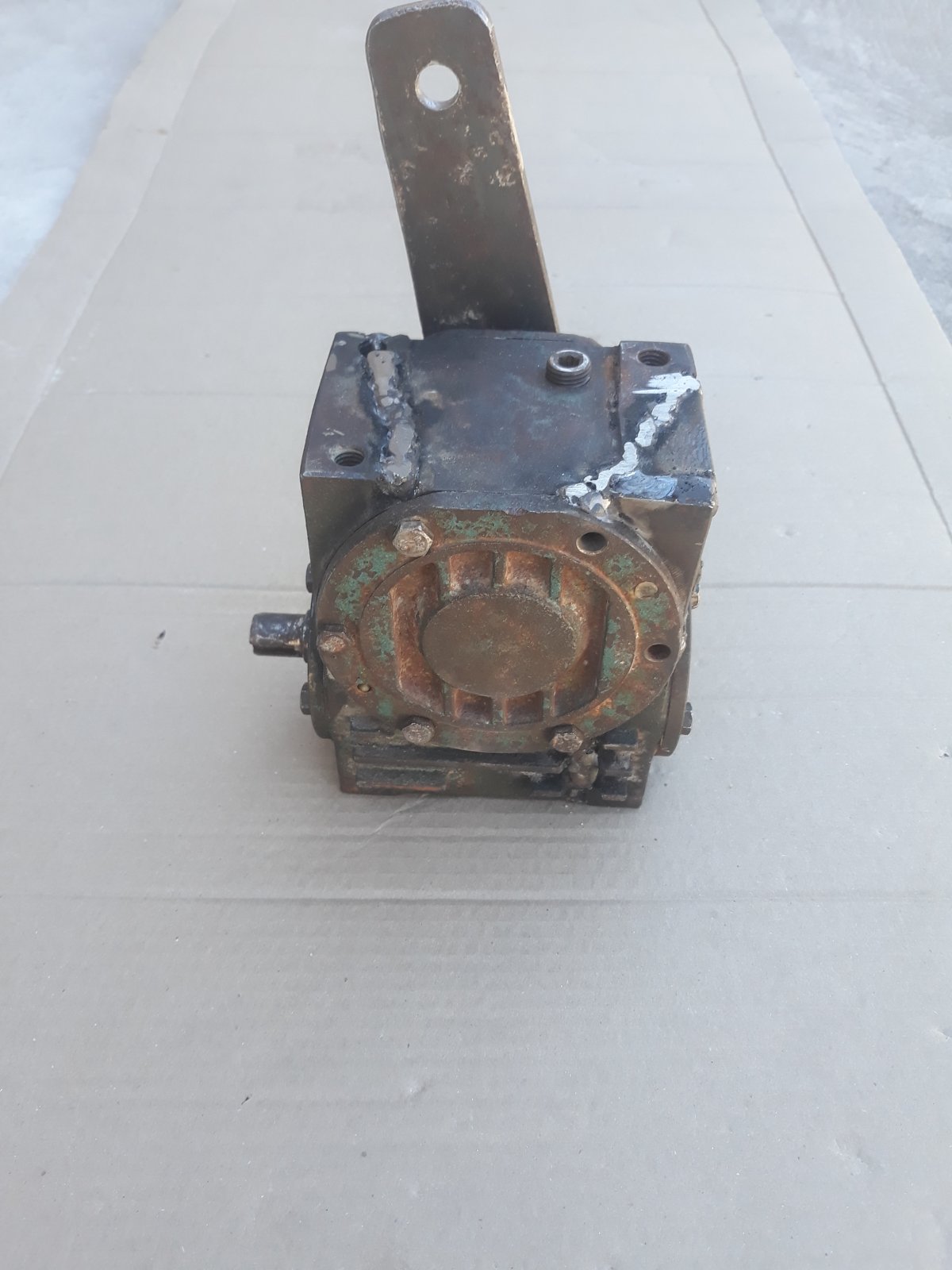

    SPEED RATIO.
    I used 2800 rpm-180w motors - 7,5 amps.
    On the motor shaft, a 20 mm diameter pulley {20 x pi (3.1416) = 62.83 circumference},
    Attached by belt to a 120 mm pulley (120 x pi = 376.99 circ.), Then 376.99 / 62.836 = 6.00.
    Then the 2800 rpm was reduced to 6 time, dropping to 466 rpm.
    A 60mm pulley (60x pi = 188.49 circ.) Is attached to the 120mm pulley, therefore rotating at 466 rpm.
    The 60 mm pulley is connected by belt to a 190 mm pulley (190x pi = 596.90 circ), therefore 596.90 / 188.49 = 3.16
    Then the 466 rpm was reduced by 3.16 times, dropping to 147 rpm.
    147 rpm is the input speed for the gearbox whose speed ratio is 30: 1 (30 turns on the input shaft by 1 turn on the output shaft).
    The lifting arm of the structure coupled to the output shaft of the gearbox has a 180º (half-turn) path which makes use of 15 revolutions at the entrance.
    Being 147 rpm (60 seconds), 15 rpm is for 6.12 seconds. (60 / 147x15 = 6.12)
    The travel time of the platform tilt for each side is 3.6 seconds. If you want a faster platform, just reduce the pulley ratio to obtain a higher final rpm.
    However, there is a cost for this, since increasing the final speed requires more engine power, so you would probably need to increase the wattage of the engine.

    20200925_150329.jpg today i added a metallic support for the tracker, necessary to use the motion compensation software (later i will test the virtual tracker with the flypt mover software), because my x axis rotates 90º to each side, so it is impossible to fly decently without this wonderful OVRMC software, for which we have much to thank Dschadu. 20200925_150329.jpg
