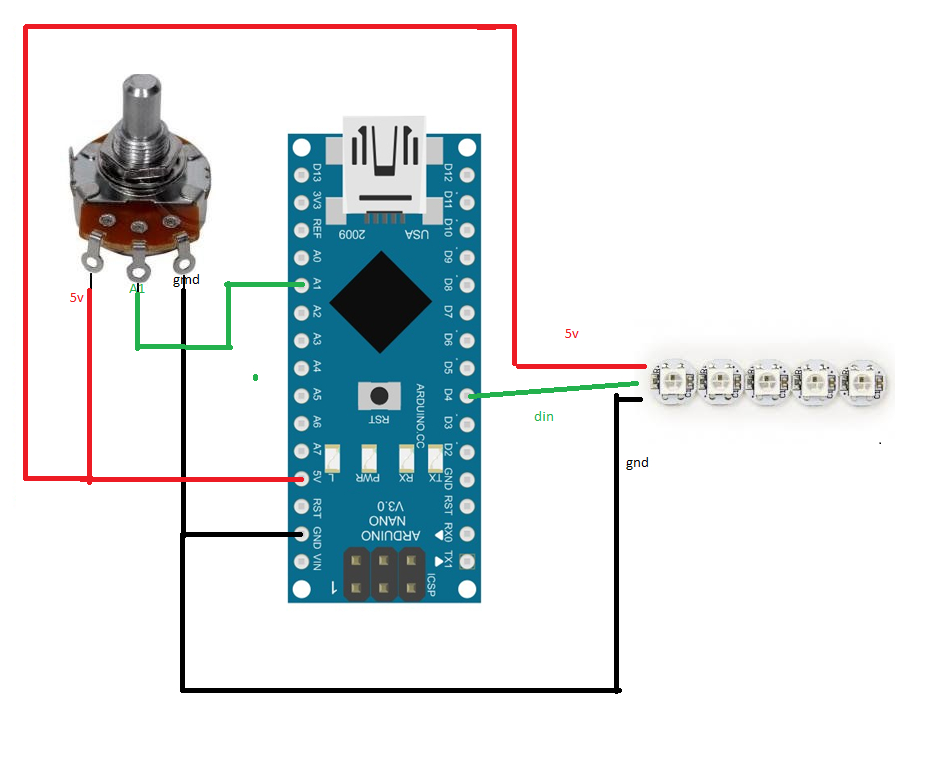

    If you are to put LEDs behind the rpm gauge numbers like I am (pics coming ) this is an easy project for you to change the red line with a pot,
    Parts need:
    10 k pot
    Wire
    Arduino nano or uno
    some ws2812b LEDs
    Wiring diagram below
    Here is a video of it working
    don't forget you can change the colours in the code please see note in the code
    Code:
    #include "FastLED.h"
    // How many leds are connected?
    #define NUM_LEDS 10
    // Define the Pins
    #define DATA_PIN 4
    // Define the array of leds
    CRGB leds[NUM_LEDS];
    void setup() {
    FastLED.addLeds<NEOPIXEL,DATA_PIN>(leds, NUM_LEDS);
    void loop() {
    int val = analogRead(1);
    // Map the pot values to 0 - Number of Leds
    int numLedsToTurnRed = map(val, 0, 950, 0, NUM_LEDS);
    // Clear the existing led values
    FastLED.clear();
    // Change led colors // after the crgb below change to what coulors you want.... web colours heres a website:: http://htmlcolorcodes.com/color-names/
    for(int led = 0; led < NUM_LEDS; led++)
      if(led < numLedsToTurnRed)
        leds[led] = CRGB::Red;
      else
        leds[led] = CRGB::Blue;
    FastLED.setBrightness(50);
    FastLED.show();
