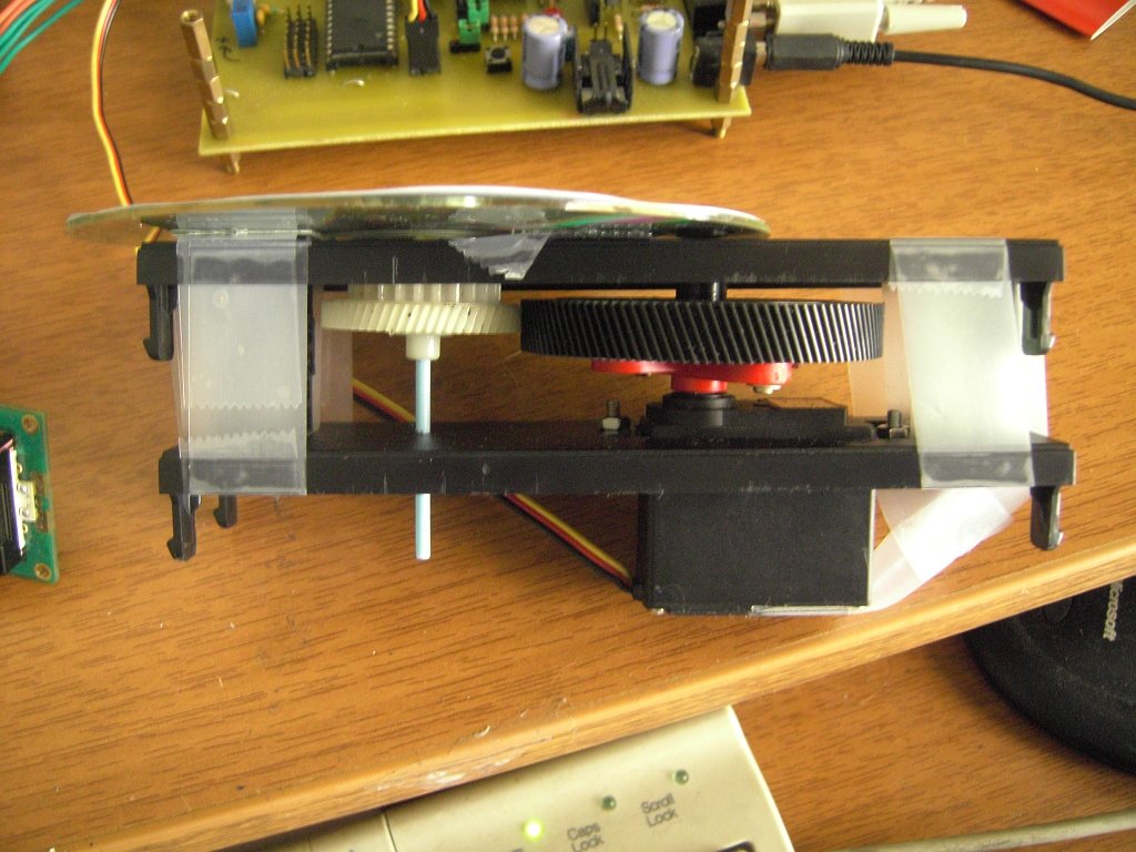

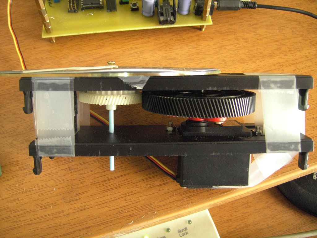

    This is an attempt to make analog car instruments using simple materials.
    For start I made a speedometer that is driven by a simple 180 degree servo. As the max rotation of the servo was only 180 degrees I decided to gear up its output using some gears that salvaged from an old printer. The ration of the gears is 1:2 that means that the needle can rotate for 360 degrees.
    To interface it with the game (liveforspeed) I used my AVR motion controller 1.5 (AMC) and plug it in its first servo port.
    In the profiler I assigned the effect #36 that is the speed output to y axis output that sends the data to the first servo port on my AMC. An issue that I have to overcome with the current profiler was that the g-effect output, that can be used to output linear motion, can only send 127 positive positions... So I had to modify the rc servo code on my AMC to assign the 127-255 received values to a full swing of the rc servo. This means reduced resolution but for now it works!
    A request to Sirnoname: In your next profiler add linear effects that can have base as 0 (no negative values).
    Unfortunately I also realized that liveforspeed plugin doesn't output RPM to be able to also use a second instrument for RPM that I have. I'll try it later with GTR2 probably... Anyone that can make an rnr profile that reads speedometer and RPM from GTR2??? Please?
    Here are some pics:
    Yes I know, lots of duct tape... :rofl: I'll bolt them down later to a more solid construction.

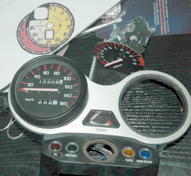

    Cool :thbup:
    You should try to grab a real automotive gauge cluster from the junkyard. With fuel indicator ;D

    Unfortunately, the gauge clusters from real cars, don't use servos, but electromagnetic coils that follows the voltage given from the measure points. Some of the gauges even use aircore driven gauges, that are even more difficult to drive...
    Anyway, simple servos are the easiest way right now for DIY gauge panel for the hobbyist! :thbup:
    I've seen that too few downloaded the Hi-resolution video I uploaded on rapidshare... Too bad, you are loosing many details not shown on the youtube video! :eek:
    Regards, Thanos

    I know, but you could use an automotive cluster anyway, and replace all electronics behind the display with your geared servos.
    Would be way more eye candy :)

    I've looked around for some real car instrument panel to hack but I could not find anything decent.
    One surplus store I visited had seperated round-shaped instruments, but their cost was 45 - 55 euro each!!! :eek:
    Too bad I can't have easy access to car junkyard's here in Greece as in the other countries around the world... ~censored~
    So I'll keep making my own I guess. Anywone has photos of instrument plates without the needle?
    Regards, Thanos

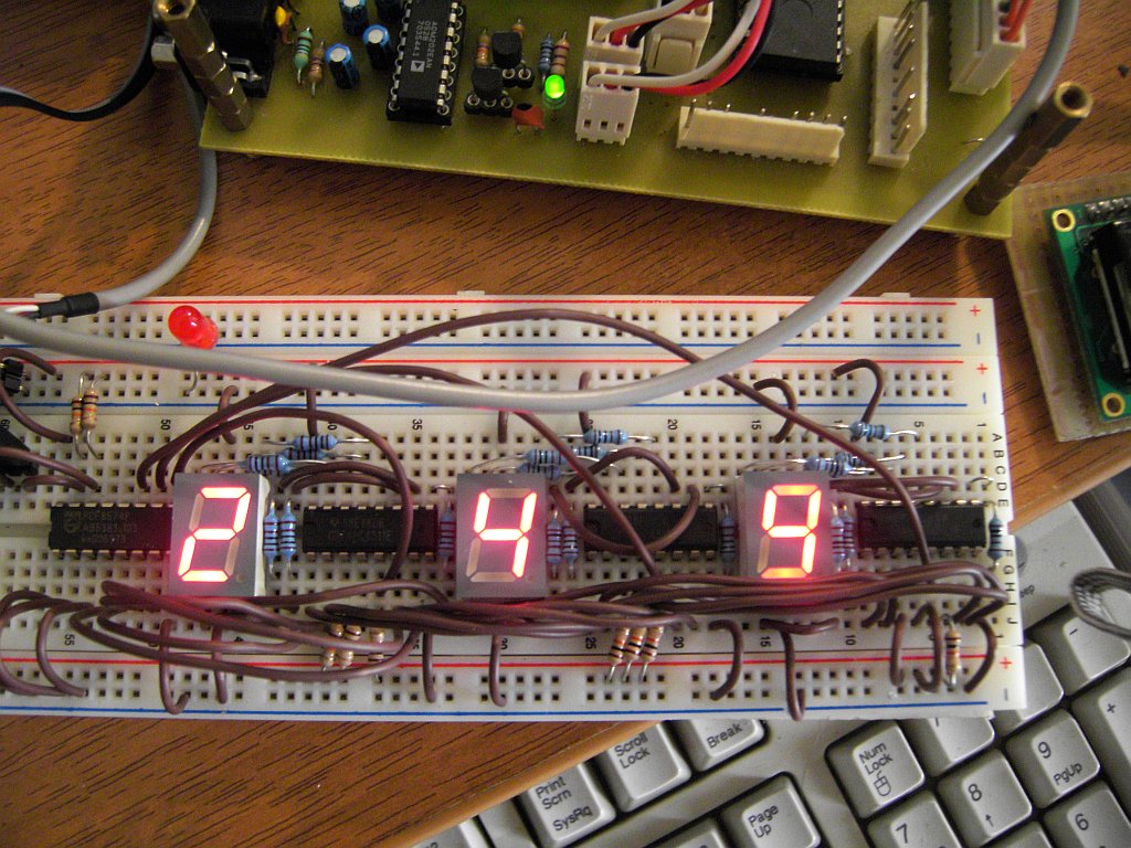

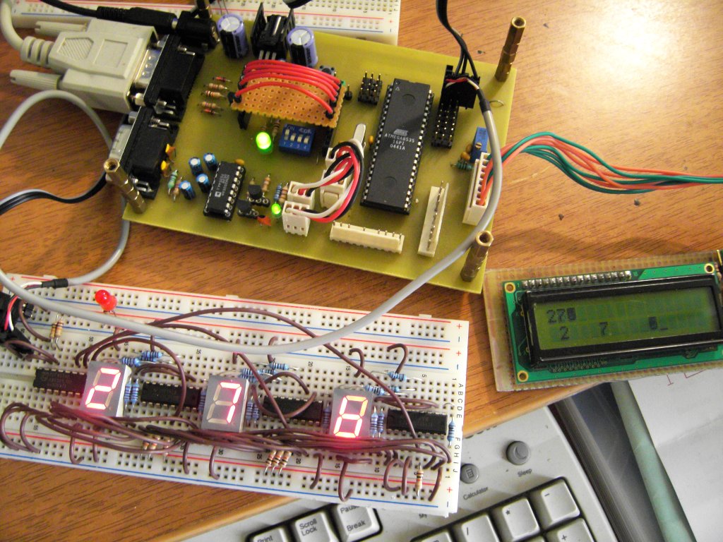

    I have great news! At last I made the digital speedometer on my AMC to work! I used an I2C chip to drive the signals to the enable 7seg lines and multiplexed their data lines with BCD to 7segment drivers. This is a design not found nowhere else around the internet
    (At least I could not find anything similar!) :D
    The hard part was the coding of the multiplexing of the 7seg numbers as I had to figure out a way to separate the speed number into three different digits. For example the number 243 into 2, 4, 3.
    The I2C chip has free one more port that I can add to it another 7seg digit, to indicate the GEAR number.
    What remains now is to make a prototype of it on a protoboard until I design a proper PCB layout. The best part is that you need only two ports of the AMC to connect the whole circuit and drive four 7seg digits!!!

    This in an update on the progress of the DIY Car Instruments project.
    I put side by side the analog (R/C servo driver) gauge and the Digital 7 segment display to see how accurate it is. They retrieve the data from the same variable right now.

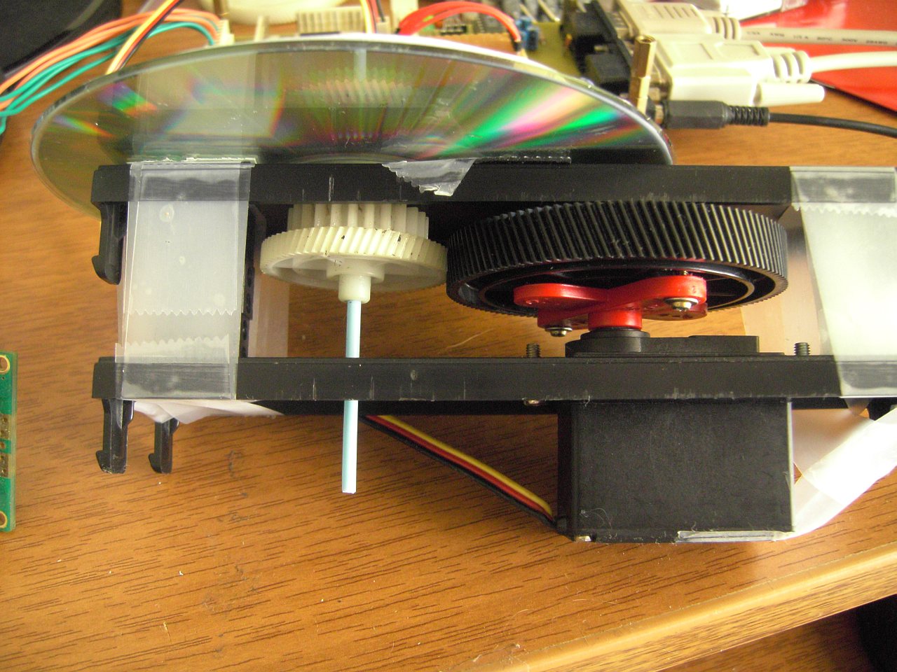

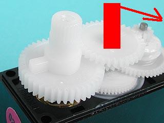

    If you disassemble servo and connect shaft with needle to centr cog (like on picture) you got mutch faster movement and bigger range but you lost some accuracy.

    @ SirNoName
    Are you shure you can positioning this winch servo? I ask'd a guy in a RC Store and he sayd that you can only use this servo's like a DC Motor, not for a clear position. (But he hasen't a winch servo there, so i'm not shure about this what he sayd)
    @ Mambo
    The range depends on the poti that is mounted in the servo. If you remove the pin then you have not much more range than original. If you get 200 degree is very good. But i ordered yesterday a poti with 300 degree, to mount external. (Normaly they use 5k poti's in servo's) like this it should work. (Already tested with an external 230 degree poti - works fine)

    you dont remove anythink, just connect shaft to the gear (so you skip one transmission and that gives you mutch more range)
  19. mboRacing
    mboRacing Member Gold Contributor
    Sep 16, 2007
    231
    Automatiker
    Switzerland -Eiken
    - 281Coins
    +0 / 1 / -0
    And also a point of interess is how many degree's did you reach with this modification??
    (Normaly the servo has a mechanical stop on max 180 degrees, and the pot make not more than 200 degree, and
    is mounted on the last gear...)
