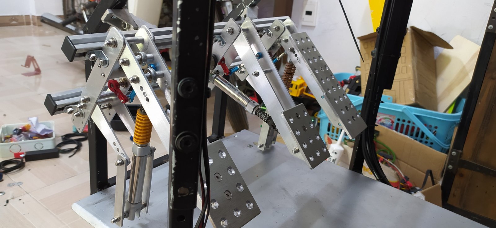

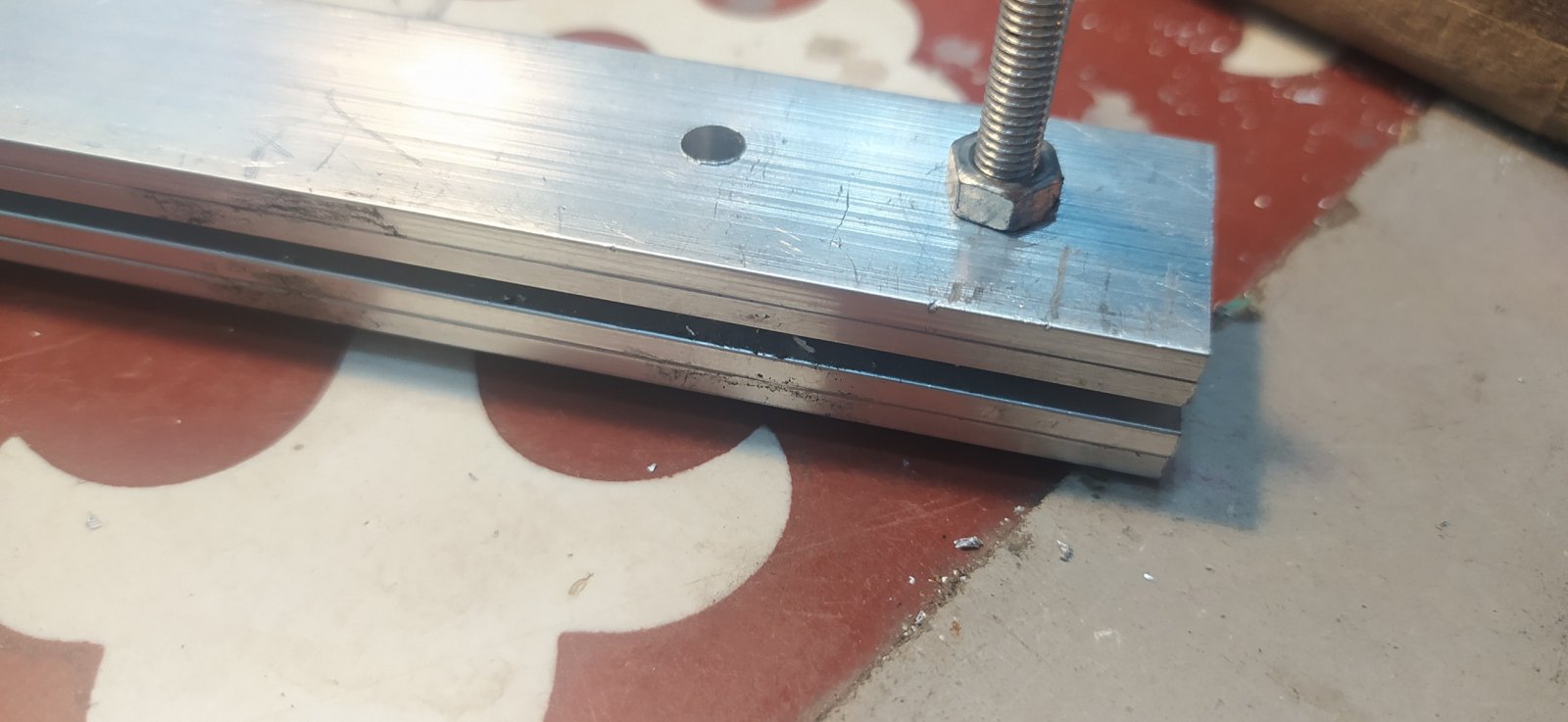

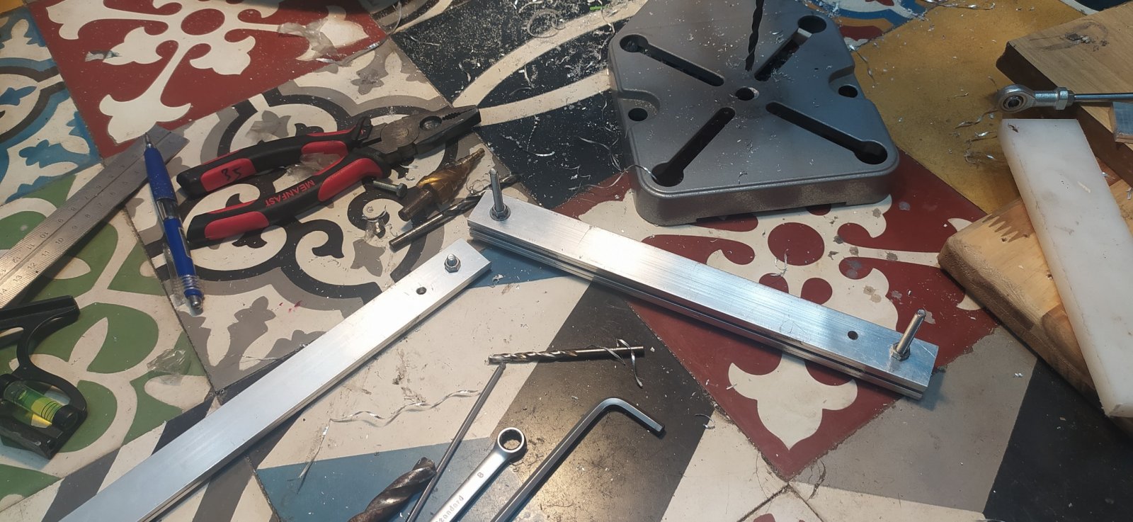

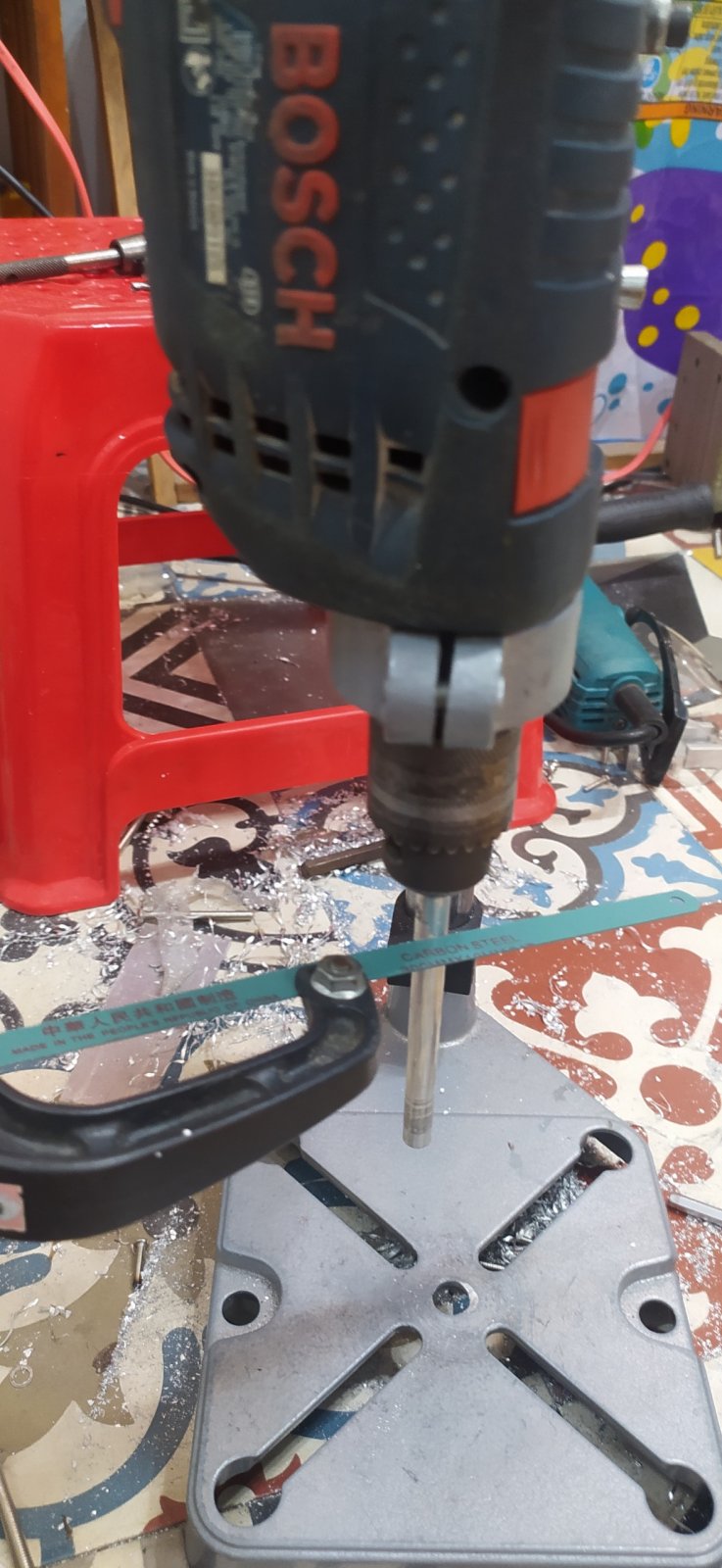

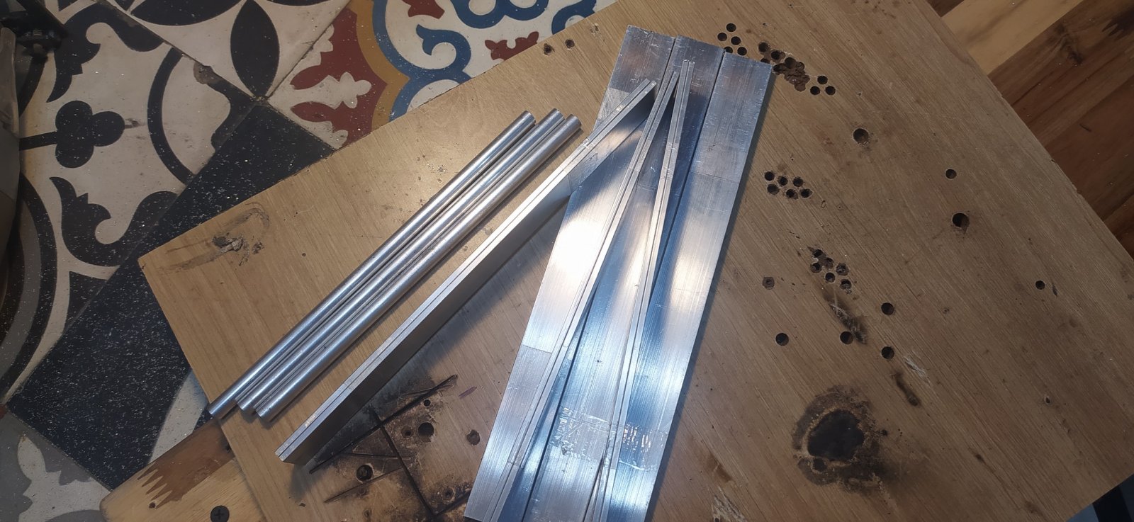

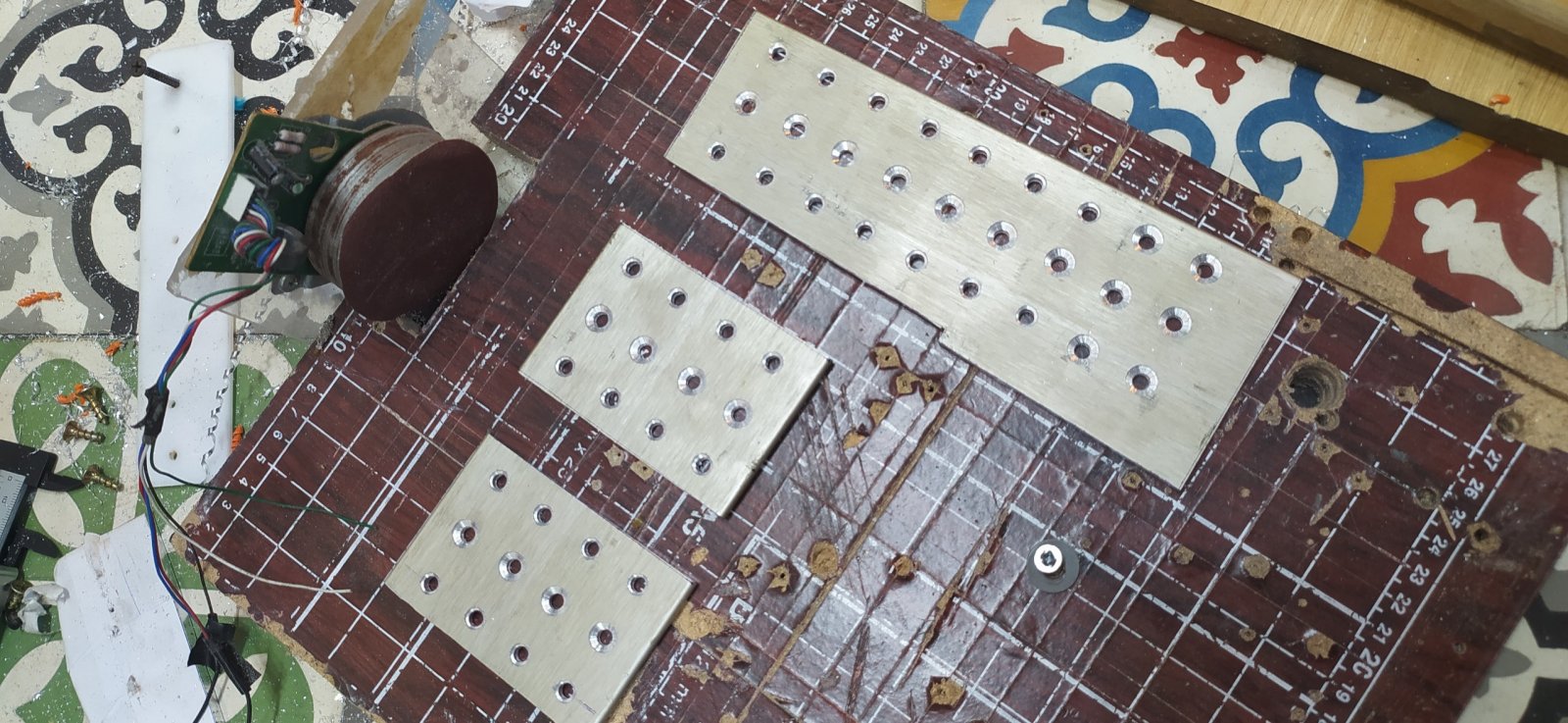

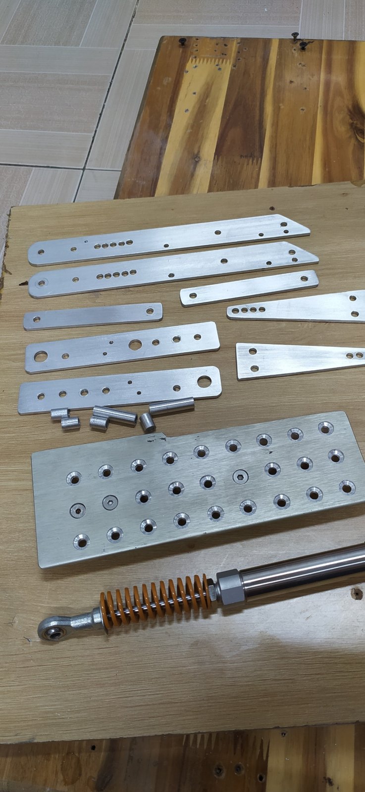

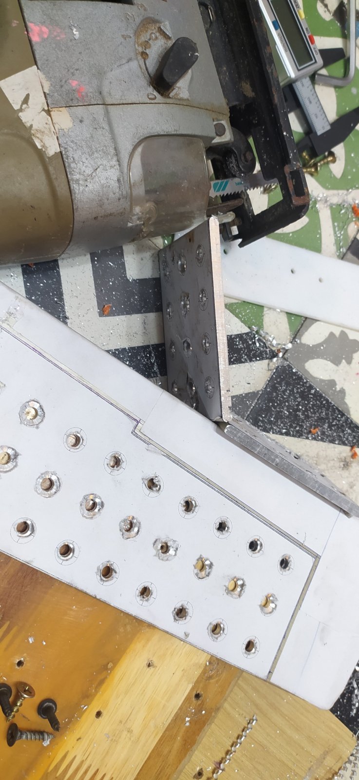

    1. I bought aluminum tube (ID 5mm, OD 8mm), aluminum bar (3mm X 25mm X 500mm), screw, bearing,...
    Manual drilling, cutting and grinding
    6a1810dc8e2e7a70233f20.jpg 8e8d3cdea22c56720f3d18.jpg 21d17c0f9dfd69a330ec23.jpg eebaeb5f75ad81f3d8bc21.jpg
    some pictures of the making process:

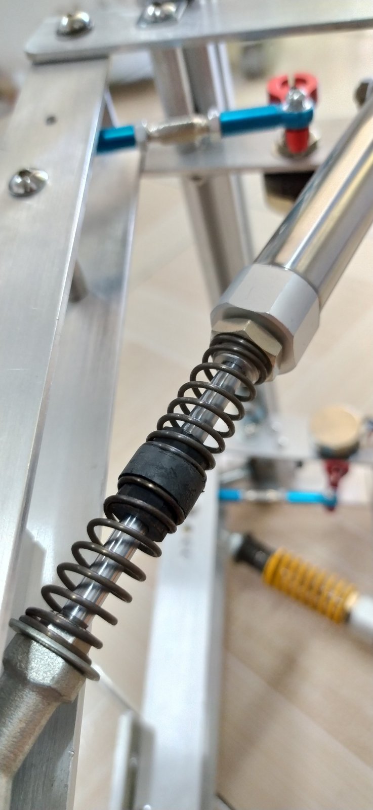

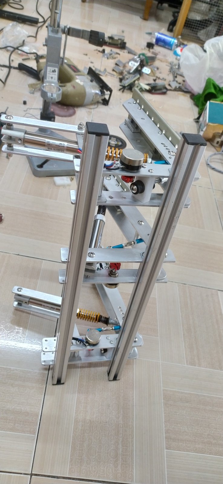

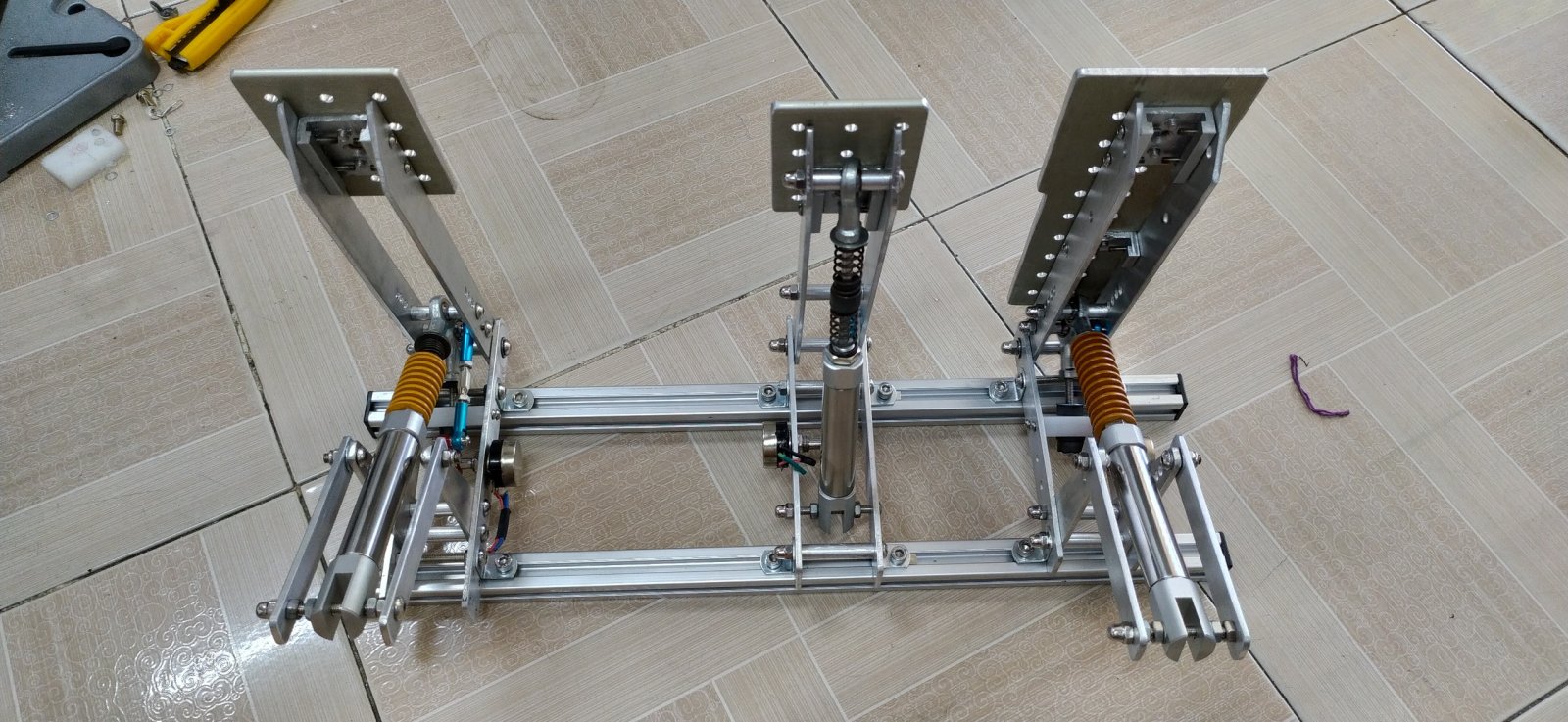

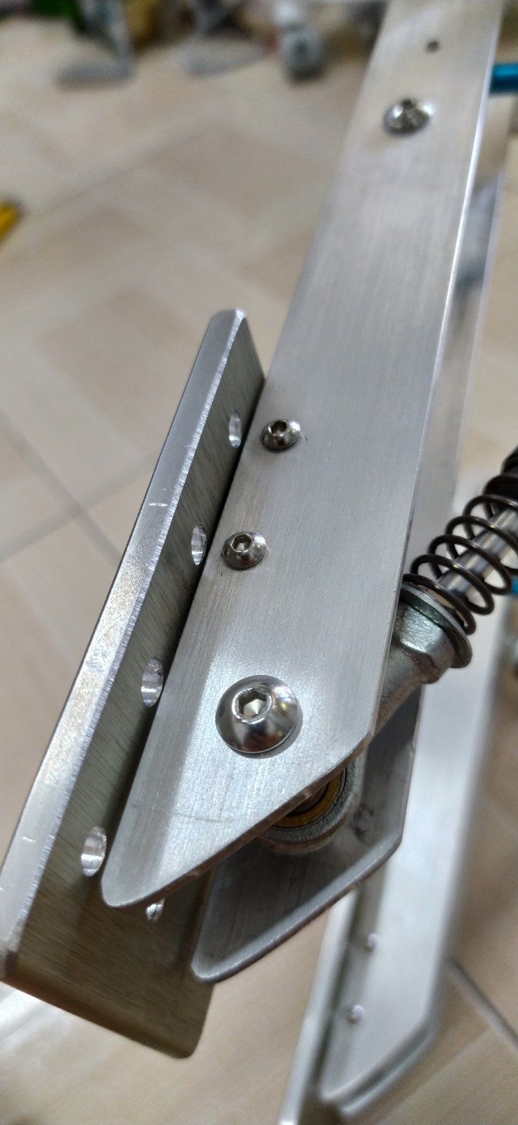

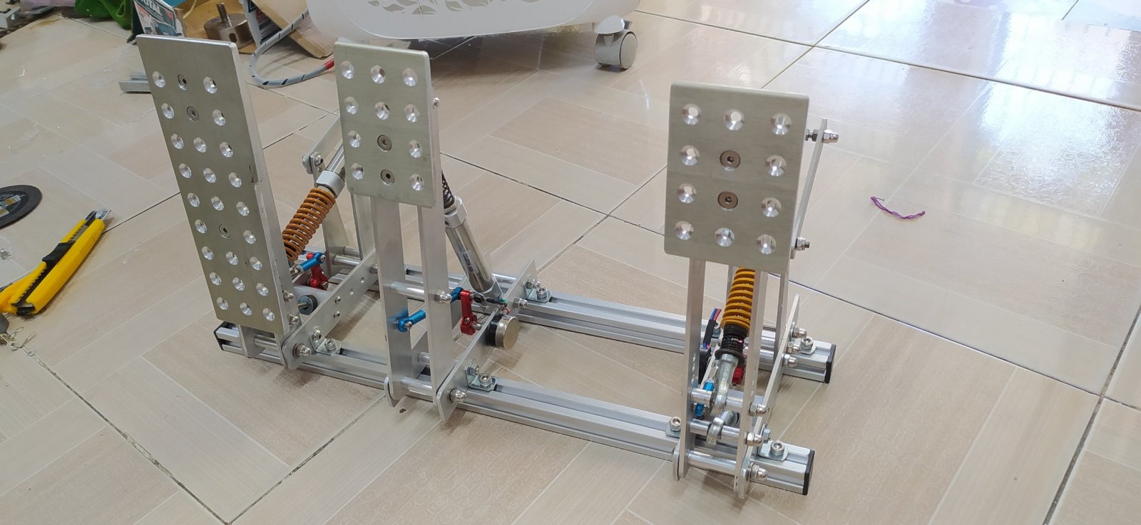

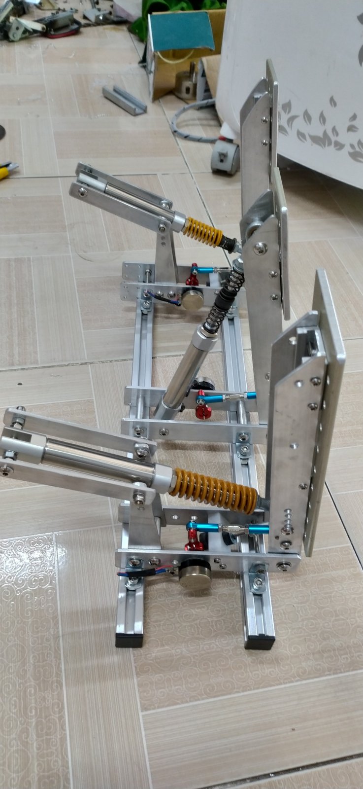

    and complete :
    0e2c9a68069af2c4ab8b14.jpg 1abd8f0115f3e1adb8e24.jpg 65fbc95053a2a7fcfeb37.jpg 93d9cafa5708a356fa1911.jpg 7120e5b67f448b1ad2552.jpg 19120b4c96be62e03baf8.jpg a9290aa69054640a3d453.jpg cab02cbfb14d45131c5c10.jpg

    Does the clutch have a feeling of engagement ?
  3. leductrinh
    leductrinh New Member
    Aug 11, 2020
    17
    32Coins
    +25 / 0 / -0
    yes, feeling
  4. Gadget999
    1,990
    12,144Coins
    +492 / 11 / -0
    Did you make the design yourself ?
