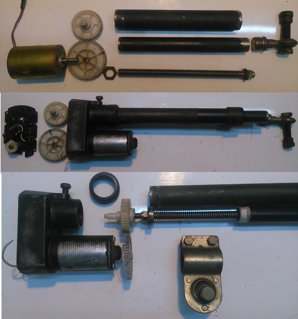

    I'm trying to make a DIY actuator, It can be done practically from improvised materials ......
    - the only question to be resolved, is the position sensor, maybe 360*-encoder or multi-turn resistor..., or something else ?
    - what can advise the guru? maybe someone have ready solution?
    Thank you.

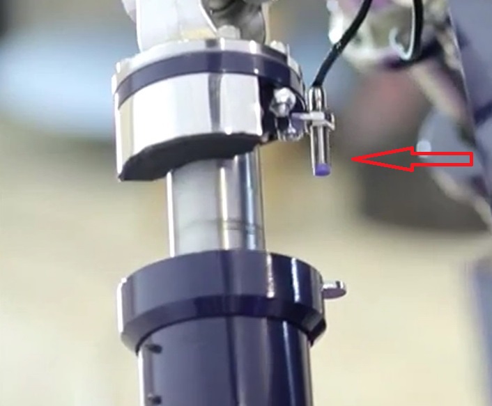

    hello @Ashraf
    did you see this.the commercial one, think for Playmotion:
    I don't know if anyone can help for way of using somthing like this
    seems works very smooth
