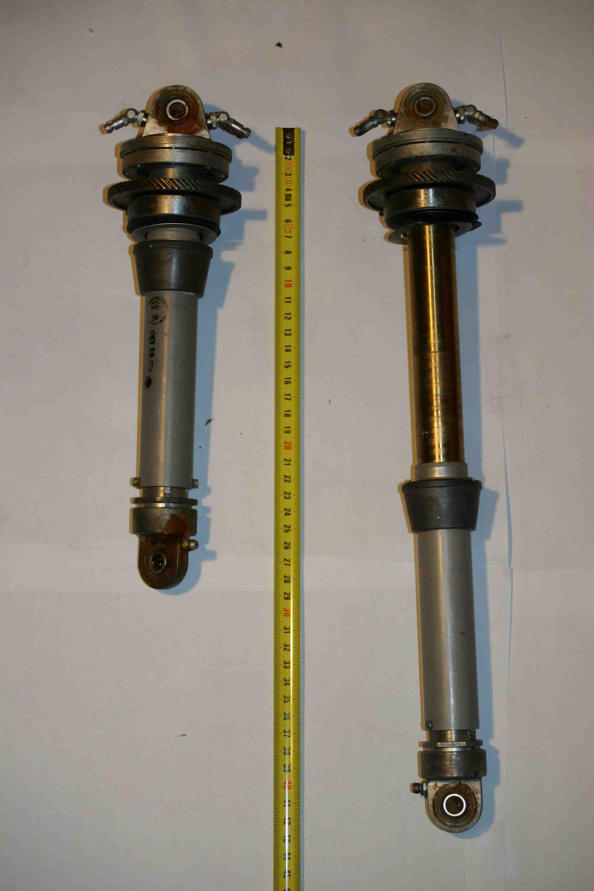

  18. OscarH
    OscarH Member
    Jun 8, 2008
    43
    Paris, France
    517Coins
    +9 / 0 / -0
    Got my 2 units this morning. Time to open the box and take pictures. Here they are...
    Look promising. Just need to find out how to stick a motor on it.
    15cm activated lentgh. Not a lot, but somehow reasonnable.

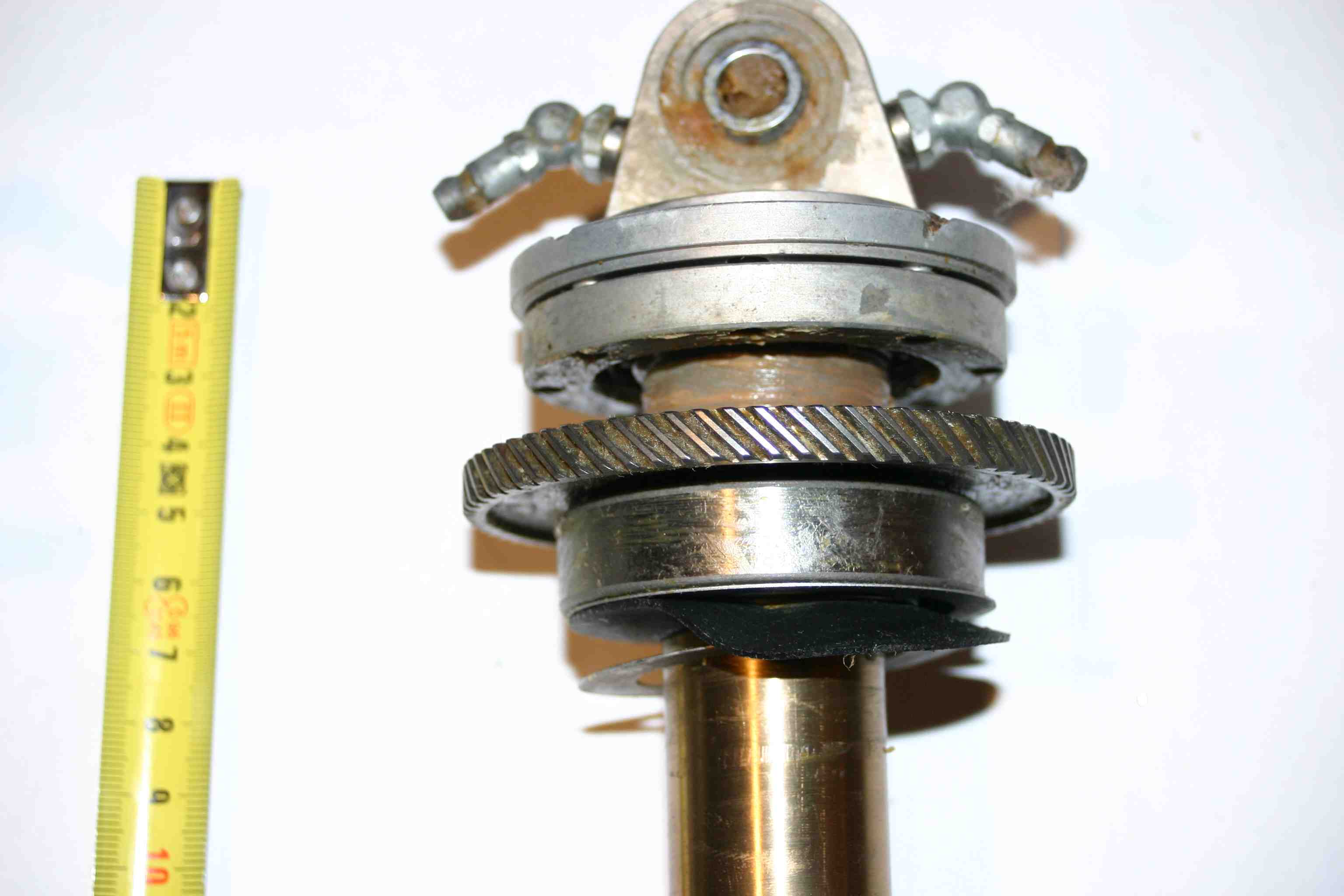

  19. devincox
    devincox New Member
    Jan 16, 2009
    25
    IT Guy/Programmer
    352Coins
    I am disassembling mine so I can get the old grease out and make it spin more freely. I am also trying to figure out how hard it would be to get the helical gear off so I could put on a cogged pulley and belt setup to fix it to a motor.
