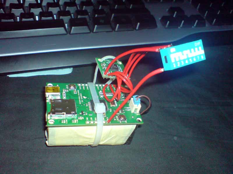

    Ok i have orderd the logger and the Triple Axis Accelerometer Breakout (MMA7260Q).
    First i will see how it works with the 3 axis and if the import to the video plug will work fine. If there is all ok i wanna order the pitch an roll sensor to complete the logger...
    I hope i will post some results soon...
    Martin
  13. mboRacing
    mboRacing Member Gold Contributor
    Sep 16, 2007
    231
    Automatiker
    Switzerland -Eiken
    - 161Coins
    +0 / 1 / -0

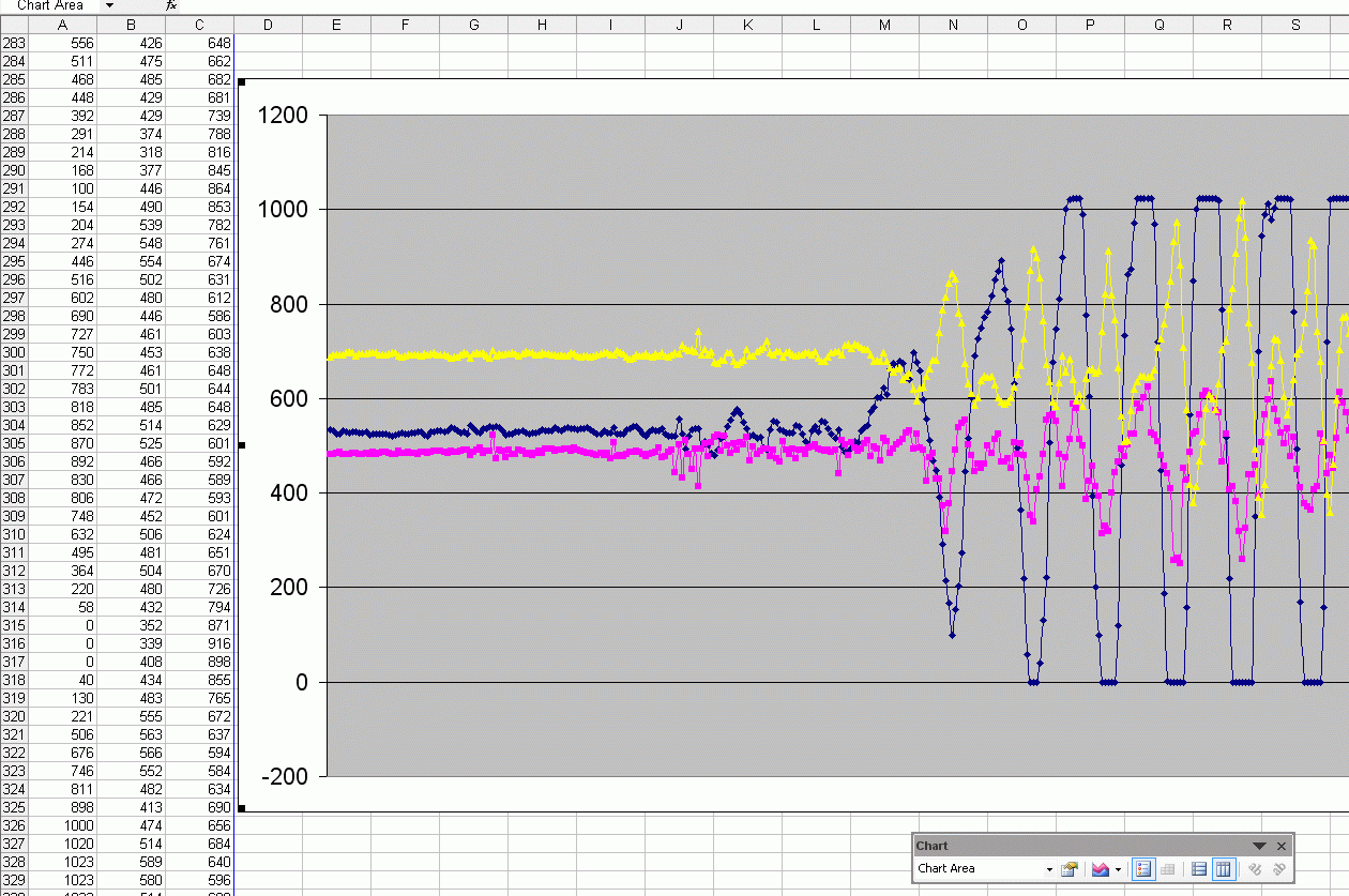

    So das ging ja mal fix: nicht mal ne ganze woche Lieferfrist von USA nach CH :clap: Kostenpunkt ist zZ bei 109$, also noch total fair :happy:
    Und jetzt brauch ich aber hilfe; ich habe mal nen Testaufbau gemacht, funktioniert auch einwandfrei, aber wie kommen jetzt diese Werte in das Video Plugin??
    Bzw wie kann man diese Werte etwas Verdaulicher Visualisieren?
    Im Anhang ist noch die Lgger config Datei und 2 Schüttelmessungen (Zuerst X dann Y und noch Z), einmal in ASCII = Y und ASCII = N

    I don't know how these values can be imported to video plugin but I could easily import them to excel and represent them in graphical axis.
    From the look of the data, you perhaps are holding the sensor in your hand and shaking it one axis at the time! :lol:
    LOF01.zip
    Thanks for the photo too! It looks really small. Easy it can fit everywhere, or even mount it on a camera to follow its view! :thbup:
    BTW, what is the purpose of the DIP switches?
    Regards, Thanos

    I was shaking the sensor first to x then y and at least to z (By hand ;D )
    the switches are to configure the G-level (1.5, 2, 4, 6 G) and i wasn't shure about the sleep mode so i have connected this signal also to the switches. It works very simple and without any
    problems...

    The excel file is in the zip file on the above post!
    I guess I was lucky on guessing the way these motion data was generated, right? :lol:

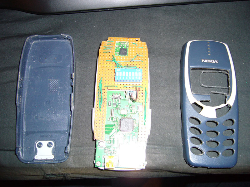

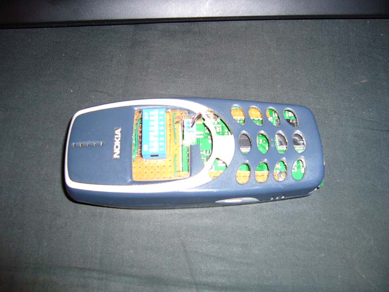

    Ich werde nächstes Weekend als Zuschauer am IRC Rallye du Valais sein : http://www.riv.ch
    Dort wird Thomas Büeler (Impreza WRX http://www.rtsw.ch/) den Logger im Auto haben und Daten + Video aufzeichnen. Werde ihm noch einen Satz X-Sim Kleber auf sein
    Auto pappen, vielleicht sieht man ihn ja auf Eurosport (mit etwas glück) : 23.8. 00:00, 24.8. 15:00 (Live), 25.8. 10:45 15:00 (Live)
    http://de.eurosport.yahoo.com/11102008/ ... hweiz.html
    Was denkt Ihr: Einstellung auf 2, 4 oder 6 G ??
    Hier die Bilder des Aktuellen Designes :D :
      File size:
      72 KB
      Views:
      728
      File size:
      143.4 KB
      Views:
      730
