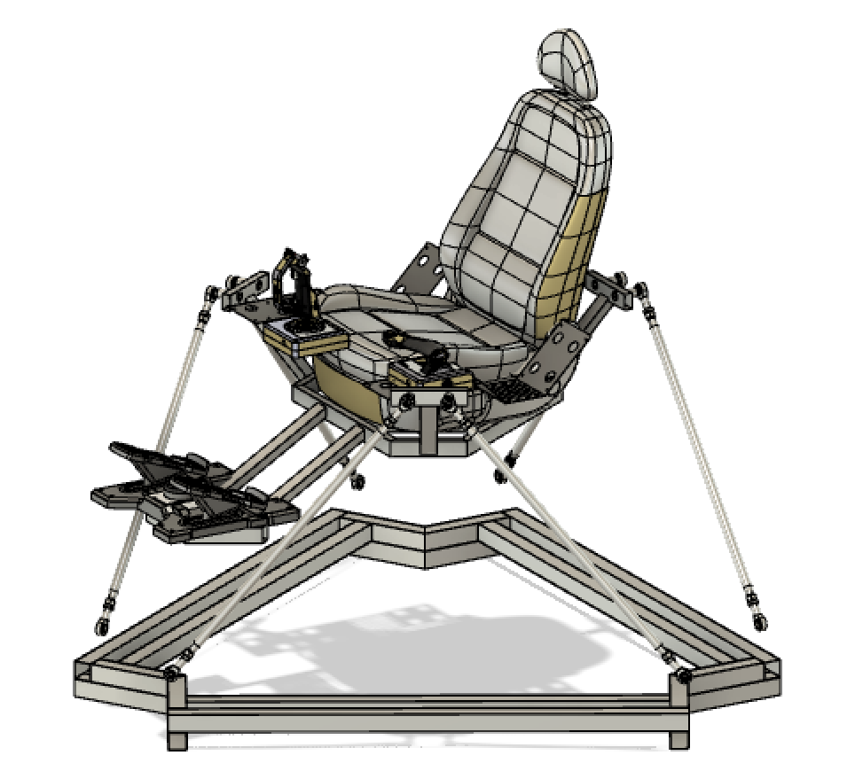

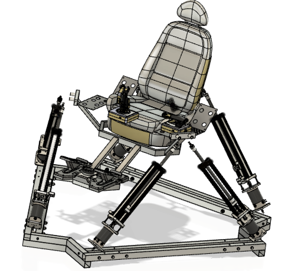

    started tinkering.....
    I'm at the point thought where I need to determine what motors I will need to spec and start perusing for what is within my budget
    as well as initially determine whether I will be making my own linear actuators or going with rotational/worm gear instead.
    at this point I'm thinking I'll be going with Thanos off the shelf solution
    https://www.xsimulator.net/community/threads/amc1280usb-motion-simulator-controller.10517/
    to take some of the heartache out of the controller aspect.
    I've followed the plans from this post
    http://motionsim.freeforums.net/thread/176/dof-step-diy-project-blueprints
    as I like the idea of being able to disassemble the base for transportation (if required)

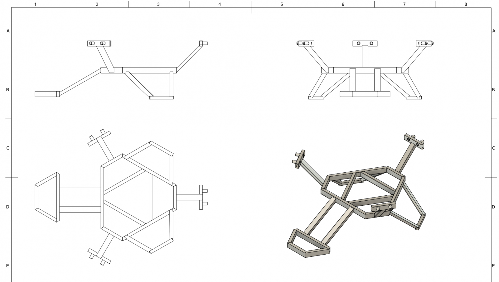

    I've tweeked the upper platform so that it is slightly recessed and has a pedal shelf extended and lower, this will need to be watched carefully for collision potential when I start animating the platform.
    I've thrown in some steel rods with rod ends at 800mm just to kick me off for height.
    once I know what actuators & motors Im going to go with, I can replace these components with the real units and get some motion happening.
    I'm sure there is much more tweeking of the frame to come to alleviate issues and eliminate collision impact points...

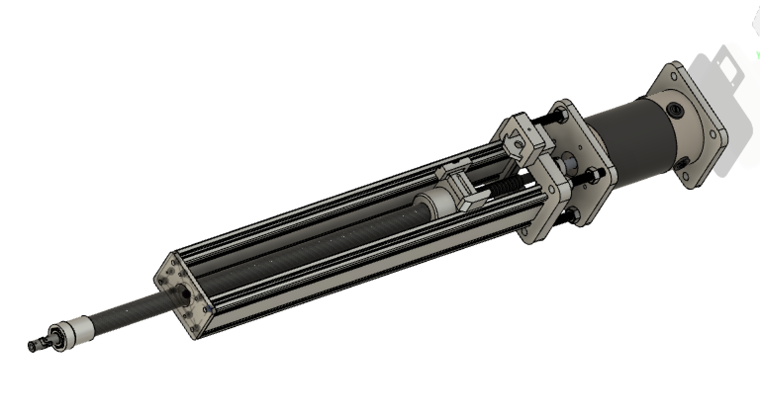

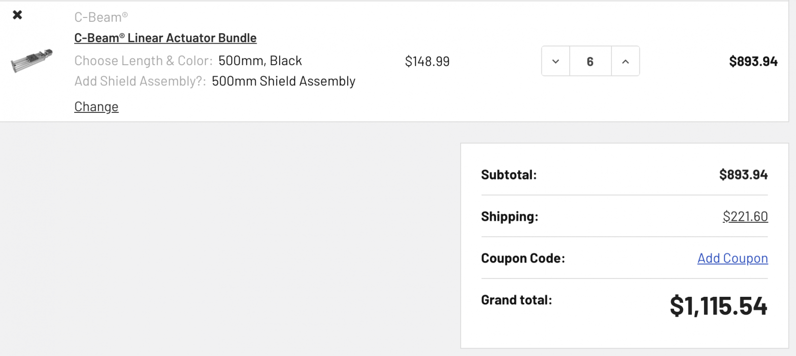

    I noticed a post here about linear actuator bundles
    https://www.xsimulator.net/communit...th-a-bunch-of-stroke-options.6750/#post-75329
    https://openbuildspartstore.com/c-beam-linear-actuator-bundle/
    Was there any feedback on whether this bundle could handle the being beef'd up with a larger motor
    (i was thinking along the lines of something like this: https://www.motiondynamics.com.au/120w-4100rpm-12-24-dc-straight-motor.html )
    Does anyone think that the bundle is cost effective?
    given that I would still need to change the top plate & pillow block as well as the tube assembly & connection
    My battle with Fusion360 continues and its slowly taking shape.

    I've tweeked my upper platform slightly and the model is almost completed so that I can begin creating pivot points to start animating and inspecting for collisions
    I've added a tapered step at rear on each side for easy access,
    (& allow for the platform to sit upright on its own)
    hopefully without too much additional weight and they don't get in the way
    but given that they are slightly outboard as well, there is slightly more lever ...
    I havent dont any motion joints yet to perform an assessment of potential collisions
    so they might need to go
    it would be nice to keep at least one, if so it would be mounted on the right side
    to even up the additional weight of the warthog throttle on the left hand side (& slightly forward).
    once thats complete I will then need to learn how to use simtools
    something I'm actually quite dreading...
    (if I cannot work out how to do the proof of concept I'm not going to get very far.)
    interested on thoughts from anyone

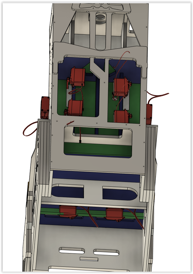

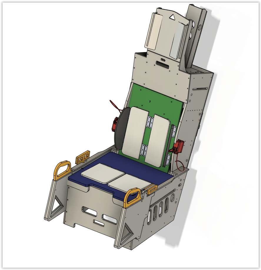

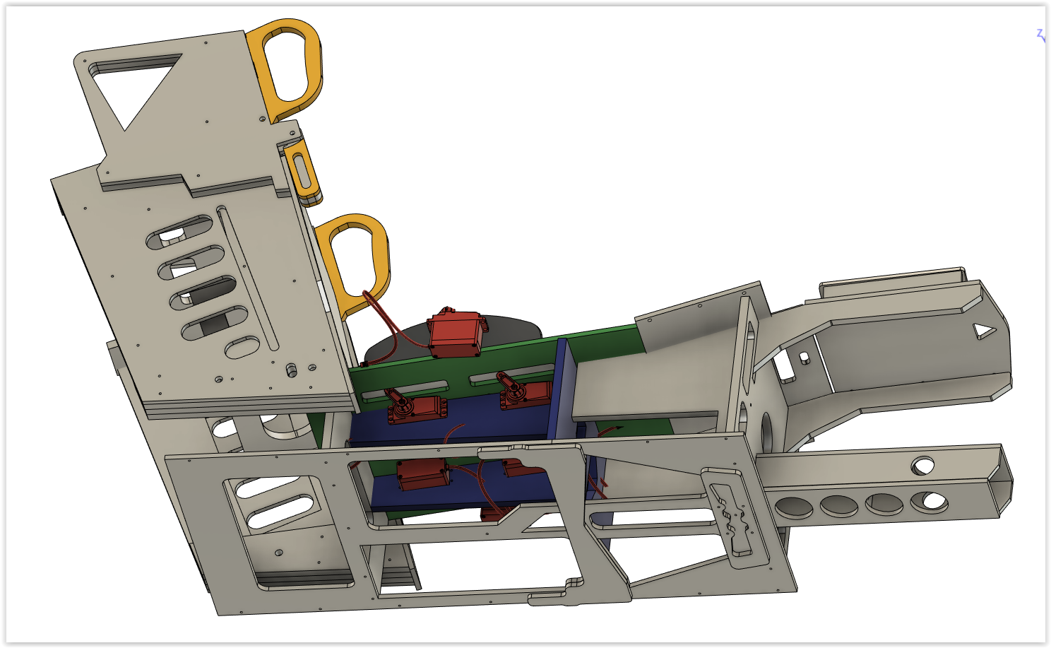

    I have become a bit distracted and been considering options.
    But I have been keeping myself busy and got myself the plans to the A-10C seat and have been merrily modifying it so that I could incorporate a G-seat into it.
    the side servos would have to have some sort of cover, probably just source a electrical junction box and hack it out a bit...
    the only panels that required modification are indicated in blue and green so the seat remains for the most part true to the original design
    Im considering building the entire A-10C simpit & then placing it in an enlarged 'dream-flyer' 2DoF tilt platform (~10<13 degrees pitch and roll) and the g-seat would then compliment that.
    (Massive footprint though)
