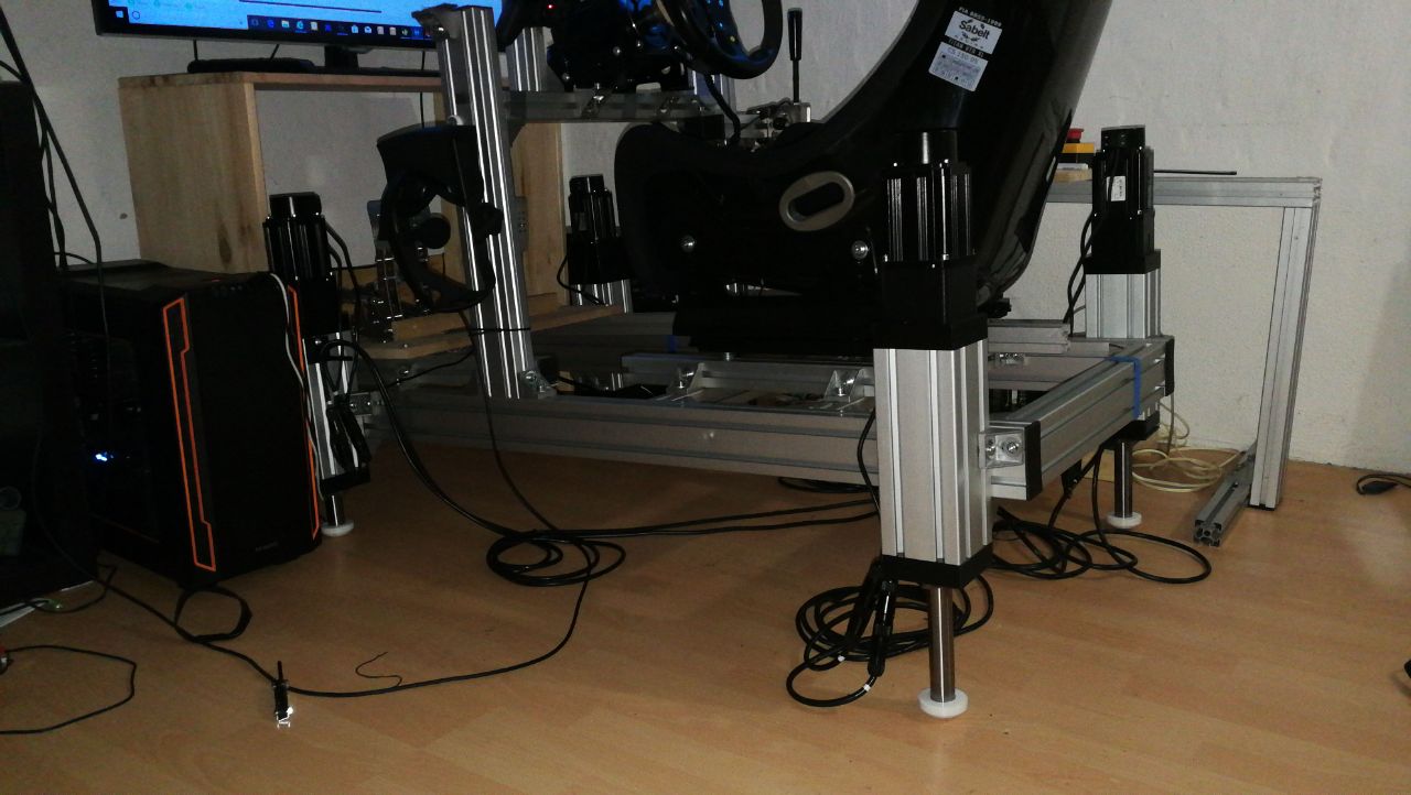

    Hi guys, the project is public now, so everybody can build it. You can find the documentation,shopping list, software .... here
    https://github.com/SimFeedback/SimFeedback-AC-Servo/wiki
    First, this isnt running Simtools. Its based on my friends ideas and he was so nice to let me also build them and use his software , this one is his ...
    It should inspire you, the cost of one actuator is about 400 Euros, all together .. The Black and white parts are printed with pla ... if you do alloy, it will raise the cost , sure ..
    If you go to aliexpress and search for that 750W Servo motors you can get them around 240 Euros shipped incl dutys and vat .. incl VFD .. unbelievable cheap .
    We used this , some times you get special offers .. payed 220 USD plus shipping
    https://de.aliexpress.com/item/HOT-...25c8-43ae-ab41-6c3a16a5f793&priceBeautifyAB=0
    The rest is standard pieces ..

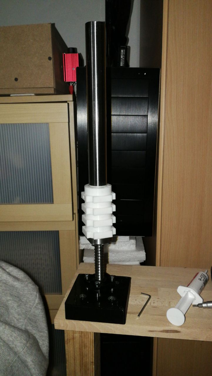

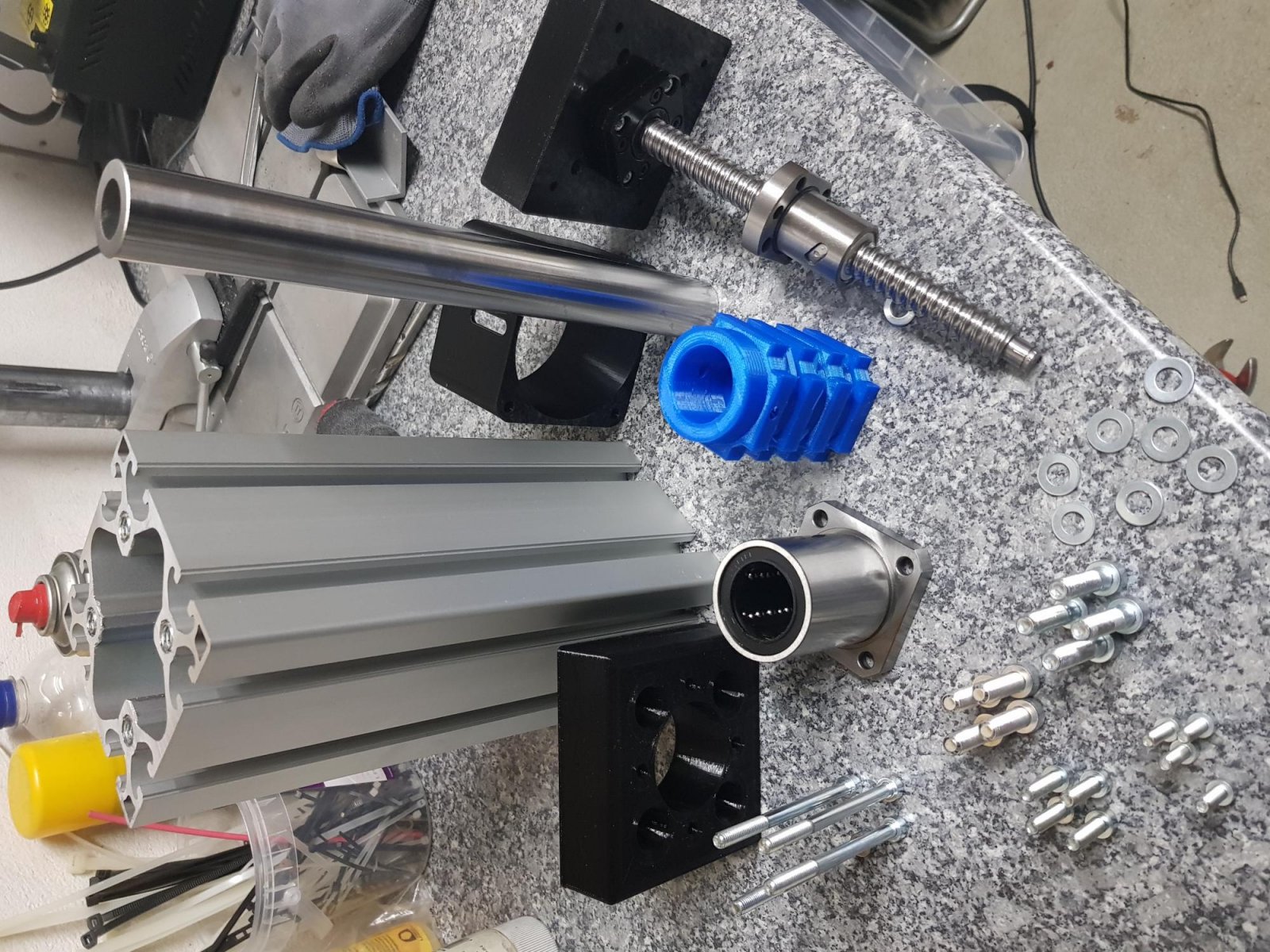

    1 x FK12 / 12 Euro
    1 x LMEK30UU / 12 Euro
    1 x Hollow Shaft Tube 30h6 / C60 280 mm /16 Euro
    1 x Coupler / 12 Euro
    1 x Alloy K50 100x100 250 mm / 25 Euro
    1 x Chinese Spindle 1605 / 23 Euro
    1/4 x of an Arduino Leonardo ~7 Euro
    1 x DB25 Adapter ~ 7 Euro
    1 x DB25 Cable ~3 Euro
    about 600 gramm PLA per Motor
    Some Screws
    AND a lot of time to print :)

    Awesome rig. I've always wondered what happens to these designs with 4 actuators for legs when one corner lifts higher or lower than the rest by a large amount. Does it smack back down to the floor?
    What method did your friend write to the drivers with? Step dir, pwm, can bus, serial, etc?

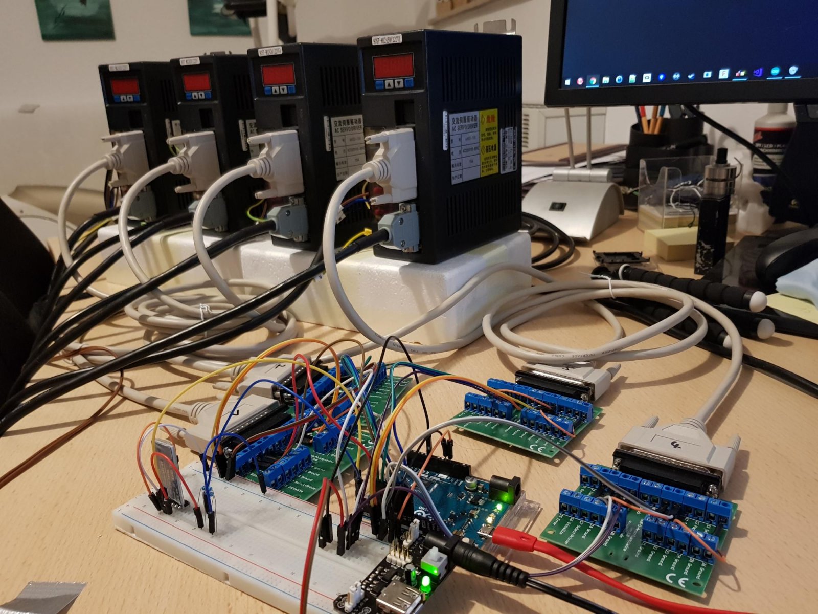

    Can you explain the components for this project.
    4 x MiGE servo + motor controller
    Code:
    https://www.amazon.com/Controller-NEMA34-Industrial-Control-AC220V/dp/B06XB9J34Y

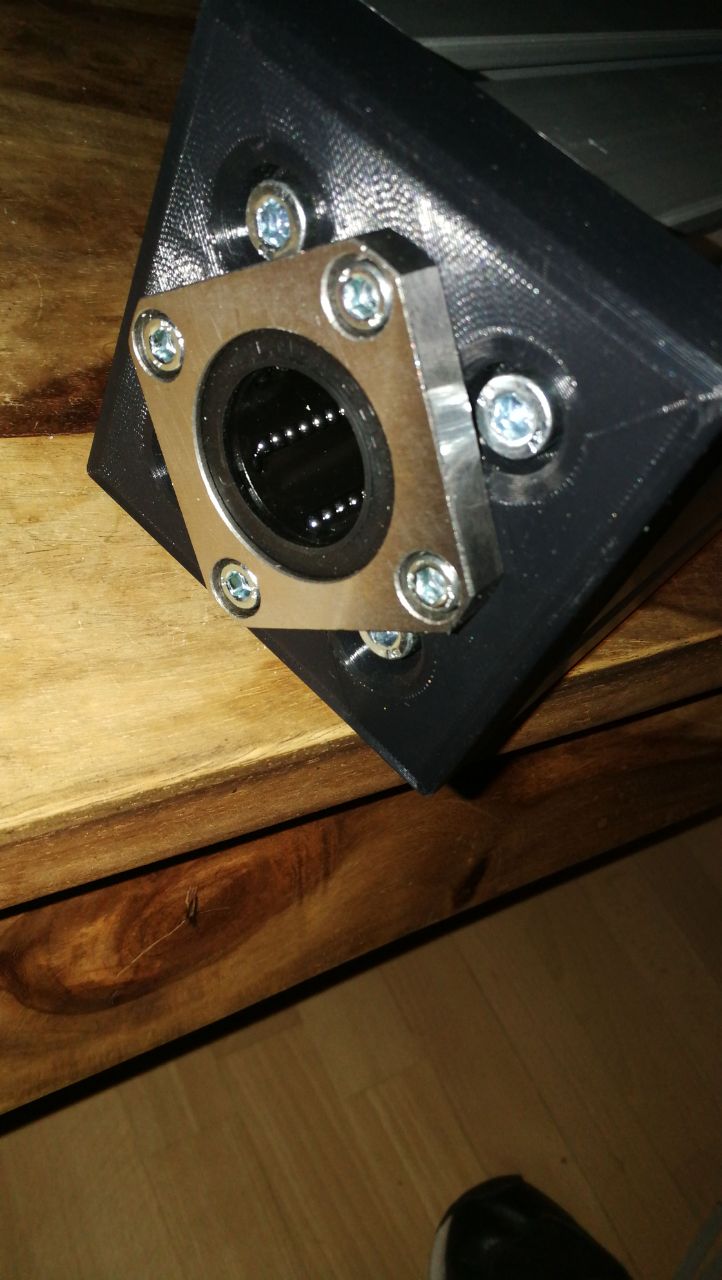

    The actuator components :
    - 100mm length T-Slot profile ? 80x80mm
    - Fixed bearing and ball screw (1605)
    - 30mm hollow axle
    - 3d Printed (black) Motor, fixed bearing and plain bearing holders
    - 3d printed (blue) guide
    - nuts and bolts
    1 * Arduino as the motor controller
    A PC running SimFeedback
    Are there other components ?
    Arduino shield, bread boards, parallel port / USB adapters.

    @cfischer , dont know exaclty :) Never had this or it just follows were the most weight is (back). But i dont think that a situation where 3 are up and one is down happens ..
    You must ask him for programming .. Contact on youtube for exmple

    I mean the Interface Plugin and a simtools compatible arduino Sketch.
    Motor Controller is Incl with every Motor .... You only need a Power Plug and a db25 cable to Send Data to a arduino.
    1 arduino For 4 motors is in use at the moment...
  14. SeatTime
    28,370Coins
    +2,844 / 39 / -0
    Ok, good job:thumbs. But normally the voltages out of a Arduino are not suitable to interface directly into a Servo driver. Just for members Info, the 1280's that I use to drive my sim, can interface to a Servo driver (using standard Simtools Plug-ins), via a daughter board to handle the voltage/other requirements. Latest info here http://motionsim.blogspot.com.au/2017/06/new-linear-servomotor-actuator-solution.html .

    The voltage level for the position and direction line is 5v, so no problem at all.
    Even a 3,3V controller, like a teensy can be used, because high level (1) is everything above 2.5v.
    Open drain setups are feasible too.
    Supply voltage can be a problem. Normaly between 12-24v is required.
    But these servo drivers work like a charm on 5v.
    Closed loop systems can be driven even by simple micro controllers like the arduino because you only have to send the position and the driver will do the heavy lifting jobs, like keeping track of the position or derivations.
