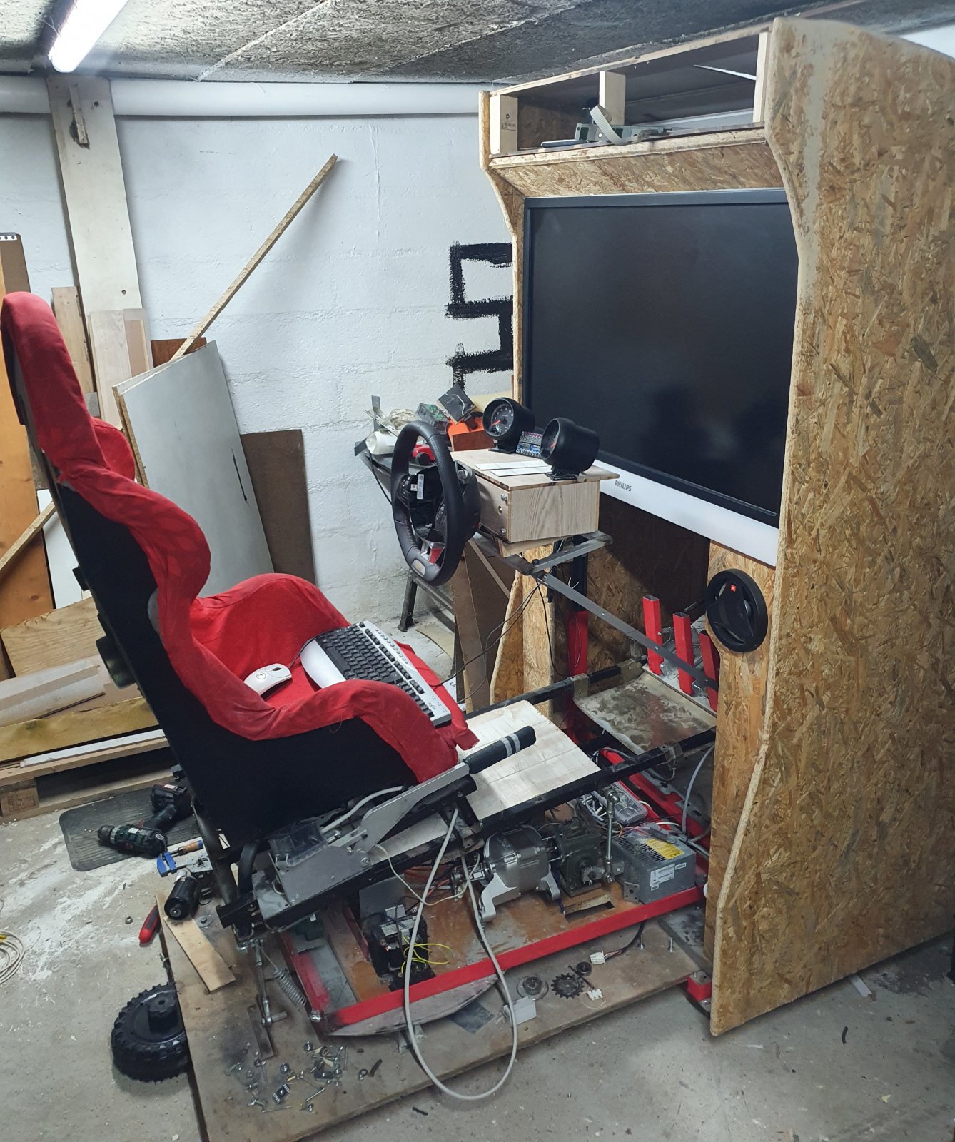

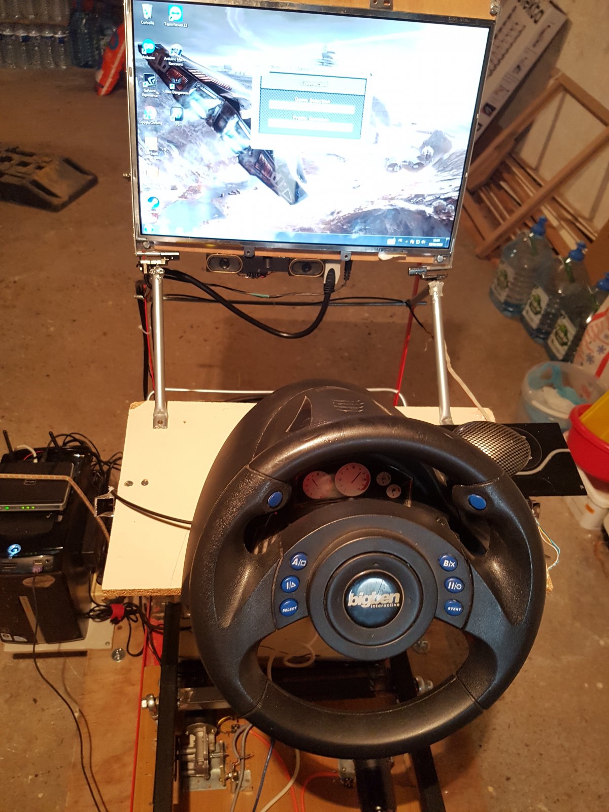

    Hello everyone
    it's been a while since I browse the forum and I admire your creations, then I told myself why not make one too.
    So I started building a simulator while mobile 2dof + effect yaw.

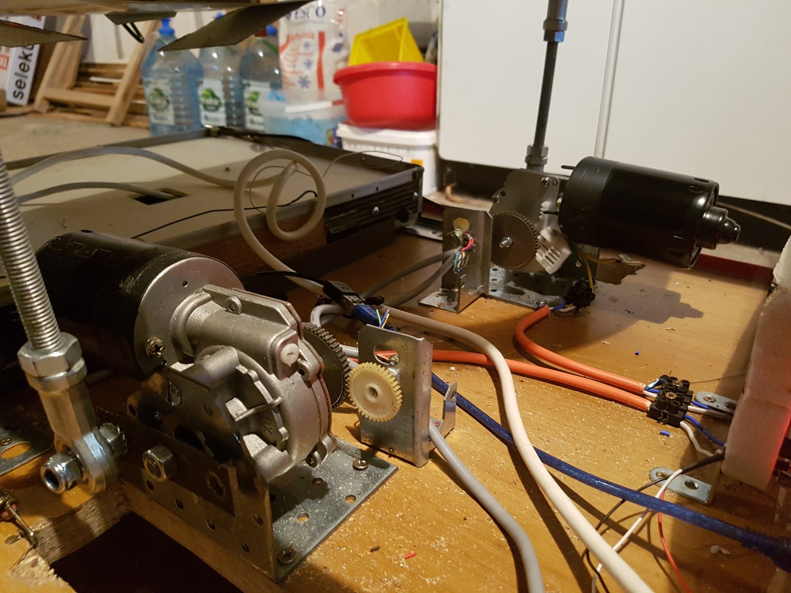

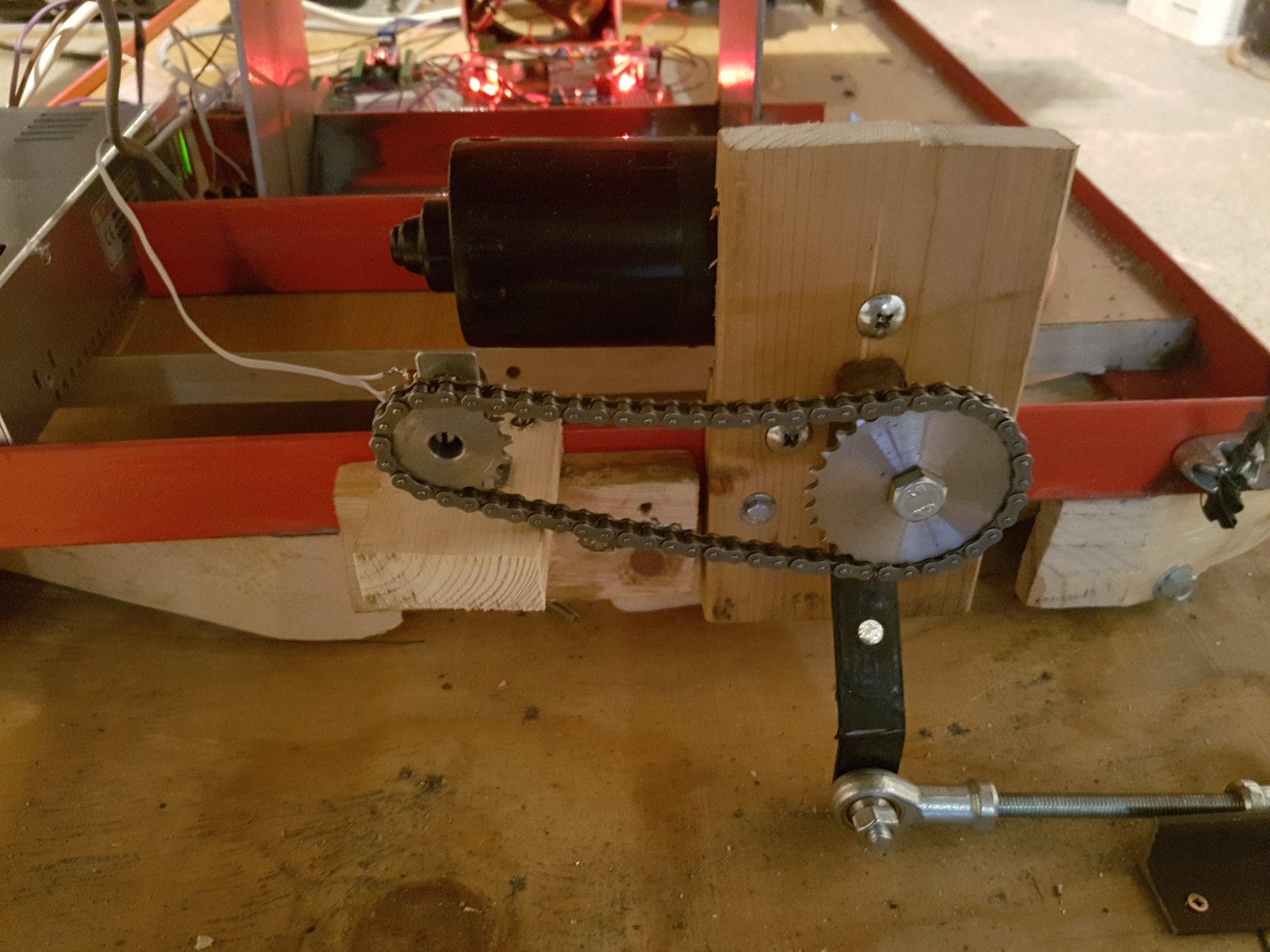

    my simulator was built with as much salvage as possible.

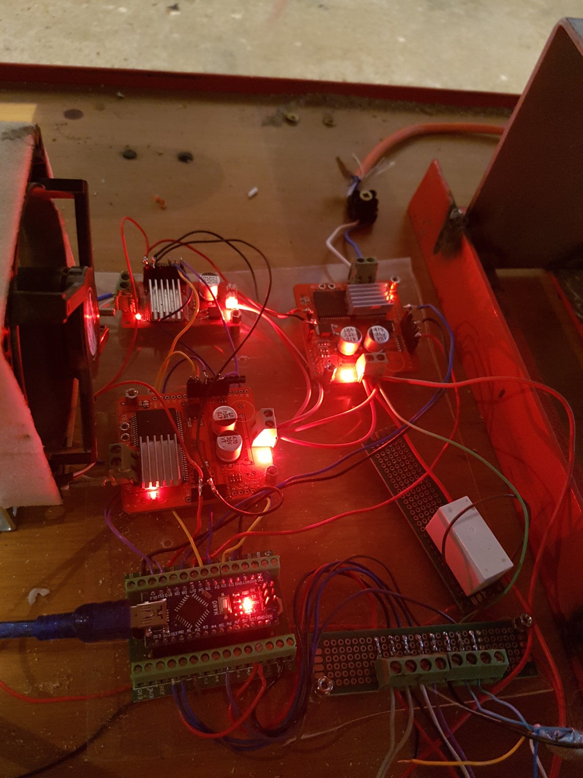

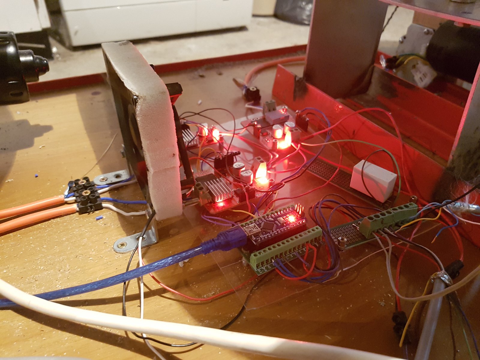

    the system works with a nano arduino, 3 moto monster vnh2sp30 and 3 wiper motors.

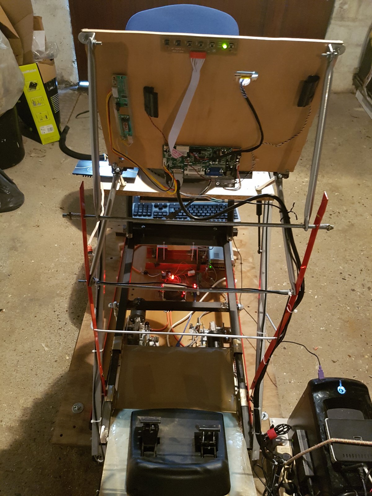

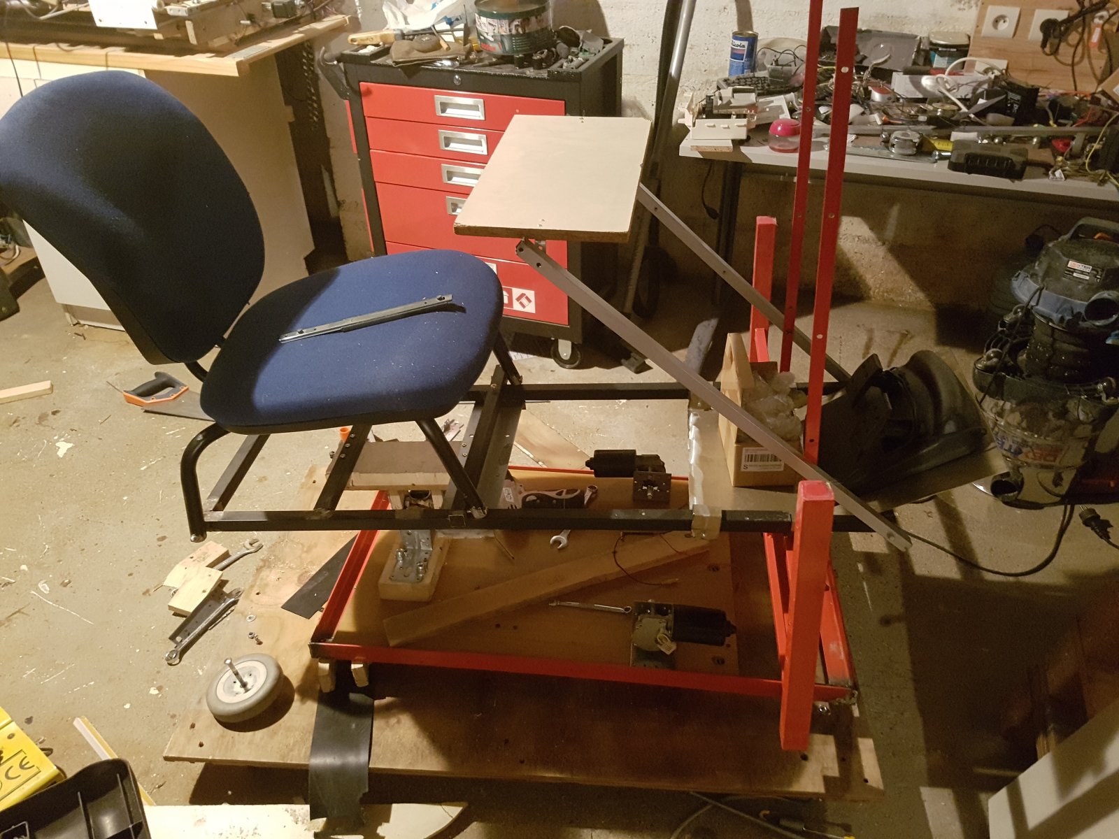

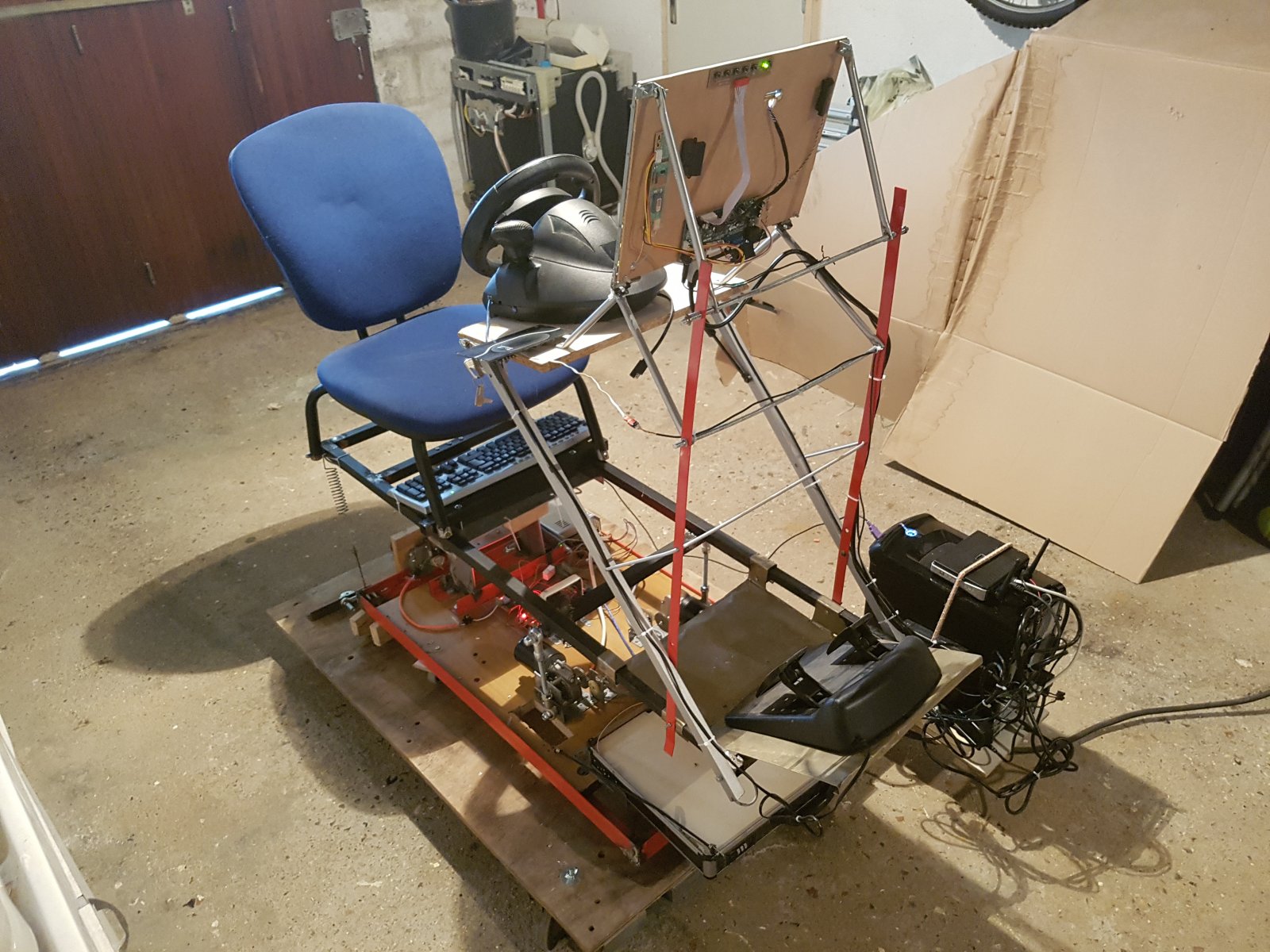

    construction stage :
    the playseat.
    wheel for yaw effect movement
    assembly and positioning of engines 2 dof
    motor axis
    electronic
    screen support

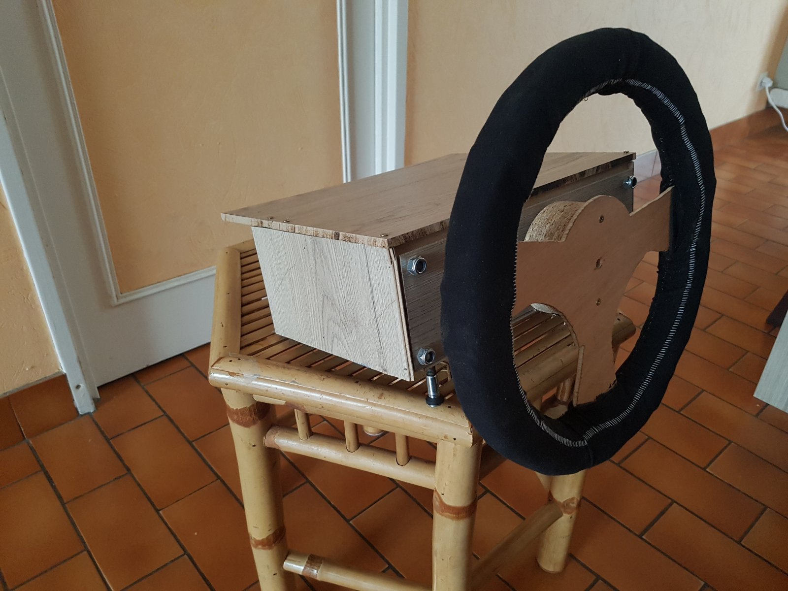

    New project for my simulator!

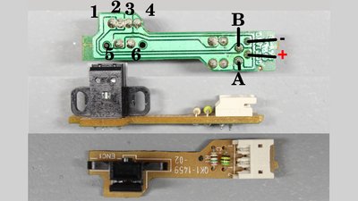

    Bored with my steering wheel, former Playstation 2 wheel modified by me to make it compatible with PC and having no force feedback function which makes my simulations not very realistic, so I will make a new one with force feedback 100% home made to stay in the theme of my simulator but also for a reason of money.
    I will post some photos throughout the project.

    Construction of a steering wheel and a base for my steering wheel project

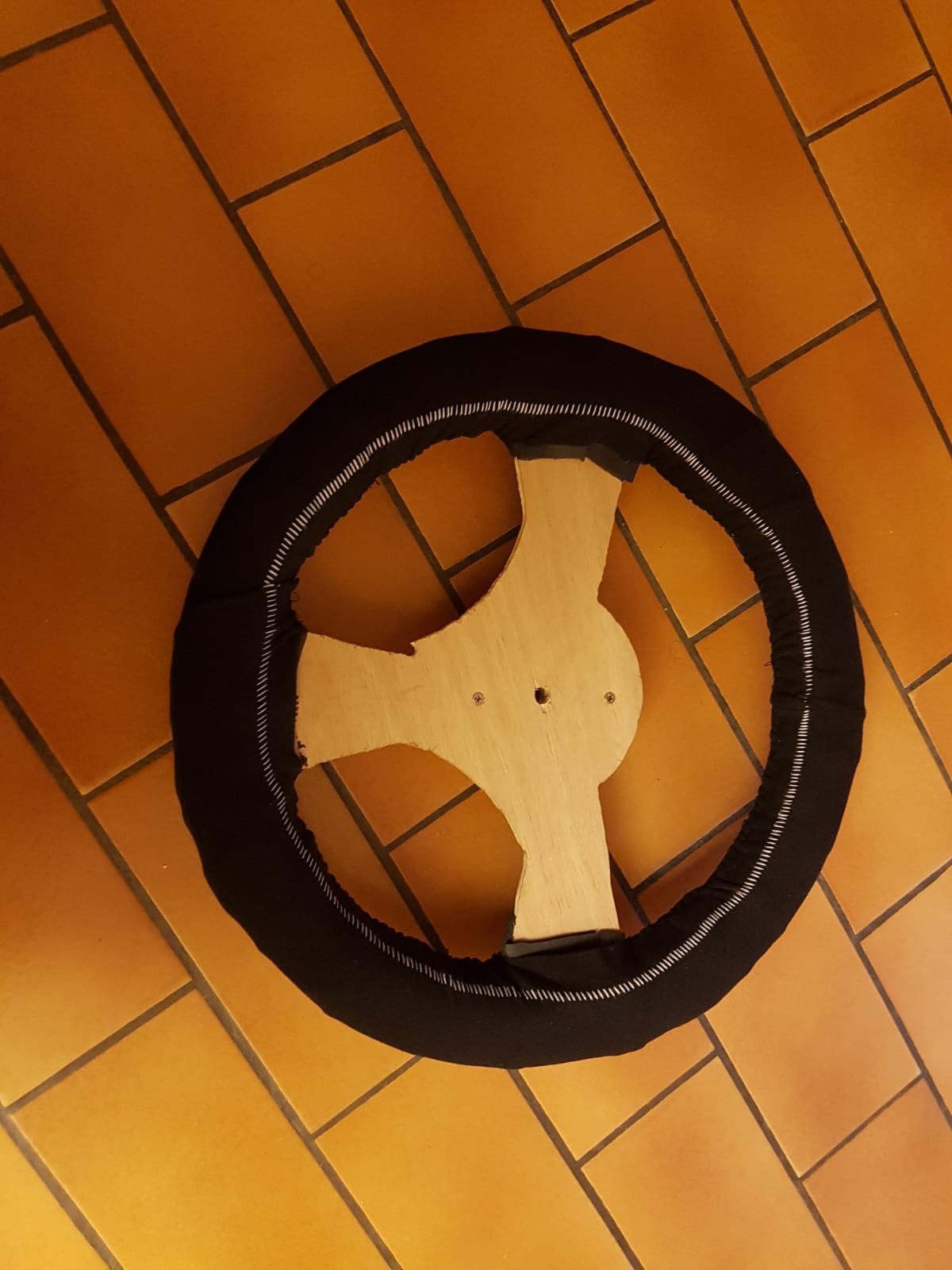

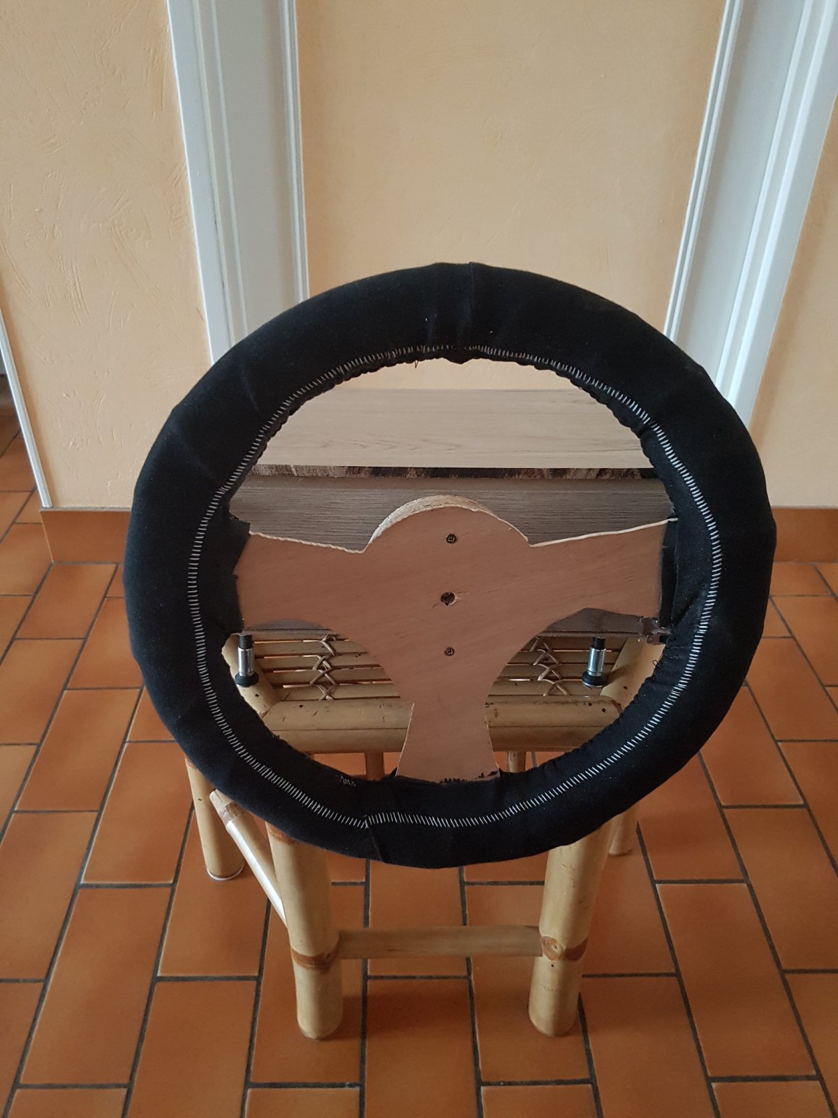

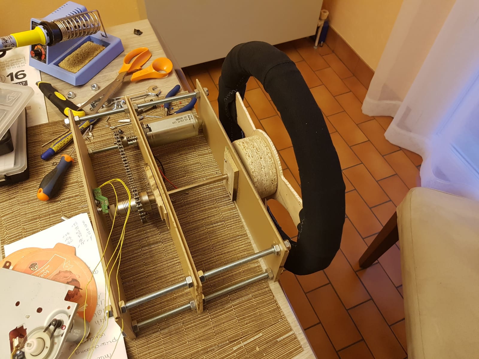

    Manufacture of the steering wheel in 5 mm plywood, covered with 2 layers of foam all enclosed in a black cotton fabric (much more aesthetic and pleasant for the hands).
  7. hoyang
    hoyang handyman
    Dec 14, 2017
    94
    Bricoleur
    1,337Coins
    +93 / 0 / -0

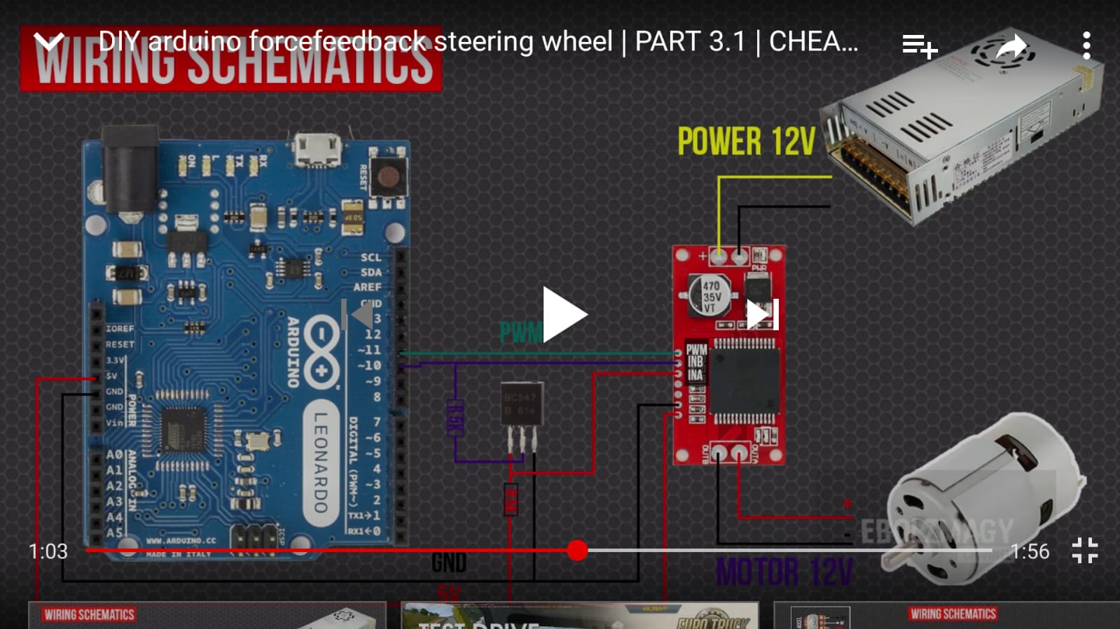

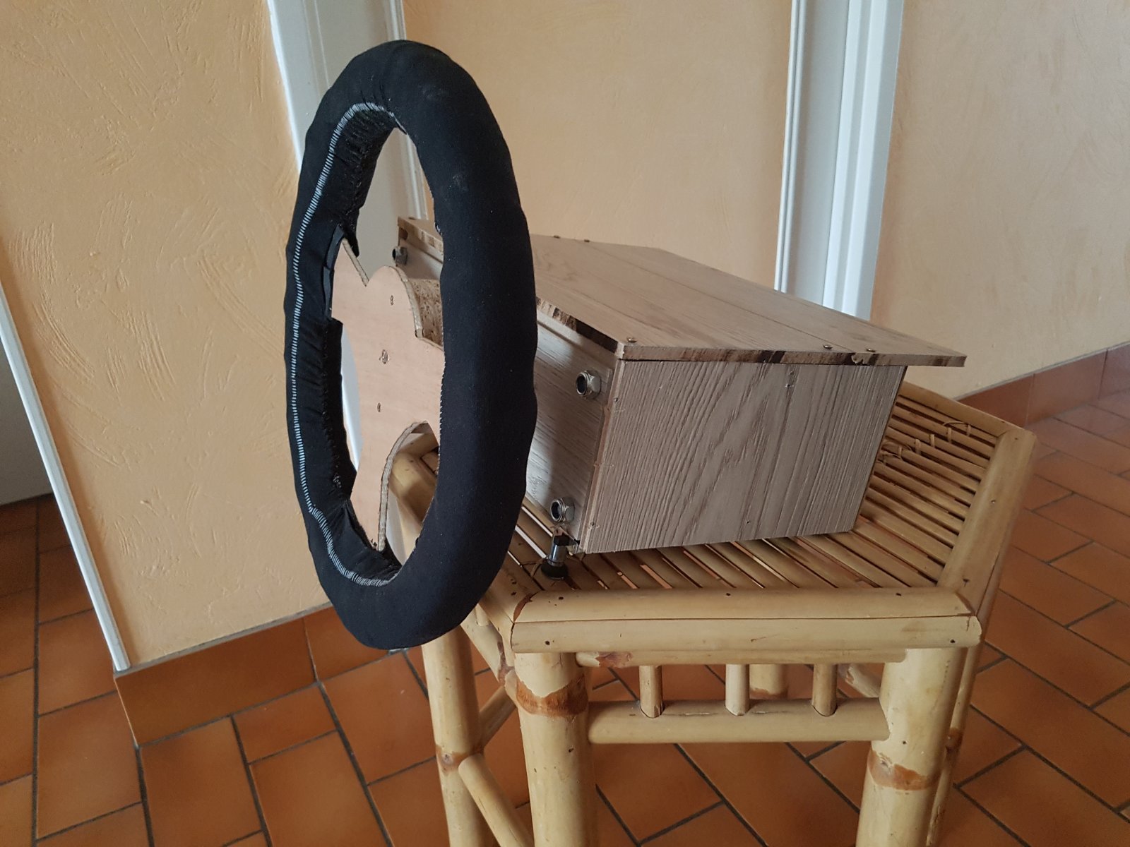

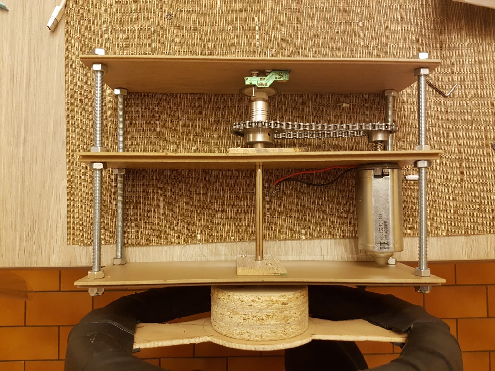

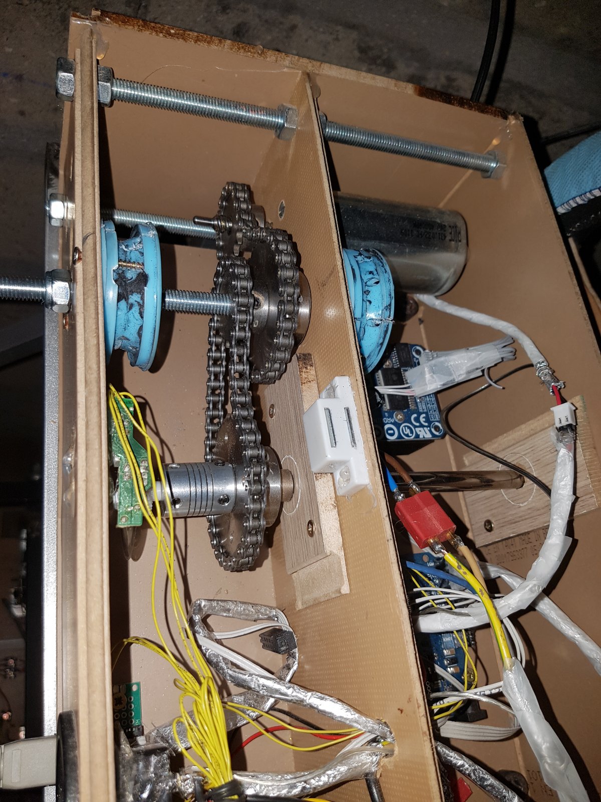

    The base of the steering wheel will contain electronics and mechanics.
    To realize my project of return of force I will follow the tutorial of Etienne_GameSeed
    On racingfr.
    http://www.racingfr.com/forum/index.php?showtopic=49848
    And tutorial YouTube de EbolzMagy
    Material :
    Arduino Leonardo
    Encoder printer
    Moteur 24v
    Motomonster vnh2sp30

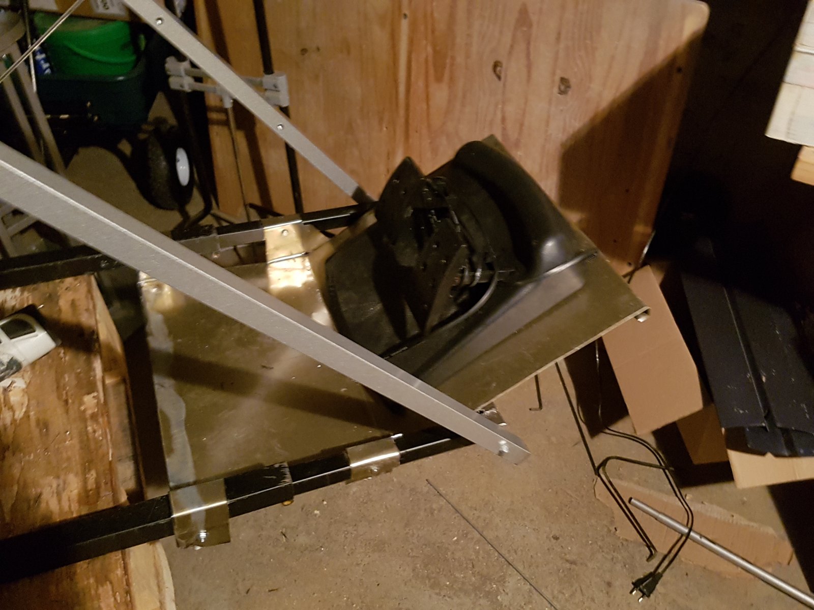

    I will also have to build a pedal. a rather delicate part given the mechanics of movement and inclination.

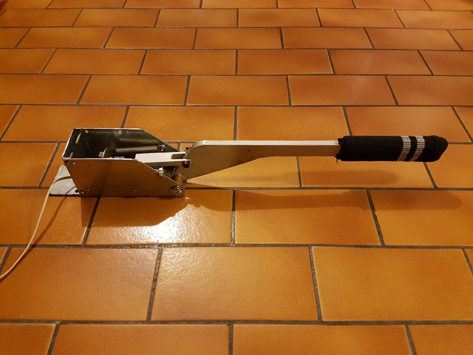

    new diy project: handbrake 20190122_183806.jpg 20190122_183752.jpg
