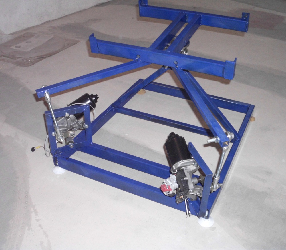

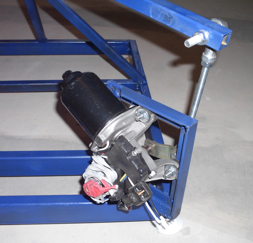

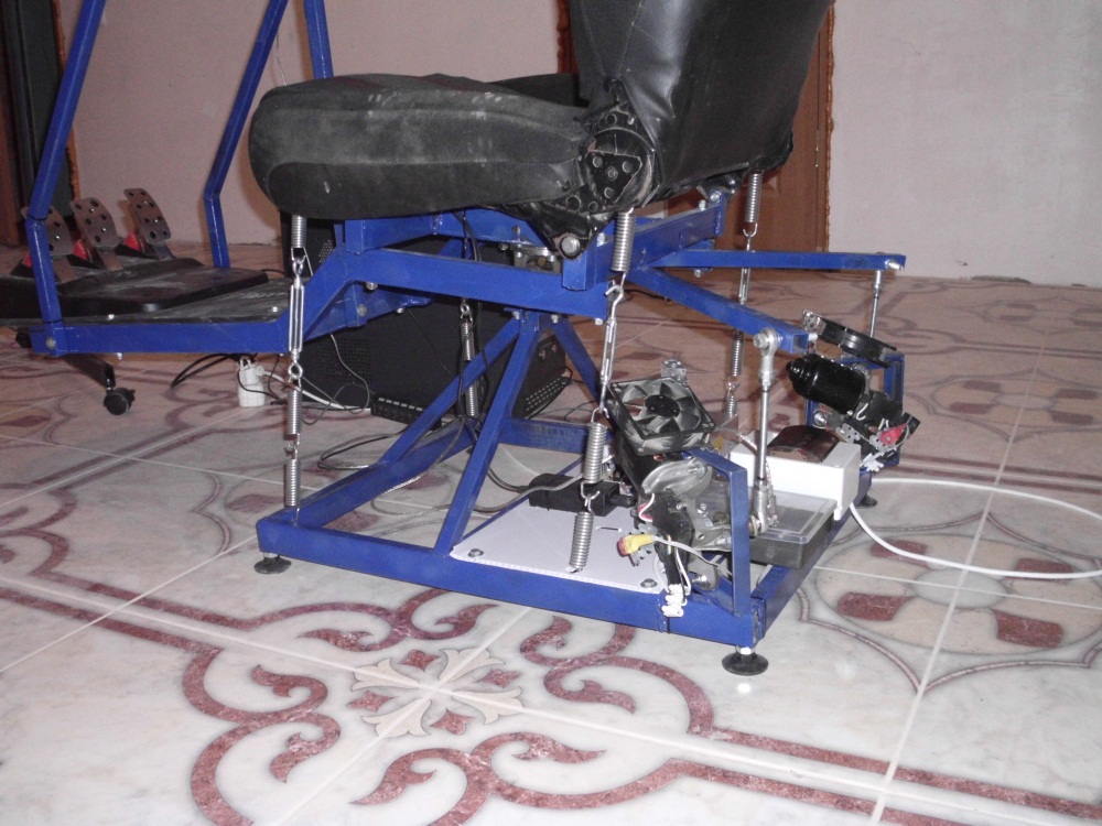

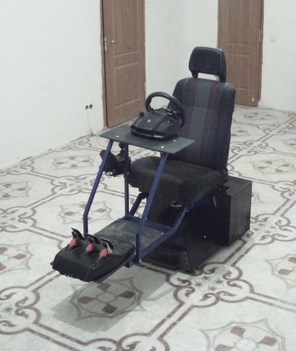

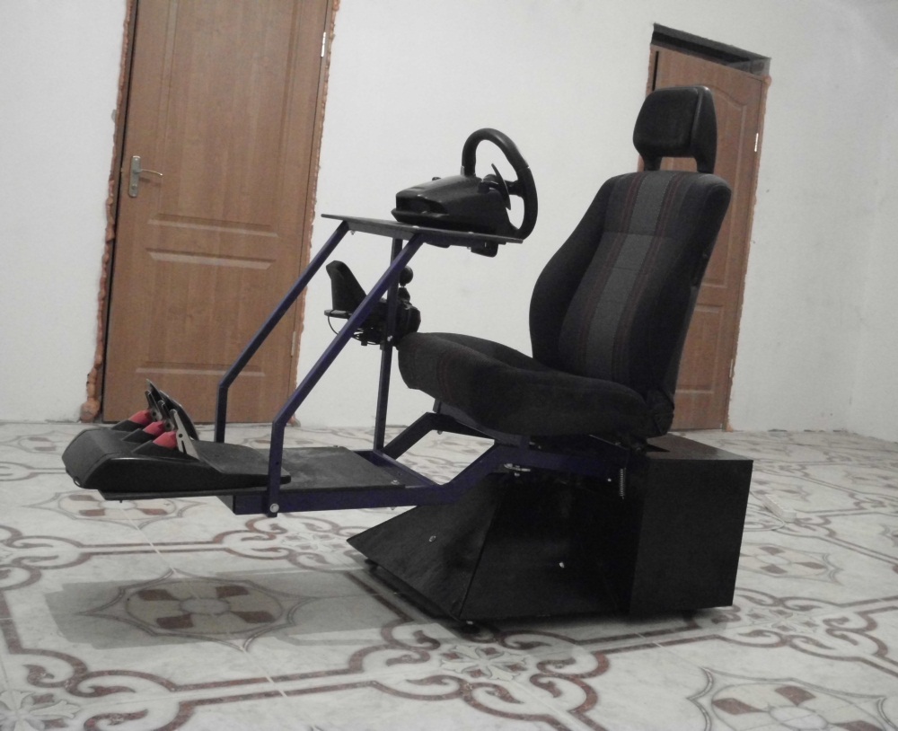

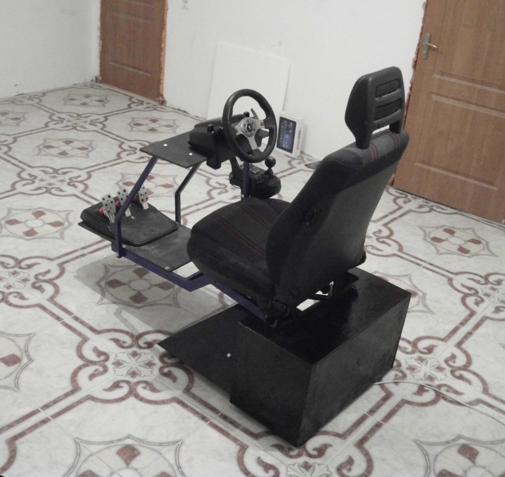

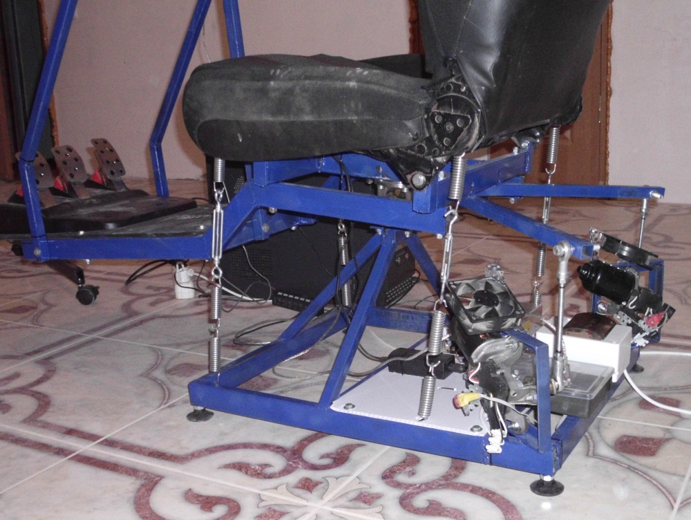

    Hi. My name is Alexander. I built 2dof racing seat. I want to share with you the report. I don't want to torture people by my Googlish, so mostly is a photo report. These photos were taken at different times, so sometimes design on them varies.
    Article about this sim in russian. Google translate.

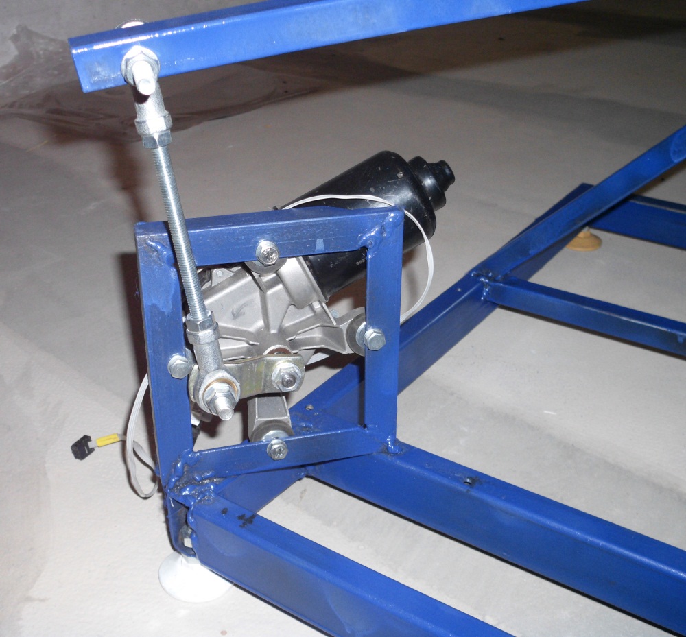

    I used wisper motors from Daewoo Lanos. 12V, 30W, ~45rpm
    Controller, firmware, motor drivers are self made.

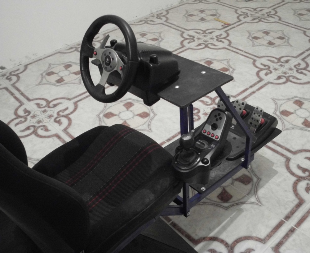

    I finished the device about a year ago, but the decoration panels added a week ago. Now the device is as follows:
    More video in this playlist.

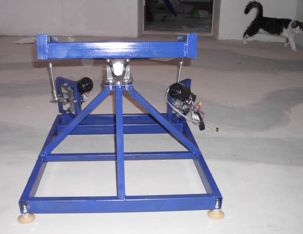

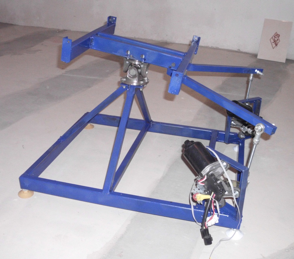

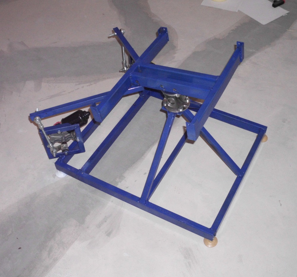

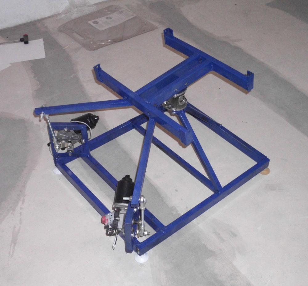

    Basic frame:
    IMG_0008.JPG IMG_0009.JPG IMG_0010.JPG IMG_0011.JPG IMG_0012.JPG IMG_0013.JPG

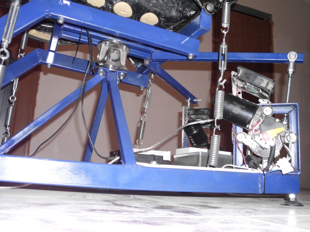

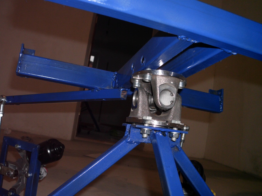

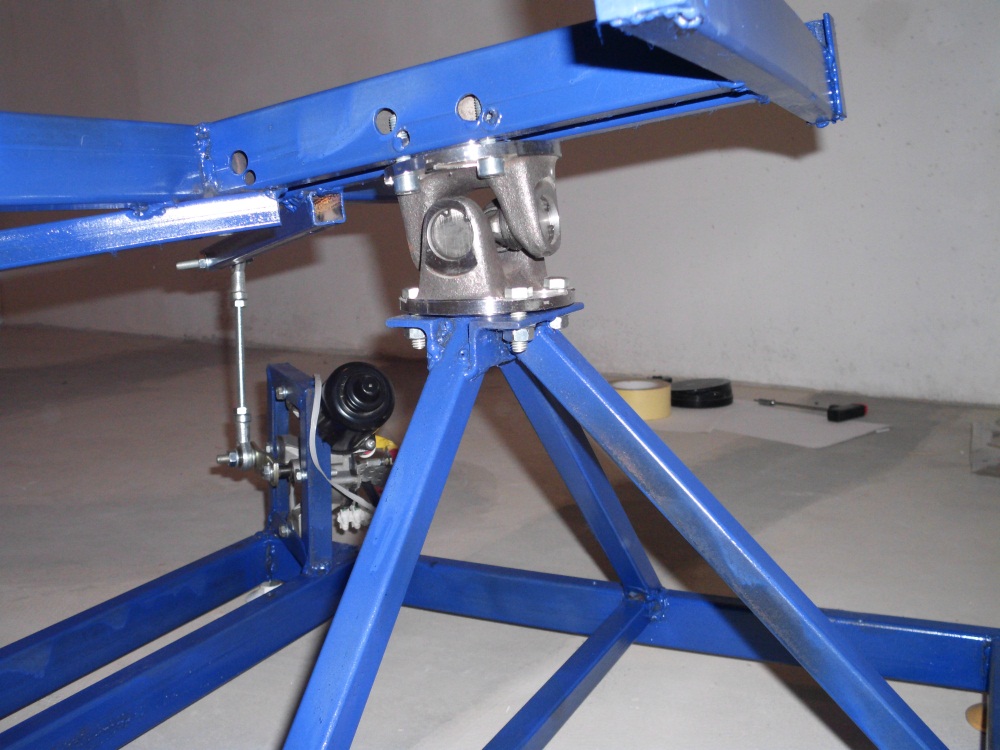

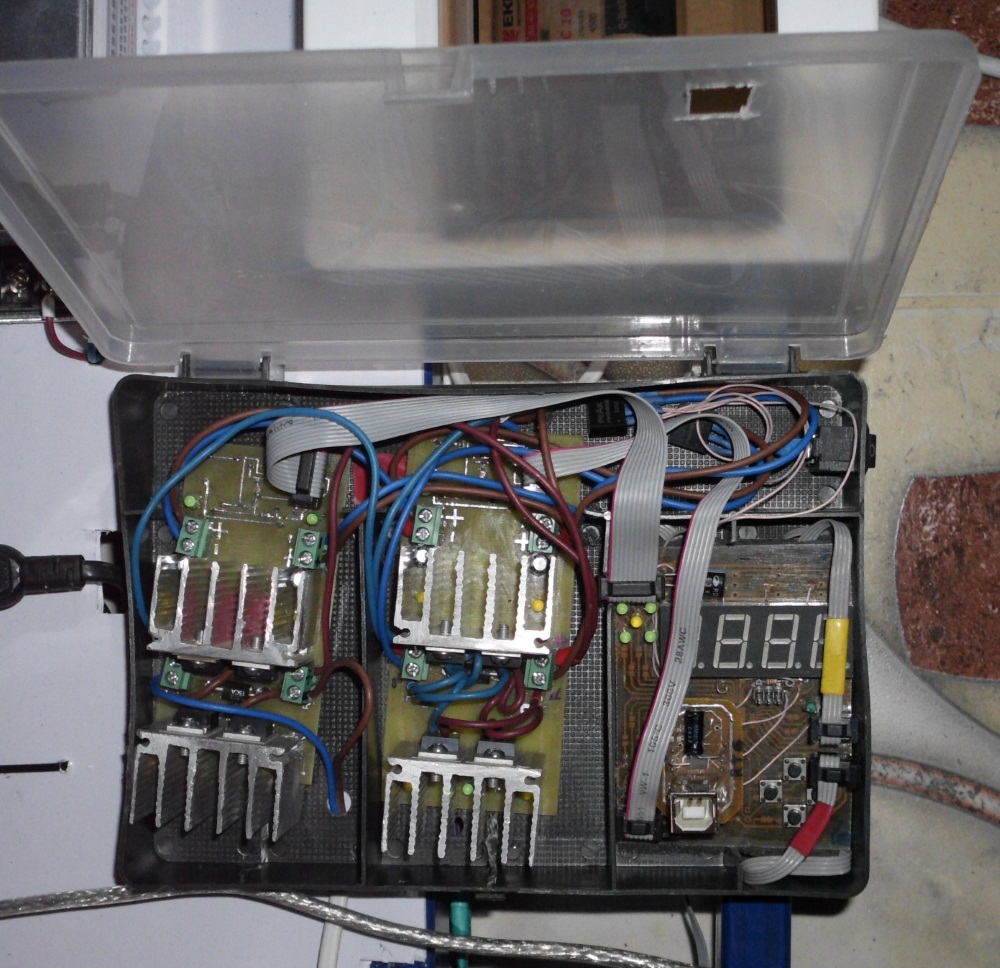

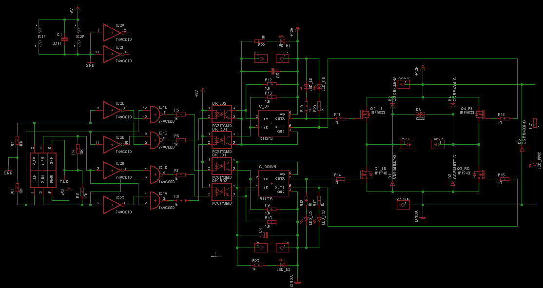

    Universal joint:

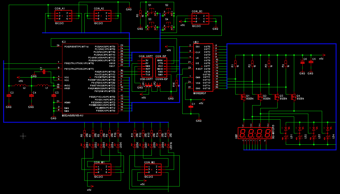

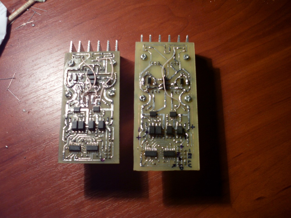

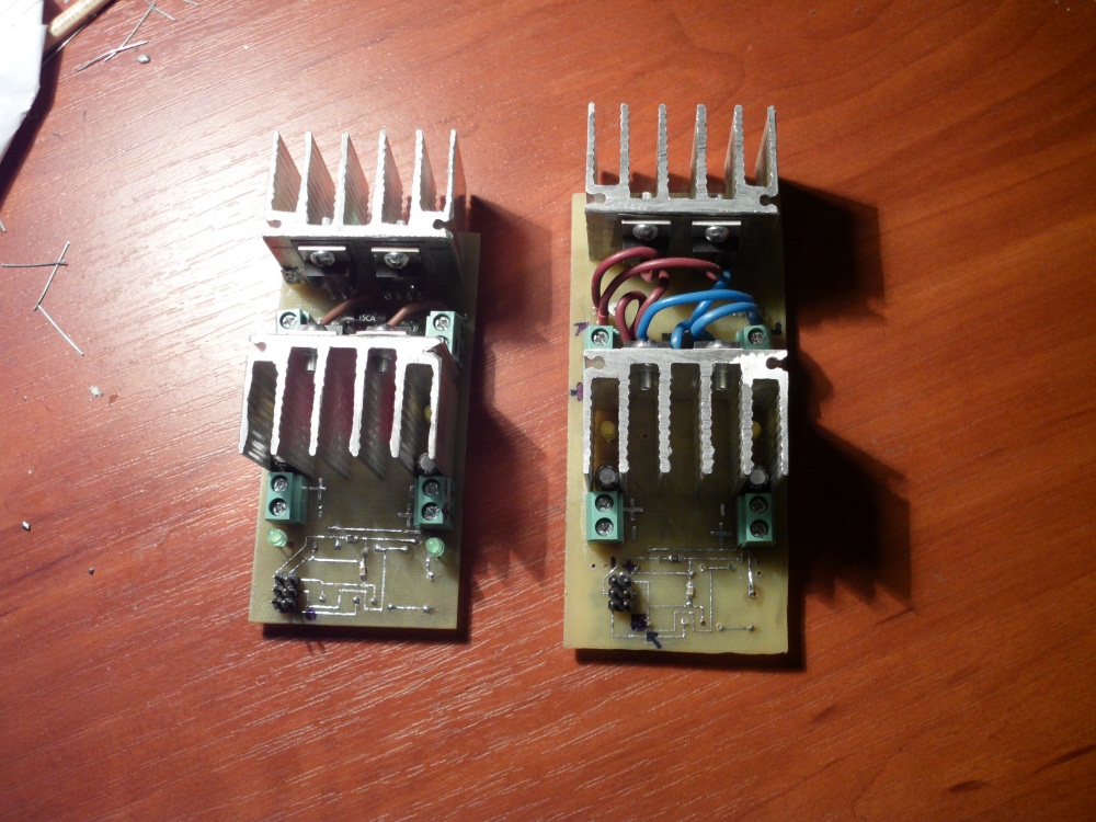

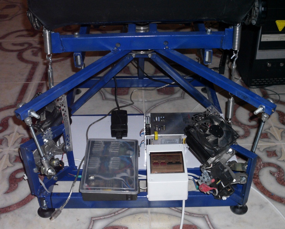

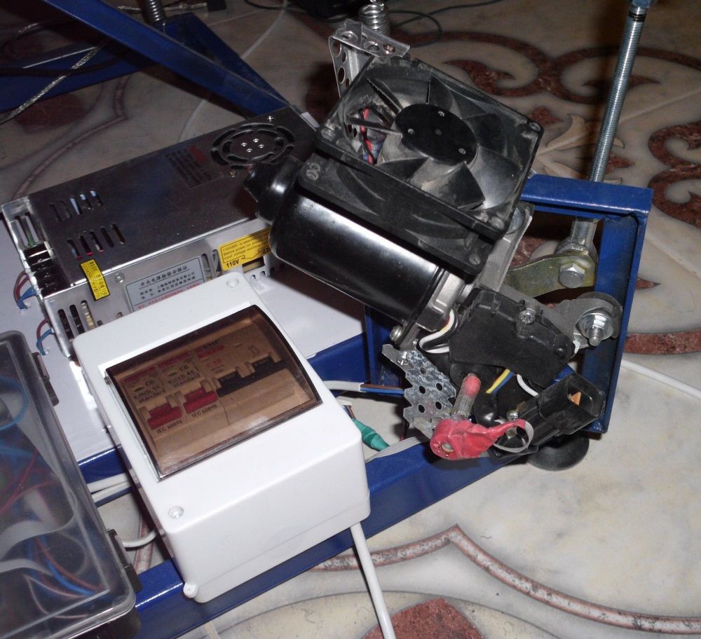

    Electronics:

    This is really a nice motion seat you made! I'm impressed!
    And admire your soldering :)

    Great job @Simal, thanks for sharing your sim.
    Can you tell me where you got the uni joint from as I have been searching for one like that.
    I think we would all like to know more about the custom controllers and firmware, though I appreciate Googlish makes that a bit of a challenge at times.
  6. eaorobbie
    20,481Coins
    +1,686 / 23 / -2
    Another custom controller , cool , yes agree @noorbeast would love to know more.
    As in I can see how its made by the schematic but it will have a code simular to an Ard I believe,
    Did you use AVR or C to code it. ?
    Nice rig for sure.

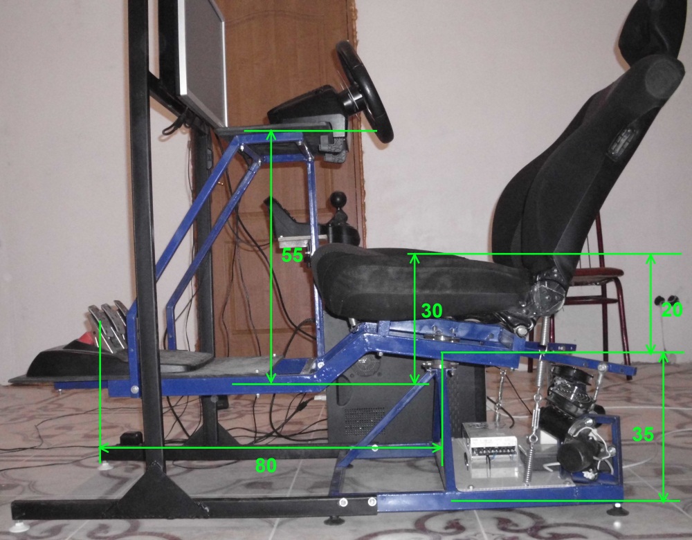

    Size in centimeters:

    2DOF, DC motor
    I'm from Ukraine, so i bought joint here (~$4) and cross here (~$3)
    Yes, it's AVR atmega88. I never programed Arduino, it's C.

    +28 / 1 / -0
    I really like the joint that you are using but i can't found out where to buy them. The Cross "thing" is easy to find but i can't see the other part (this one). Maybe i only need the specific name of it so i would find them.
    Anyone know here where to get them together?
  12. Simal
    Simal Member
    Oct 19, 2013
    19
    Solar System, Earth, Ukraine, Kirovograd
    - 144Coins
    +38 / 0 / -0
    2DOF, DC motor
    That part is from old soviet car, so it's easy to find it in post-soviet countries (Russia, Ukraine, etc.). I'm not sure you can buy it in Vienna. But you can try to searsh that part by "part number" - 2101-2201023, or use similar part from some other RWD car.

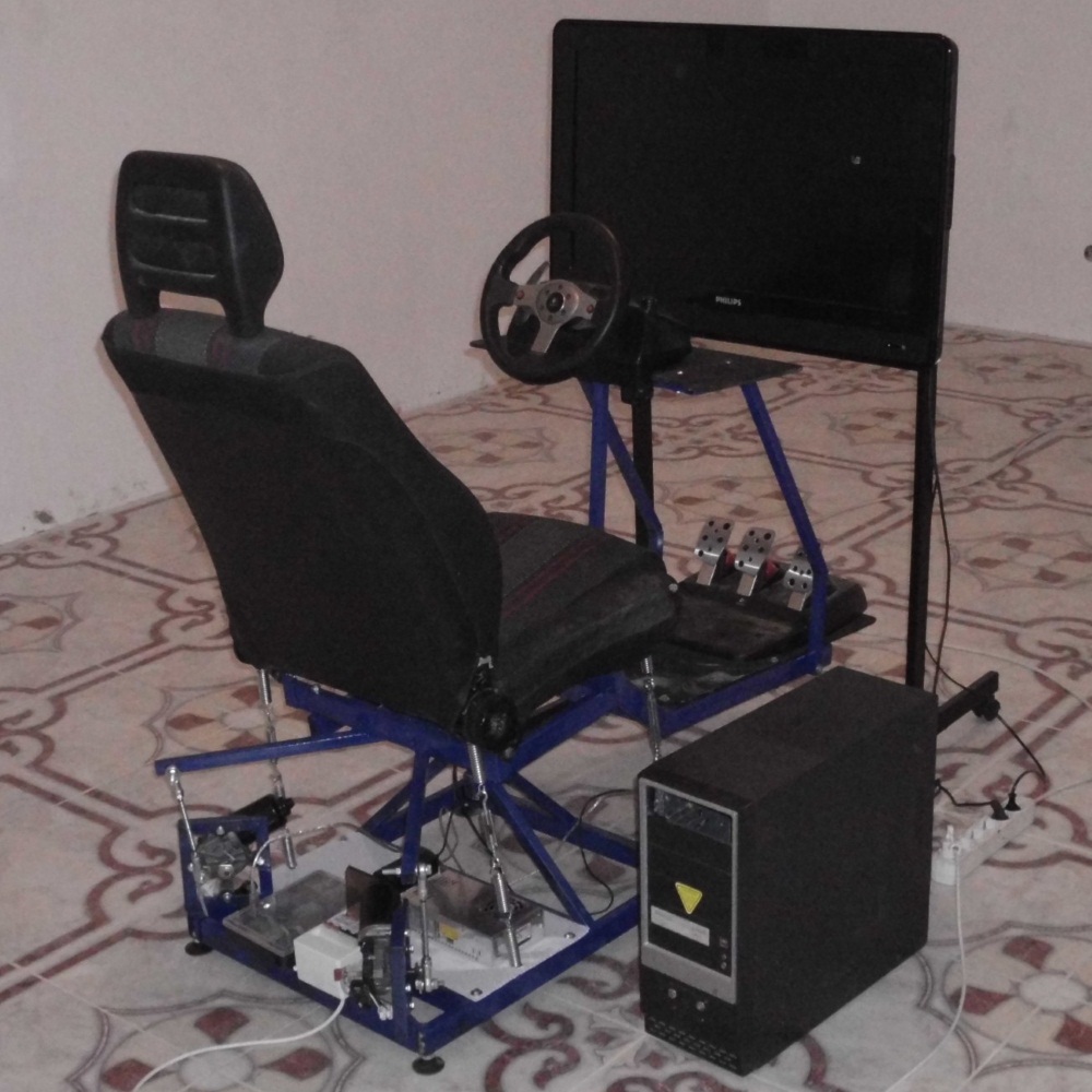

    Since I logged in, there is last version of my sim:

    +28 / 1 / -0
    "Flange Yoke" seems to be the magic word :)

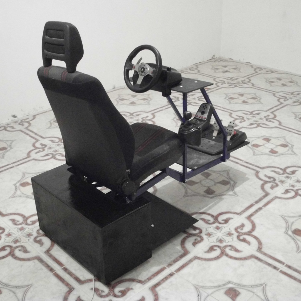

    New one:
