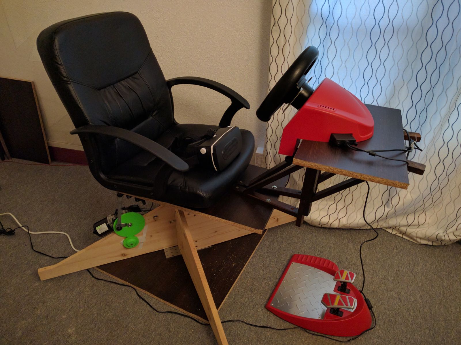

    Hi !
    I'm happy to present you my low cost simulator 2DoF made with 200€.
    This is a wood structure with 4 crossed plates.
    I use a car cardan junction for the rotation.
    For electronic parts, there are 2 wiper motors + 1 moto shield + 1 Arduino Uno.
    More pictures and price details are coming soon!
    I'm new here, don't hesitate to ask me questions !

  2. FlyingColander
    FlyingColander Member
    Mar 20, 2008
    76
    643Coins
    +16 / 2 / -0
    Looking forward to the video, mate. Like the low, low budget and can do spirit!

  5. momoclic
    momoclic Active Member
    Sep 23, 2014
    215
    Retraité
    Nantes - France
    2,761Coins
    +115 / 1 / -0
    DC motor, Arduino
    Très bon travail, conception originale, mille bravos !

  9. Martoul
    Martoul Member
    May 4, 2016
    37
    Paris, France
    177Coins
    +17 / 0 / -0
    What do you think of the result? How can I improve it?

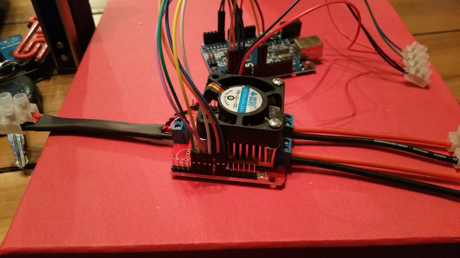

  16. stevemontuno
    stevemontuno Active Member
    Apr 24, 2015
    316
    UK
    1,721Coins
    +335 / 0 / -0
    Nice one ,,,,,, you could probably knock 25euro off that too if you use cheapo pots ,,, but could probably do with a heat sink & fan on the MM though so would bump it back up again ,,lol.
    Good list for someone wanting to knock a cheap rig up though :thumbs
    You forgot the motors too
  17. Martoul
    Martoul Member
    May 4, 2016
    37
    Paris, France
    177Coins
    +17 / 0 / -0
    I didn't find cheaper potentiometer without rotation stop. Do you have a link ?
    What do you mean by "do with a heat sink & fan on the MM "?
