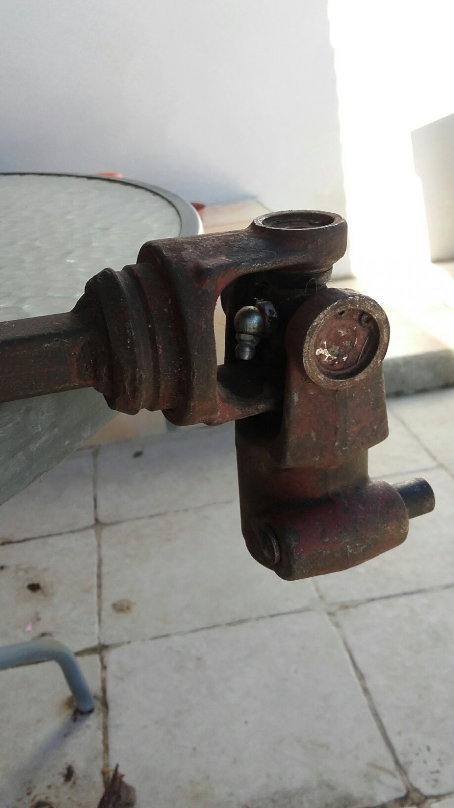

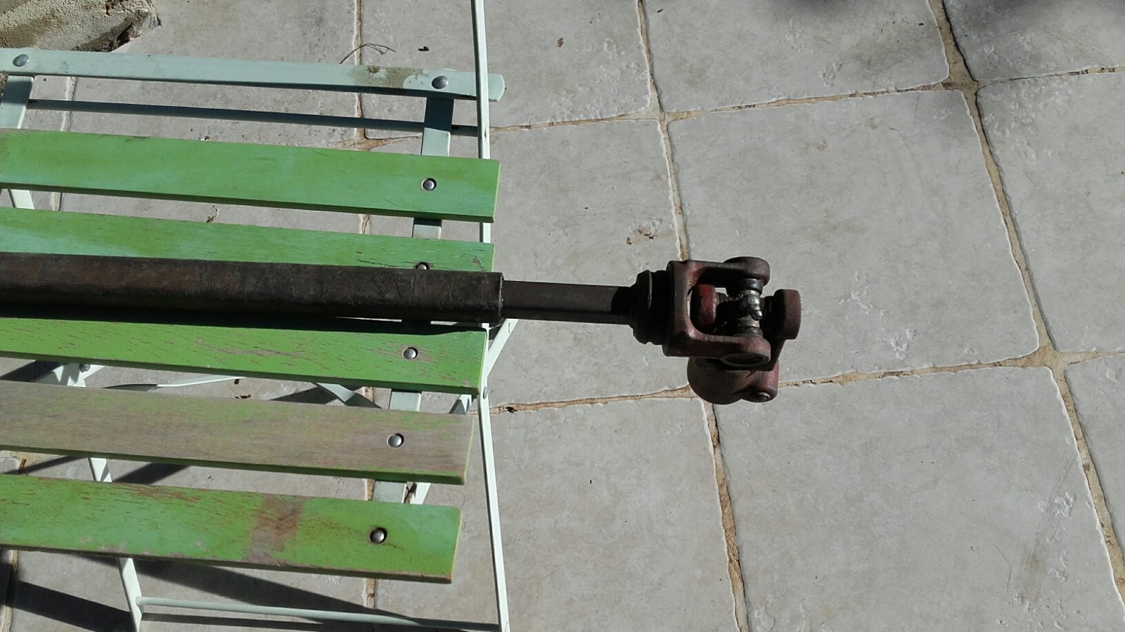

  7. dominike
    dominike New Member
    Nov 24, 2018
    13
    462Coins

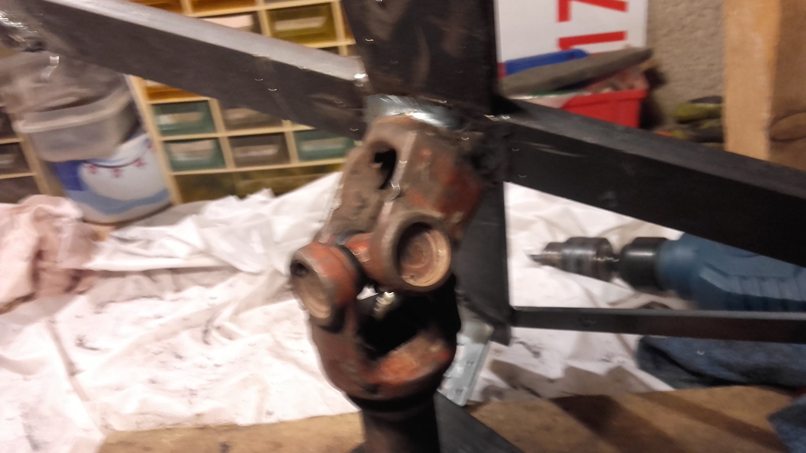

    next step preparation of my cardan

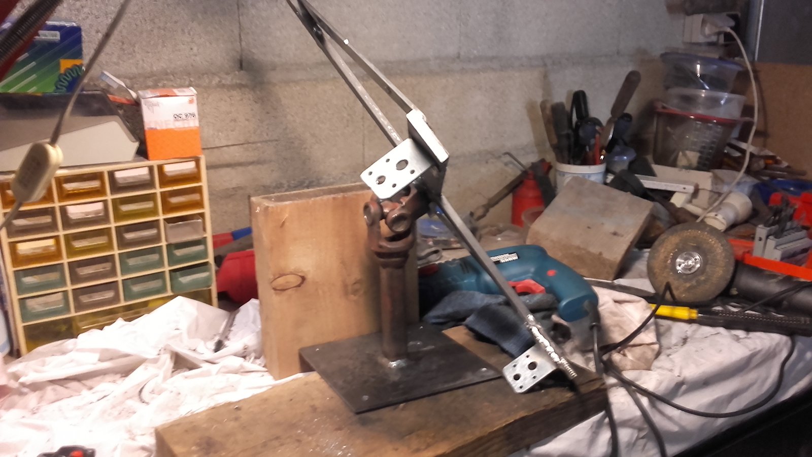

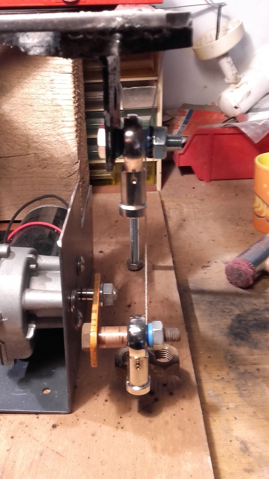

  9. dominike
    dominike New Member
    Nov 24, 2018
    13
    462Coins
    finally some free time;)

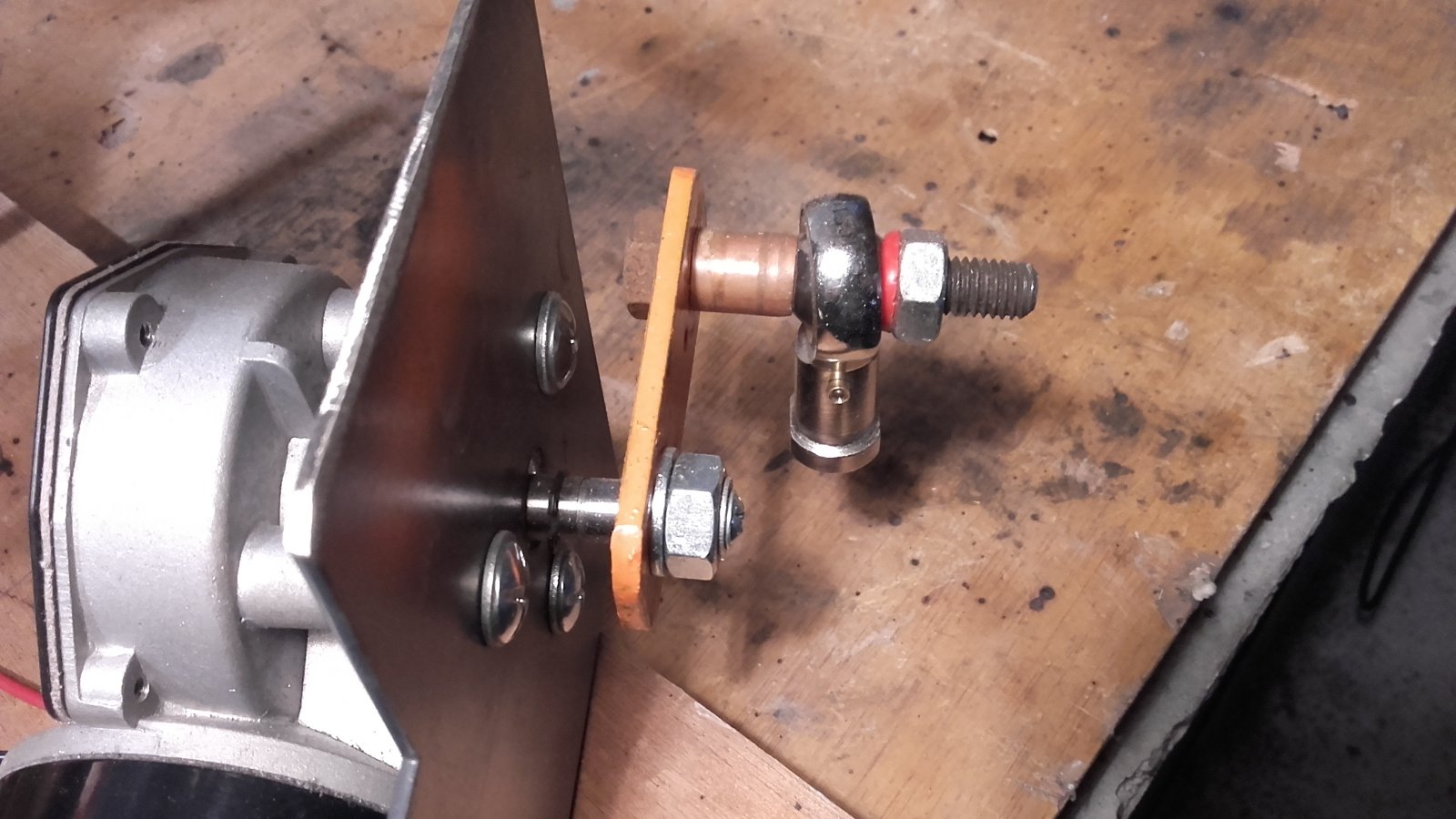

    here is the calculation of implantation of the kneecaps
    arm * sine (angle of motion) = crank
    here I take 10 °
    X * (sinus10) = 45
    x = 26cm
    length of a square inscribed in a circle of radius 26cm
    26 * 1.414 = 36.66 cm
    Calcul d'implantation des rotules
    bras*sinus(angle de mouvement)=manivelle
    ici je prends 10° maxi
    X*(sinus10)=45
    x=26cm
    longueur d'un carre inscrit dans un cercle de rayon 26cm
    26*1.414=36.66 cm (entre axe des rotules en cooperatif)
    show must go on..:popcorn

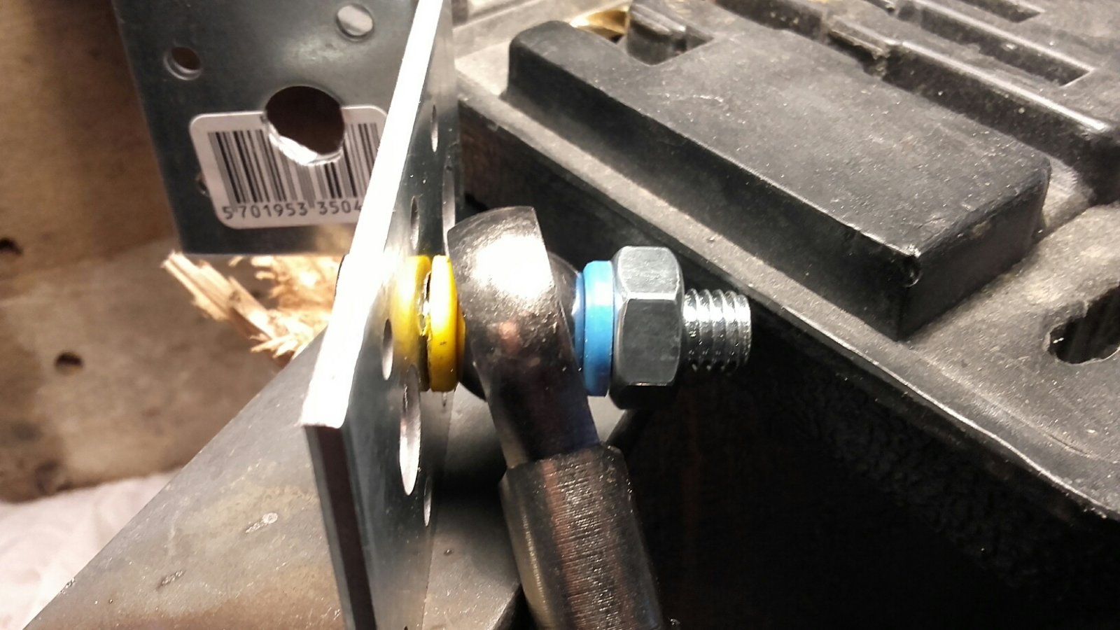

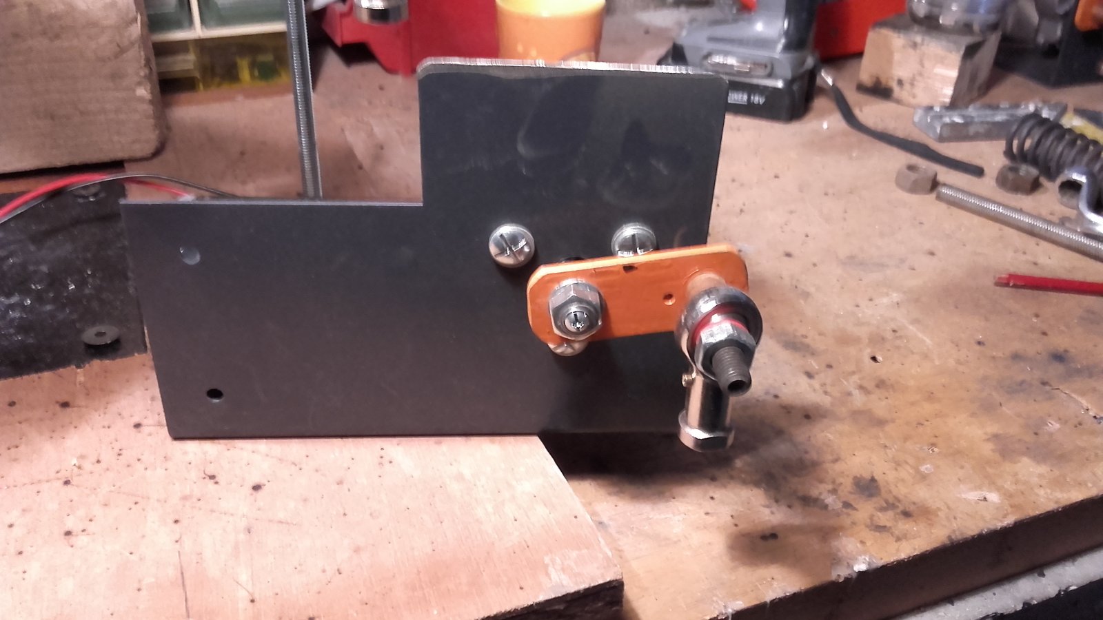

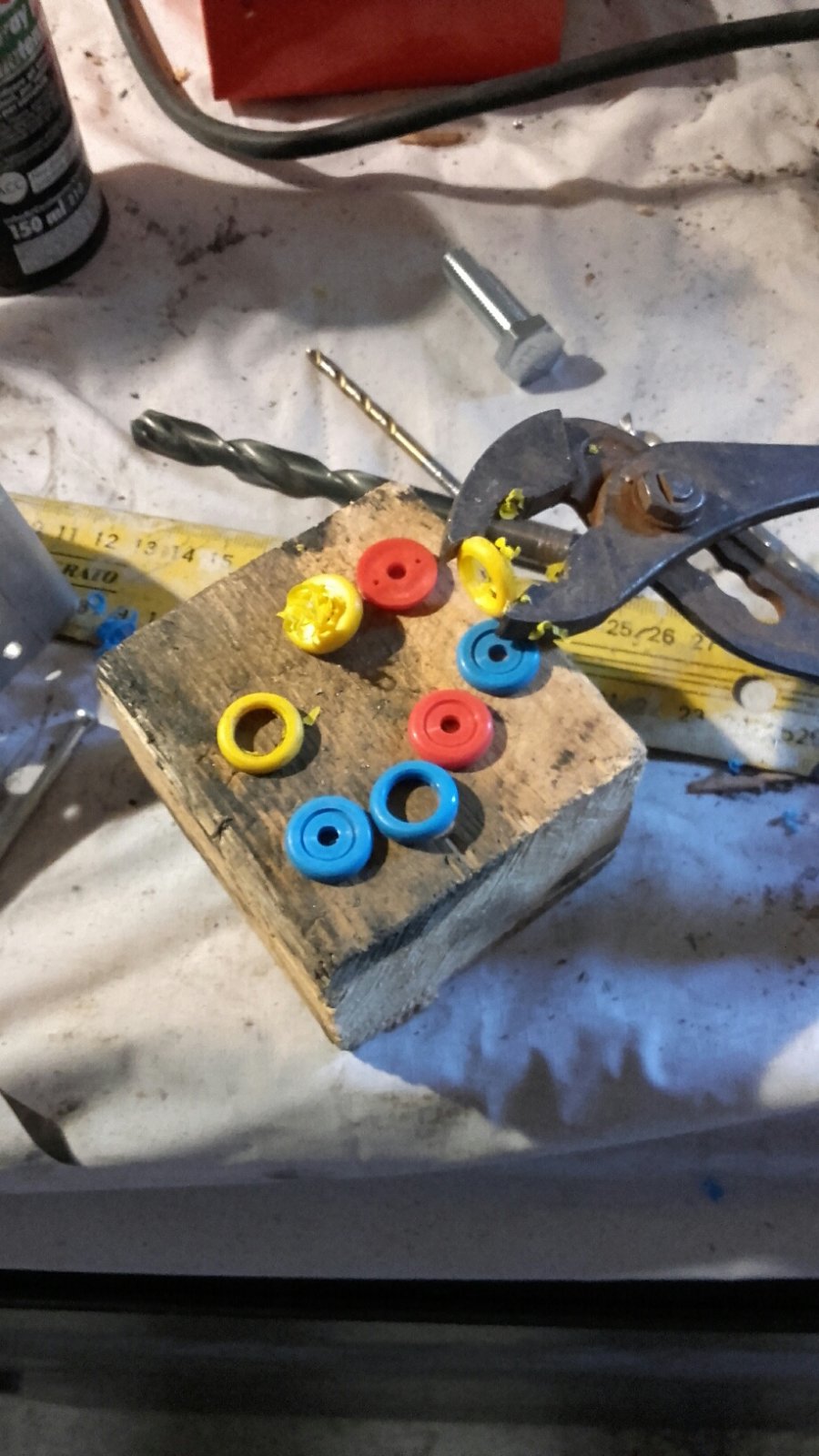

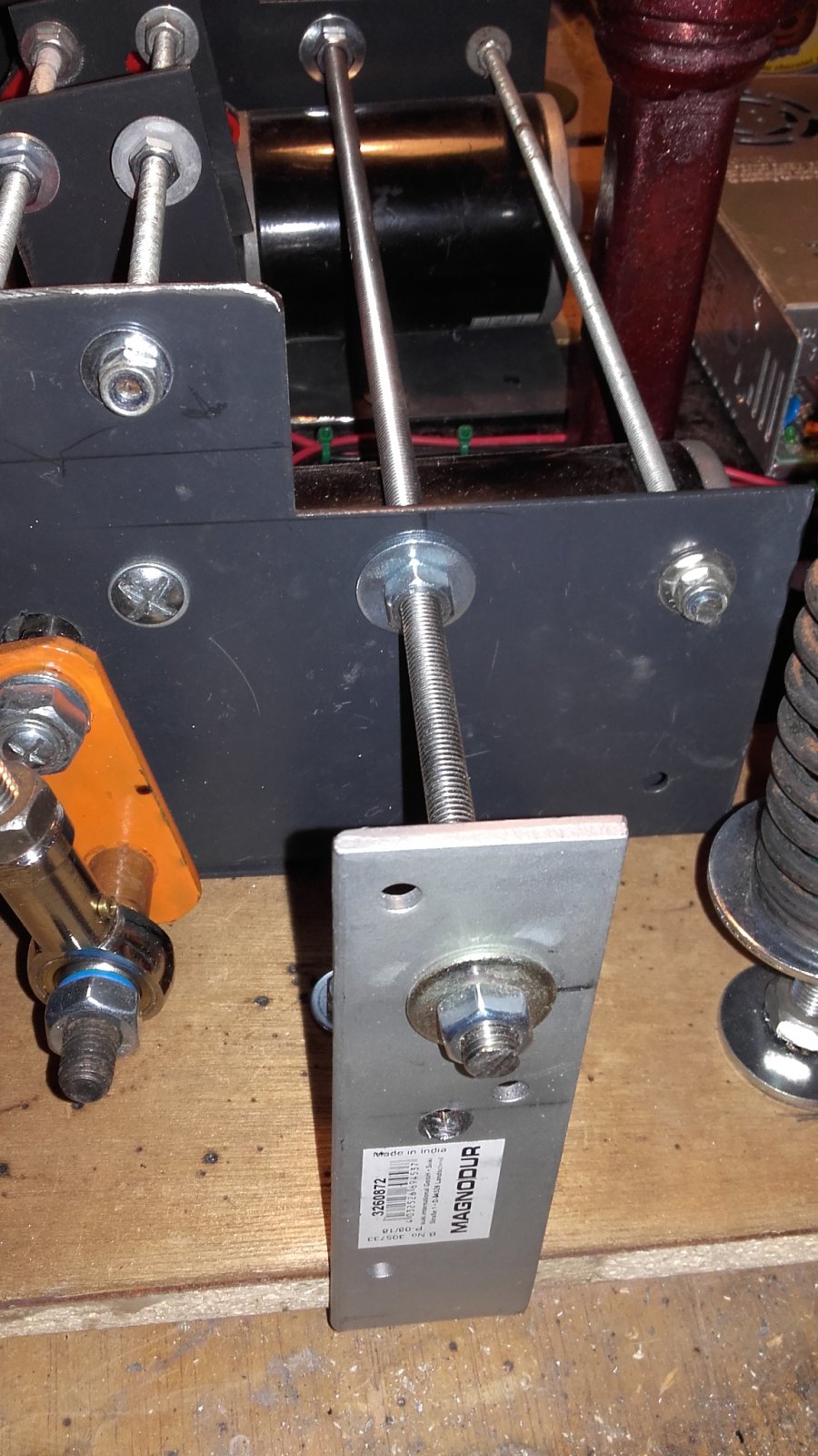

  10. dominike
    dominike New Member
    Nov 24, 2018
    13
    462Coins

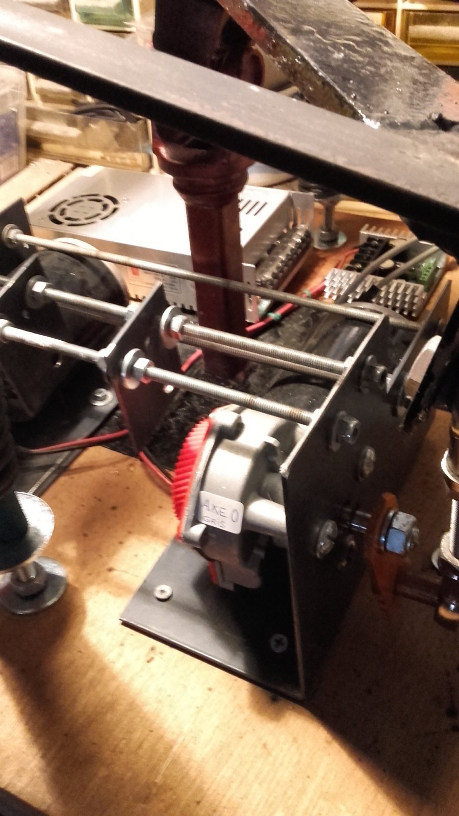

    finished my kneecaps and my engine fixings:)
    20181223_101805_resized.jpg 20181223_101626_resized.jpg 20181223_101912_resized.jpg

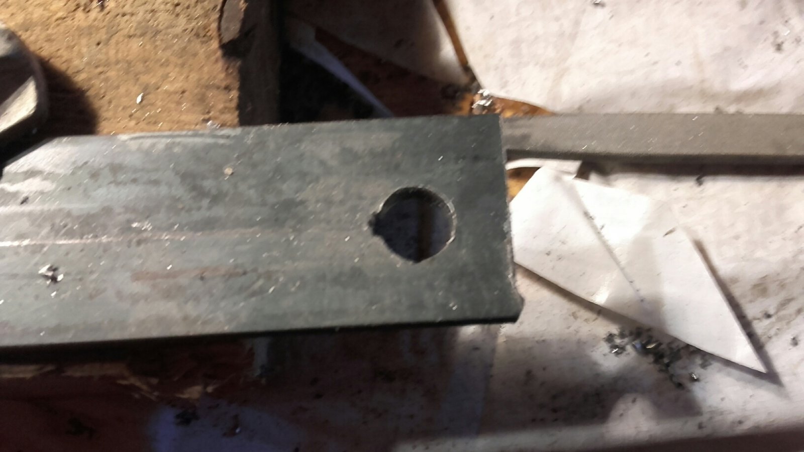

  11. dominike
    dominike New Member
    Nov 24, 2018
    13
    462Coins

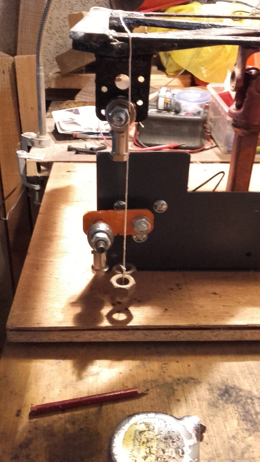

    finishing of my cams and alignment of the set
    lack of free time:(

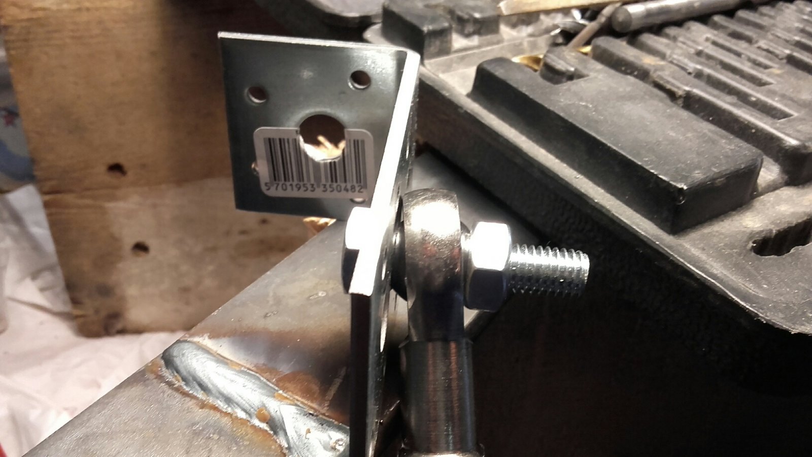

    after my first try to force to strengthen everything
    next step, the tests with the seat
