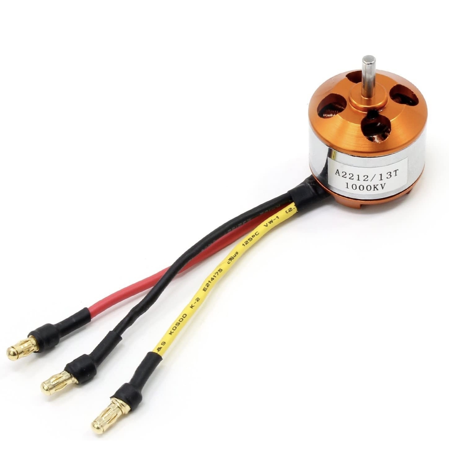

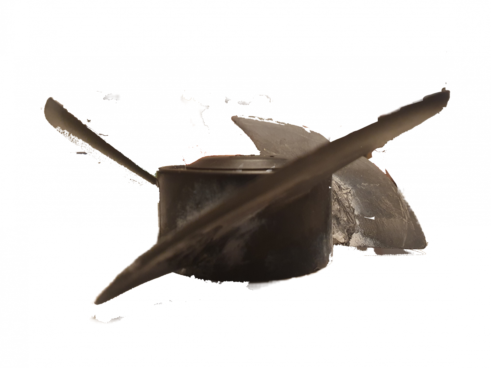

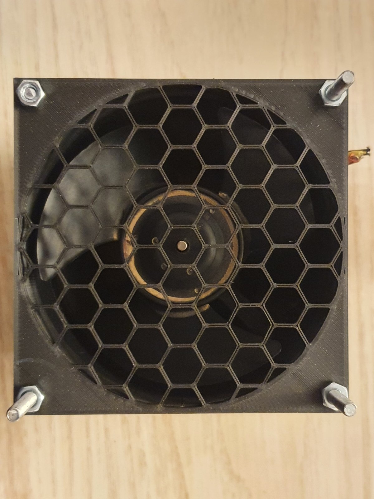

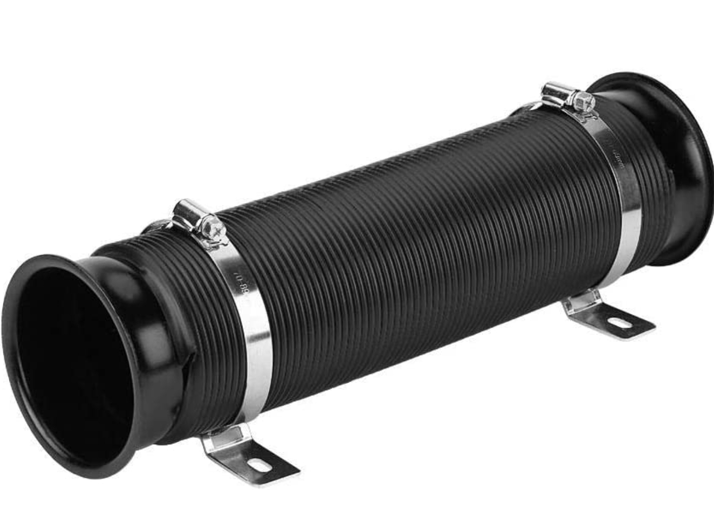

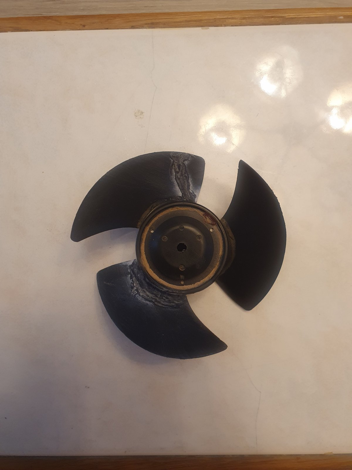

    addition of a wind simulation system working with two brushless motors.
  6. Mattlekim
    Mattlekim Member
    Jan 19, 2023
    38
    - 5Coins
    +18 / 0 / -0
    This is looking really good. How powerful is the wind simulation? Powerful enough for vr?
  7. hoyang
    hoyang handyman
    Dec 14, 2017
    94
    Bricoleur
    1,337Coins
    +90 / 0 / -0
    I don't have wind measurement tools. but its potency is sufficient to feel its effect on the face and hands.
    I don't know the effect strength of other wind simulators to be able to compare.

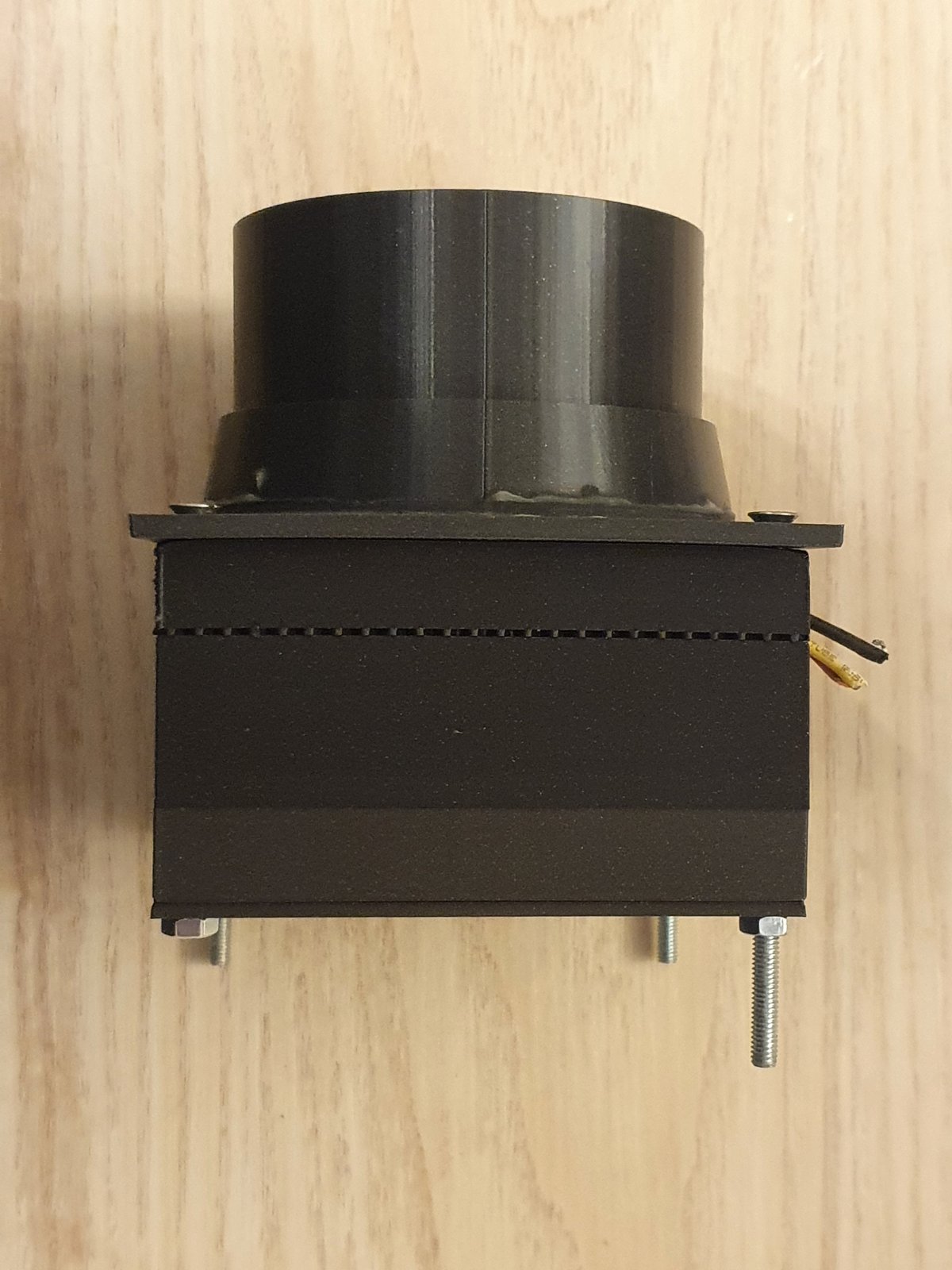

  8. hoyang
    hoyang handyman
    Dec 14, 2017
    94
    Bricoleur
    1,337Coins
    +90 / 0 / -0
    wind simulation

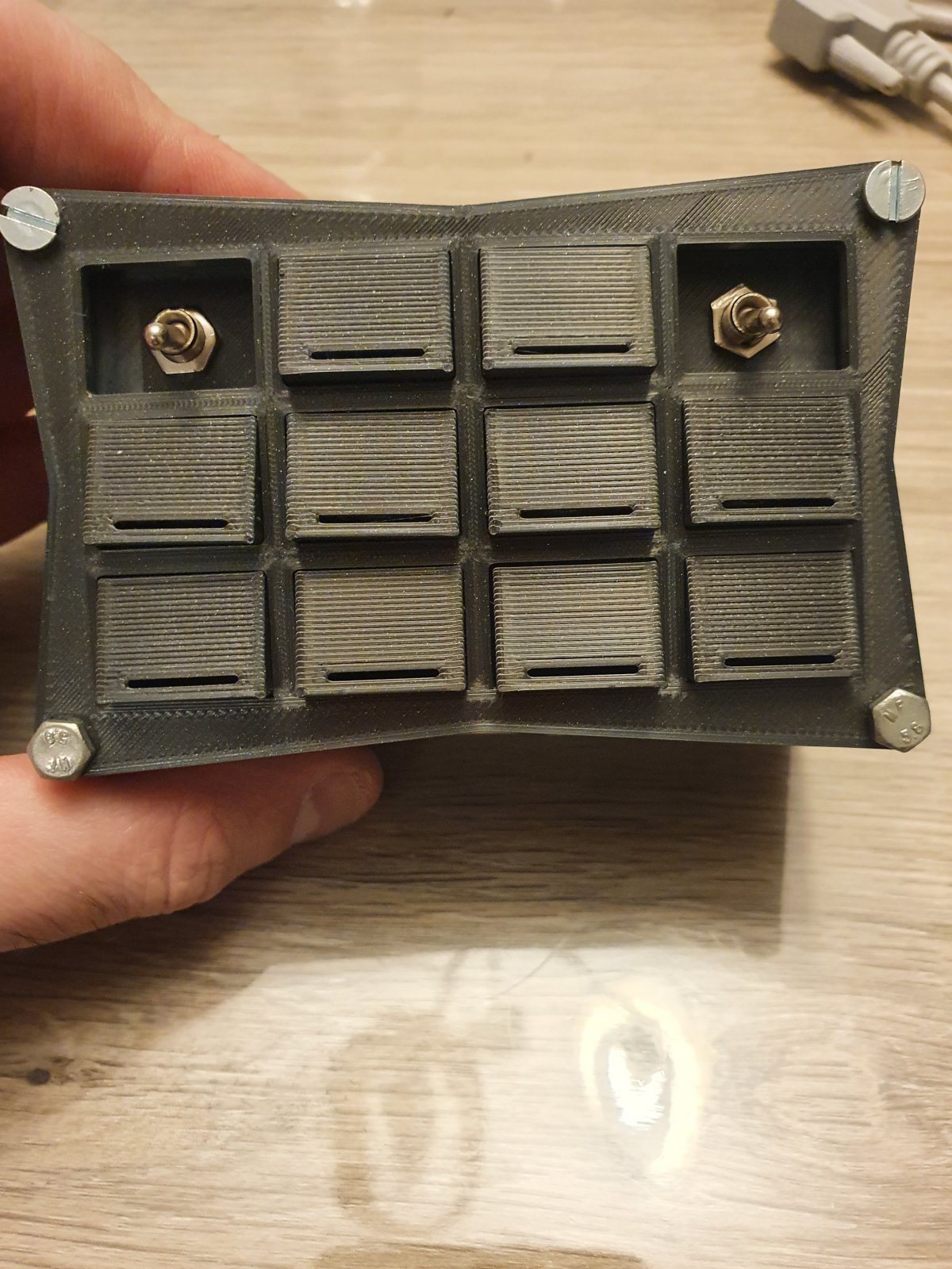

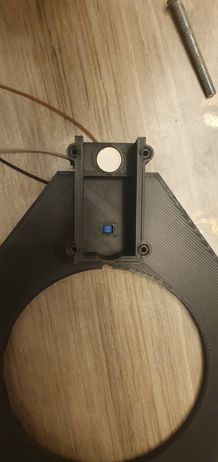

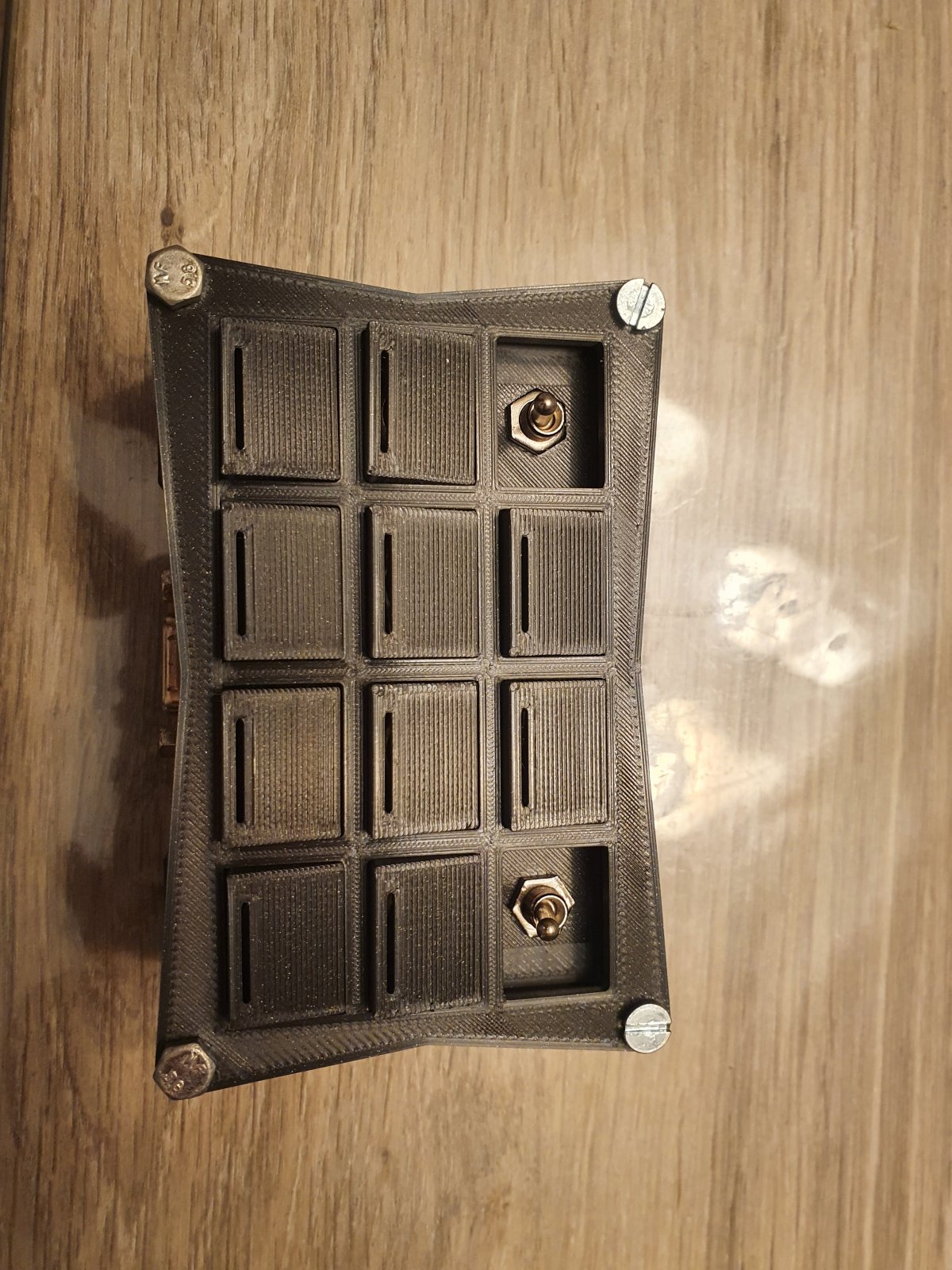

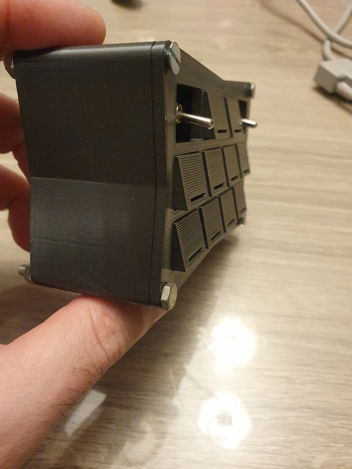

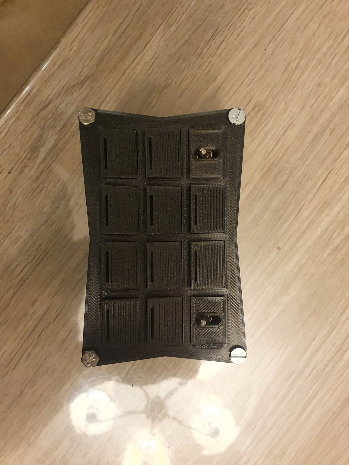

    new button housing

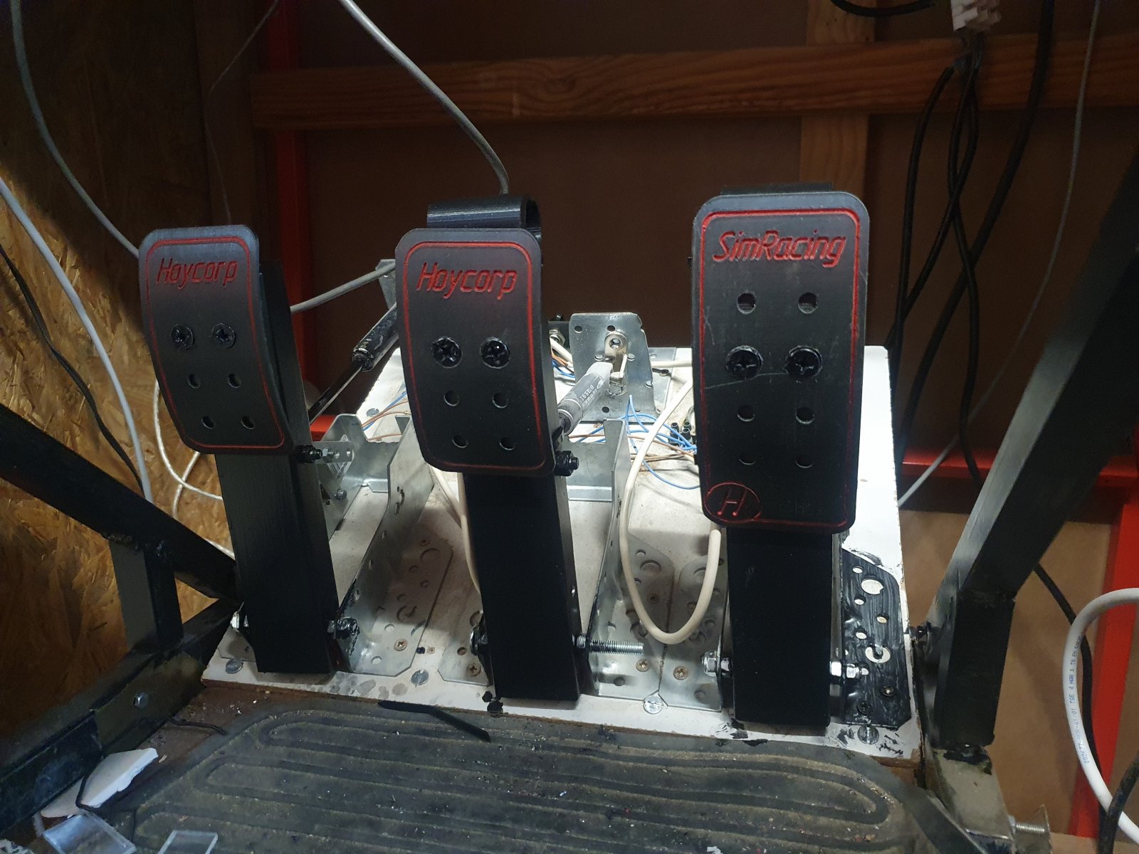

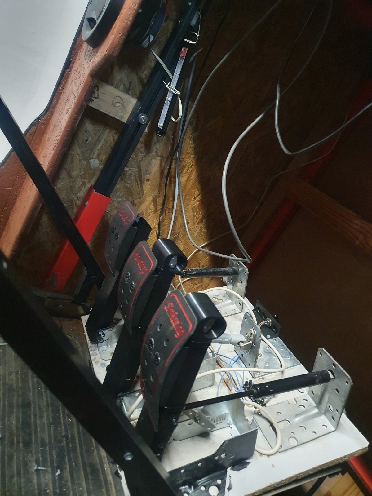

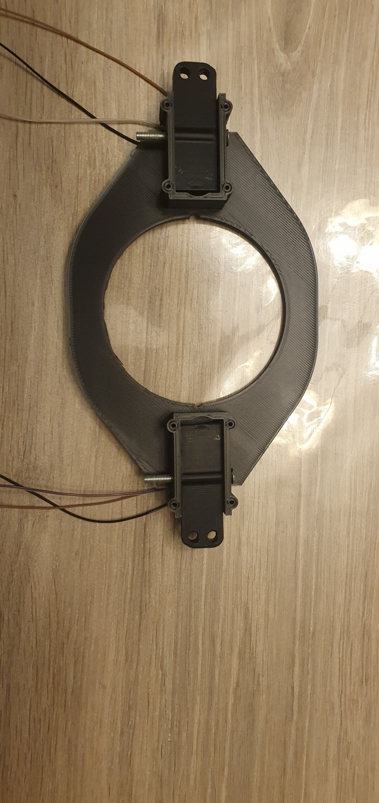

    pedal improvement

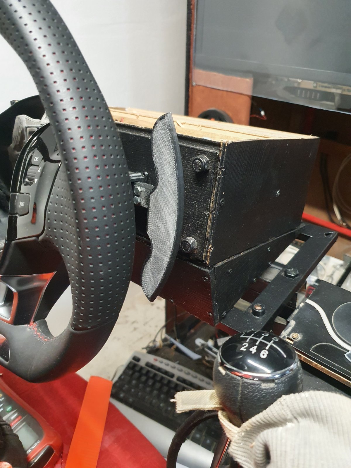

    addition of steering wheel paddles

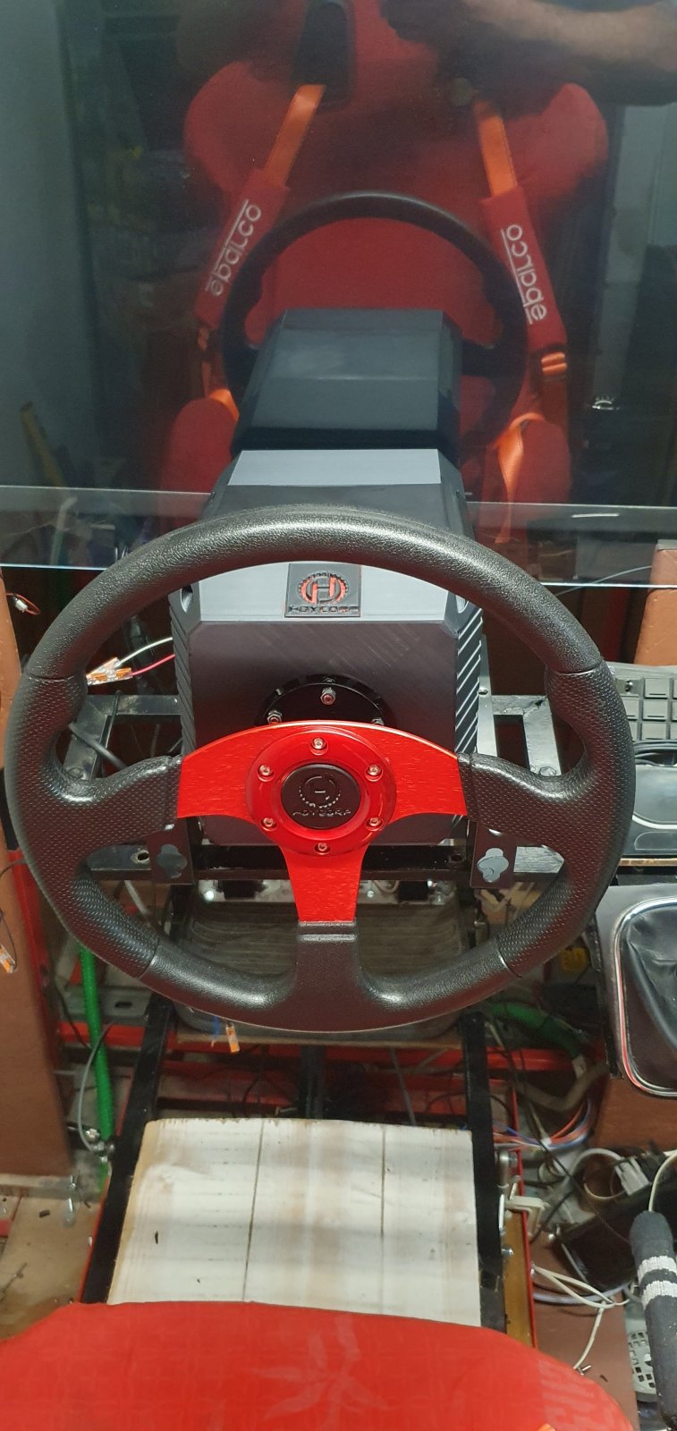

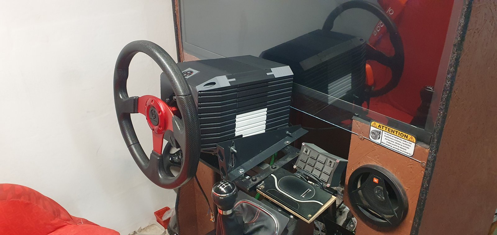

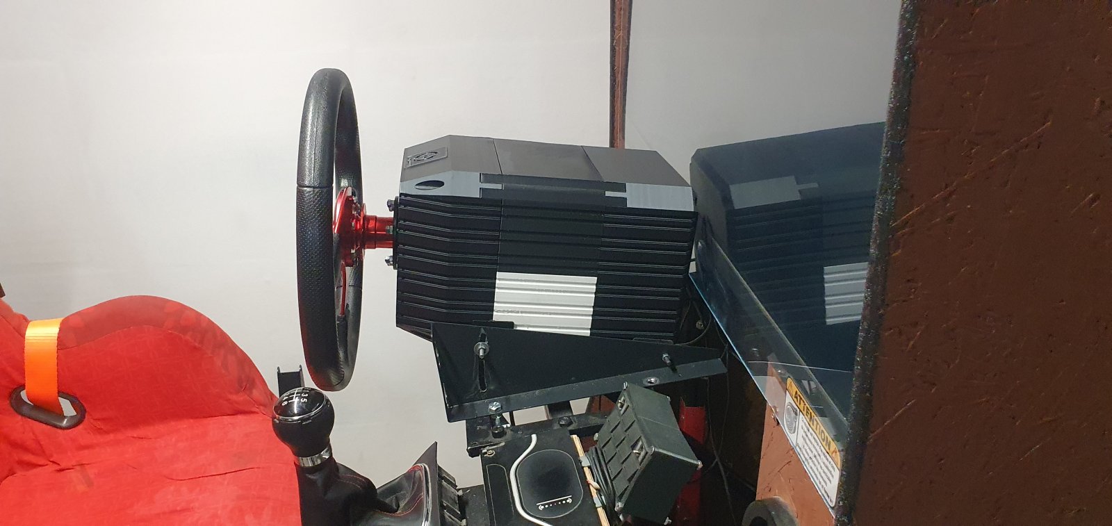

    creation of a direct drive steering wheel base with a hoverboard motor.
    working with vnm wheelbase software.
    stm32f407vet6
    driver motor zs-x11h.

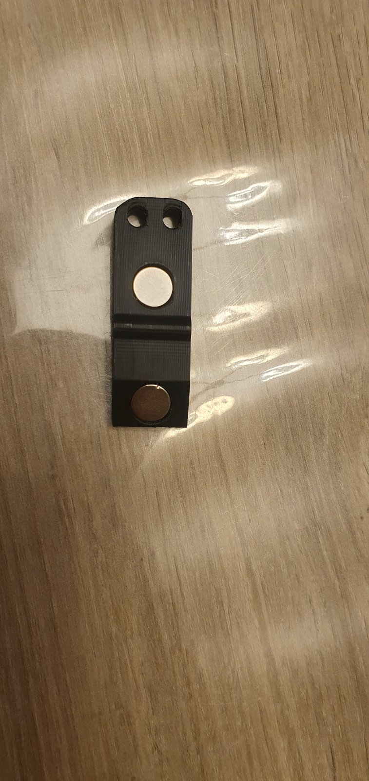

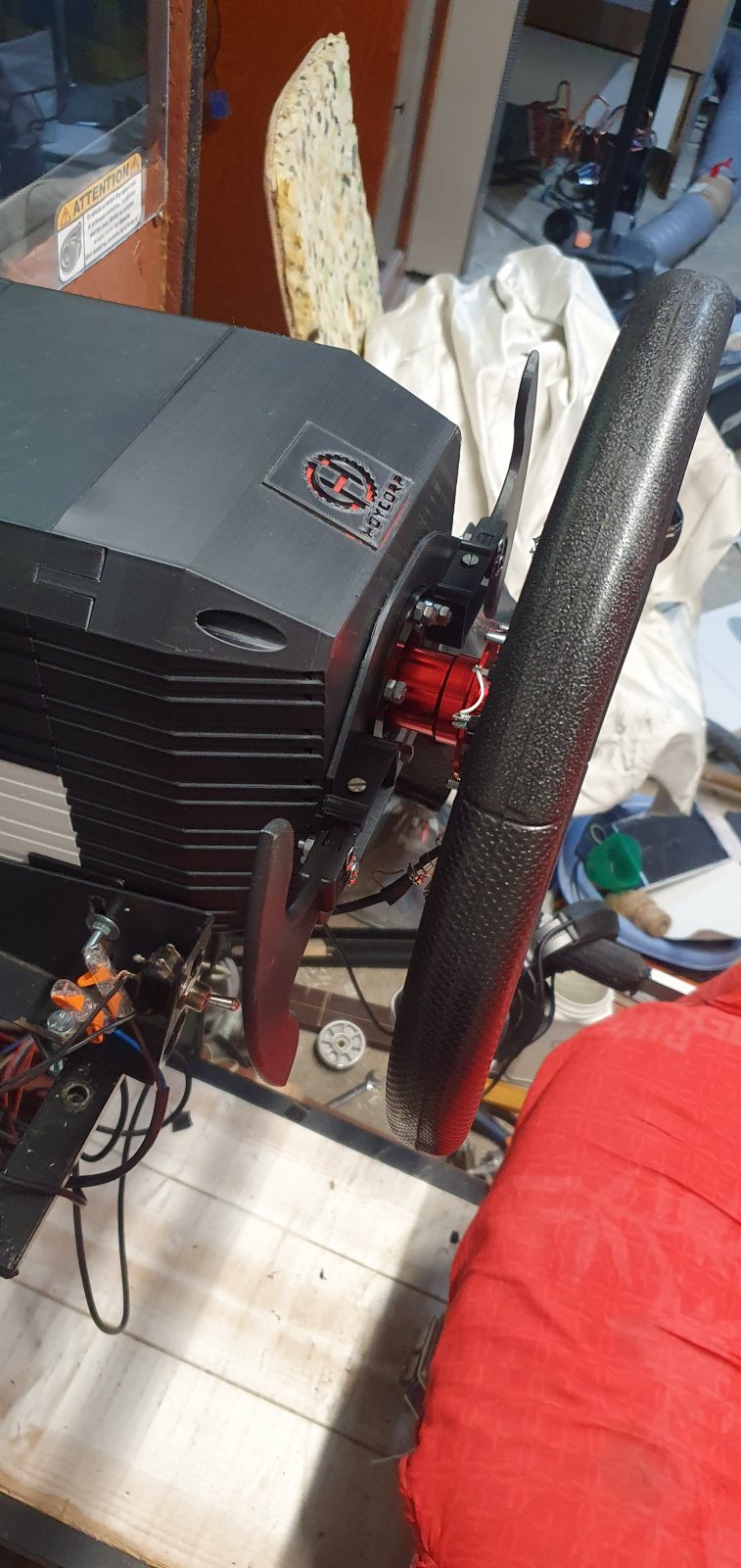

    addition of paddle shifter:

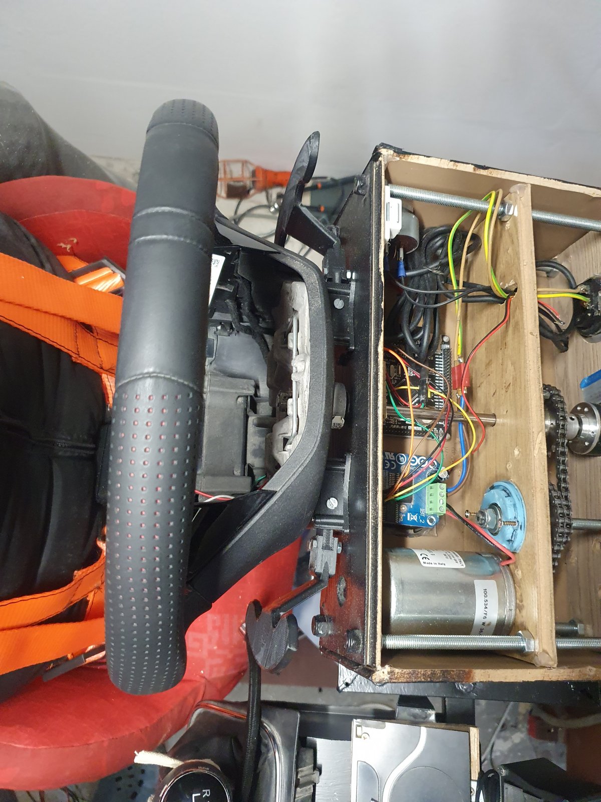

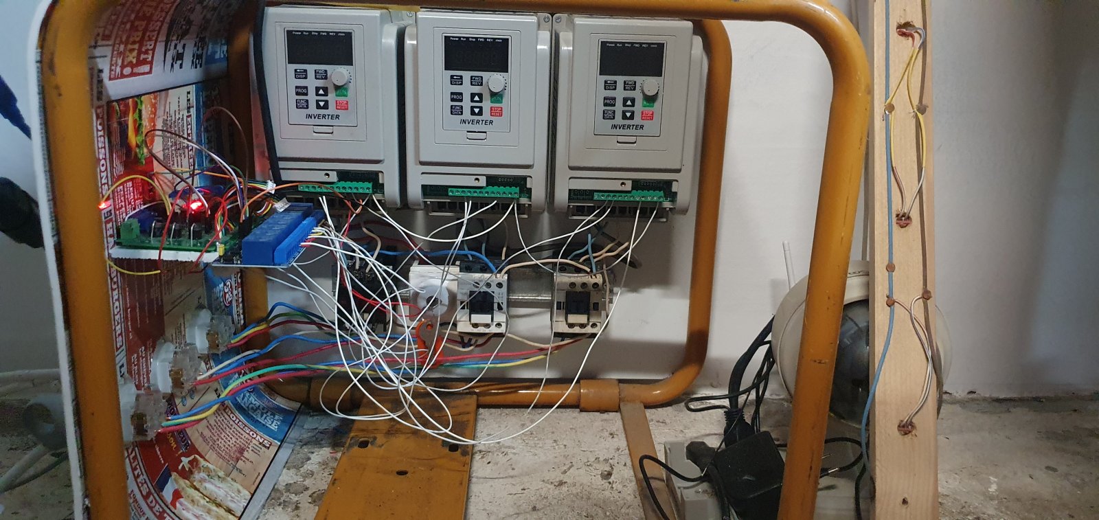

    modification of the simulator:
    replacement of bldc motors for three-phase motors controlled by vfd and arduino smc3.
    21,513
    150,698Coins
    +11,018 / 55 / -2
    Nice work, I am interested to hear more details of the SMC3/VFD hardware used, wiring, tuning and use?
  15. hoyang
    hoyang handyman
    Dec 14, 2017
    94
    Bricoleur
    1,337Coins
    +90 / 0 / -0
    I have not changed my 30/1 reducers on the left and 40/1 on the right on the yaw effect I am on a double reducer which creates a 100/1.
    2 three-phase motors of 1500 rpm + 1 of 3000 rpm.
    2 VFDs AT1-1500 + 1 AT1-2200.
    the classic smc3.ino code in an arduino nano. for the moment module 6 arduino 5v relays (I will create an electronic PCB to replace the relays).
    the PWMs are connected directly to the VFDs (potentiometer location).
    some parameters to modify in the vfd at the velocity level p34=1000hz p42=1000hz.
    external control setting p10 p11 p12.

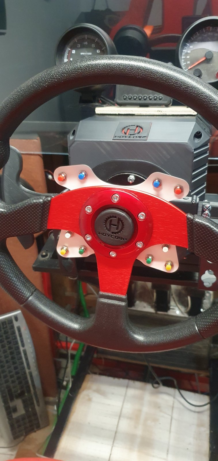

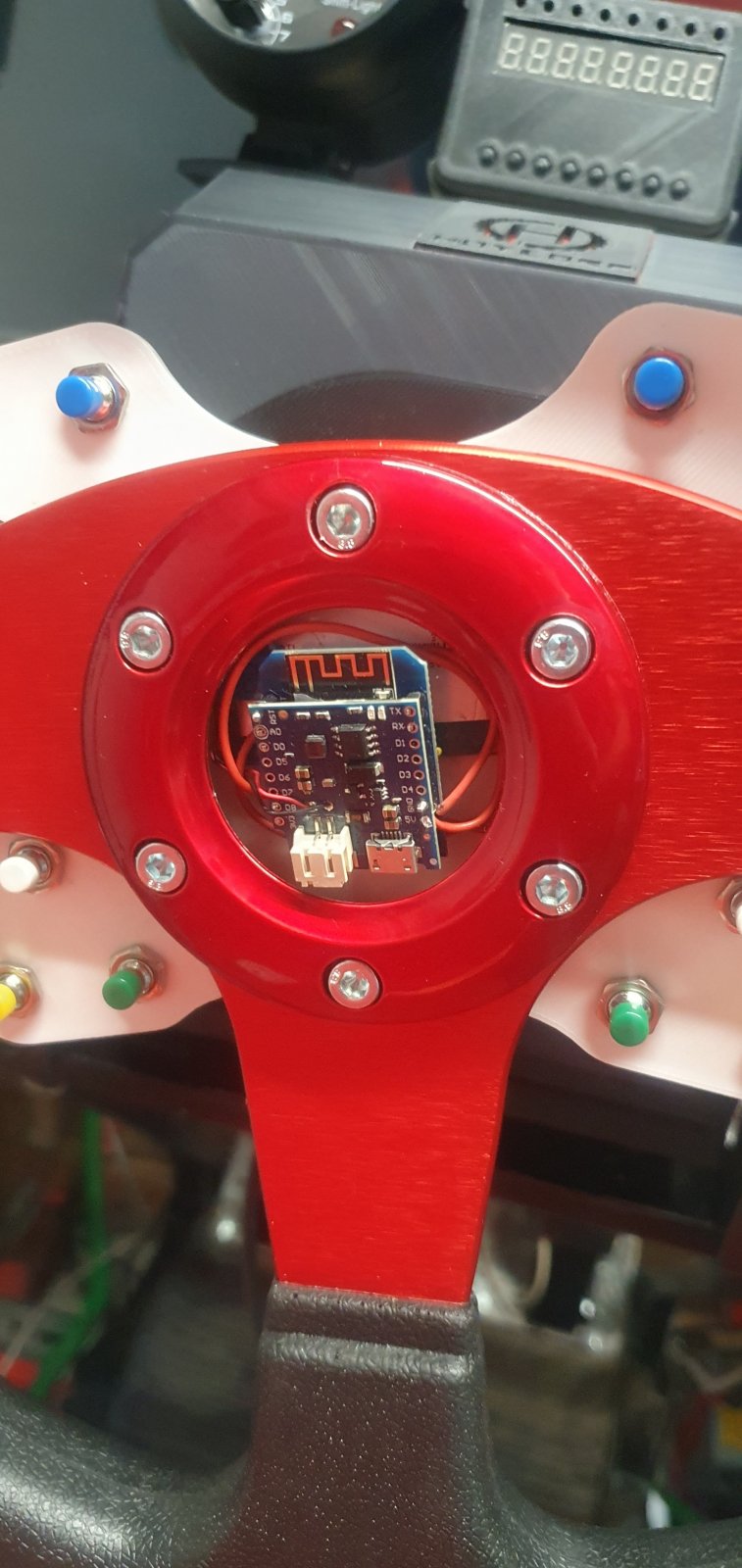

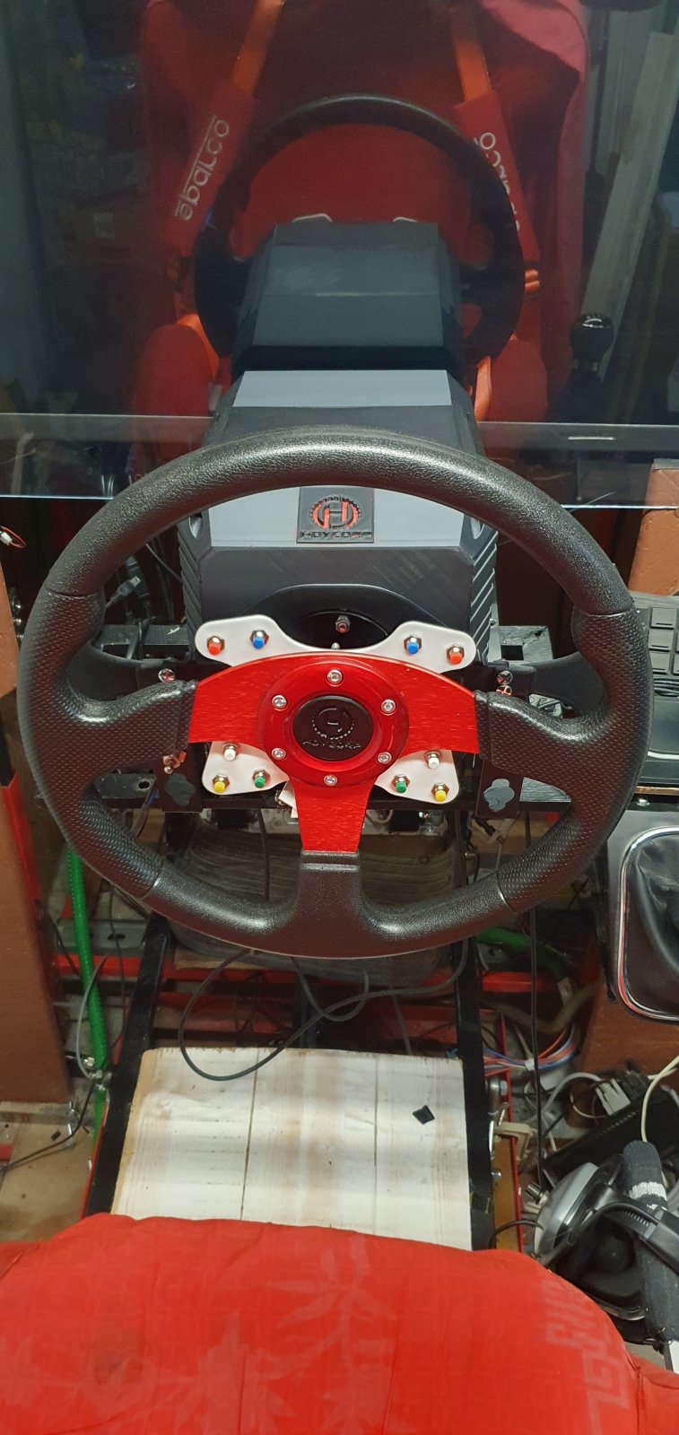

    finally no more cables that hinder driving.
    modification of the steering wheel for wireless management of game buttons.
    wemos d1 mini module + wemos battery holder.

    Direct drive Steering wheel.

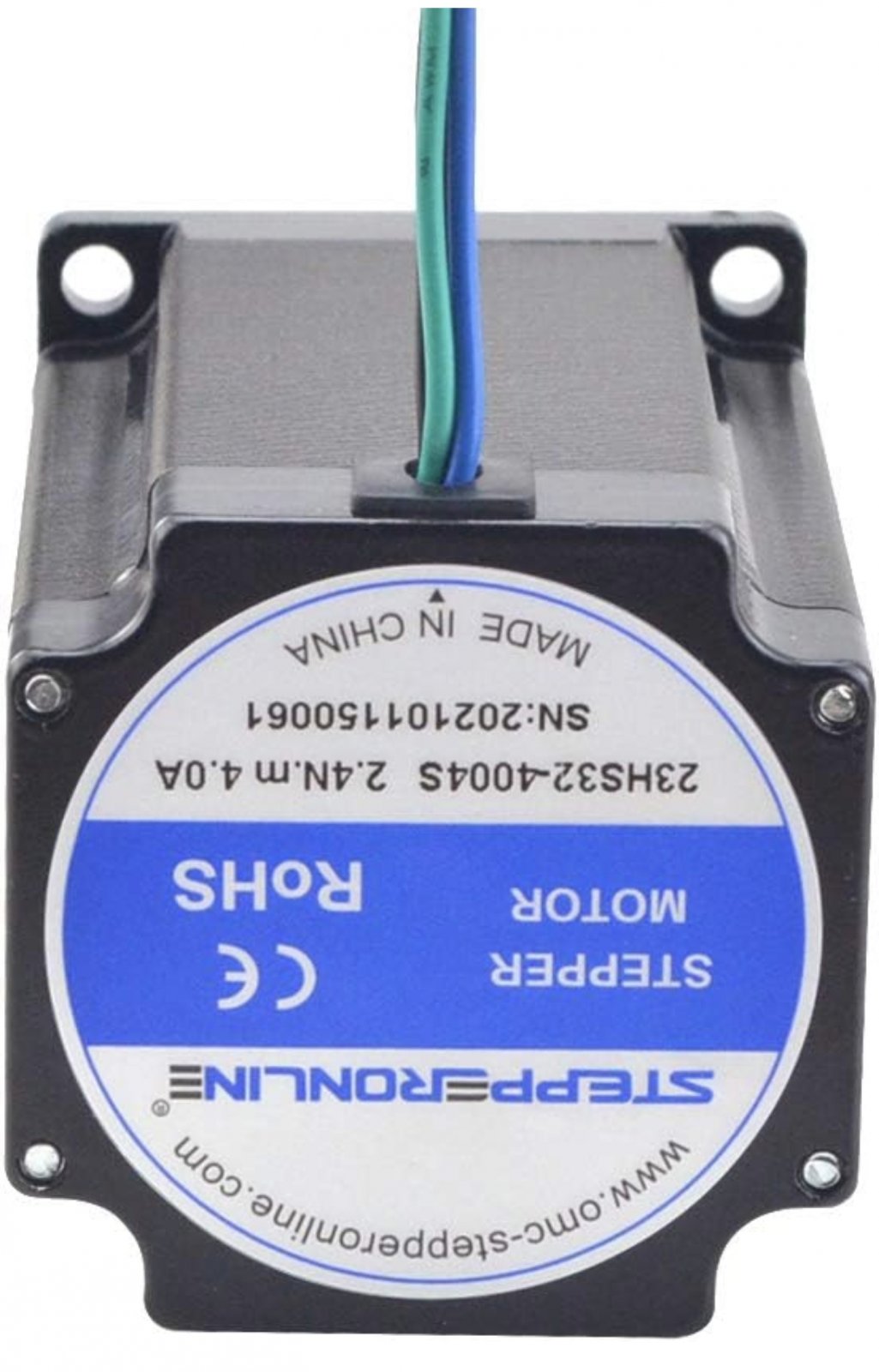

  18. brkN
    brkN New Member
    Aug 16, 2020
    6Coins
    I love your belt tensioner setup, which Nema23 did u use and is it´s power enough for your needs?
  19. hoyang
    hoyang handyman
    Dec 14, 2017
    94
    Bricoleur
    1,337Coins
    +90 / 0 / -0
    Screenshot_20240321_222317_Amazon Shopping.jpg the strength of the motors is sufficient to feel a good pressure on the shoulders
  20. brkN
    brkN New Member
    Aug 16, 2020
    6Coins
    Thx! Are u willing to share the code? Love your design and might want to copy it, as it is much more simple compared to wiper motors
