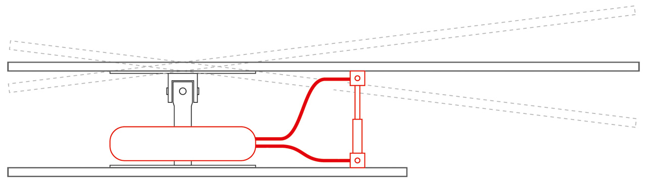

    Thanks a lot for your explanation Tahustvedt!
    If I'm correct basically what you do is place an air cylinder with an expansion tank next to the motor and pressurize it until the platform (including driver) is easy to level and move up/down without having to apply too much force? And the bigger the expansion tank is, the more linear the cylinder responds.
    Are there any basic rules to calculate the cylinder one would need for his platform?

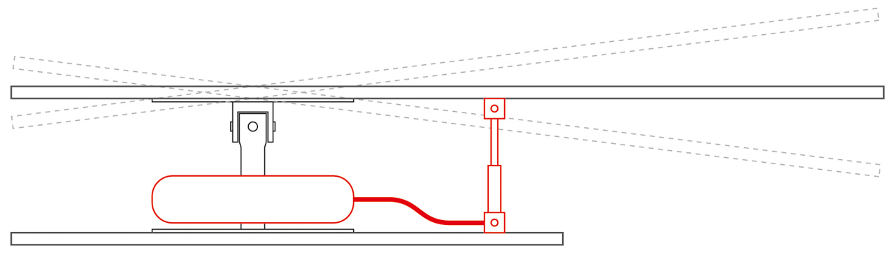

    And is a single action cylinder used:
    Or does it have to be a double action one:

    The cylinder needs to be double action for it to work as a spring. Single action cylinders usually have a spring in the opposite end to move the cylinder back when air is removed, I believe. You connect the tank to one end of the double action cylinder, and leave the other end unconnected to breathe freely.
    A double action cylinder can be set up to either compress, or expand, depending on which end you apply pressure. I apply pressure so that mine wants to compress, which means there is no chance of the piston rod bending under load.

    @tahustvedt
    You pressurised the cylinder so it wants to compress.
    Which meens it's mounted in such way that your sim (when idle) wants to expand it right?
    In case of my sketch (the more common type of sim compared to yours ;) [strike]it would have to be the other way around because the motors will have more problems pushing the platform up than pulling it down or am I mistaking there?[/strike]
    Edit:
    Just figured out that my statement above is wrong and most likely should be:
    • Cylinders on same side as motors: Cylinders need to be pressurised so they want to expand
    • Cylinders on other side of pivot as motors: Cylinders need to be pressurised so they want to compress
    Right?

    That sounds right.
    Yes, my sim wants to extend the cylinder. I don't know how long these cylkinders last in this application, but I expect the high quality ones to last for years since they are for industrial use.

    hmm, just came to think that if my above statement is right, 2 cylinders won't be enough:
    if I place 2 cylinders on one side they will help push the platform up on that side (and thus sort of pull it down on the other side) but it won't help the other way around, or am I missing some logic here?
    Edit: as you can see pneumatics just isn't really my thing ;)

    If the sim is balanced and teetering then the expansion tank is probably not a good idea as you will not want a linear force. A double action cylinder can spring both ways if it's pressurized on both end connectors while centered, and then the connections are closed. It will give progressively more force towards each end and the force can be adjusted by changing the pressure.

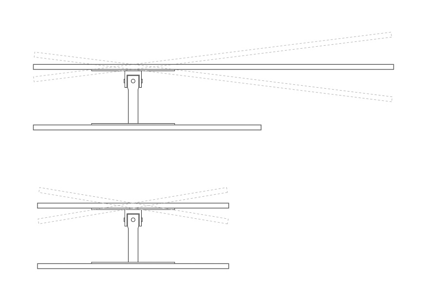

    Now the question is how we can use this to reduce the motor load in the below platform type where the center of gravity is above the pivot:
    Do we need to put a cylinder with expansion tank on each corner, just 2 corners or......

    Hoi Floris
    Ik zou pas aan gewicht compensatie gaan denken bij een dof 3 met lift optie.
    Zoals ik begrepen heb wil jij deriy's simulator na bouwen, hier heb je geen gewicht compensatie bij nodig.
    De krachten bij een seatmover en deriy's simulator blijven gelijk (het draait namelijk om de afstand tussen kruiskoppeling en aktuator)als hij goed uit gebalaseerd is.
    welk compensatie systeem je ook gebruikt het gaat tegen werken bij deriy's setup.
    de krachten worden groter als je verder van zijn balans punt af gaat en werken als volgt: uit gebalanceerd 0kg en op 90 graden van balans punt het volle gewicht
    hier tussen word het verdeeld bijv. op 30 graden 1/3 van volle gewicht 45 graden 1/2 van volle gewicht op 60 graden 2/3 van volle gewicht.
    Aangezien je bij deriy's setup niet zo veel bewegings vrijheid hebt blijven de krachten ook binnen de perken.
    Als je later een dof 3 wil maken zet je de cilinder onder de kruiskoppeling.

    .Volgens mij hoeft het toch niet tegen te werken bij deriy's setup,als je met een dubbelwerkende cilinder werkt met 2 apparte drukvaten en slangen op beide cilinder nippels.
    Op deze manier kun je beide kanten van de cilinder op druk zetten, en komt de trek/duw stang in het midden te staan,en kan met een bepaalde kracht 2kanten op geduwd worden.

    So Ad, basically what you are saying is that due to my max pitch of 14° and roll of 18° the most weight my motors will have to deal with is approx. 1/5 of the total weight? (about 125/5=25kg)
    Personally I think that's still a lot and would love to reduce that.
    Will adding double action cylinders with an expansion tank on both connections take care of that? (so 2 cylinders and 4 tanks in total)
    Edit:
    If I'm correct more pressure results in the platform re-centering more easily but the motors having to work harder to tilt the platform? And are the expansions tanks actually needed in that case?
    Basically in that case the cylinder is working like a spring right? So using springs would be easier, but not adjustable?
  20. adgun

    Hi Floris
    I made a mistake 2 vessels upon one cylinder will not work sorry.
    If expansiontanks are needed, depends on pressure
    Yes the cylinder and vessel become one adjustable spring
