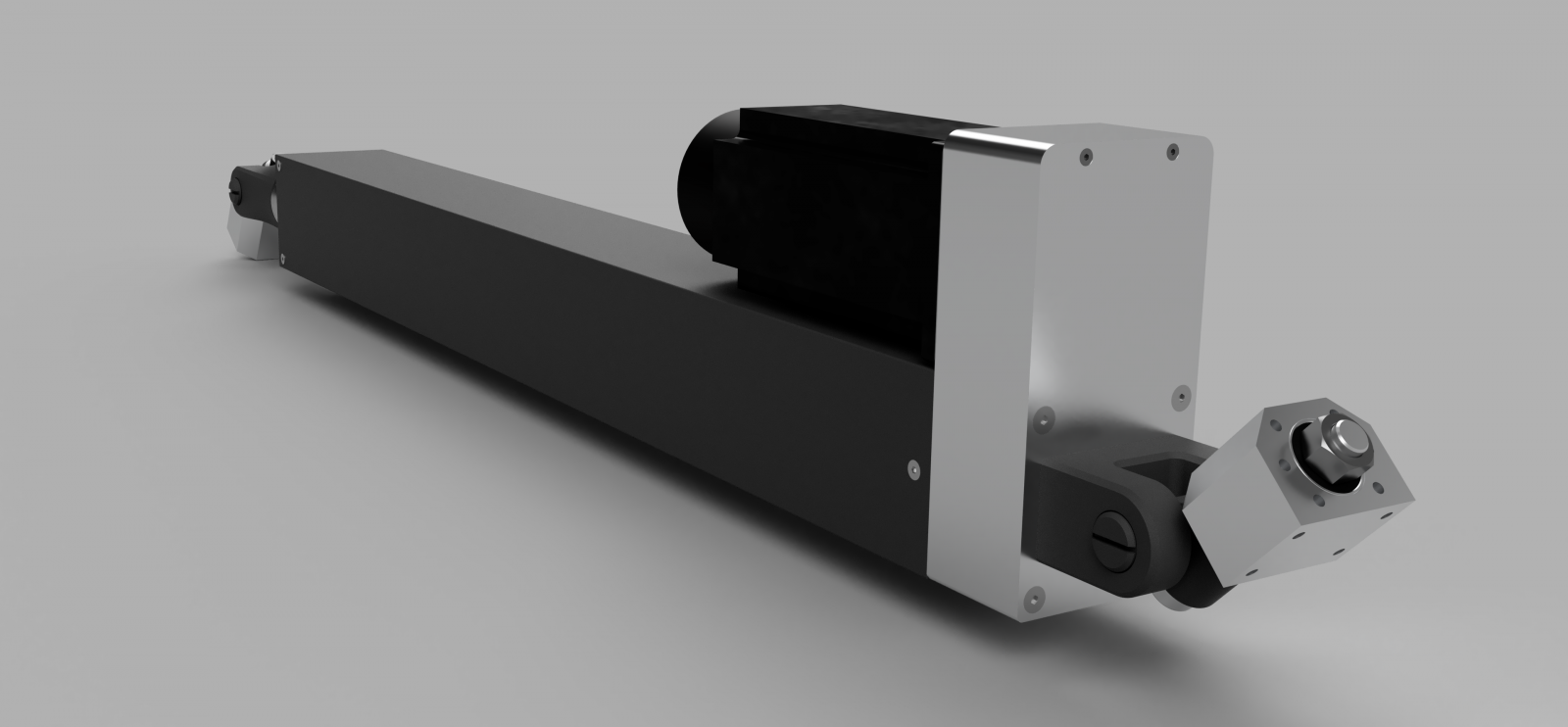

    I started working on my second rig almost two years ago (early 2021) in the midst of the pandemic. With A LOT of spare time on my hands, some previous experience from my first rig and some left-over funds I was able to make quick progress and had it ready within roughly 8 months.
    Here's the final result:
    And two videos:
    I'm gonna go through the design process somewhat chronologically, starting with the heart of it: The actuator:
    Screenshot 2022-06-13 152304.png Screenshot 2021-01-21 at 21.30.10.png Superpusher_TopAssembly_2021-Feb-05_12-10-04PM-000_CustomizedView866266250.png

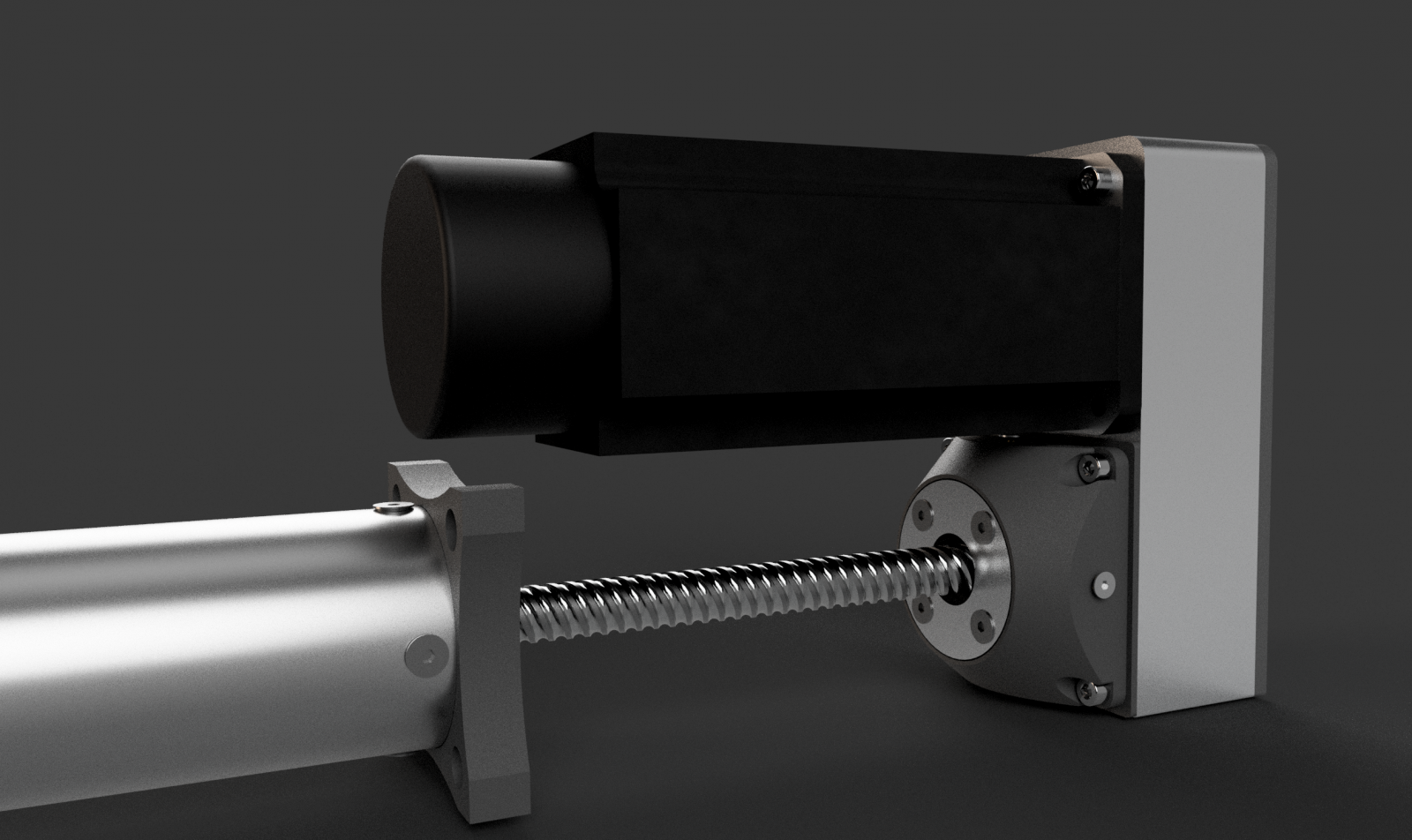

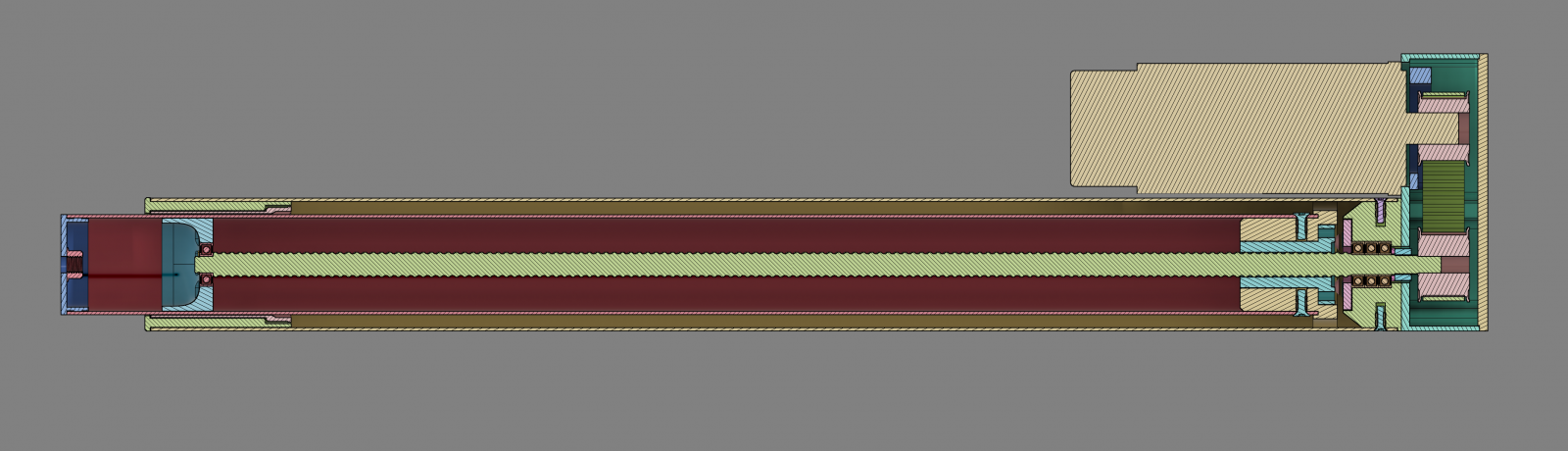

    After my first build, in fact even during my first buid already, I was looking for features to improve. I wanted it to be more quiet, more smooth, more stroke, more safety, better looks and I am quite satisfied with the result.
    Key features:
    • Fold-back motor configuration
    • SFS1620 ballscrew
    • Closed body design
    • Internally constrained (rod won't spin!)
    • 620mm stroke (minus ~20mm buffer --> 600mm usable stroke)
    • 808mm overall length (w/o u-joints)
    • 833mm/s speed
    • 1KW power
    • 1000N (~100Kgs/220lbs) force in both push- and pull direction
    • Single, but looooong upper bearing for buckling stability

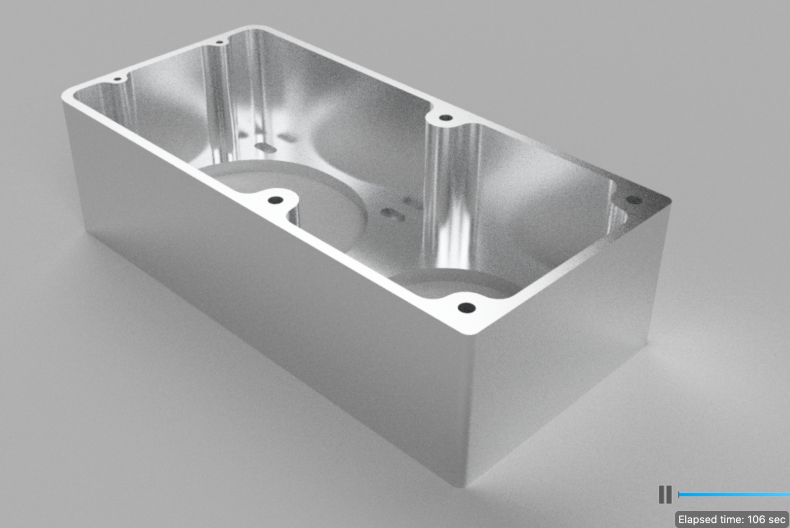

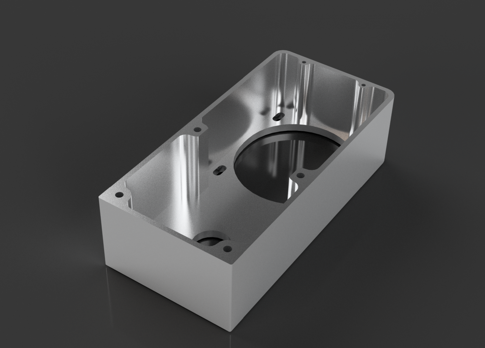

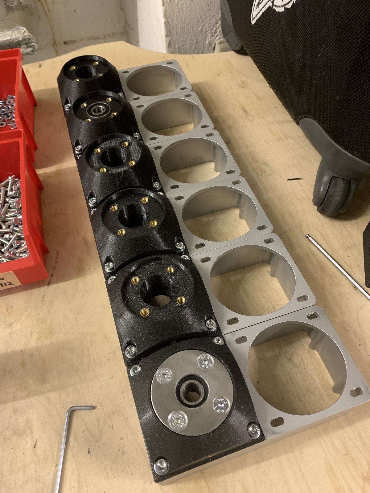

    I wanted the belt drive to be in a closed housing for noise and safety reasons. I got 6 of these made from www.xometry.com CNC'd out of aluminum:
    Just for comparison:
    1pc: 170€
    6pc: 60€
    60pc: 22€

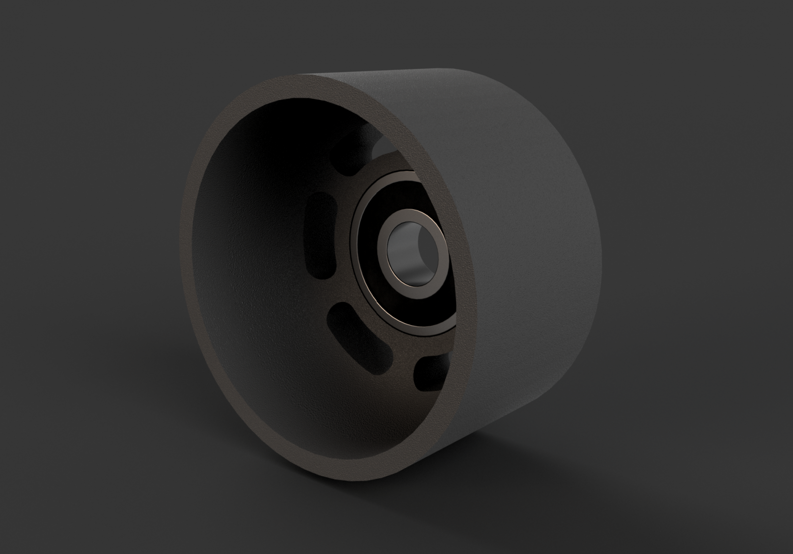

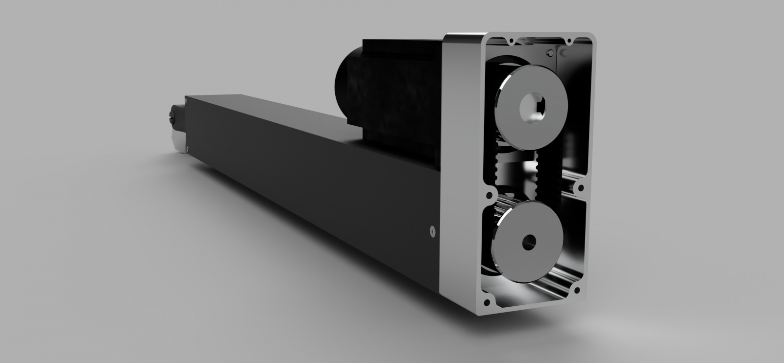

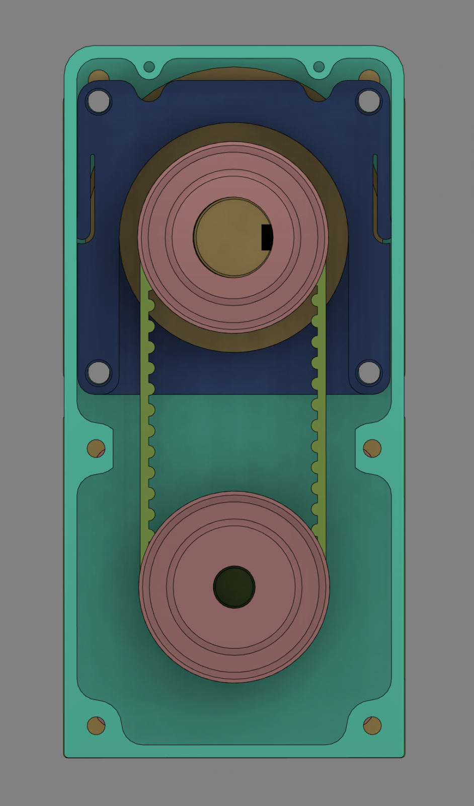

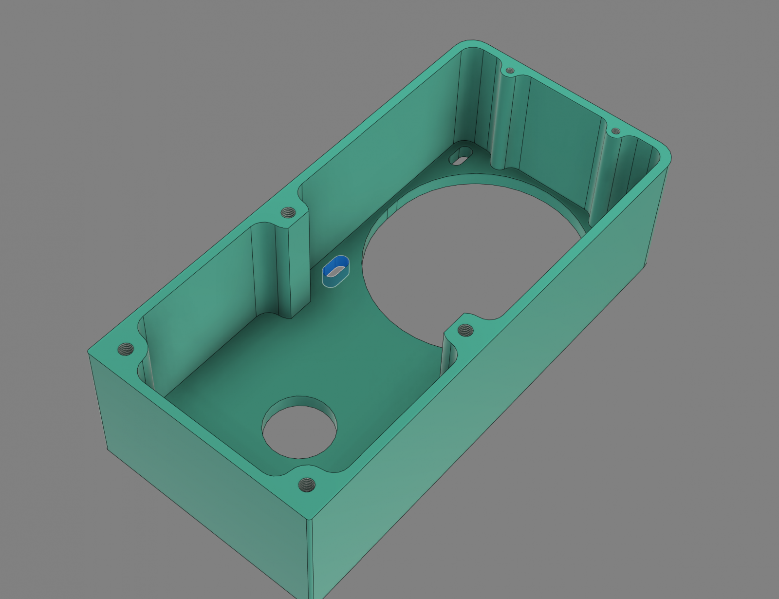

    Inside this CNC'd housing runs a 25mm wide, 1:1 belt drive (30 teeth on both wheels) with a little room still left to cater for possibly changing the gear ratio if needed in the future.
    So far, after about a year of operation I can say that the 1:1 ratio works perfecly fine for single person use.
    The belt drive does not have a dedicated tensioning mechanism, but relies solely on mounting the motors in elongated holes:

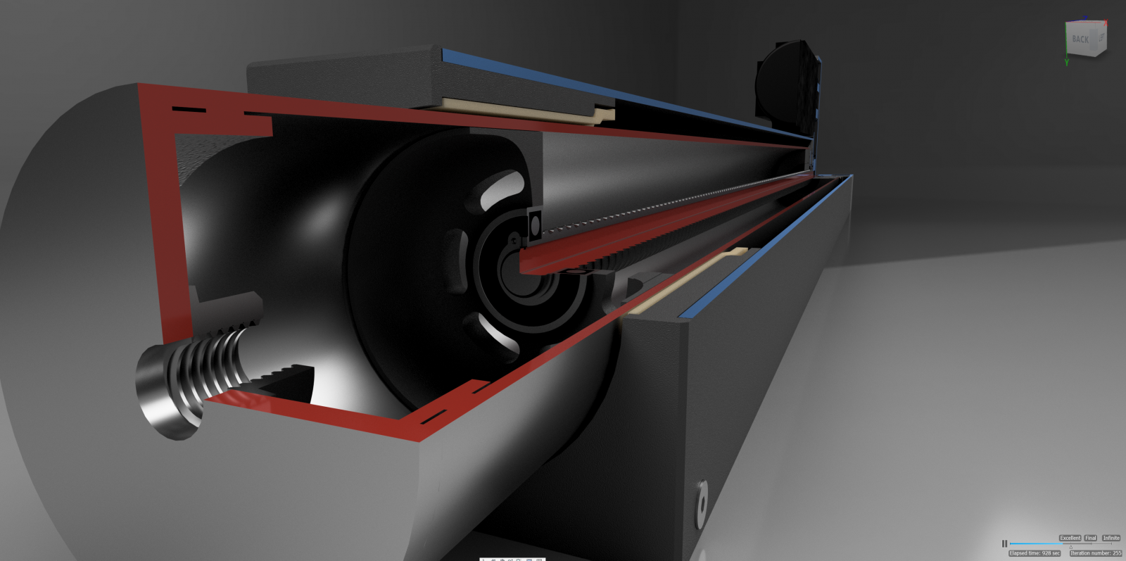

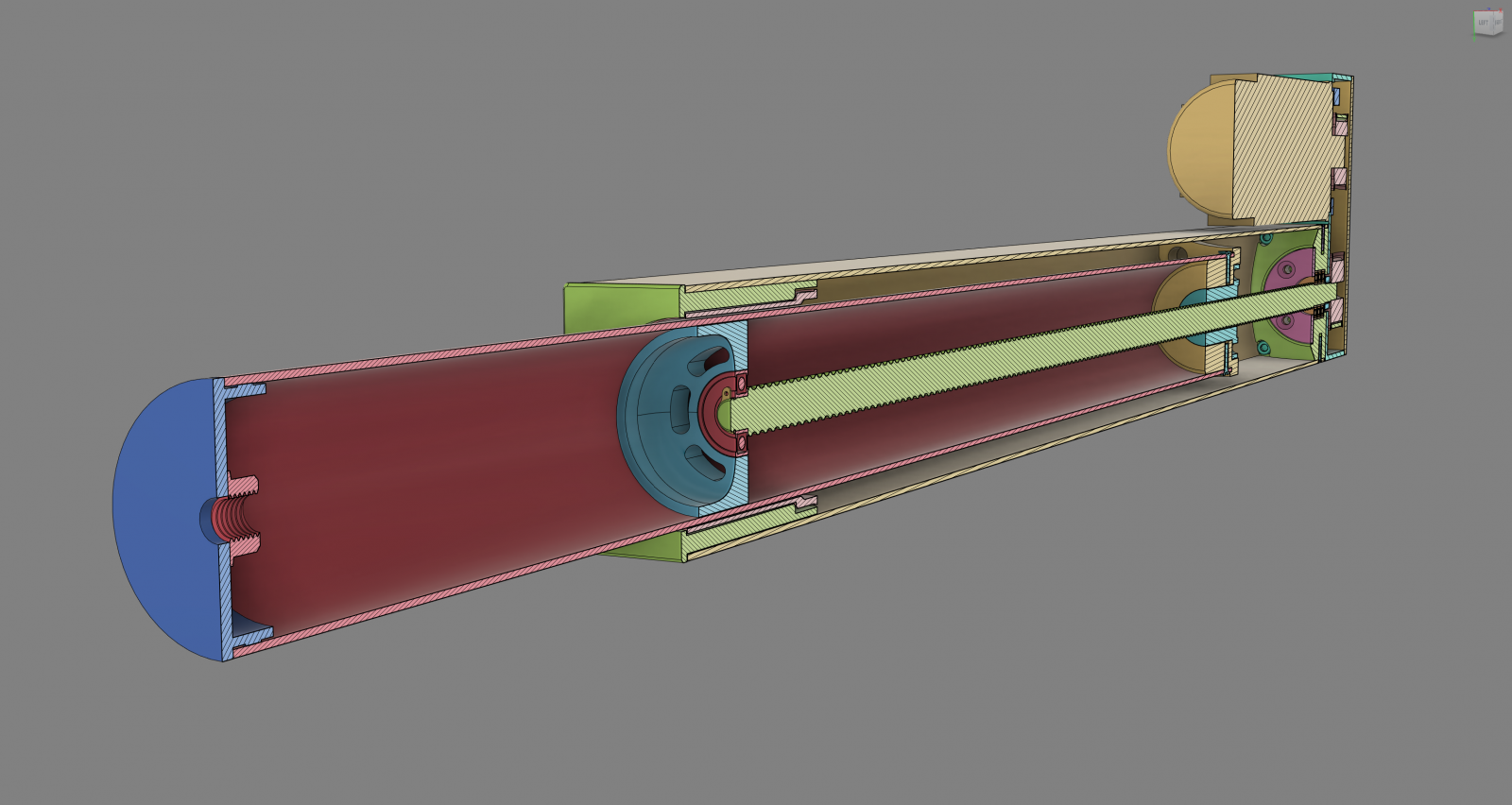

    Here's a crosssection for overview:

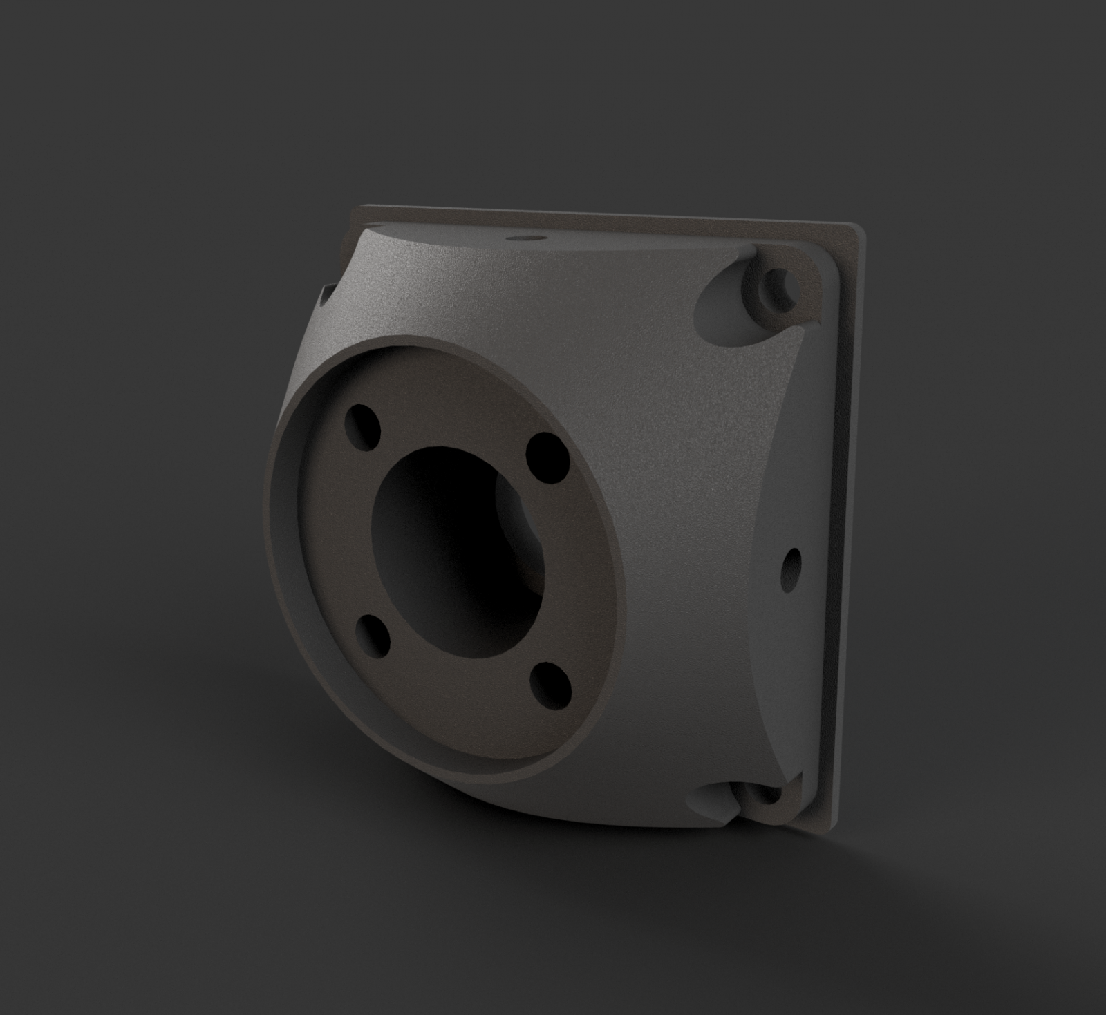

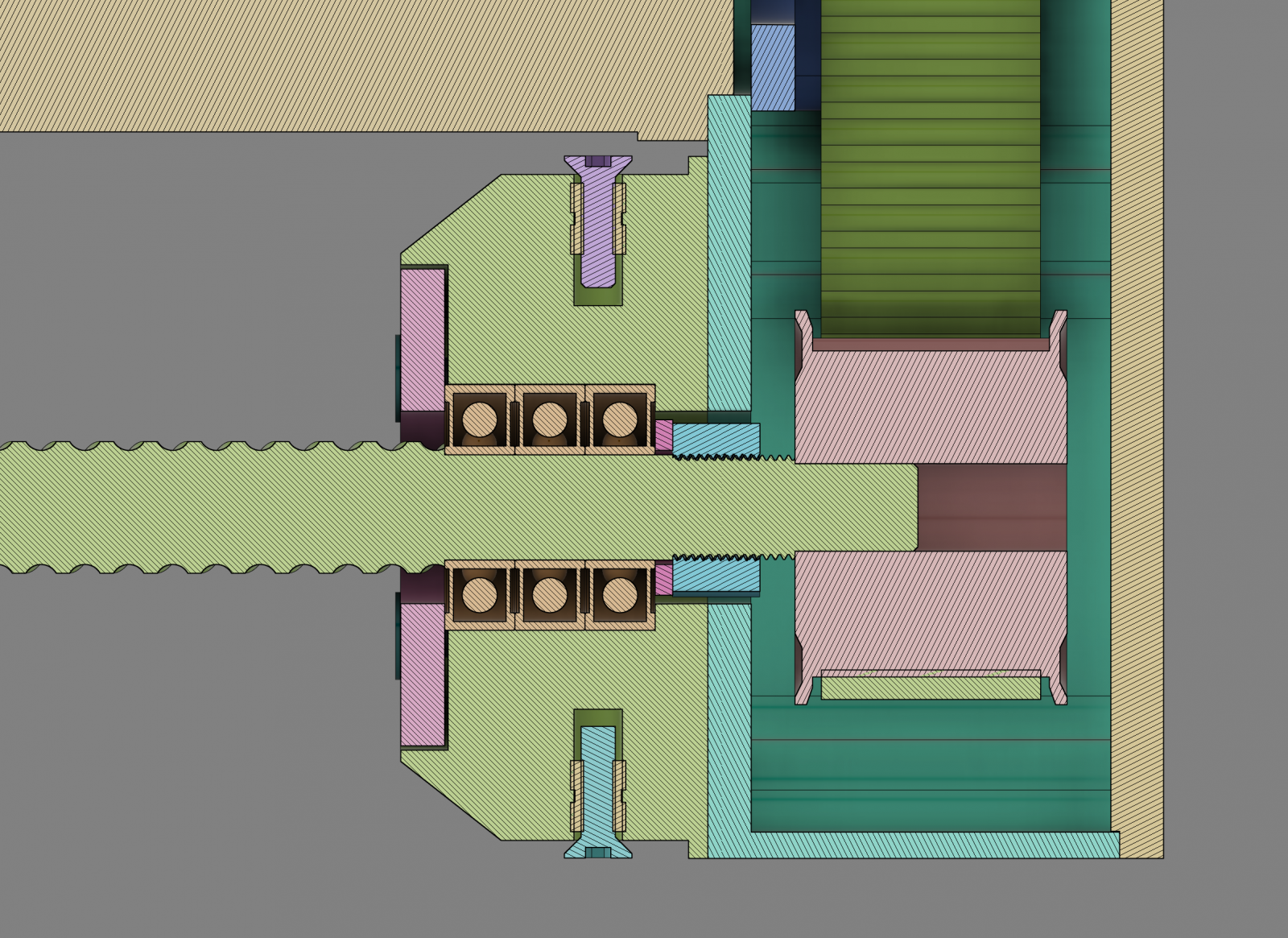

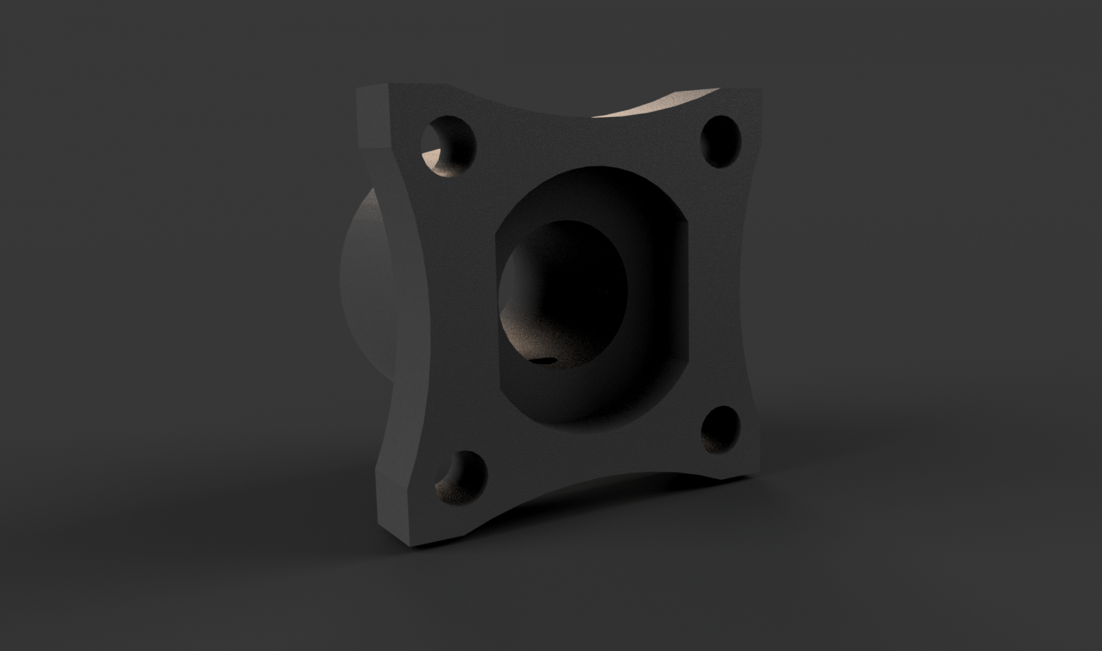

    One of my main goals was increased reliability/durability. On my previous build I noticed the simple 6001 bearings that were used in those FK ballscrew bearing blocks. I wanted those bearings to be bigger/better/more, so I had to design my own custom bearing blocks, FDM printed.
    Screenshot 2023-01-30 143613.png Screenshot 2023-01-30 142521.png IMG_3097.JPG
    I decided on three 12 x 28 x 8mm bearings to hold the axial loads. A great improvement and much better use of the available space.

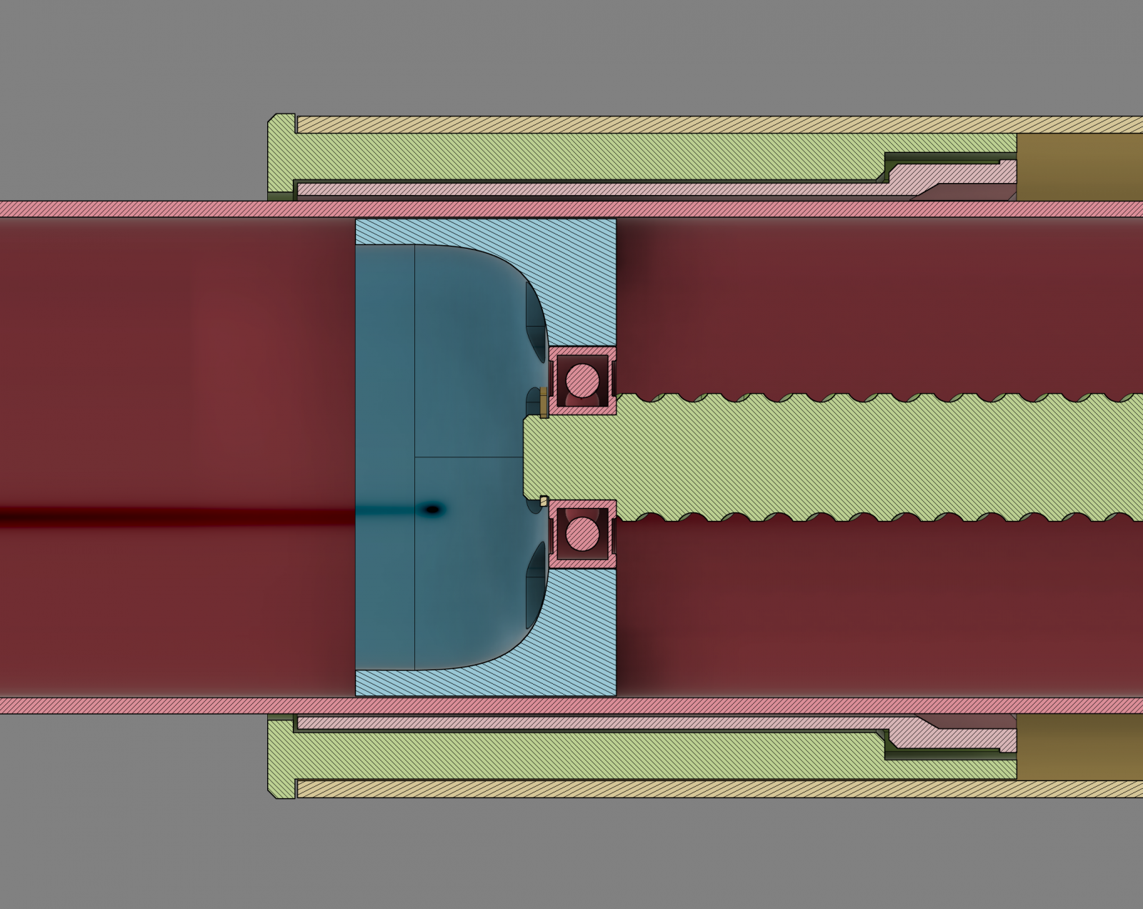

    The ballscrew is an SFS1620. I increased the lead to 20mm to require less RPM for a given actuation speed, thereby reducing vibrations and noise significantly. The actuator was designed around the standart ballscrew, so no custom end machining is required.
    The ball nut is mounted inside this FDM printed "nut sleeve" which transmits the loads to/from the pushrod. It also constrains the nut through the four corners that keep it from rotating.
    The pushrod is a 60x2mm stainless steel pipe. The size of the diameter (and so its failure load) is much stronger than what would ever be required of it (like 30x), but I chose it this large to allow the ball nut to sit almost completely inside the push rod:
    That alone saved me about 30mm of overall actuator length.
    • Like Like x 6
    • Optimistic Optimistic x 1

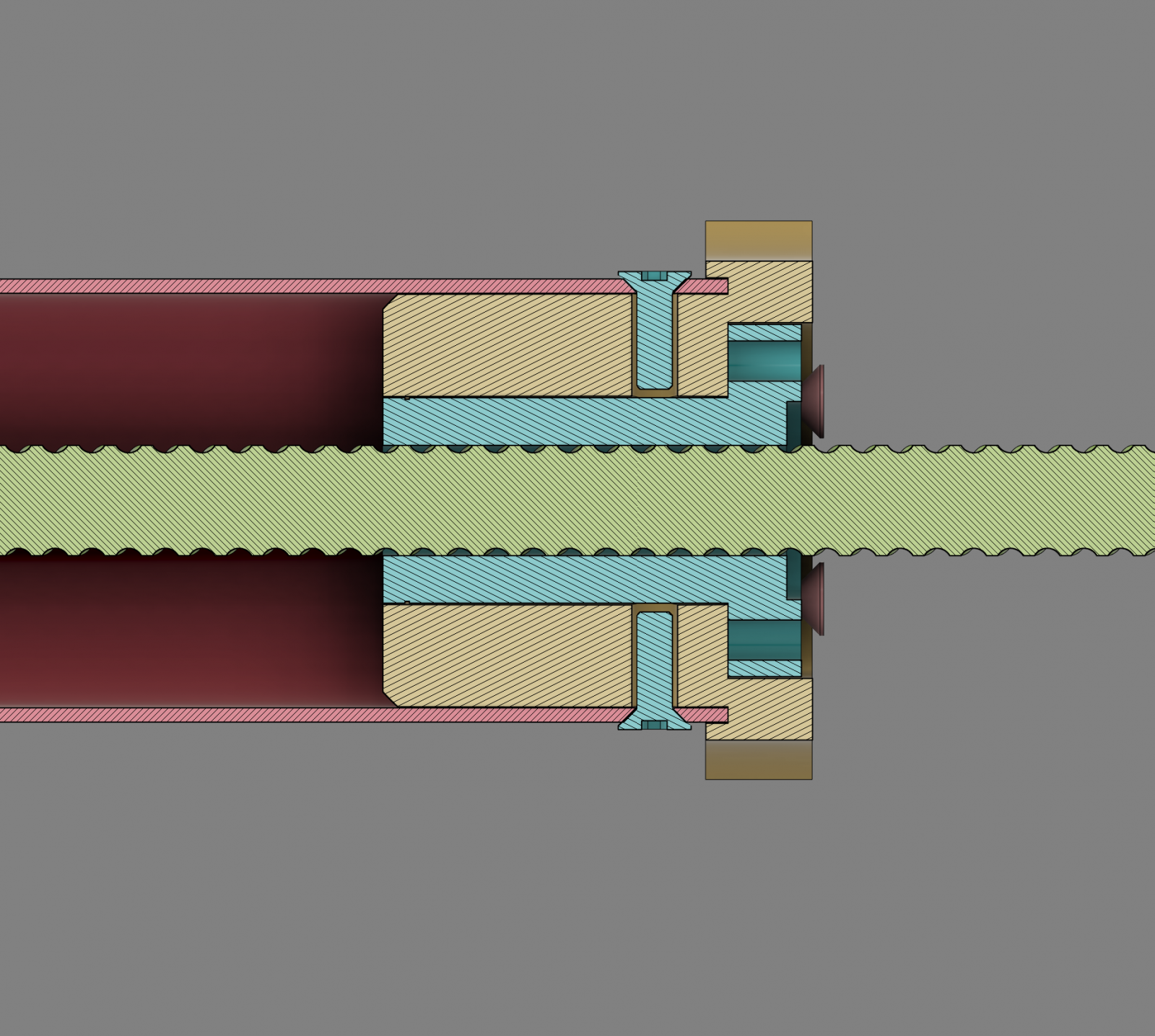

    Next comes the spacer inside the rod.
    I consider this an important part to carry the buckling load. But I also have to mention that many other builders are omitting this part alltogether and they don't report any problems whatsoever.
    Probably worth a note: I have printed a couple of them in 0.1mm increments to get a perfect fit. Up to a point where I could insert one into the tube (with bottom closed off) and it took ~10s for it to "fall" all the way down because the gap clearance was so tight.
    I wanted a bearing inside, because at speeds of up to 2500RPM it just felt better. Also 85ct for a bearing is a small price to pay for eternal peace of mind. At least in that regard :)
    And of course, needless to say: I had to add ventilation holes to let the air inside the rod escape, given the tight clearance described above.
    The somewhat un-orthodox dimensions come from a fear that the part might bind inside the rod when it tilts slightly. And since this particular space was not length-critical anyways, I gave it some length to prevent it from tilting. It had the beneficial side effect that it now has 54cm² of surface area in contact with the rod to distribute load onto --> very little wear & tear expected over time.
    • Like Like x 9

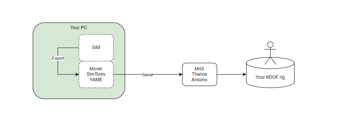

    Could I trouble you to quickly tell me the flow through all the software programs so I know what those various components are?
    I'm sure I've got this wrong or missing parts:
    Flight Sim or racing game ===>simtools? Some sort of plugin? ==> Your hexago motion cueing program? (Only if actuators or is that system agnostic?)==> Controller like Thanos or motion4sim ==> controllers and servos
    Thanks!
  16. Dirty
    Oct 15, 2017
    744
    All the way up front.
    7,927Coins
    +880 / 3 / -0
    Almost :)
    I would give this as a rough schematics:
    SimTools uses plugins that allow users to add support for their favorite games. Mover and Yame have no plugins.
    I think SimTools supports the largest number of games, Mover also has many titles supported and my own software (Yame, still alpha!) supports only DCS, X-Plane, FS2020, Condor2, and soon iRacing.
    The export path depends on the sim you want to export data from. Some offer a TCP/UDP interface, others use memory mapped files or a custom .DLL from an SDK.
    Mover has kinematics implemented for all different kinds of rigs. Pretty much no limits threre.
    SimTools has no kinematics system implemented directly, but AFAIK relies on forwarding the motion data to other software. Someone correct me if I'm wrong.
    Yame only supports 6DOF linear actuator setups. Crank arm systems might come at some point, but don't hold your breath for it.
    My recommendation would be: Use Mover!
    Cheers,... :)

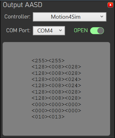

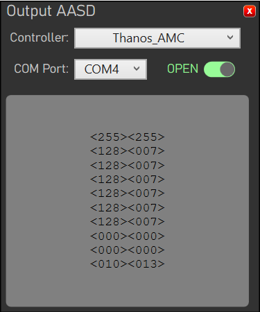

    You mean to the motion controller? AFAIK both Thanos and M4S expect a couple of bytes only.
    - Starting with <255><255>
    - Then 8 numbers represented by 3 bytes (M4S) or 2 bytes (Thanos) each. These numbers represent a value between zero and 16.777.215 (M4S) or 65535 (Thanos) that indicates where on the full travel the actuator is.
    - Ending with <010><013>
    Here's an example for all actuators pretty much at 50%:
    I put it in lines for better readability in the UI. The controllers expect something like...
    Code:
    <255><255><128><008><028><128><008><028><128><008><028><128><008><028><128><008><028><128><008><028><000><000><000><000><000><000><010><013>
    Cheers :)
