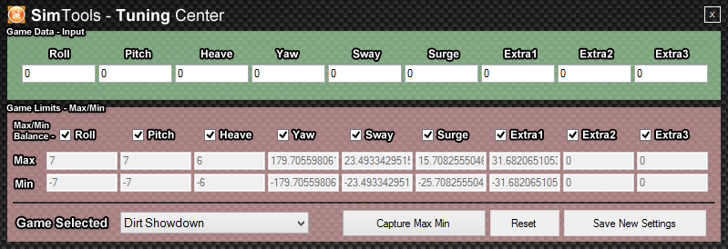

    Last night I downloaded dirt showdown on steam and simtools won't recognise it running. I've tried everything that I can think of from previous plugin installation issues. I am using windows 7 64 bit and i tried naming the exe exactly like the plugin but nothing has worked yet

    Can confirm it works under v1 without any issues.
    Patch area for 64Bit is "C:\Users\(User)\Documents\My Games\DiRT Showdown
    Im running Windows 8 too in 64bit.
    When the game fires does the Game Manager display "Game Running" in blue, if so then check the Game Engine - Tuning Centre for values coming from game in the green area, if not then check you Game Engine - Axis Assignments for Dirt Showdown and be sure that the axis are set, finally check that the min max setting have been set in the tuning centre, if Min Max too large you wont get any motion, either.

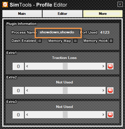

    I bought this game the other day during the Christmas sale. I too have found that it does not work for me.
    I followed all of the above advice and nothing.
    Checked that the patch info was created and in the proper place.
    I am running Simtools 1.1
    Changed the case of both executable files even though that shouldn't matter now (and it didn't, still doesn't work).
    One thing that I noticed that is different; in the profile editor the executable is shown simply as showdown, unlike Eaorobbie's example above.
    In processes in Windows (8) it shows that showdown_avx.exe is the process running, not showdown. I cannot look in the plugin dll file to see which one it is actually looking for though.
