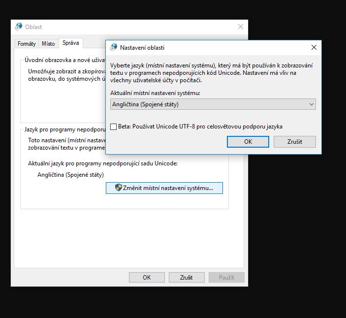

    Soo, after long time i came back to run Dirt Rally.. Well when i run it i recieved common .net framework problem and all my Simtools collapsed.. As i was using simtools 2,25 i decide not to worry too much, backed up settings, deleted simtools completely and installed 2,3 verison.
    Now i can run Dirt Rally with simtools, however my motion is missing..
    Well i have traction loss motion ok (i have 2dof scn6 seat mover with TL) but the rest is dead and i can not absolutely find out why...
    Assetto corsa works normally (perfectly:). I believe i have Axis Assigment and everything ok (as i´m using similar settings with AC, and this WAS working at my rig with Dirt Rally also)...
    When i try to turn on virtual axis while running Dirt i recieve errors ang game engine crash...
    I got unicode language settings to US, i try to repair / disable .net framework, no helps.
    Also i got config.xml at Dirt Rally set properly i believe..
    So i really do not know where is the problem... Any ideas?:)
    Btw last time i run Dirt Rally was at Simtools old version 2,2 i think.. I´m not sure if i´ve run it at 2,25 (i believe not)...
    Here are some screenshots of errors and my settings..
    https://imgur.com/a/J5IBD7R
    Many thanks!!

    It is much easier for members to help if you post the pictures dirctly here: https://www.xsimulator.net/community/faq/upload-pictures-or-files.81/
    In the picture you did post the computer is definitely not set to English local, as I can't read the error message: https://www.xsimulator.net/community/faq/simtools-language-setting-bug-change-to-english-local.233/
    Your roll and pitch ZIR settings are also messed up in Axis assignments, as one is always the opposite of the other.
    Did you also upgrade companion apps, if any are installed, like Game Vibe?

    Ok will do, sorry.
    Well trust me, i have got this set to English (this solved MANY problems for me..). Only Windows language is Czech, but this important setting is set to "English (United States).
    Do not worry about this pitch and roll settings atm, i´ve just clicked it in hurry to tune later. Most important for me are Sway and Surge which are non-existent completely...
    Yes i´ve upgraded Vibe to latest version (B44) and this works fine (in Dirt and other titles..).

    Quick update..
    - fresh reinstall of dirt - no help.
    - tried both plugins which are available in download store - no help (at 2.0.0.3 works only extra 1 for me, second one 2.1.1.0 does not work at all - unhandled exception when selecting profiles at Game Manager or starting the game).
    - however i´ve found SilentChills plugin (https://www.xsimulator.net/community/threads/codemasters-dirt-rally-plugin.6823/page-22#post-130123) which works ok!! Althrough there is no Vibe support:(
    Strange... would love to know WHY:-D
