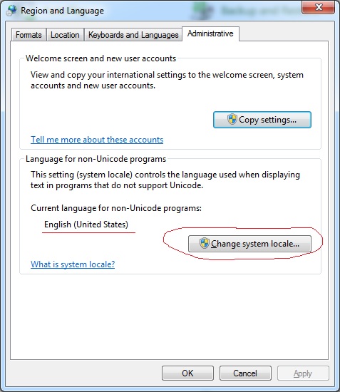

  12. yobuddy
    5,162
    48,172Coins
    +5,037 / 16 / -0

  19. noorbeast
    20,539
    145,052Coins
    +10,777 / 52 / -2
    The plugin is built against the Steam version.
    Have you tried known solutions, such as using English Local language settings: https://www.xsimulator.net/community/faq/simtools-language-setting-bug-change-to-english-local.233/
    On Codemaster games the patch path is different for 32 and 64 bit computers: https://www.xsimulator.net/communit...-32-bit-install-path-for-motion-patching.260/
    Does your rig respond correctly in Output Testing?
