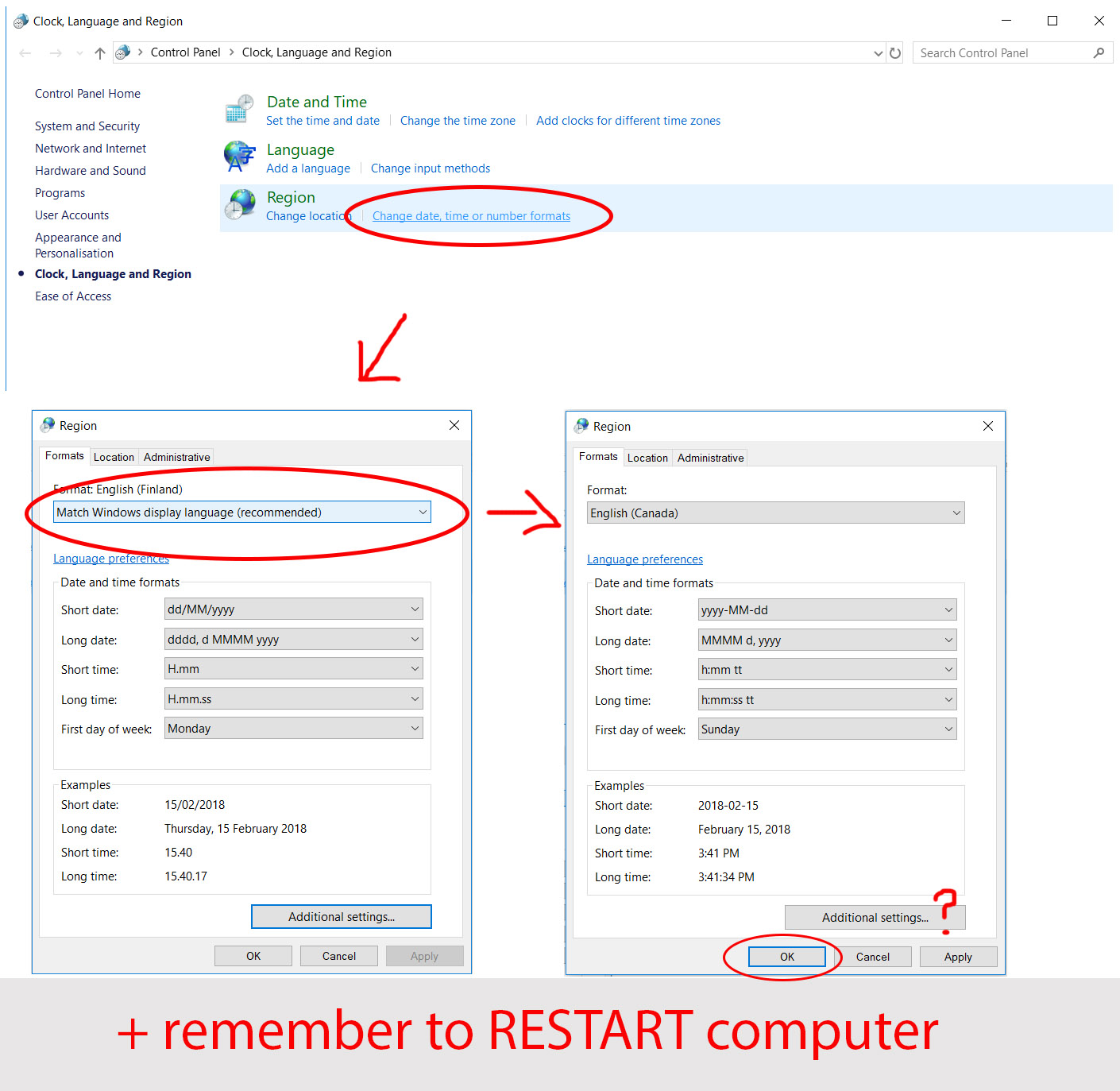

  8. Jymä
    Jymä Member Gold Contributor
    Nov 24, 2011
    61
    Finland
    184Coins
    +43 / 0 / -0

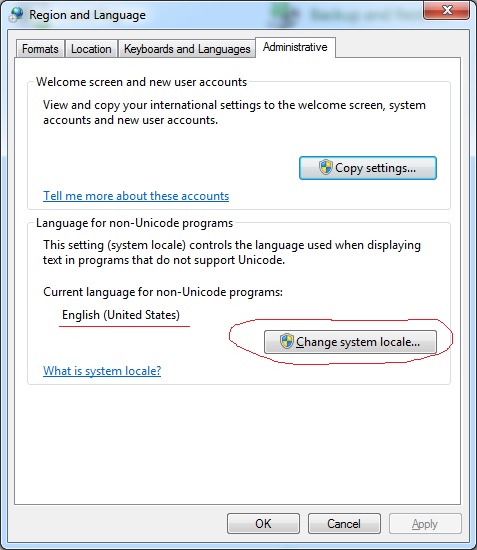

    I can confirm the issue still exists, but I found a workaround. On Windows 10 you can search Control panel (Win+S).
    It must be connected to decimal format or something on additional settings, I didn't test which setting is causing it. But you can reproduce it by changing the format to some European country. I remember SMC3 used to have the same issue with SimTools.

  10. baykah
    baykah Active Member
    Sep 1, 2016
    137
    Toulouse - France
    414Coins
    +132 / 0 / -0
    nice fouding, it was it for me too
    I switch on langage parameter in my win7 the decimal indicator from , to . and it worked :)
    I have windows in french and the standart parameter is ","

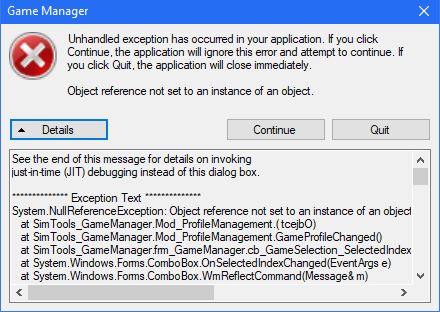

  11. Sarge
    Sarge Active Member Gold Contributor
    Aug 11, 2016
    117
    - 181Coins
    +64 / 0 / -0
    I'm struggling to get any of the new plugins to work. Game manager just crashes with the error below. Not sure if I'm doing anything wrong. All previous plugins seem to work fine for me but Dirt 4 and Dirt Rally now produce this error.
    Any ideas?
    Cheers :)
  12. baykah
    Sep 1, 2016
    137
    Toulouse - France
    414Coins
    +132 / 0 / -0
    I had to delete the old plugin for rally, I went to the good directory and deleted every thing
    After that, I reinstalled the new plugin and It worked

  13. Sarge
    Aug 11, 2016
    117
    - 181Coins
    +64 / 0 / -0
    Thanks, I'll give that a try later :cheers
    Update: That worked. Thank you very much for pointing me in the right direction :)

  20. yobuddy
    5,160
    48,153Coins
    +5,036 / 16 / -0
    try this,
