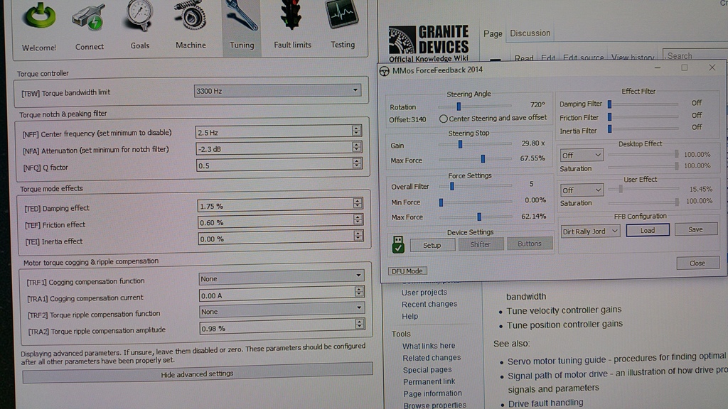

    These Granity & MMos settings i got from Jason Jordarski on iRacing ,,,,the only thing i changed was the TBW upto 3300Hz
    I'm using small mige + ioni pro hc : simucube

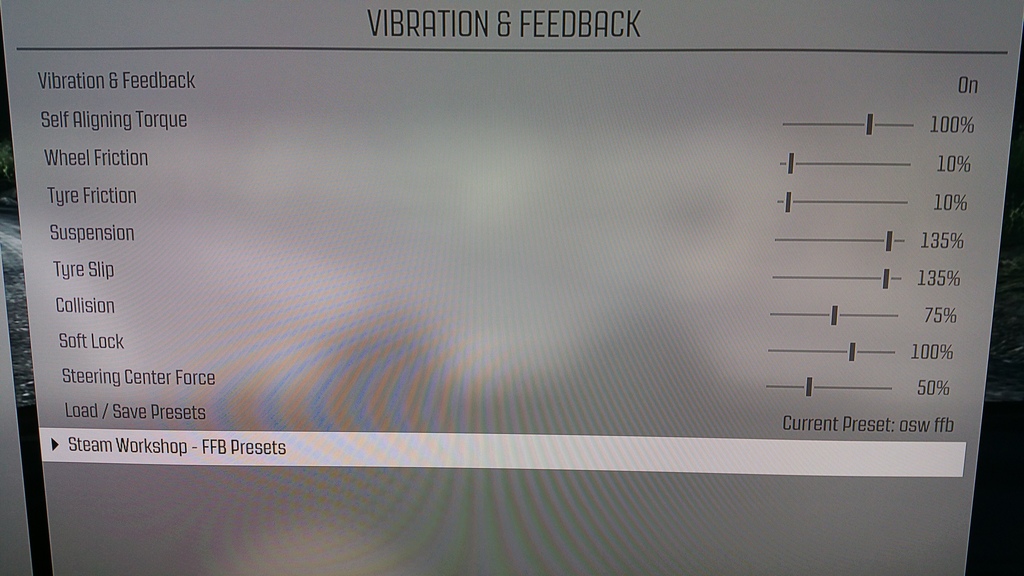

    These are my in game FFB settings although drop Self Aligning Torque to 70
    These setting feel pretty good to me ,,,if anyone can improve on them or has some other cool settings of their own i'd be happy to see them,,,, :thumbs

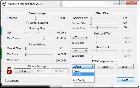

    In mmos you have to save to eprom and default for it to load. you can also make config files.

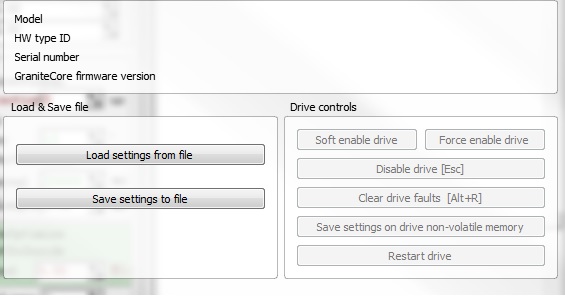

    you can make profiles and save and load different profiles here on the connect page of granity. for settings to load on start save to non volatile.....

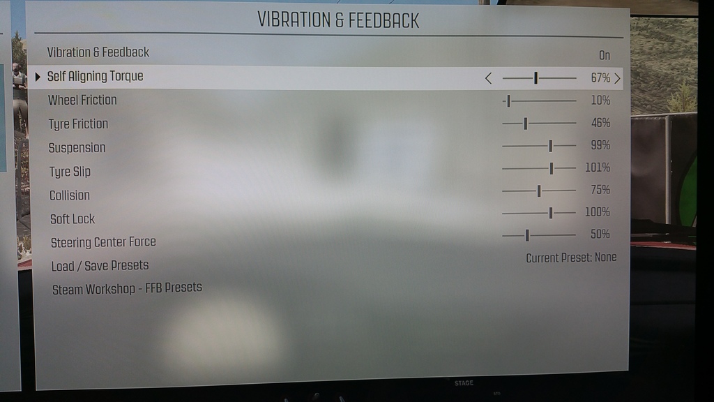

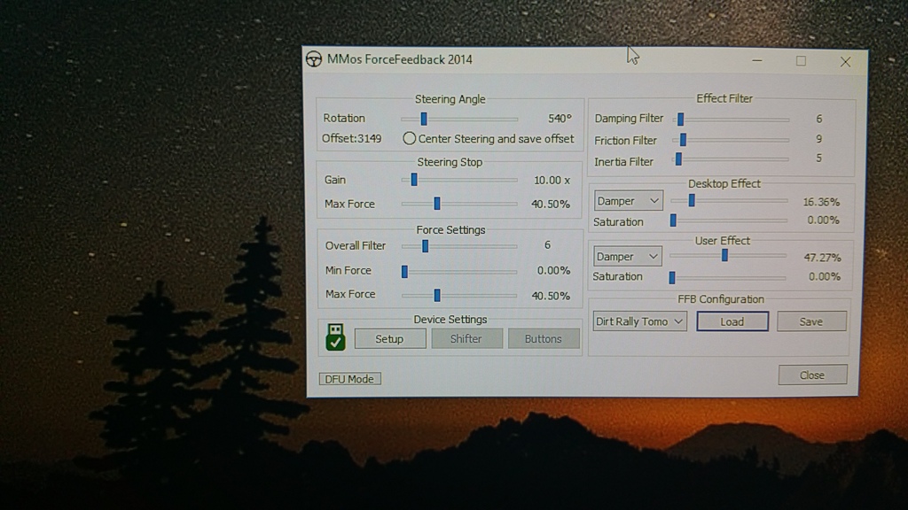

    These are the settings i'm using at the moment,,, they are Tomo's granity & MMos settings with my in game FFB settings ,,adjust the Self Aligning Torque slider for stiffer or lighter wheel but it's set pretty nice as is . @crammy for the large mige use Tomo's granity settings that your simucube came with :thumbs

    thanks @stevemontuno ill Give that a try tonight. I tried your previous granity settings last night and is was under powered for me. the wheel was quite loose, however i will give these ago as you have upped the current. my settings from tomo were different in the granity, being large MIGE and i had about 18A continuous and 19A max. it is definatly that current that makes a difference. when i run on Tomos setting on that game i nearly broke my wrist but its perfect on assetto.

    @crammy yep if you use tomo's granity settings and pop those MMos + game FFb in ,,then just adjust the game ffb Self Aligning Torque slider for your wheel strength .
