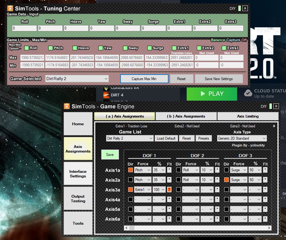

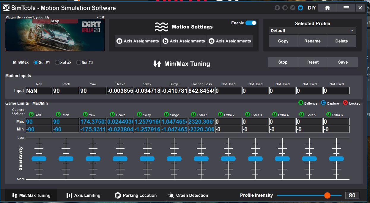

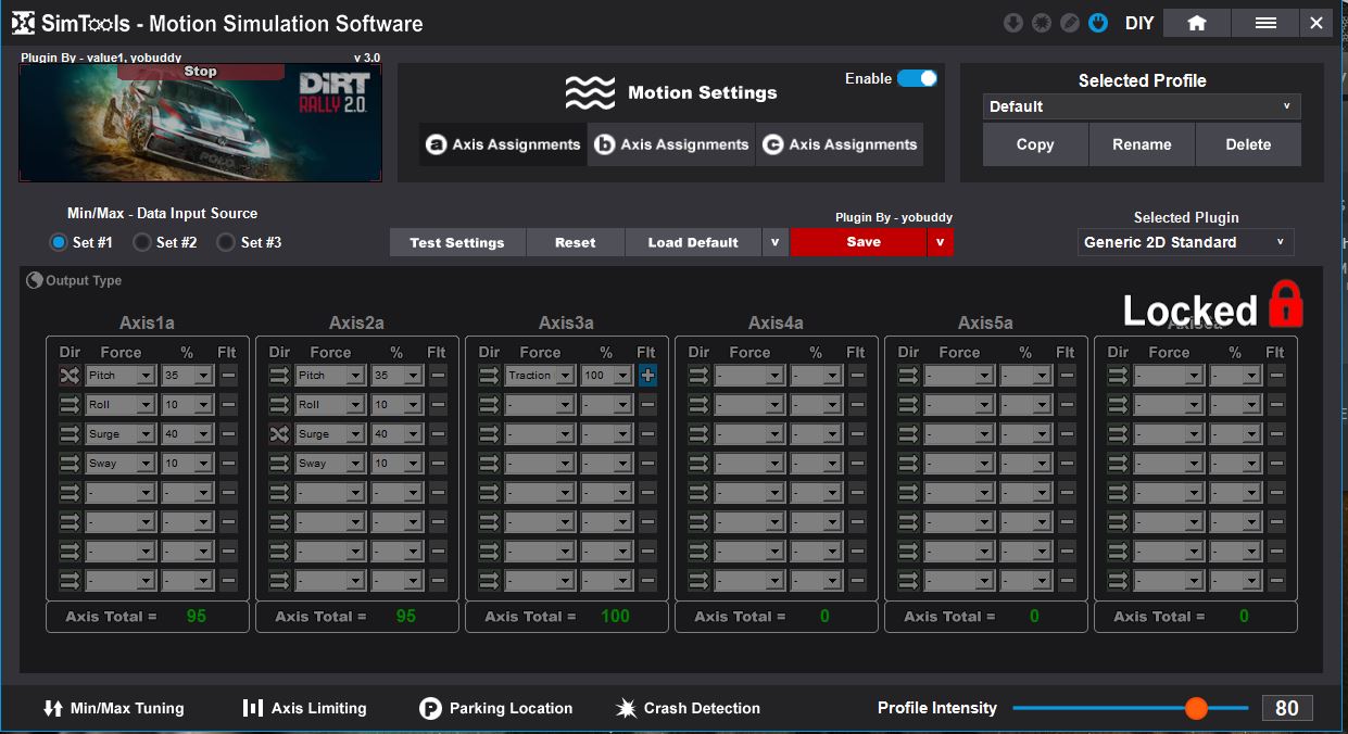

    Hi there, I am getting some really weird values when I try and run Dirt Rally 2.0. I tried in both Simtools versions and both show different values. Fyi this is after me carfully driving without hitting anything and going around a few turns and hills. When I run this profile at full intensity level, my motors just jump around. I tried lowering it to 80 and nothing is moving in a logical way, like the axis3 is shifted to one side, and my axis 1 and 2 are not really moving. Not sure if anyone ran into this before. And the roll input is NAN in the new SimTools. Not sure why that would be.
    Thanks!

  2. yobuddy
    5,133
    47,913Coins
    +5,027 / 16 / -0
    Looks like the same problem in wrcg, I will take a look.

  4. Nicki9knuckles
    Nicki9knuckles Active Member
    Sep 1, 2022
    161
    Web Developer
    Dartmouth, Nova Scotia, Canada
    518Coins
    +73 / 0 / -0
    3DOF, DC motor, Motion platform
    @yobuddy just a heads up that this seems to only be an issue with the plugin inside of SimTools v3. I was just testing SimTools v2.5 with Dirt Rally 2.0 and it works like a charm.
  5. yobuddy
    5,133
    47,913Coins
    +5,027 / 16 / -0
    @Nicki9knuckles,
    I pushed a new Dirt Rally 2.0 v3 plugin to the repo earlier today, maybe let it update and give it another shot.
    Thanks buddy!
  6. Nicki9knuckles
    Sep 1, 2022
    161
    Web Developer
    518Coins
    +73 / 0 / -0
    hey @yobuddy I just gave the update a try. I seen it was available in Simtools v3, and downloaded it. Then I booted up DR2 and got though all the menus but as soon as I get to the race, Simtools crashes. I reproduced this the 2 times I tried, booting it up a second time and relaunching DR2.

  8. yobuddy
    5,133
    47,913Coins
    +5,027 / 16 / -0
    Please remove the plugin all together and restart v3.
    Then reinstall the plugin and give it another go.
    (It's using different patching now, so I think it did not patch correctly is all.)
    But we will see :D.
    Chat soon!
  9. Nicki9knuckles
    Sep 1, 2022
    161
    Web Developer
    518Coins
    +73 / 0 / -0
    hey @yobuddy ! You were right! Uninstalling the patch first fixed it, things are working perfectly now. Nice work!!
