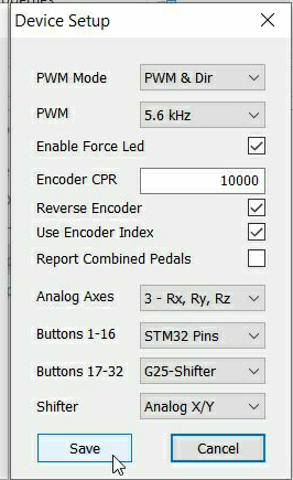

    Hello everyone, I guess I wanted to start this thread as I'm currently in the planning phase of building a direct drive wheel. As we all know we have MMOS and VNM, with VNM as it matures hopefully will take hold and provide us with better options for games. Although right now VNM is quite limited in the games it supports.
    I recently started my build by buying one of Thanos TDD boards which should allow me to build the system I want. I had great luck with my AMC controller for my motion platform so I wanted to give the TDD a shot.
    With that said I want to use a large 20-30nm Mige motor, with a minimum of 10,000 PPR encoder. I was on the VNM discord page and speaking with some people there. They have one option for a Mige 130ST with an EP100 driver. As far as I can tell it only looks like its 220v.
    Here in North America as we all know line voltage is 110vac, so I would need to install a seperate feed from the panel. Not a big deal, but an annoyance. I was looking to keep everything 110vac.
    What I'm looking for here are alternatives to the 220v while keeping a high encoder PPR and a strong 20-30nm motor. I'm looking for options and suggestions. Keep in mind, I am looking to stay very affordable, as well I like the customizable DIY approach hence not buying a DD1 or a DD2, Simucube etc.

    The TDD is plug and play with AASD drives (AASD-15A, AASD-20A, AASD-30A etc).
    To use with other servos you would need to do custom wiring for the control signals and also experiment and find the correct parameters for torque control with analog voltage input, with offset and scaling for 3.3v DAC used on TDD. Its not easy task... also as you mentioned, almost no other servo supports 110v operation...
    Better stick with AASD drives. 10000 positions per revolution is still very detailed for use with MMOS firmware!

    @Thanos all the AASD Drivers and motors I find are only 2500PPR in the specs on aliexpress. Do you have a listing for the 130st motors with 10,000 PPR as you said previous? Thx

    They are 2500 but are multiplied by 4 with an extra signal - 10000

    The encoders are 2500 quadrature... means 4x the pulses. So the real resolution is 10000 pulses per revolution.
    Also in the MMOS utility you set the encoder to 10000, so yes. Its true resolution.
