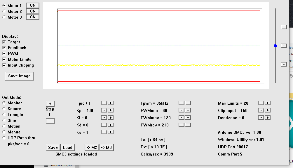

    I already managed to change my code to mode 2, but now smc3 won't let me put my engines "on" to follow the steps

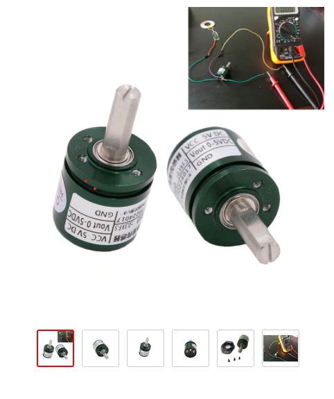

    Hello, I had the same problem and I only had to turn the potentiometers a little and in the smc3 as in the photo press motor 1,2 or 3

    DC 5V Hall Angle Sensor Non contact Industrial 0-360 Degree Rotation Angular displacement Sensor
    bought on aliexpress

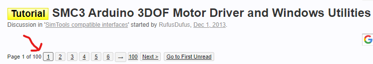

    Best to follow the SMC3 instructions: https://www.xsimulator.net/communit...3dof-motor-driver-and-windows-utilities.4957/

    Please post pictures of ALL of your settings in SMC3 and SimTools.
    Does SMC3 behave as expected, as that has to be fully sorted before configuring SimTools?

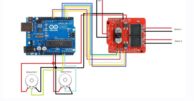

    Hello, excuse me, in what position do we put the potentiometer when connecting it to the motor?
    we need the engine not to make a full turn and that is what our engine tries to do
  16. noorbeast
    20,533
    145,022Coins
    +10,776 / 52 / -2
    The pot or Hall Sensor feedback should be centered when the motor levers are in their centered rest position.
    Mounting and connecting a pot depends if gearing is required or not, direct mounting with a flexible coupling is easiest, but some pots require gearing: https://www.xsimulator.net/community/faq/how-to-connect-protect-a-potentiometer.13/
    The control code, such as SMC3, should be tuned to set the range of lever movement and to cut power if that range is exceeded: https://www.xsimulator.net/communit...driver-and-windows-utilities.4957/#post-48121
