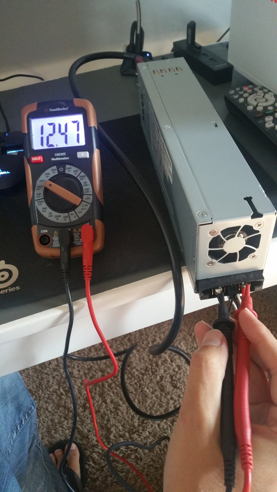

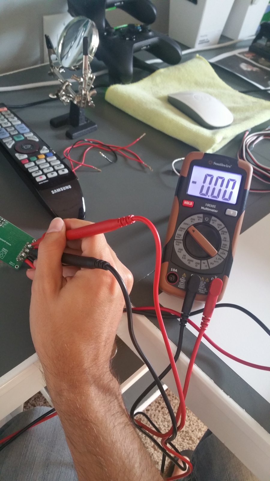

    Just when I thought I was ready to move my first motor, I had a very anticlimactic moment. I'm wondering if my horrible soldering skills may have fried my JRK.
    I have power at the PSU, Power at the JRK but nothing going to the motor itself.
    Any ideas?

    There won't be any voltage on the motor terminals unless the motor is being driven at the time.
    Are you trying to measure voltage while controlling the motor via SimTools or while in game?

    No, not via SimTools or while in a game. I was just trying to use the Pololu Jrk config utility.

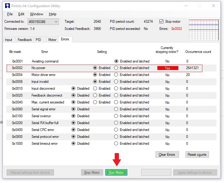

    Sorry. I thought I was doing pretty good with the info. I do not have a feedback POT fitted yet. I have the most simple setup possible right now. PSU -> JRK -> motor. The JRK is plugged into my computer and I'm running the Pololu utility. I'm assuming the "Run Motor" button would actually run the motor if everything were configured correctly.

    Part of the configuration is setting the min and max calibration for the lever, via the pot feedback, so the JRK knows what range to run the motor within.

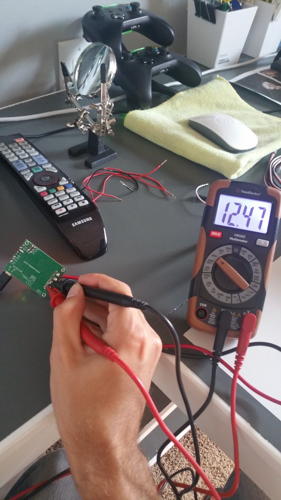

    Ok. I got my POT attached to the JRK and I get feedback in the variables vs time graph. So that looks all good. Next, I ran through the Setting Up Your System section of the JRK user guide, set the appropriate errors to Enabled and Latched, applied the settings and powered it up. Still no luck, the JRK LED is still red. Next, I ran through each error that should be set to enabled and latched individually and the only error that continues to stop the motor is the No power error. Its looking more and more like a bad JRK... in my noobie opinion.

    Problem solved. Went back and re-soldered everything! Thanks!
