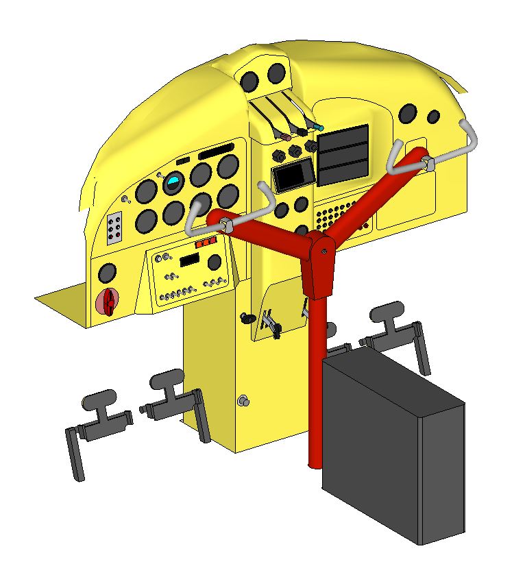

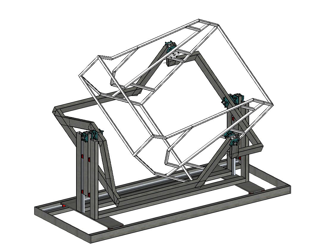

    I have been planning to build a simulator cockpit for a while now, and over the past couple of weeks have started taking definitive action towards fulfilment of the dream (other than just researching)

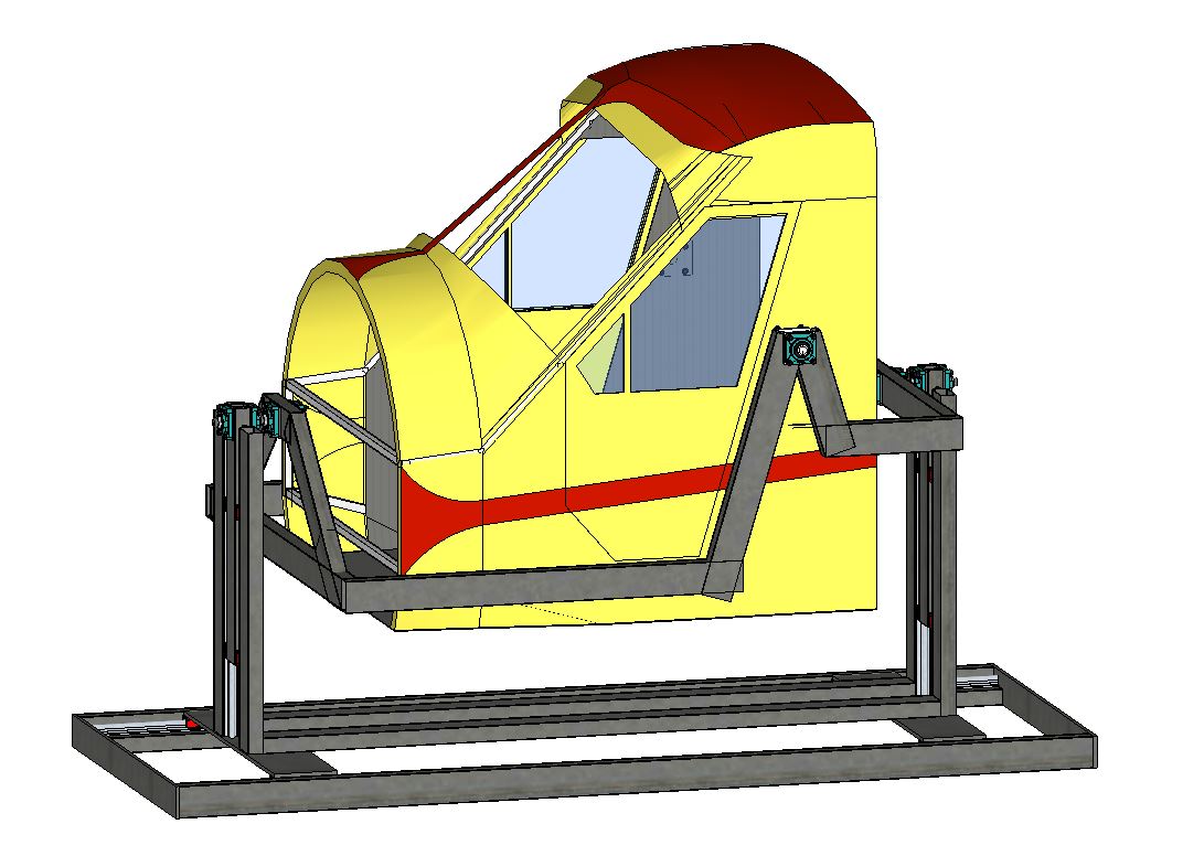

    I have decided to build a de Havilland DHC-2 Beaver, with fully functioning cockpit, on a motion platform. I found a nice looking model of a Beaver on Sketchup's 3D warehouse, and started preparing plans for the simulator based on that model, as well as some plans I have. I would really like to try and find more detailed plans, especially of the cockpit and instruments.
    At the moment, the plan is looking something like this.

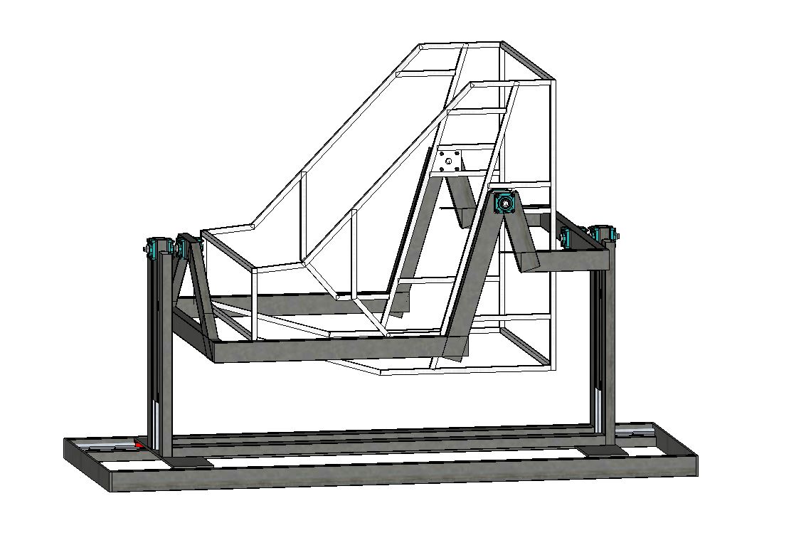

    I thought that I should try and go for a balanced frame, as this would require less power from motors and electronics. The idea would be to have Roll, Pitch, Heave and Surge. The Roll and Pitch angles should ideally pass throug the centre of mass of the combined cockpit + 1 or 2 pilots... I must admit that the whole sim is starting to look a little on the large size. I am not too pressed for space, but there is a limit to what my wife will allow :)
    I estamate the combined weight of sim and 2 pilots will be around 350kg.

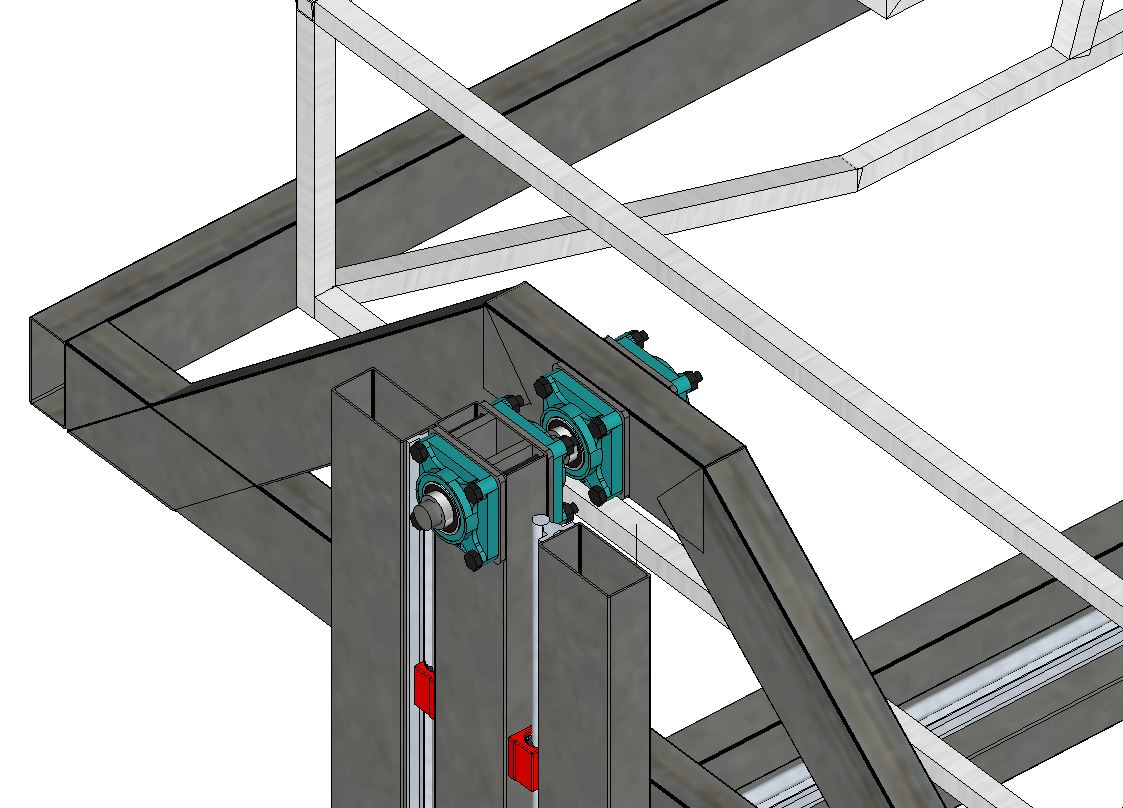

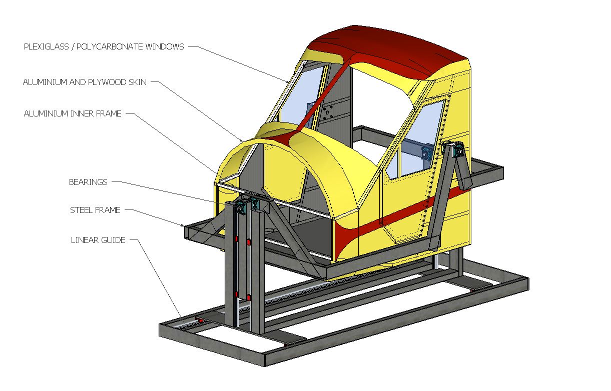

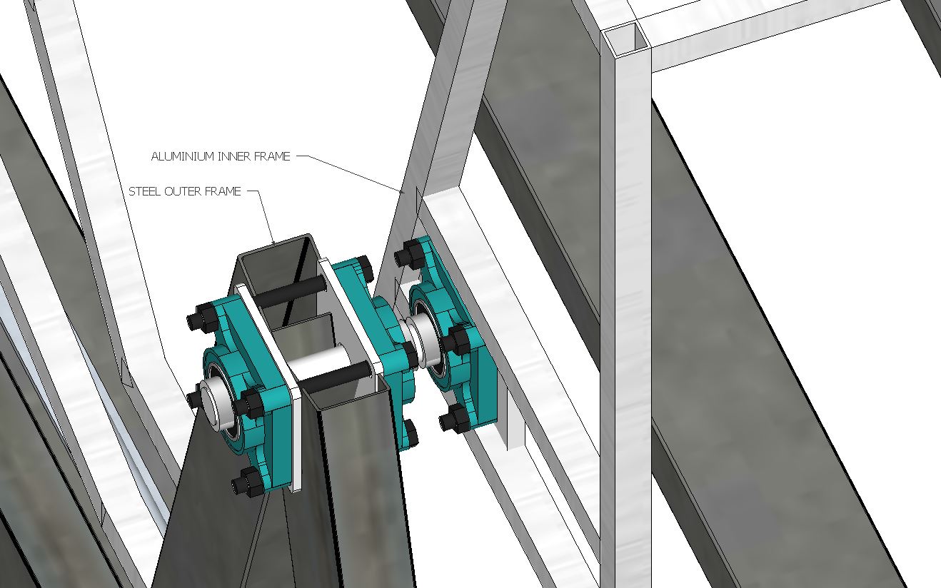

    The plan is to build the outer gyro frame from steel hollow section, whicls the inner frame will be made from aluminium. The body will have to be made from a combination of 3 mm playwood and 1 mm or 1.6 mm Aluminium sheet. the Roll and Pitch motion will happen around pillow block bearings. I am hoping that I can have Heave and Surge by moving the frame in something like SBR16 linear guides.
    The detailing of the frame is only done roughly. Lots of bracing and strengthening is still required.

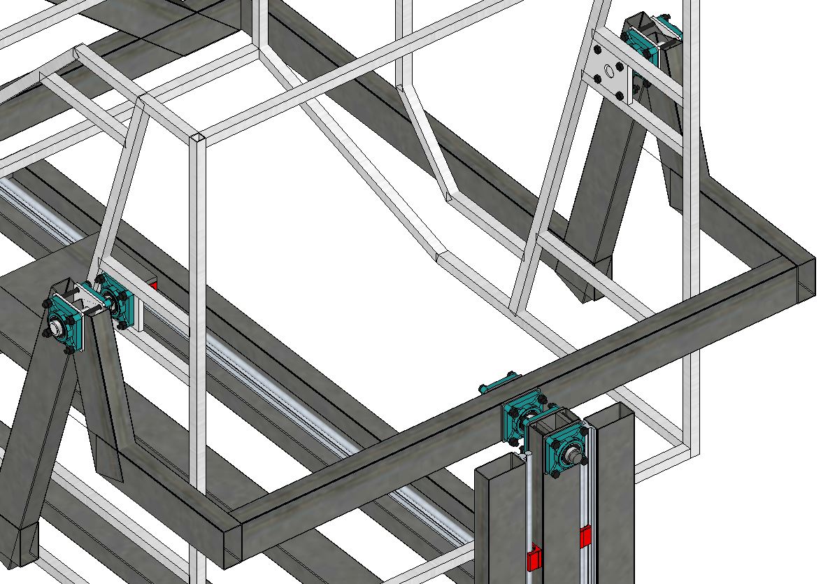

    I'm thinking that pillow blocks should give a good motion for the Roll dof,
    and for the pitch...

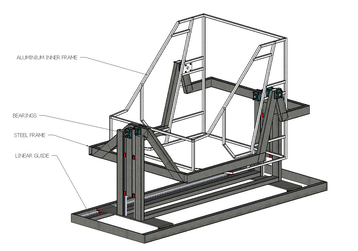

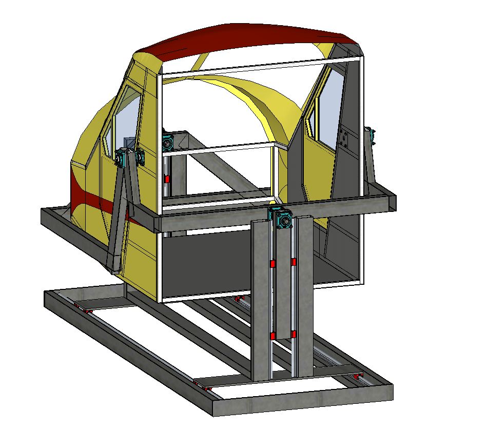

    There are still a few issues with regards to the amount of motion I will be able to get, but from my research over the past few months it seems one dosen't need an exorbitant amount of motion, anyway.
    The interior of the sim will require quite a bit of work, also. I might even start off by building flight instruments and controls.

    The lighter you can keep everything the better, particularly non structural components.
    It will take a bit to power it, do you plan to go AC?
    Just something to think about, you could incorporate a G-Seat into the design instead of the complexity needed for heave and surge.

    I was hoping to stick with DC. I'm thinking about something like Roland's actuators...
    http://www.simprojects.nl/diy_motion_platform_v.htm
    I'm hoping that by going as close as possible to the c.o.g. I won't be needing huge motors.
    @noorbeast , maybe you're right, I could can the Surge and Heave, make 2 dof frame, add G-seat and thereby reduce the complexity significantly. Would you say the G-seat is a good substitute for Surge and Heave, or is the actual Heave and Surge motions on the motion platform better i.e. more realistic?

    A G-seat has the advantage of simulating heave and surge in a much easier to implement form, with the potential to also contribute to the sustained simulation of other g-forces.
    The likes of @SeatTime would be in a better position to comment about the capabilities and limits of DC powered actuators, but I suspect the advice would be to lower the planned mass.

    I have little doubt that I will be building 2 G-seats. I don't think its easy to simulate sustained G force effect in any other way. The only thing is that I am still not that clear on adding Heave and Surge. If I read @SeatTime post correctly, he uses a combination of G-seat and 6 dof motion.
    My thinking is as follows:
    1. Plan for everything neccesary or desirable as it will probably be easier to leave things off / simplify the design later, than to add things later,
    2. I would ideally only build a simulator once in my life, so I should rather try and do it right,
    3. About immersion, you know that feeling you get in your stomach as you initially lift off the runway... or the feeling you get when going through some turbulance (vertical movement) Well, my thinking is that those effects will be hard to simulate with anything other than actual heaving motion. Thing is, I don't know as I have never bern in a simulator in my life.
    4. Other effects, such as sustained climbing or turning will be easier to simulate with a G-seat.
    5. I fully understand @SeatTime comments regarding inertia. I have been thinking of getting lifting assistance for heave using bungee chords.
    6. Also, about washout and returning to starting position slowly, does Simtools make this possible?
    Lastly, I was thinking that if I try and get the pins for roll and pitch as close to the cog of the system as possible, I could reduce the amount of power i need.
