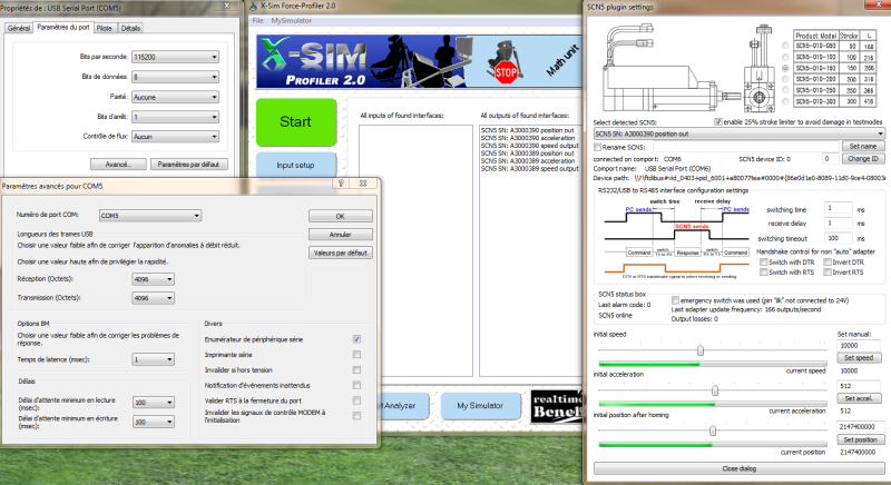

    Could you share your settings in Profiler for the Devantech rs485 to usb ?
    I am getting an average of 160 output/seconds with default Profiler (2.1.0.4) settings of 1-0-100.
    Did not try to check LPT in the adapter properties like some users here metionned ...
    What is the 'normal' average output/seconds we can get with these adapters?
    Also, what should be the initial speed and acceleration values?
    Thx!
    Bleco

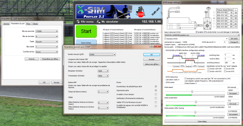

    I am finally getting 250 output/secondes after tweaking scn5 and com port settings ...
    however it doesn't seem to be very consistent ... I can get 250 and then next hardware scan 166 and then 200 and then 250 ... What can explain this ?
    Thanks!
    Bleco

    It is important to understand what these settings actually do.
    70ms or 200ms -- doesn't effect your performance. It is a timeout value. It only has an impact when either something in the Windows OS or X-Sim software or FTDI driver goes bad an causes an excessive delay. X-Sim is not known to have this problem, but many factors can cause windows or the driver to have an excessive delay. The example shown in the picture above is not an optimal configuration because the FTDI driver timeout is set to unlimited and the X-Sim timeout is 200ms. In my testing, I have found the best recovery from rare Windows timing issues to be when the FTDI driver and X-Sim timeout settings match. Since the lowest FTDI timeout is 100ms, then the best matching value is 100ms.
    Also, the subject of performance gets much more complicated than this. Just because X-Sim says 250 updates a second, does not mean that you are getting these updates to the actuator! You may simply be filling the FTDI buffer at a very fast rate causing X-Sim to think that you are getting a good update rate when in fact you are not.

    Setting latency to 0 will only make things worse. It's sort of like overclocking in that some PC's can handle the aggressive timing settings with no problem and others cannot. There is no good explantion for why some PC's can handle aggressive timing and others do not, it's just the luck of the draw. If you have problems with 0,0,100, then try 1,1,100. It is better to have stable consistent performance than to have a high update rate that stops working in the middle of a race.

    With these settings I am getting constant 200 outputs/sec each time I scan for hardware changes.
    I have found out that in my case enabling LPT printer check in com port settings resulted in making very inconsistent results ...
    If I set the switching time value to 1, I am getting constant 166 outputs/sec ...
    I will do some in game testing to with 0-0-100 settings and if I am having issues with actuators connection drops then I will stick to 1-0-100 ...
    Thanks!
    Bleco

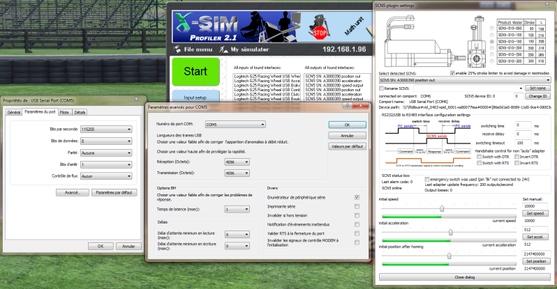

    Please refer to my above post again. Your timeout settings are still mismatched. 0 = unlimited in the advanced virtual com port settings.
    I have tested each of these scenarious when developing the SX-3000 under various circumstances including an intentional strain on the OS. This is when the timeout settings become most important.

    Hi Bernard,
    Thank you again for trying to help me with this ... I wish I could spend more time on this project these days ...
    Is it better like that?
    Bleco

    Yes, this corrects your timeout settings. We'll leave the rest for sometime when I can write a tutorial about how the virtual COM port actually works.
