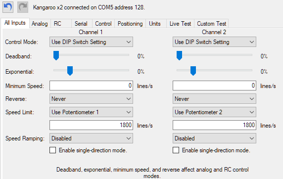

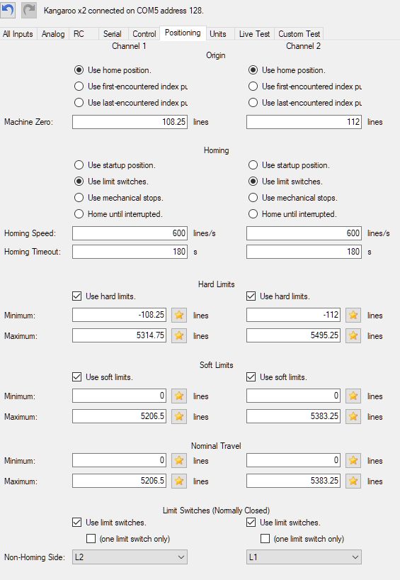

    Hi: I'm using encoders, Kangaroo x2 and Sabertooth 2x32. Live test, Tune worked. Rebooted.
    These are my settings. Can you see where my settings wouldn't allow it to home at half way?

    I do not think it is supposed to center after homing. Instead, it moves to one of the limits (which is at minus something coordinate) and backs off a little to get to zero.

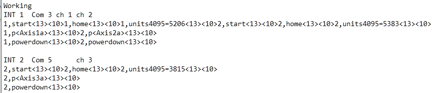

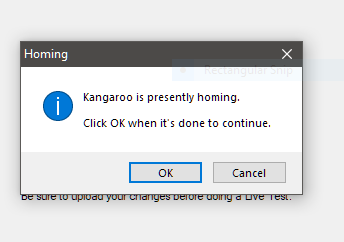

    It's doing that on com 3 M3
    and Com 5 M1, so I think they are ok. On Com 5 M2 I getting this when I try live speed. Homing Simtools live speed.PNG
    Also when I run Simtools M3 and M1 only hit the limit switch and back off a bit.
    Simtools settings.PNG Any ideas?
    I'm so close to doing laps again!

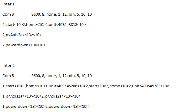

  5. PaulB
    PaulB Titanium2dof
    Apr 15, 2017
    121
    Canada
    723Coins
    +57 / 1 / -0
    Figured it out. Simtools Error. This corrected it if your running encoders withe Kangaroo Simtools Encoder Kangaroo x2 3dof.PNG
