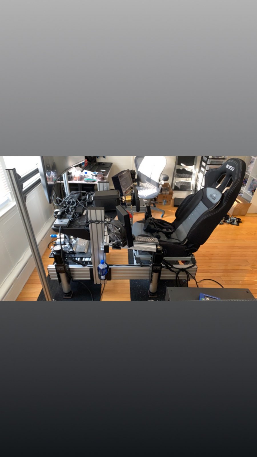

    I am almost done with the wiring for my 4DOF+TL from PT-Actuators and need help with a default profile to use for SimTools.
    I'm getting a bit confused on which Axis to use for each DOF.
    Can anyone help and show me their default profile?
    I will mainly be using it for iRacing but I will also be using it for RaceRoom, Dirt Rally 2.0, and some other sims I use as secondary.
    Any help would be greatly appreciated.

    I have the PT-Actuators 4-DOF 150mm 250mm/s mega monster actuators
    (Ill be installing the TL platform next week)
    When working on the axis assignments another thanos member told me to set up the 4 axis across all 6-DOF Under assignments. My total percentage was around 130-140% for iRacing on each axis if i counted up each DOF.
    For DOF-6 he said to put Extra1. Is that even necessary or can i leave it with DOF1 through DOF5 for the iRacing axis assignments for the 4-DOF PT-Actuators i currently have installed. If i leave off the DOF-6 and leave it for axis5a when i install the TL Platform, i will have the Extra1 on axis5a across the line.
    WhAt do you think about leaving off DOF-6 for now while i only have the 4 Actuators installed?

    You really should post pictures of your rig and all your settings, so members can give considered advice.
    From you description I am guessing you are using a 5 actuator rig, one on each corner plus traction loss, and if so that is actually a 3DOF rig + traction loss. Extra 1 should be dedicated to traction loss and allocate surge, sway, heave, roll and pitch to the other 4, initially tuning each axis/force individually, then refine.

    My rig is 4 actuators currently
    I havent added the TL platform yet. I’ll do that next week probably
    So you’re saying i should only set surge, sway, heave, roll, and pitch for now for my iracing profile in simtools? At least until i add the TL Platform
    20,464
    144,620Coins
    +10,741 / 52 / -2
    Yes, that is what I am suggesting, and initially tune each axis/force individually then refine from there, as per the earlier link.

    I assume my initial dizziness was because i set DOF 6 to extra1 and had all 4 actuators activated to work for it. Since i havent installed the 5th TL actuator, i believe it was causing me to get motion sickness.
