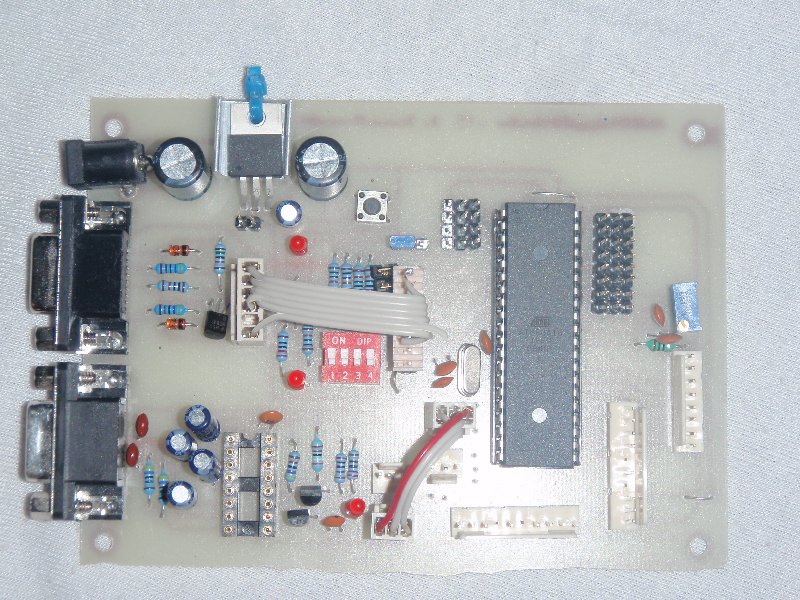

    I have finished putting on all the parts to tronics AMC board....
    went to plug it in and got no LED lights at all.
    I think i did a good job on the pcb and solidering.. although obviously there is a short or loose wire somewhere...
    I have tested that i am getting 9volts from where the power supply plugs in..
    can anyone give me hints/tips on how to debug further?
    im going to go over all the soildered points tonight. but if there is any tips on how i can try and find the problem ?
    :sos:

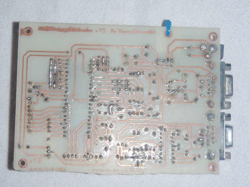

    Here is my board. I am going to go over all the solidered points slowly and carefully.
    I know its not the best job:
    Any assisantce would be great! The LEDS dont light up at all.
    if you can give me some advice hwo to test it with the multi-meter to find out which point or track is the problem that'd be great!

  4. tronicgr
    tronicgr
    Measure the output pin of the LM2940 to see if it does output 5v. If not, it is faulty and needs replacement.
    Also as the LM2940-5 is a LDO parts, the perfect match power supply for it is a 6V ~1A transformer. Be sure that the transformer you used does not have center pole reverse voltage direction switch !!!!
    Regards, Thanos

  6. tronicgr
    tronicgr
    Well, the placement of the parts looks ok, but the bottom of the board looks like its you etched the lines by yourself... Take a good magnifier and a good source of light and start searching for small short-circuit bridges...!!
    Regards, Thanos

  12. RaceRay
    Nov 8, 2006
    4,657
    Hamburg, Germany
    23,875Coins
    +2,037 / 13 / -0
    Ah ok, i see. I know what you mean.
    I think it is better to follow every route on the pcb only with a magnifier and a spiky tool like a nail or something to follow it better.
    Should be no problem to see any short curcuits with your eyes.
    I would not to advise you to find out any short circuits only with a multimeter, because you can only measure 2 points at the same time, but there is a unlimited amount of potentialities for a shortcut between that 2 points.
    Otherwise if you got at least two defined pins and definitively know that there must be no short curcuit, than you can measure the resistance between both or more points. Any resistance near zero can be interpreted as a short curcuit i think.
    regards
