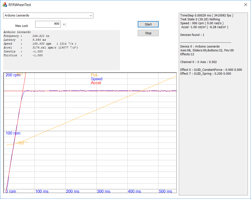

    Anybody interested in WheelCheck log files? What are the best settings for WheelConfig (gain, damper, spring, etc.) to have a reasonable log output from WheelCheck?
    • Dislike Dislike x 1
  8. Benu
    Benu Member
    Mar 19, 2018
    128
    1,295Coins
    +42 / 2 / -0
    This is the RFRWheelTest output.
    Reduced maxium current to 4A for the time beeing. Just to be on the safe side.

    Is this test program available for download?
  10. Benu
    Benu Member
    Mar 19, 2018
    128
    1,295Coins
    +42 / 2 / -0
