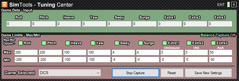

    Hi all
    Thought I'd share my export.lua, which I'm quite pleased with. I have added some functions that make especially heliopter flying more realistic and rich in feedback. I have a background in general aviation, mainly sailplanes. Therefore I really enjoy what Value1 and Dirty have done with the roll rate function, which is far more realistic than holding a steady tilt when banking / climbing. The AOA function is also great but I encountered serious problems with helicopters.
    When flying slowly or hovering, the AOA shifts abruptly between positive and negative values. For example, climbing / descending at slow speeds gives a value of anything between -90° and +90° AOA. Again, flying backwards outputs values from -90° to -180° and +90° to +180°. Flying backwards and transitioning from descent to climbing results in -180° to +180° jerk. Highly annoying and distracting.
    The export.lua I attached here outputs no AOA values at low airspeeds, but outputs pitch/bank rate values. While speed increases, the AOA values gradually increase and angle rates decrease. Works great on helos, and pulling high AOA manoeuvres in a MIG29 feel awesome :)
    Bear in mind, I am using Fasetech's RacingCube 4. I am no programmer, so tweak the code to your liking and please let me know how it feels on rigs with smaller range of motion. Have fun.
