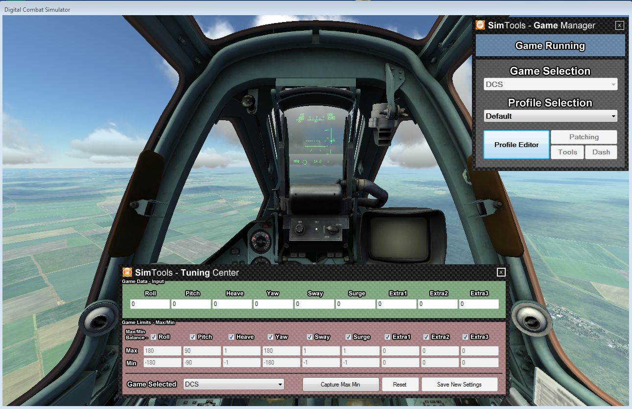

  20. RiftFlyer
    RiftFlyer Active Member Gold Contributor
    Apr 15, 2014
    195
    1,693Coins
    +120 / 0 / -0
    DC motor
    I'm no closer to solving my issue. If anyone has any advice for diagnosing the problem I'd appreciate the input.
    -Fresh installation of sim tools and dcs. Both were installed as administrator and are set to run as administrator.
    -Game patched correctly. I have the export.lua script showing in my saved games\dcs\scripts folder.
    -No mods or other entries in my export script
    -No invasive anti virus software running
    -Tried with windows Firewall off and also set up exemption rules for port 41230
    -No export script related errors in my DCS log file
    -No noticable increase or decrease for the game manager process under task manager
    As per the below screenshot game manager is showing successful connection to DCS yet Tuning Centre shows no incoming live game data.
