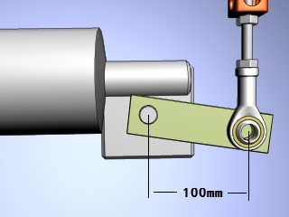

    I have been thinking about building a 6dof compact Stewart platform using these 400w motors https://simukit.com/moteurs/8-moteur-400w.html.
    I haven't finalised my design yet and am still working my way through Wannabe Flyers build thread and ZigZag49's build. https://www.xsimulator.net/community/threads/6dof-dc-24v-smolka-zigzag49.7490/
    The platform needs to be able to carry 200kg, and knowing nothing about motors can anyone tell me if 6 of these 400w motors (rated at 57nm) would be sufficient or capable?

    57NM, Arm 100 mm, about 58 kg of force, 6 motor can get about 350 kg thrust, great.

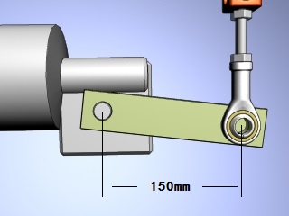

    Arm up to 150mm. About 38kg, 6 motors on the 230kg thrust.

    57 nm / 0.15 (m) = 380 (Newtons)
    380 / 9.80665 = 38.74kg
    6 (Axis) x 38.74 kg = 232.44 kg

    57nm/100mm=570/9.80665=58.1x6=348.6kg
    57nm/150mm=380/9,80665=38.74x6=232.44
